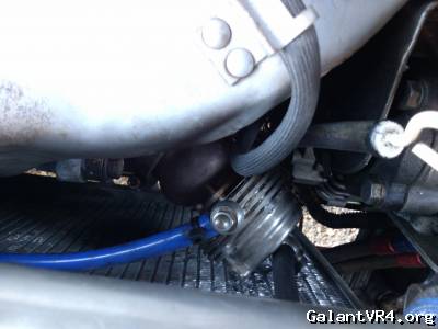

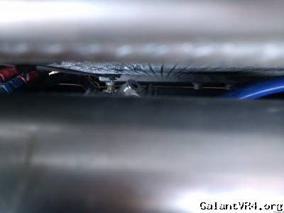

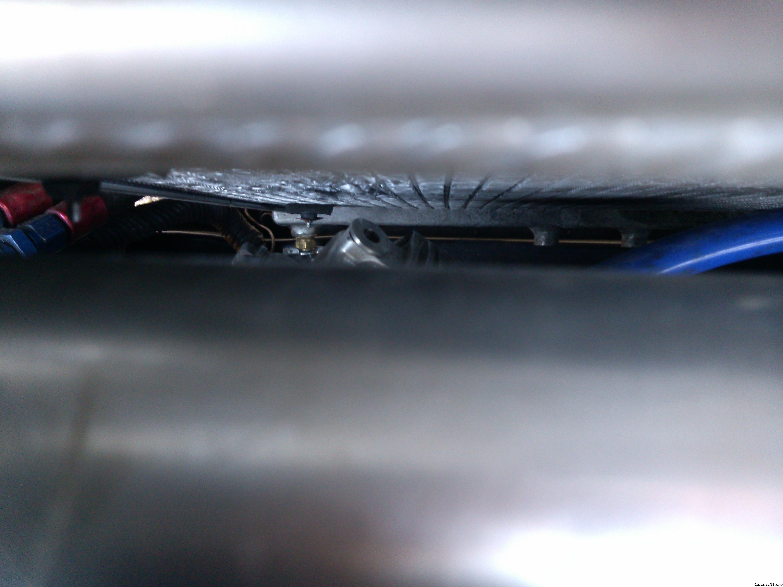

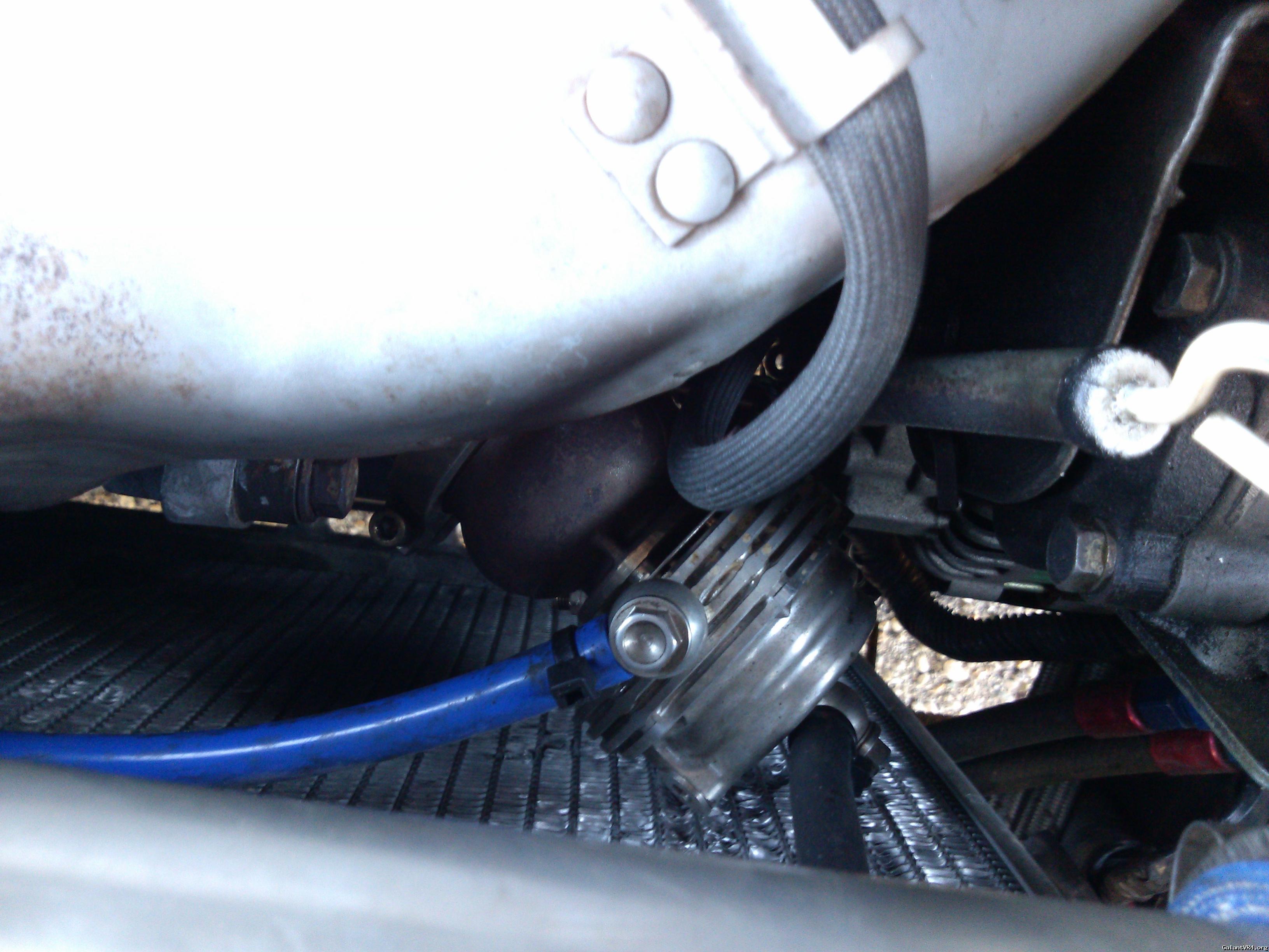

Here are some pix of my setup. Its kind of hard to see because of the intercooler pipe but there is just enough room to take the radiator in and out. The second picture is looking between the intercooler pipe and the radiator.

Don't forget about the wastegate. The wastegate in the above pictures appears to be the Tial MVS which is about 1" shorter then the 2 bolt design.

The 2 bolt version will NOT fit without major modification. I bought one and fussed with it for months and decided that there was no easy way to make it fit so I sold it. The MVS version came out and it looked like it would fit so I bought it with plans to make my own o2 housing. I got in a hurry and bought the MAP one and it took like 2 months to get it but it fit really well. I would sell the 2 bolt version and get the MVS. Its much more compact and has been working flawlessly for me. I have to remove the dump tube to take the down pipe off and I'm sure the v-band makes that much easier than fumbling with those 2 bolts. I've been thinking of getting an FP dsm76 and going with the mvs44 setup off the fp housing. It tucks up almost under the manifold. Just trying to justify $2700.
