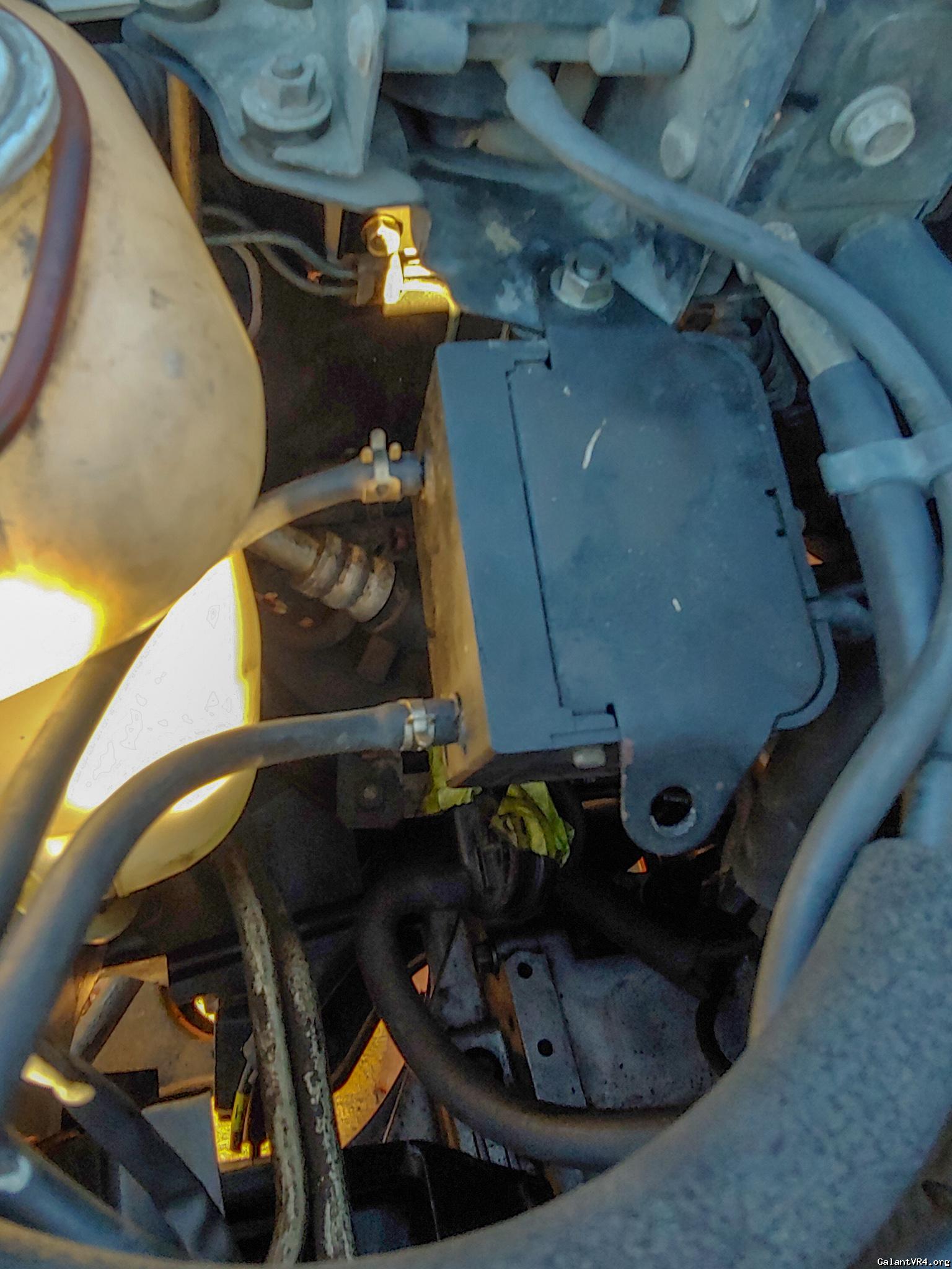

I have a black rectangular box with two vacuum lines, one in and one out, which is currently (and most likely incorrectly) mounted near the firewall passenger side. I don't know where the vacuum lines go.

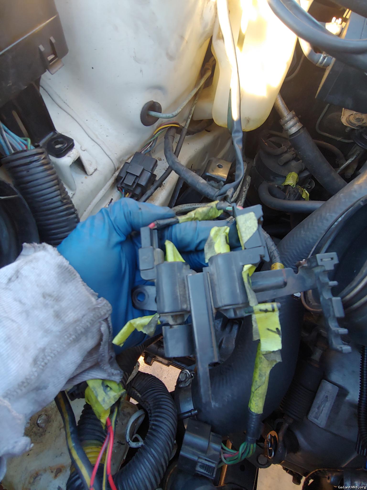

I have a little bracket with mounts to the rear of the stock airbox with two electrical switches and four vacuum nipples. I got the connectors figured out, the vacuum nipples....
Near the passenger headlight, right next the 6 pin fan connector is a 2 pin female connector, can't find the male side.

Have you looked at the "vacuum line" routing diagram on the hood, if it's still there? My car has it and if you need I can post a pic of it. Are you still using an egr valve and other components that require use of the vacuum lines? I think the 2 pin connector you are talking about goes to the boost control solenoid. I have never seen that black box looking thingy. I dont use those vacuum lines any longer otherwise I would just tell you where they go. You can figure it out by looking at the diagram, it's not that complicated

That big black box, pull it off, on the other side I'll bet it says greddy, it should be a boost controller box for a old school profec b. The two vacuum solenoid's like like they are for the fuel pressure regulator, but repurposed as the OEM boost regulator.

The box was for the greedy, so I pulled that off. Also found a trunk of vacuum lines that had slid out of sight, and those connected to the solenoids.
