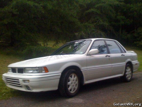

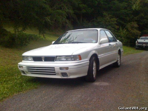

I am a new owner of a 1991 Galant VR4 #747 of 2000 The car is 100% stock
with 99,000 miles on it. While driving runs perfect then sometimes cuts out
led boost gauge jumps up and down as does the rpms sometimes lasting 4 minutes
then going back to running 100% /ubbthreads/images/graemlins/banghead.gif Most times if i drop the rpms and shift
to a higher gear it stops doing this. It hasnt happened in 2 weeks but will happen
again! I gave her a full tune up since then best of the best everything straight from
the manual since then and still happens from time to time can anybody help
