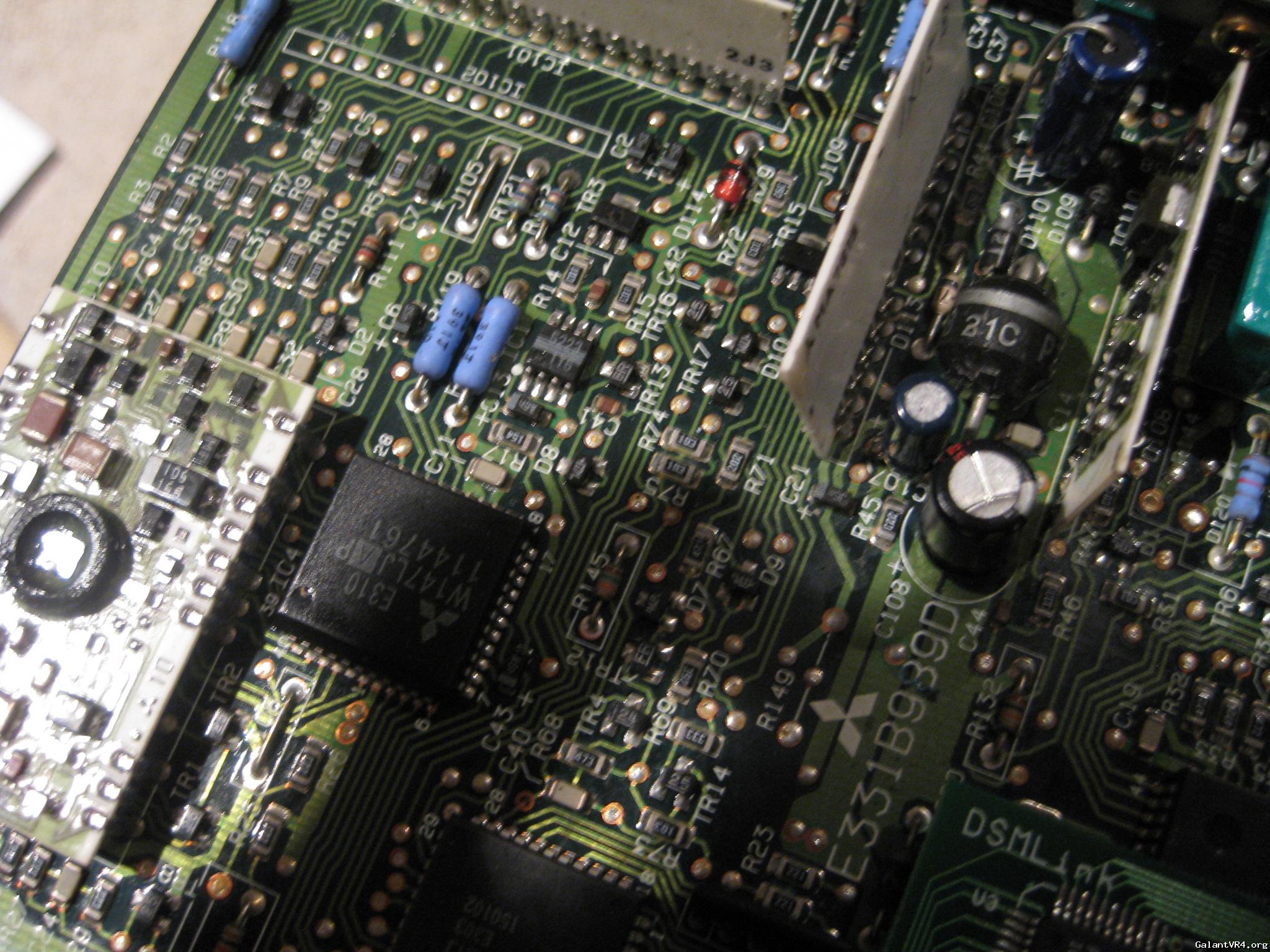

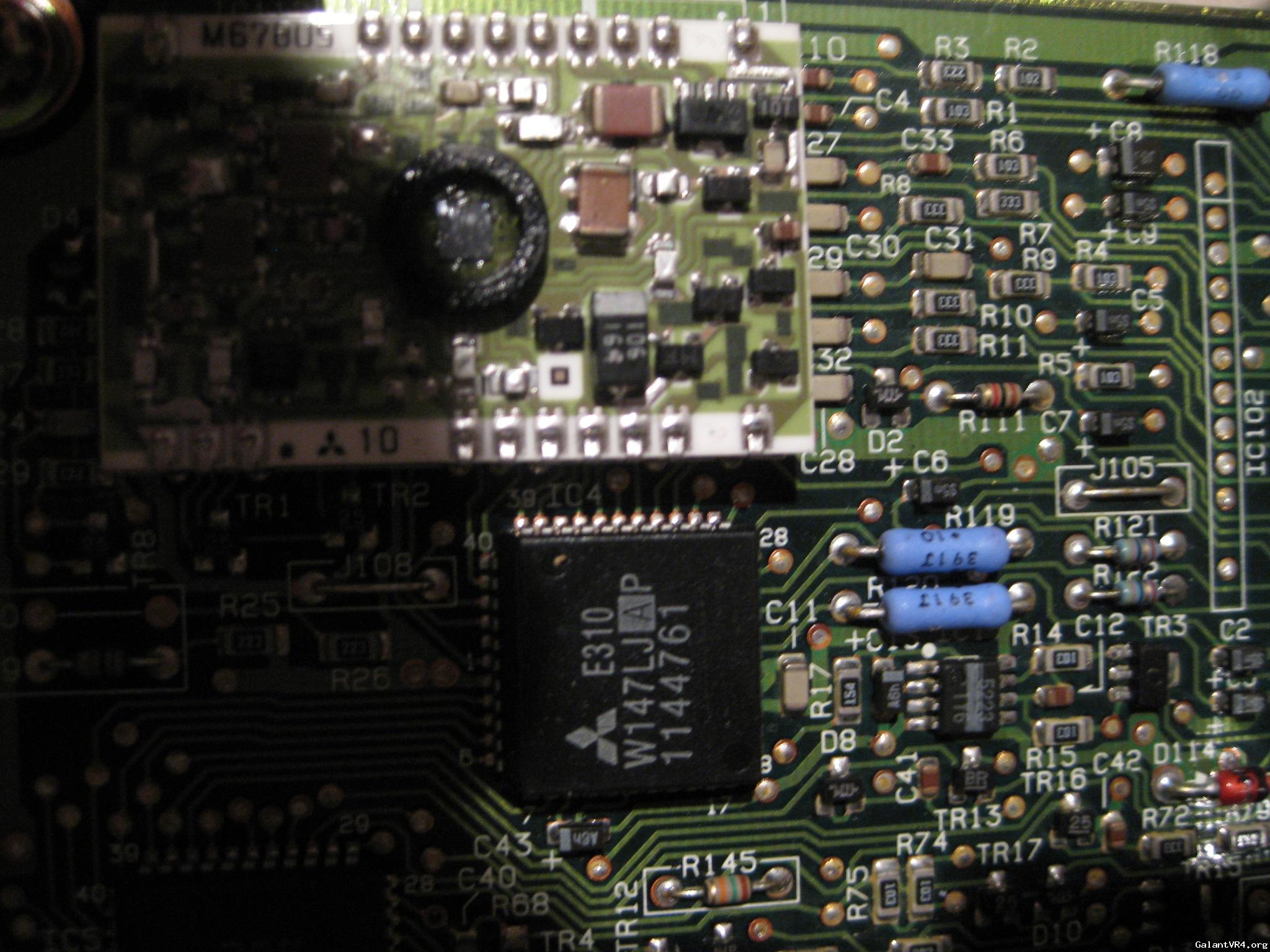

It is VERY strange to get a CEL 42. Are you sure your ECU is the right (USDM) one? The ECU checks for +12 volts coming back from the fuelpump/MPI relay, to make sure it is working. If the car is running, that means the fuelpump must be working, so pin #13 should have 12 volts on it. With all those errors, I'm beginning to wonder if you might have some acid damage in the ECU. /ubbthreads/images/graemlins/dunno.gif

I have some pics here of the ECU i dont know if you can tell if its the right one or not. If you need the numbers on it I'll go get them in a little bit. PS these are old pics with the old DSMLink on it and before I sent it to ECMTuning for testing. From the email Tom sent me, "We tested your ECU and found zero problems. The caps had already been replaced and looked good. We did replace one (free of charge) simply because the replacement part that had been used previously was not exactly the right specification."
