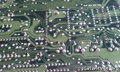

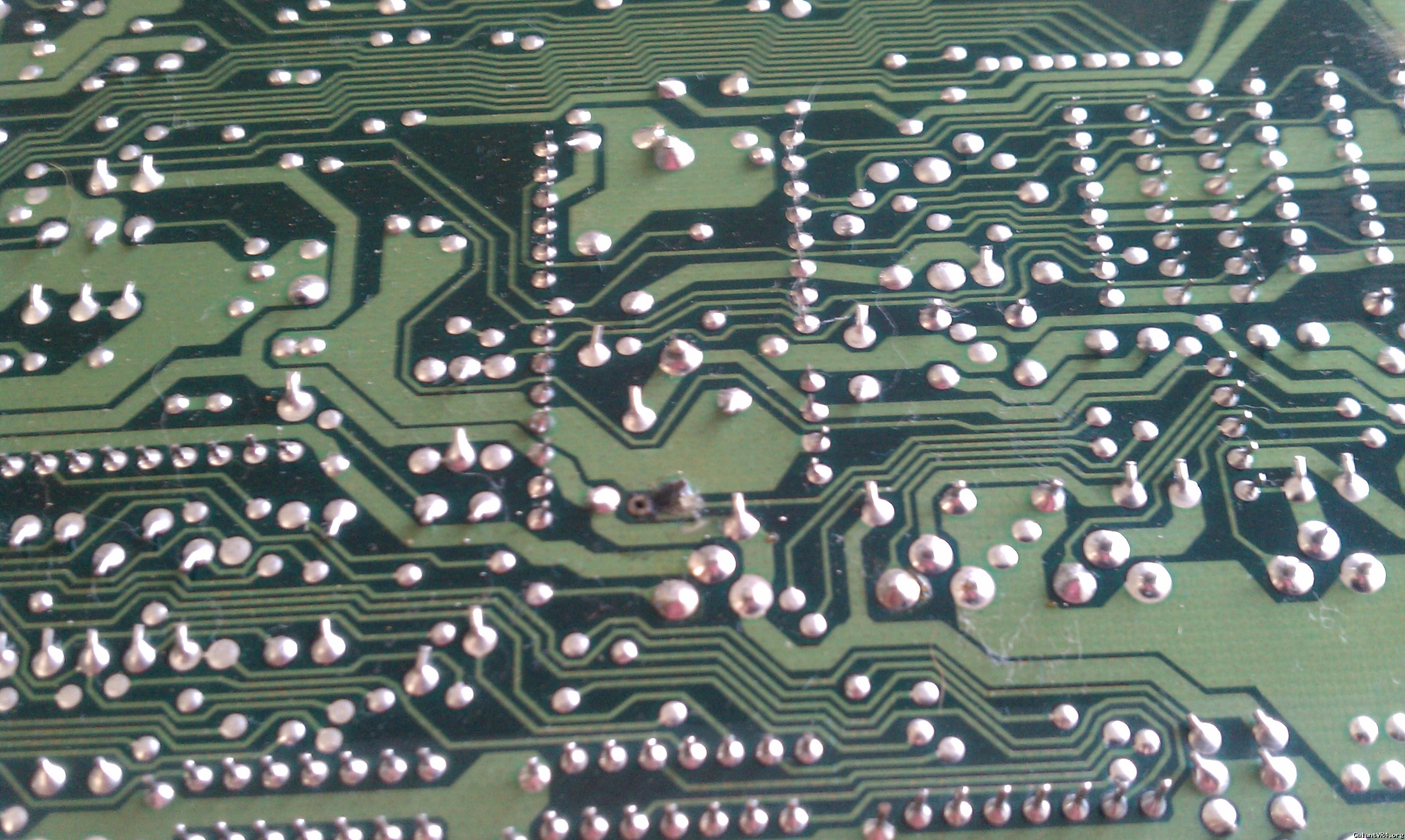

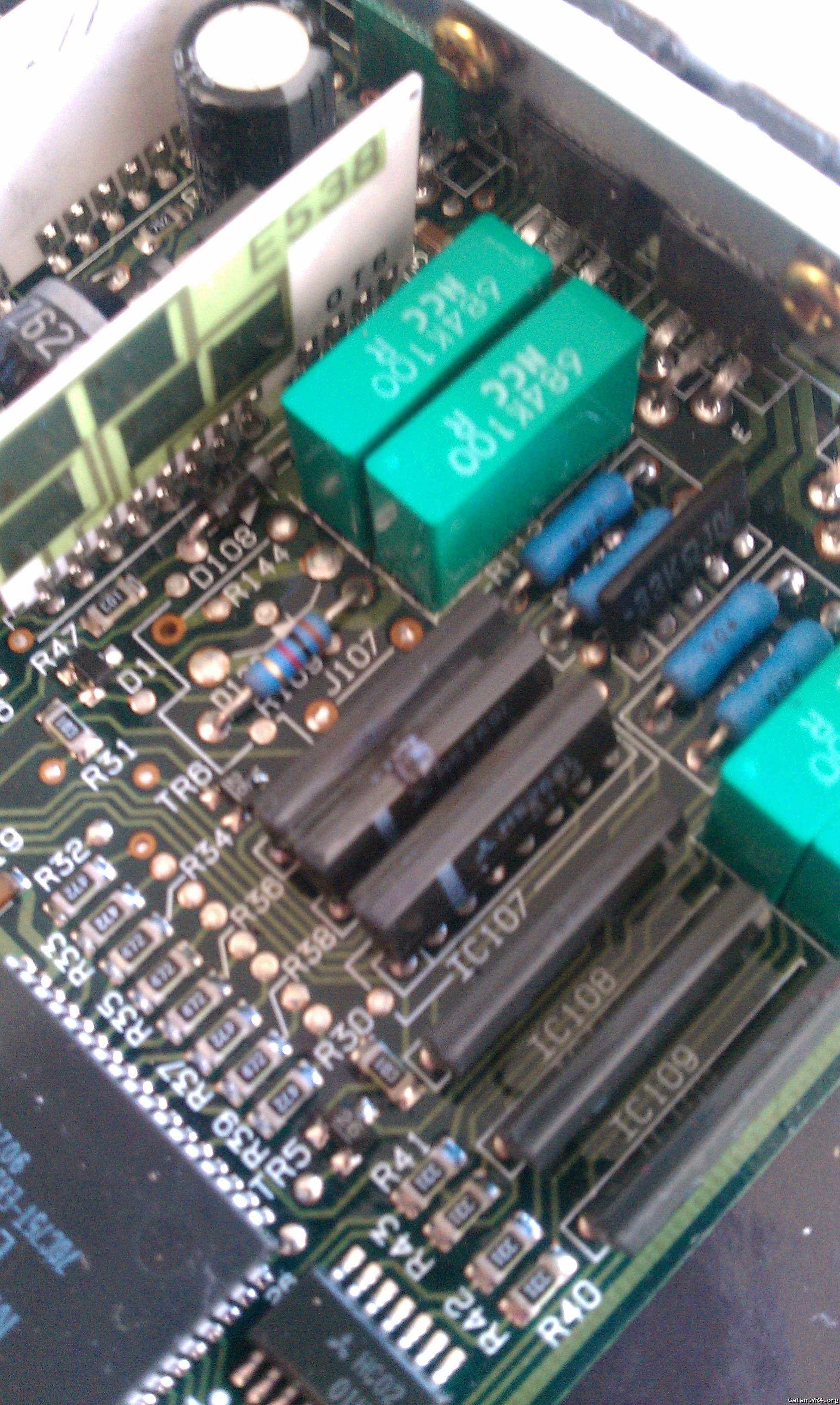

I found out that on my ecu the 47uF capacitor leaked and caused a short that fried my ISC driver. Who would have known that when you start your car after doing a few simple mods like a turbo swap, clutch and flywheel job, replacing the alternator, and putting on a 1g intake, that your ISC would finally just give out like that and cause utter destruction to your once perfect idle /ubbthreads/images/graemlins/dunno.gif I still have no error codes from the 1g MAS, so I'm assuming the vr4 one was either having issues with the 1g intake or was is just messed up.
My idle is not perfect yet, but after I replace my now torn up biss scew I'm sure I can fine tune it. I know I brought this upon myself by putting off my capacitor replacements. I have new caps for both of my ecu's on thereway now. Thank you all for your help.
