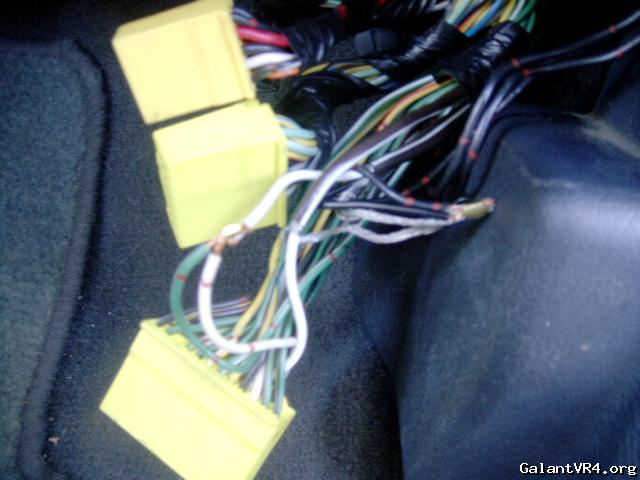

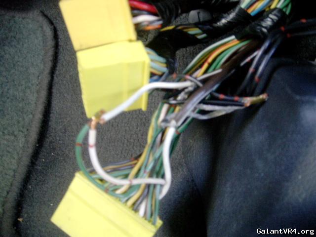

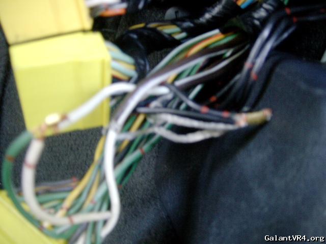

here is a picture of the ECU harness wiring after i removed some of the tape, not sure if its supposed to be like this or not. anyone know?
Yes, several of the wires do tie together and then split right at the ECU. Ones the O2 I believe and I can't remember off the top of my head what the other is. I wouldn't suspect the wiring as your issue does sound like its related to heat soak. I'd bet on the MFI relay fouling once it warms up. If you checked it before it was warm, it may not show any signs of problems. Only other thing then the relay, is the coil pack. Seen them do similar things where they heat soak and start fouling up, but since your relay (or something in that area) is clicking, I'd put my money on it.
