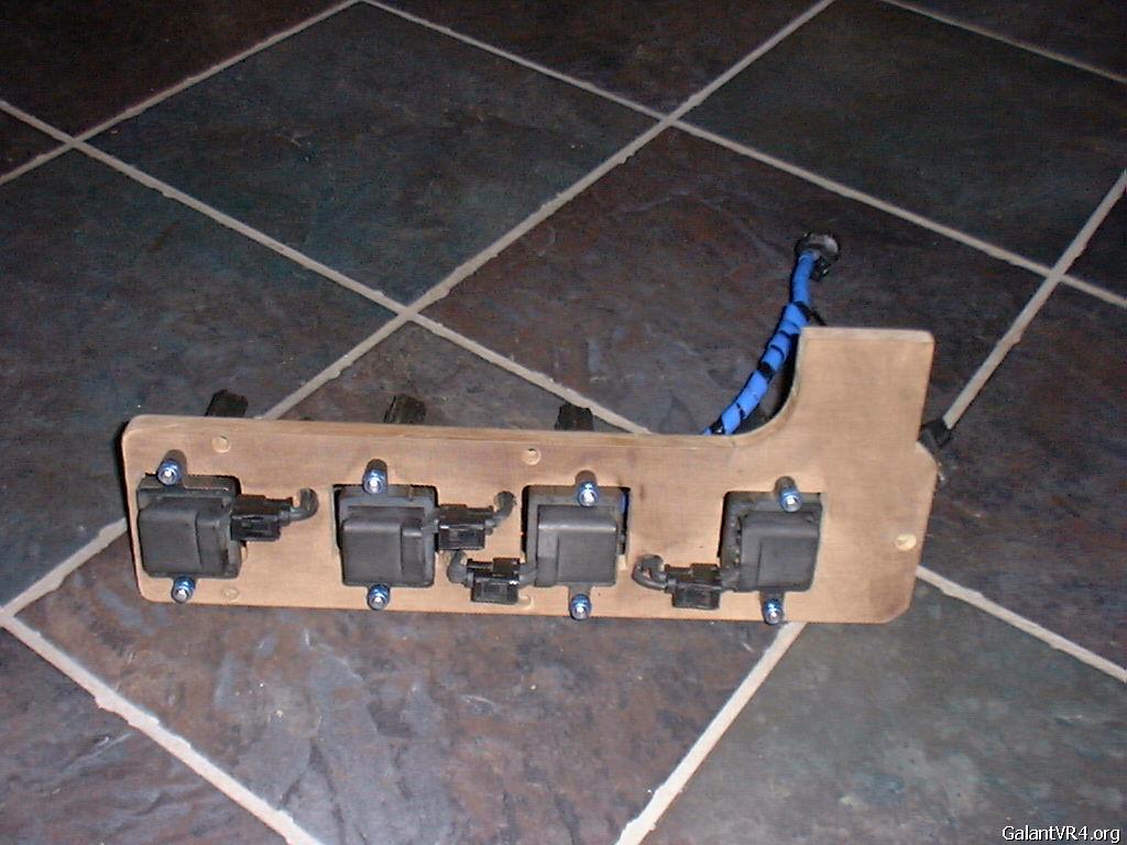

Well I'm going to reveal something else.
If I didn't like Paul I wouldn't have built this because I breathed in enough phenolic resin dust to kill 12 lab rats. Yes Phenolic resin theres only 2 idiots in the world with a COP like this me and Paul. /ubbthreads/images/graemlins/devil.gif
Curtis, why didn't you just use an aluminum or Stainless plate like everyone else? Just curious. Looks great though. I love my COP.
May 4, 2003
11,892
Clarksville TN
It will keep the coils cooler but most people wouldn't pay the price for a sheet of phenolic resin or even know where to get it. This was left over stuff I've had for years and I have to be abby normal. /ubbthreads/images/graemlins/grin.gif

Faustus,
There has been a lot of controversy about COP setups before ... well with the 4G63 engine at least ... coil failure rate seems to vary, but there seems to be very little controversy over the main cause ... EXCESSIVE HEAT !!!
Under hood temperatures WILL NOT just go away because of this stuff, we both know that and in my case at least, keeping them down will require the combined efforts of a large Koyo radiator running Evans NPG+, ceramic coated header pipes, the JDM vents and a 50/50 alcohol/water mix injected right after the turbo.
I DO NOT think there can be much doubt however that the heat transmitted to the coils through this stuff will be SIGNIFICANTLY less than the heat transferred through any other metal.
Maybe the COOL factor itself will have some cooling effect ... /ubbthreads/images/graemlins/smirk.gif
I hear ya on this. I made 2 spacers out of this sh*t and decided I'm not making any more. This stuff dusts like no tomorrow and it's so bad for you. Water jet cut from now on...

Faustus,
I spend some time on the FSAE forums and there was mention of "coil dwell" being a factor in coil life. As near as I can tell if the coil dwell (which I believe is somehow related to the charging time) is not correct the coils can barbecue themselves due to internal heat buildup.
The "coil dwell" is a settable parameter on a lot of standalones -- so I imagine it could be a factor when using mix & match coils from different cars.
