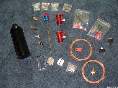

More strange items for Paul. I thought smokescreen and then I thought water injection but there's no pump so that was out. Anyone know wth these are? I don't and Paul's teasing.

Snap! I'll be excited to hear how this comes out. We're set to do something like this on a TDI soon. I haven't seen a propane kit before.

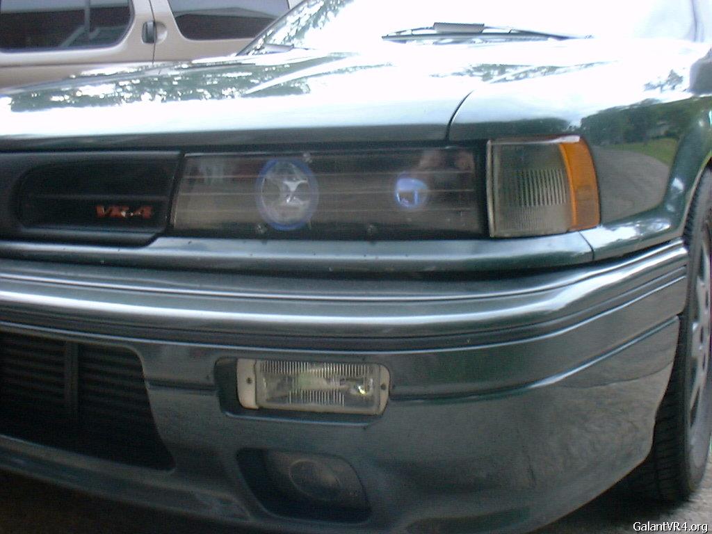

Paul has some lights too from Curtis I think. Modded 93 housings with some internal driving lights.

Nope ... no BBQ ... just high pressure hard lines and solenoids at both ends (one at the bottle and one just prior to the nozzle) so that we'll be injecting propane as a "LIQUID". The subsequent gaseous change to vapour should create some drastic in-cylinder cooling (not to mention the fact that LPG has an Octane rating of 110).
The aim is to allow us to run 30 psi through the Holset on "high boost" with the 9.0:1 compression without knock rearing it's ugly head ... low boost for daily driving for those of you that are wondering will be a little less severe ... /ubbthreads/images/graemlins/devil.gif

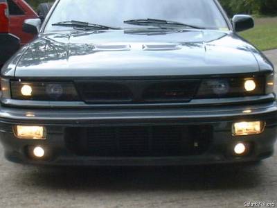

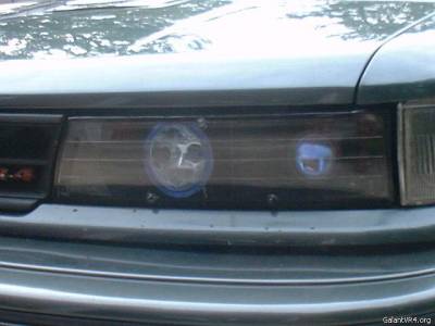

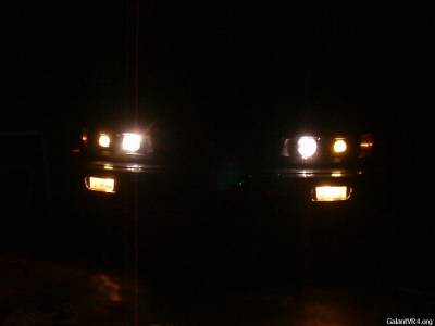

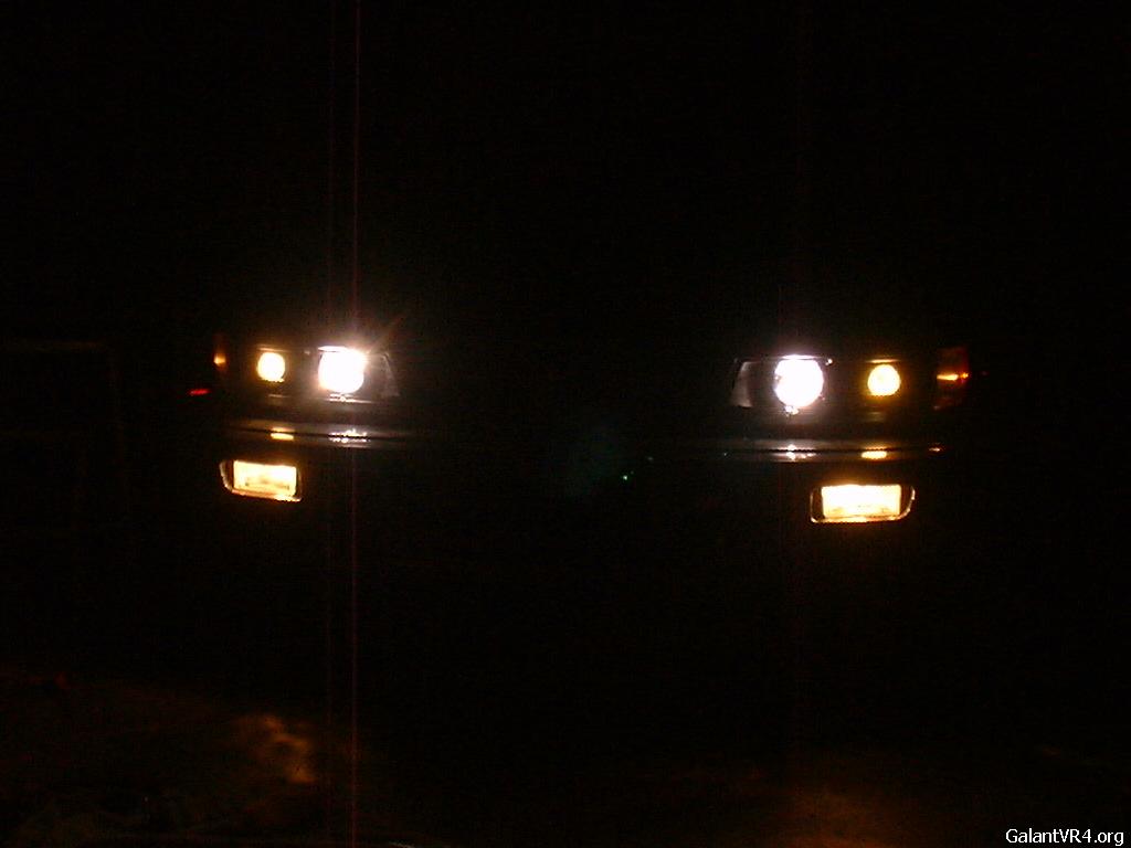

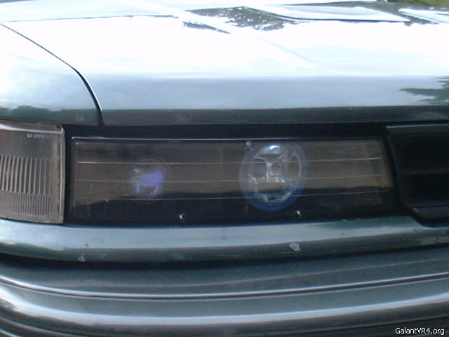

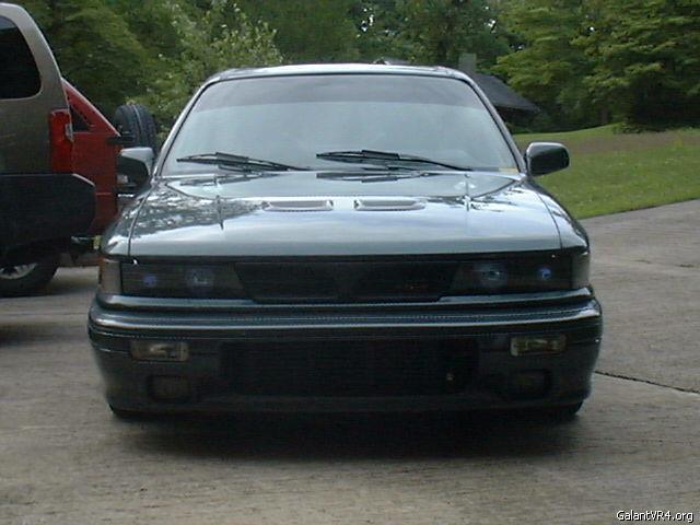

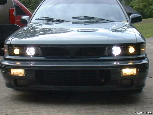

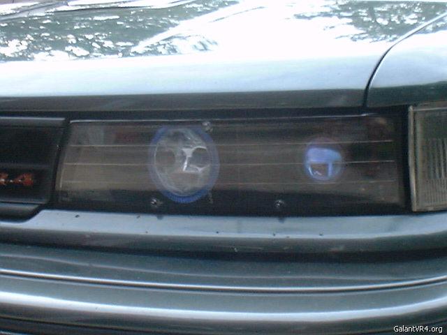

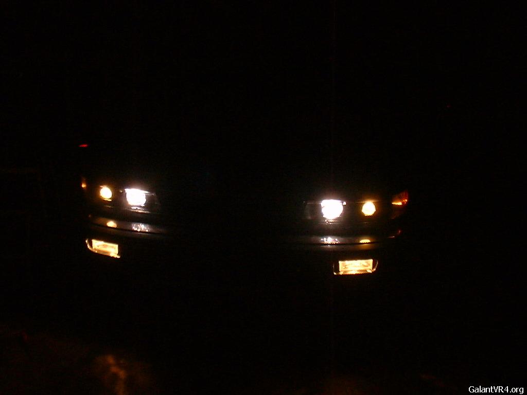

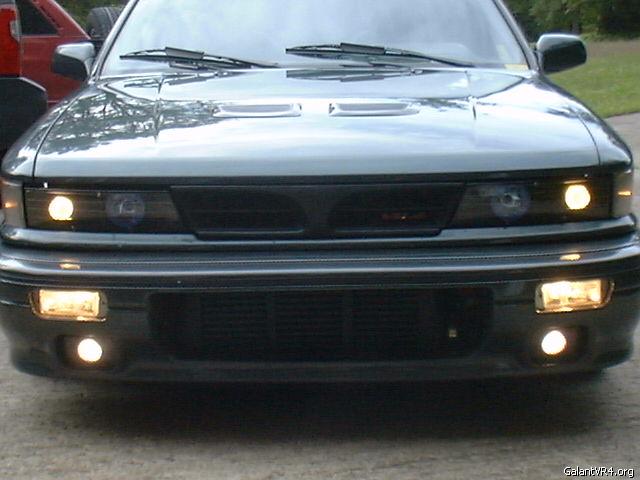

The completed lights are on my car for aiming purposes. Sorry for the bad pictures but I need a new camera. For the guys that want these and have already contacted me. I need 93 lights and a set of 92 backplates along with the fogs that I can get or fogs of your choosing with my approval first . This will be a one at a time deal it took 3 days to get these done not counting all the running for parts a pieces. I just graduated school and haven't even had a day of to sit on the deck and drink beer. /ubbthreads/images/graemlins/grin.gif
Sorry Paul but I had to show them off in there completed form. Plus I wired up the angel eye's and the strobes today just to see how they worked OH man Hong Kong Police are going to be watching you.
Enjoy Curtis
