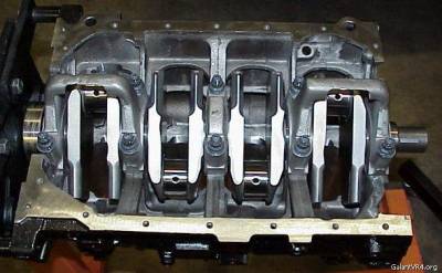

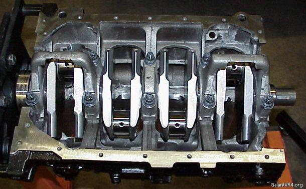

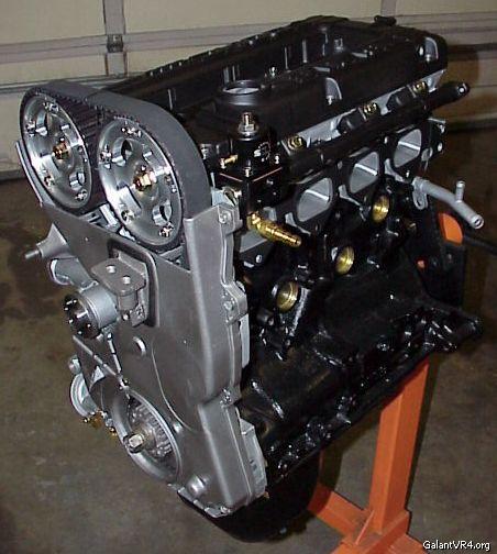

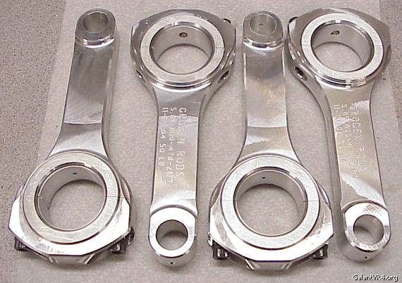

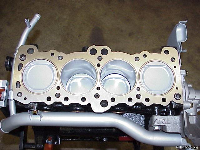

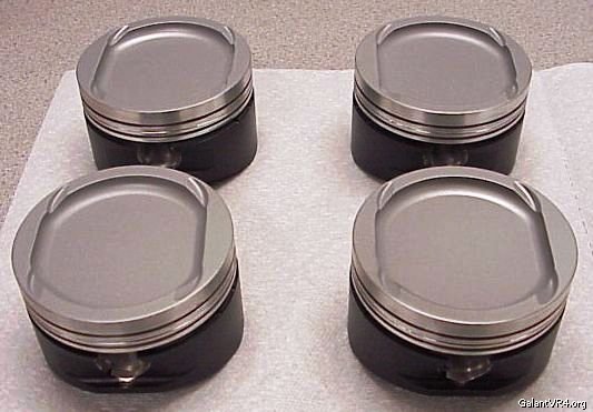

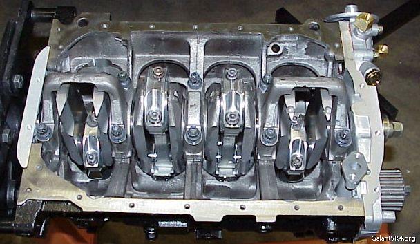

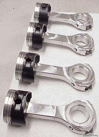

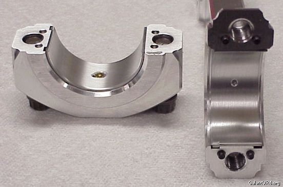

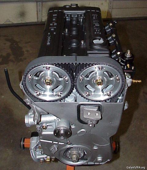

Found these on the hard drive ... some pictures of the engine build !!!
Groden Rods
Ross Pistons 9.0:1
Wedding Day preparations
Are here's the lovely couple !!!
Knifed edged crank
Coming together
Ceramic anyone?
Mean f*^ker
See that little sucker on the end ... he in for a hard time !!!
The man from Del Monte ... he say YEEESSSSS !!!

Hey Paul
I thought aluminium rods were a "race only" deal -- strictly for the fellows who tear down their engines on a frequent basis.
Are the Grodens made of a fancy fatigue resistant alloy?
Cheers, Ted
cheekychimp
Apr 19, 2004
7,333
East Sussex, U.K.
Ted,
I'll be honest ... I don't know. I've heard the same rumours and from people who know far more about engines than I do. I really don't have enough knowledge or experience to turn round to those guys and say they don't know what they are talking about. The man who built the engine says it isn't true. He said it isn't necessary to warm the engine up anymore than you would/should warm up eny engine before thrashing on it. He also said there are people using these who have hundreds and hundreds of Dyno passes (over 500) on them without an issue. I personally think that this is more abuse than they will get from me.
One thing I do know is that the rods don't fatigue, the rod bolts do !!! ... and they do this because they expand at a different rate to the rods. One way around this might be to buy titanium rod bolts in the right size.
Titanium rods might be the ultimate answer but they are ridiculously expensive ... if one day these break, I might consider it. Bottom line is, I spent a lot of money on this engine. Even if it had titanium rods in it, to just run and run and run it and never crack it open for any maintenance is in my opinion asking for trouble. Okay maybe the rods wouldn't break but something else undoubtedly would. I intend to look after this engine. So if I have to replace rod bolts every year or two ... it's not really a big deal.
Time will tell ... if they break, I take full responsibility. I've listened to all the advice and I've made my choice. At least the next time I talk to someone on the subject I can speak from personal experience and not from a "people told me so " perspective. If you don't try, you never know ... right?

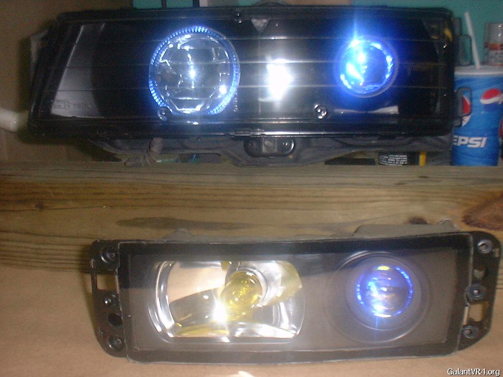

Just when everyone thought this post had died and Paul couldn't mod anything else on the car.

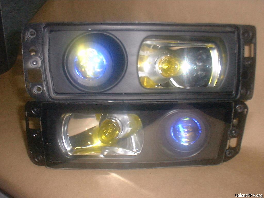

These happened.
I final got a chance to finish work on his clear lens JDM fogs today. The projectors were replaced with some coated ones that were a little smaller and match the ones in the headlamps. The center sections of the square lights were also replaced with some that have an amber globe on them. The main reason is because Paul informed me that the Hong Kong Police force is cracking down on HIDs and this is a way to camoflage them. I still need to cut the cover for another light and do some finish painting but they turned out quiet well.
I wish I had a JDM bumper so I could install all of these to see what they look like as a set.
Since Paul isn't at home right now most of you will see these before he does. /ubbthreads/images/graemlins/devil.gif

I can do some more, kinda like these but the clear lens wouldn't be a problem.
I told Paul that the stuff I was building for him wouldn't be duplicated, me being a man of my word it want be so don't ask. Thats the beauty of doing one off custom stuff your guaranteed not to see anyone else with the same thing. Like the pictures of the JDM car with the flares and the mucho wide tires and custom brakes and the headlights I built for myself, the headlights where the front signals should be, the chopped rear bumper, dual exhaust, etc. etc. etc. . Muhahahahaha /ubbthreads/images/graemlins/devil.gif
Isn't Paul the Hong Kong Police force /ubbthreads/images/graemlins/smile.gif ?
