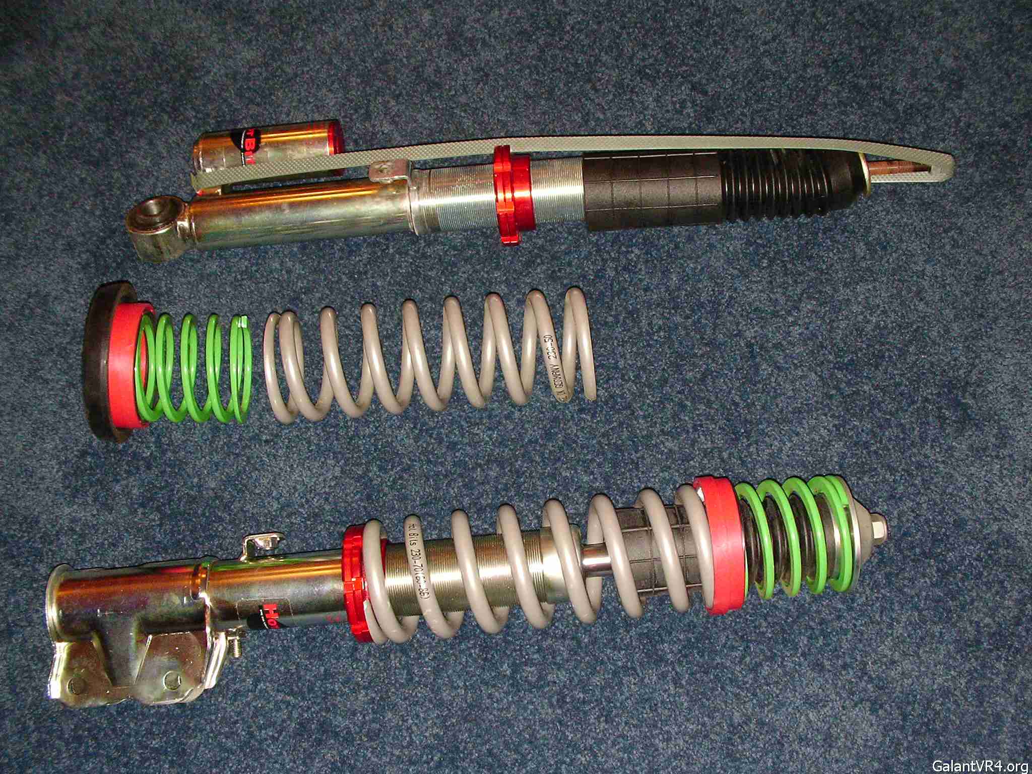

A few more pics ... nothing too exciting though ... I need to get Al to post pics of the VGA screen and mini-itx computer with solid state drive !!!
This is the Hotbits rally suspension ...

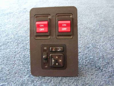

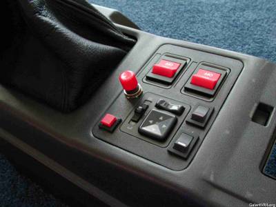

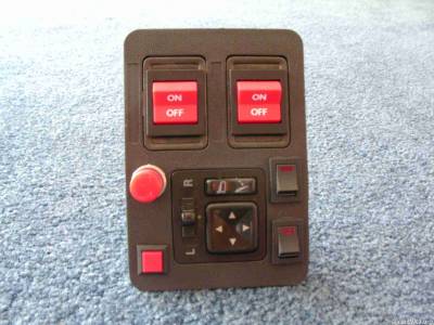

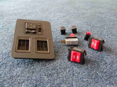

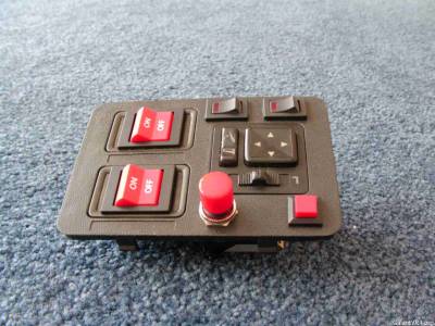

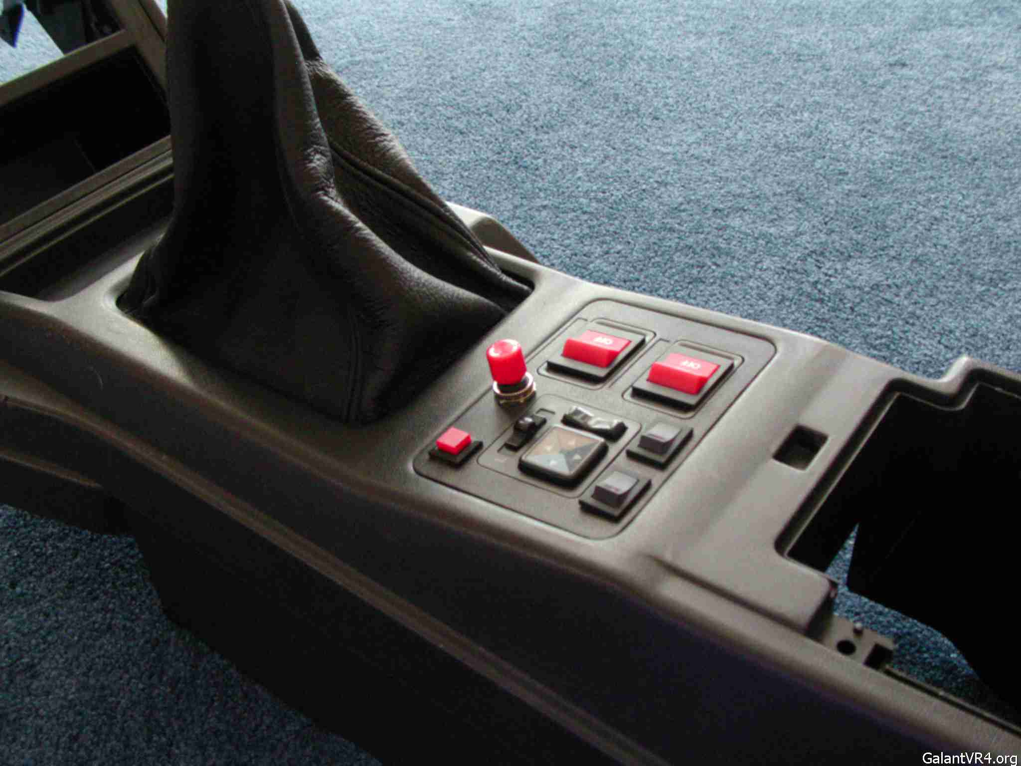

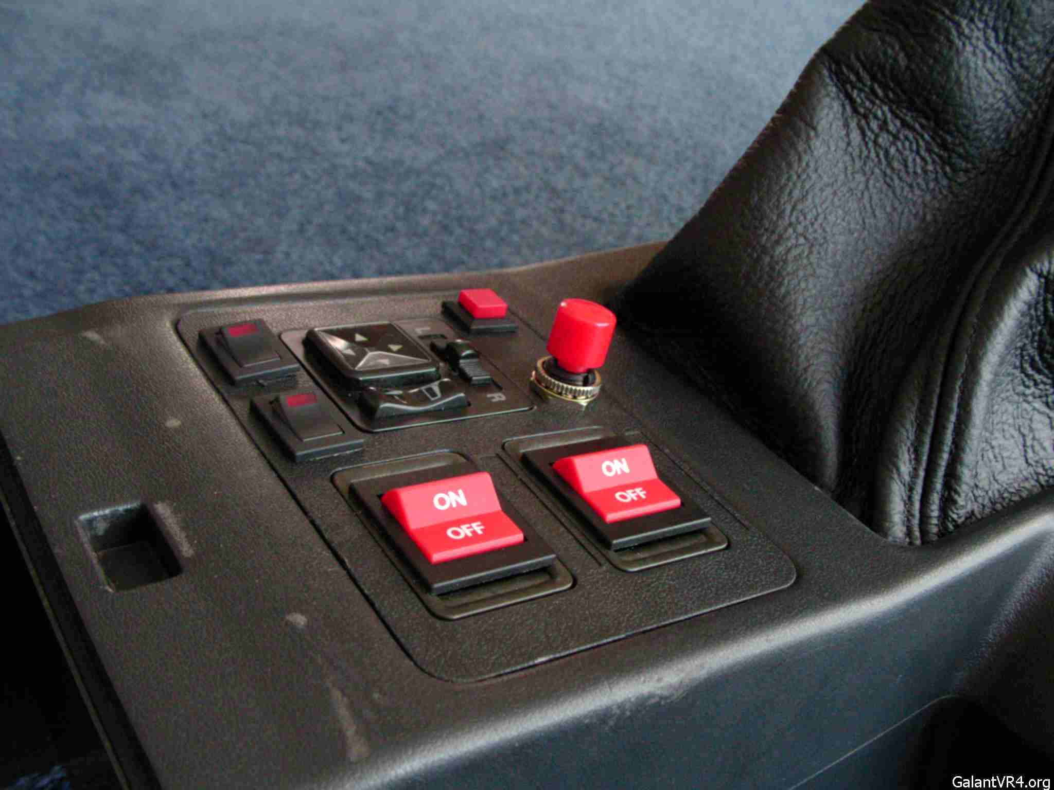

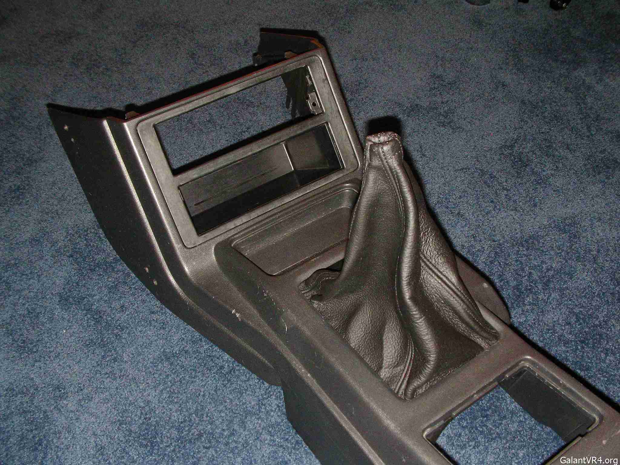

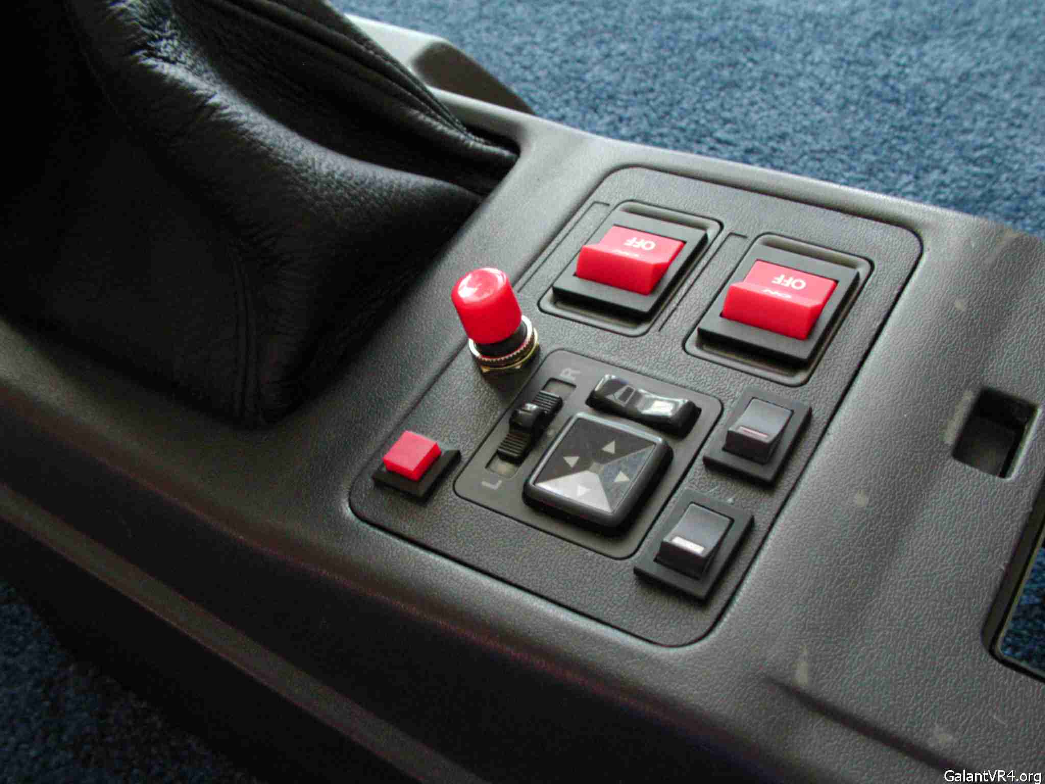

So how do you revitalize an old switch panel like this with some new switches ... /ubbthreads/images/graemlins/idea.gif
First of all, you need to cut those useless coin holders out and put something more functional in them ...
Then a little bit of work with a stanley knife and a drill and voila ...

Looks good Paul! I did the same thing for a Dejontool MBC I had, it had a switch going to a solenoid that would turn the MBC on or off, it gives a very clean look doing it like that. People didn't even notice it (mine were black).

Paul,
I did consider going with black switches. Do you think it would look better? I don't think there is much I can do about the large rocker switches that go in the coin holders, I could only find those in red. But the holes for the others are cut now and it wouldn't take much to switch those over. I just thought a bit of red broke the monotony up a little. Sometimes you can have just too much black !!!
Paul.

A black permanent marker will change the color of the switches. Take your time, get it even, and it will look like they came that way.

Paul,
Paul.
Black may look a little cleaner, but I would leave them red. It will make them easier to see in the dark.
