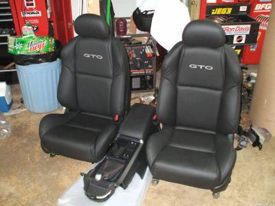

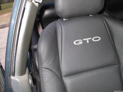

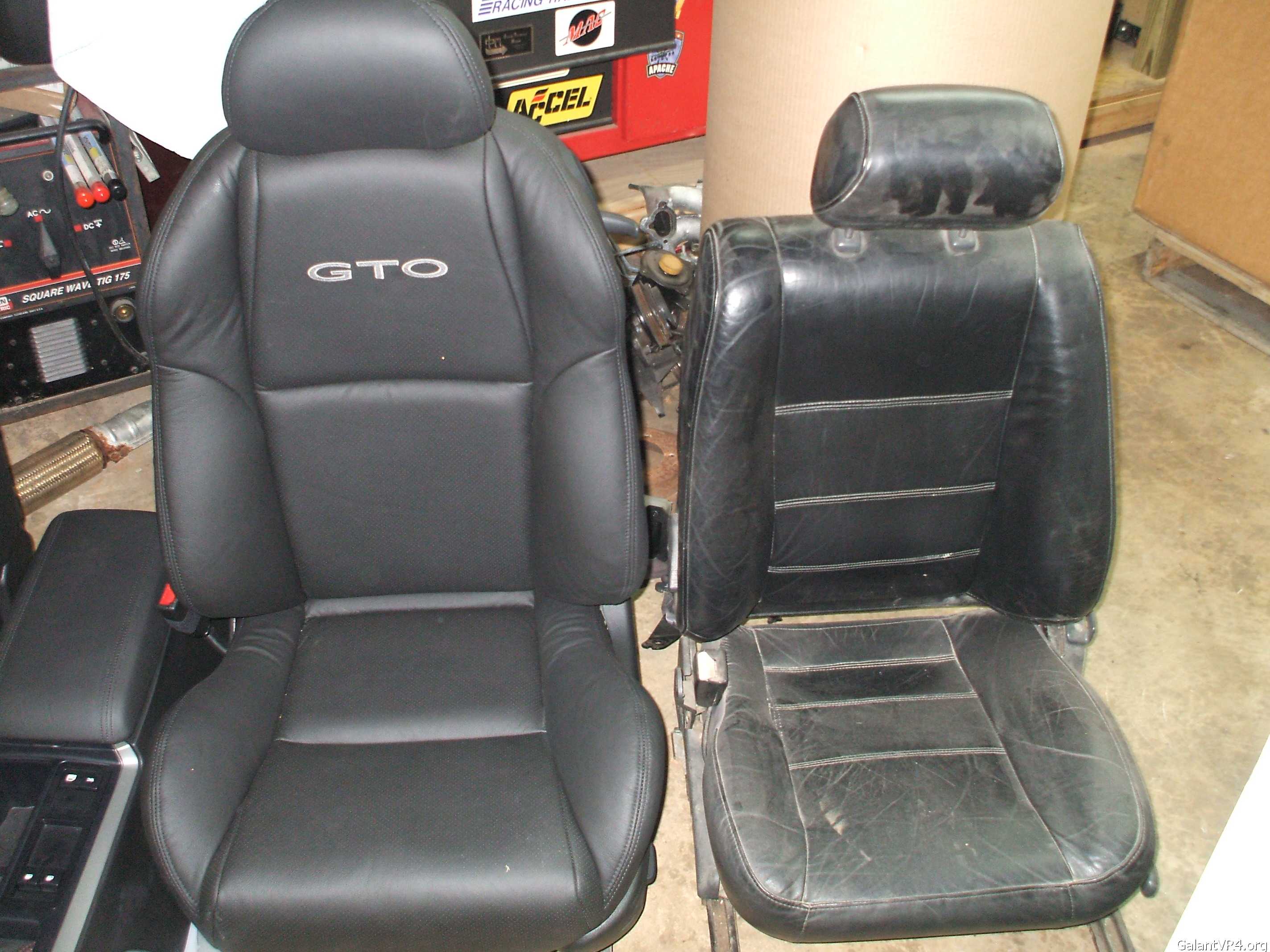

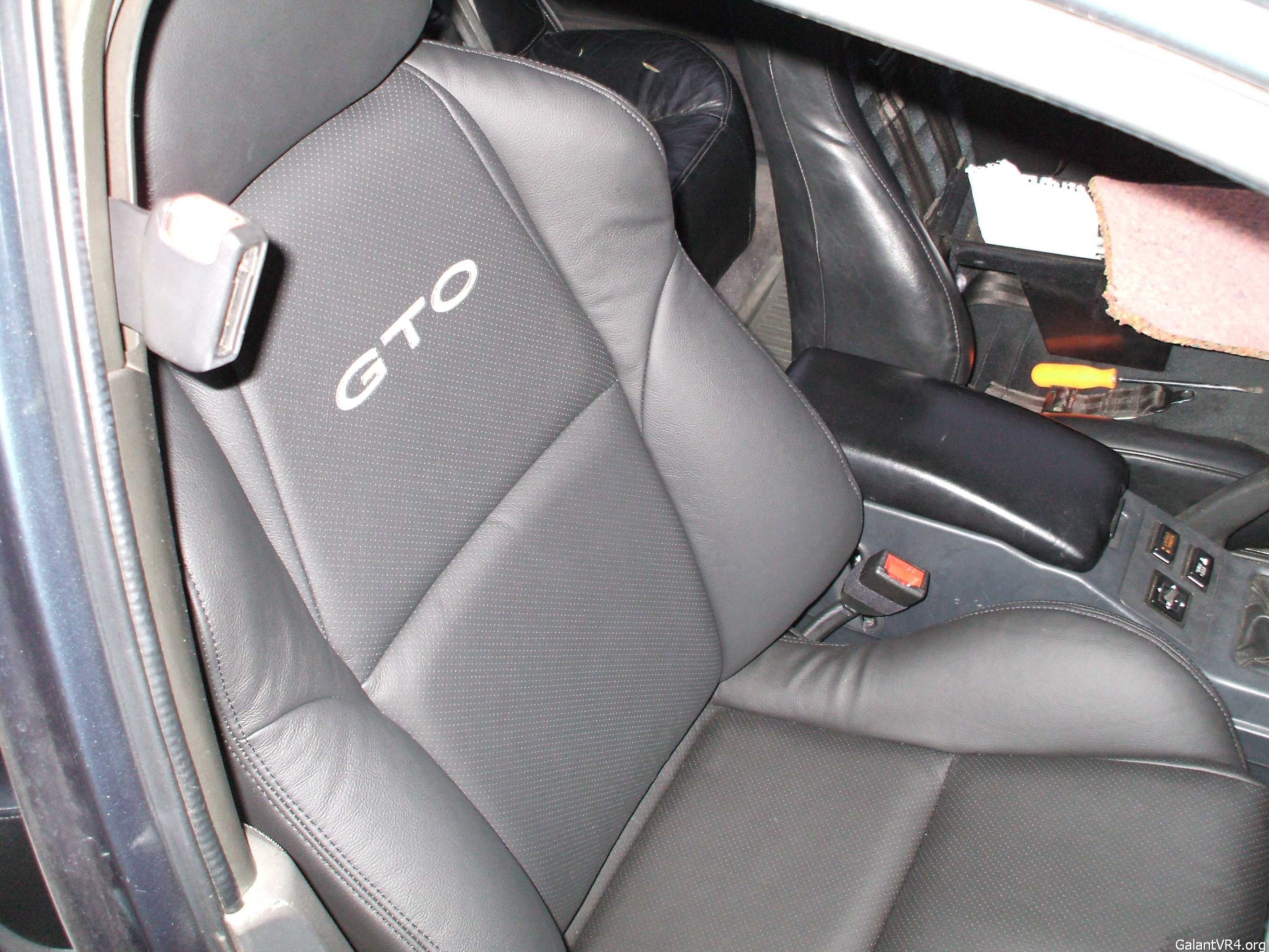

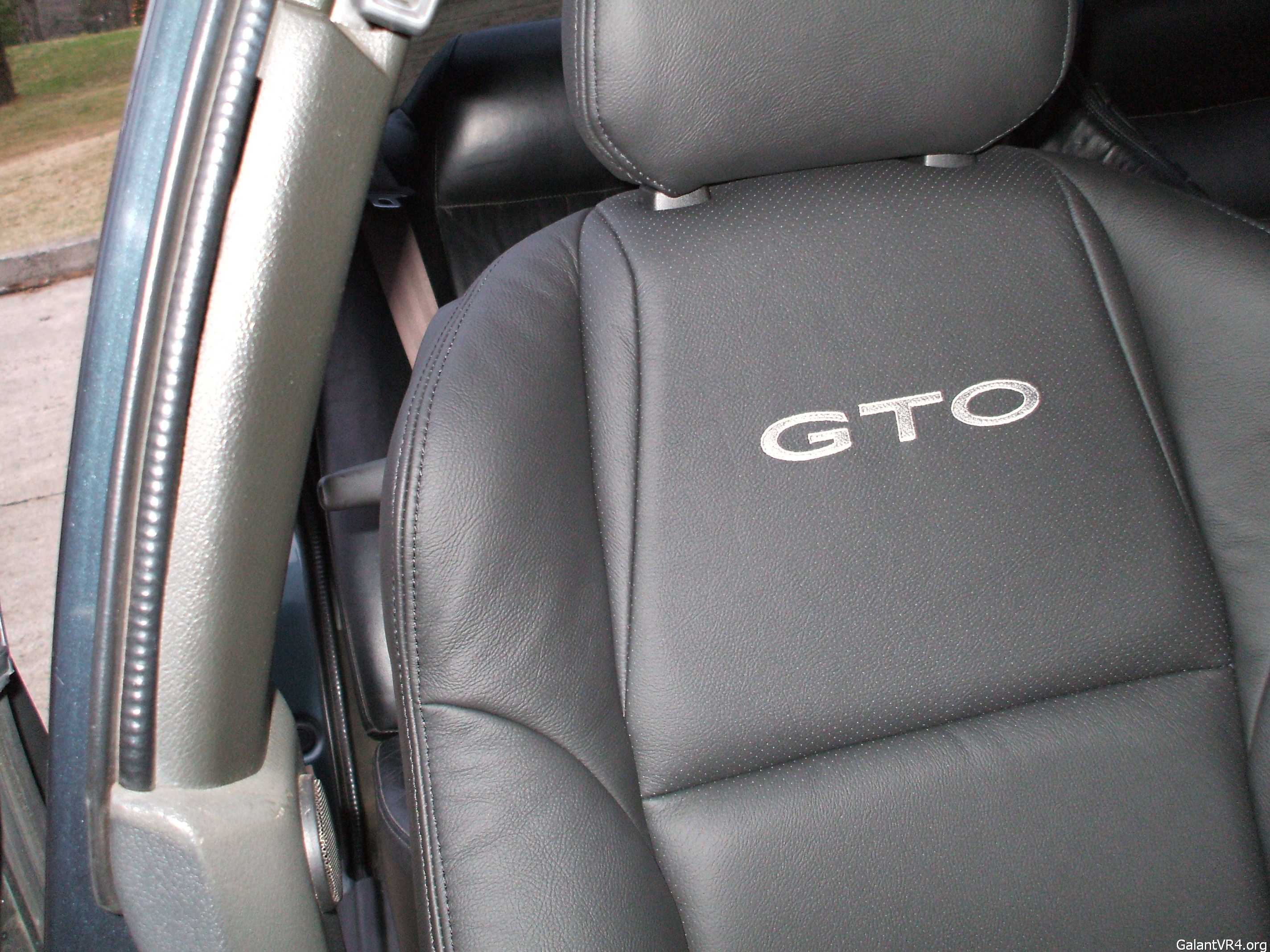

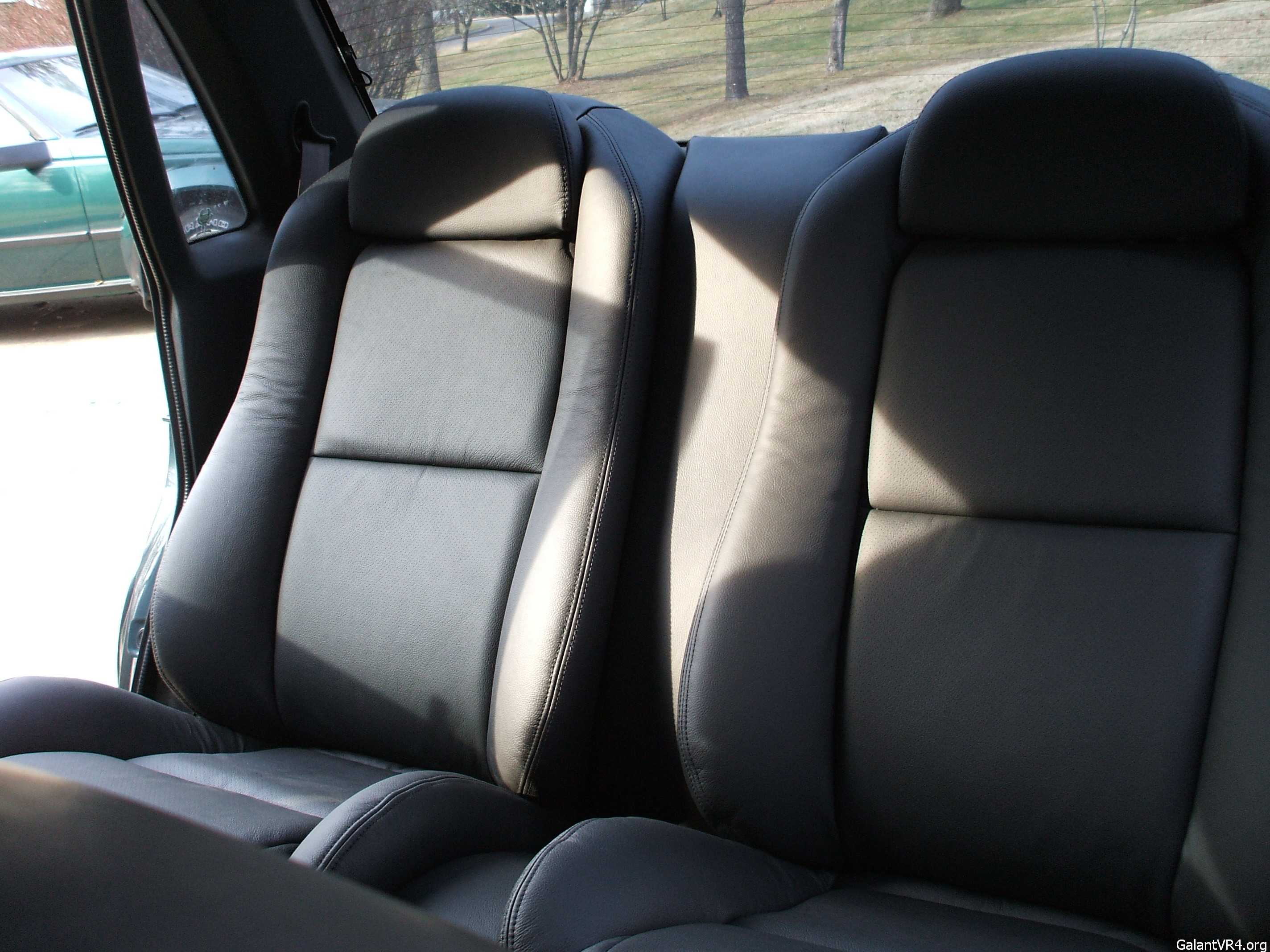

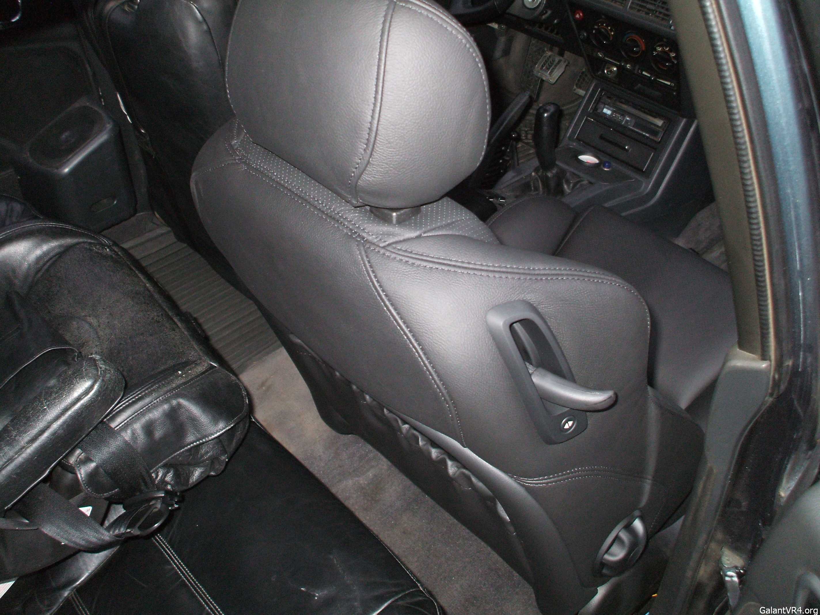

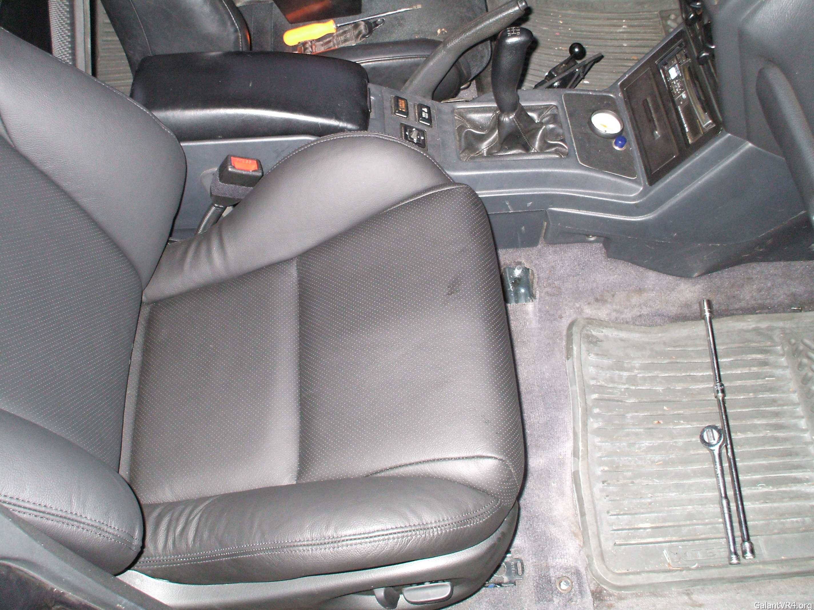

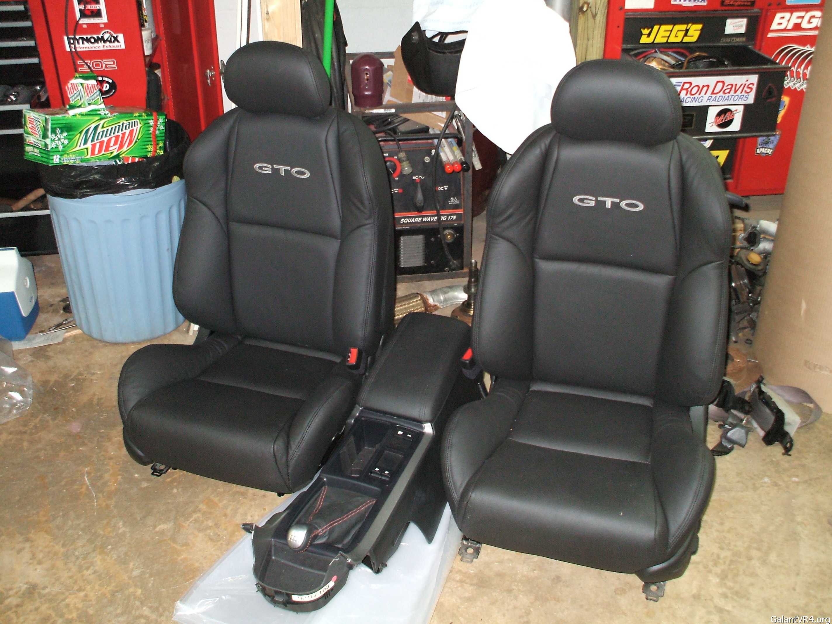

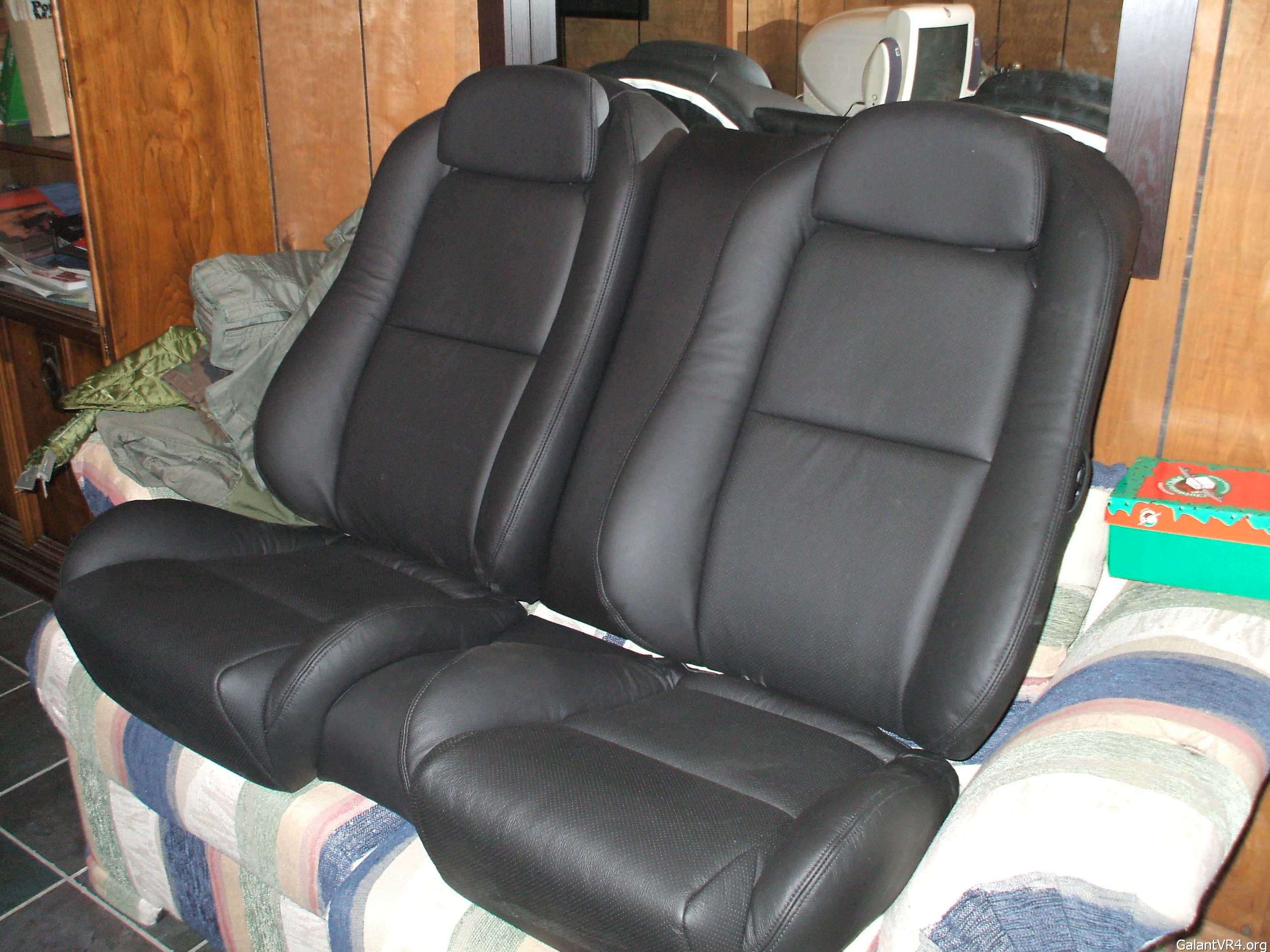

I just got back from picking them up. 50 mph on the interstate no fun. You owe me steak and beer Paul.
As you can see there not much bigger than the factory seats sorry about the dust.

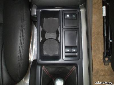

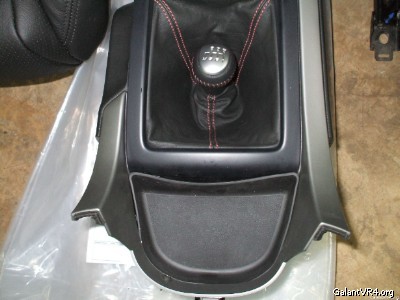

I'll pull the passenger seat in a few days and see how it looks and also the rear. Our rear seats are super thick on the bottom in the aft are where these are at an angle so these will fit really easily I'm thinking. By the way Paul if you can incorporate the center console you'll have the only vr4 with built in cup holders. Don't ask I've already started measuring It looks easy I can take a junkyard center console and graft to the forward section of the GTO and then cover in suede to match. /ubbthreads/images/graemlins/grin.gif.

Things come up. The centre console thing Curtis mentioned. Crazy? At first sight yes. But consider this. Go look at a GTO in your local dealer. Look at the handbrake. Curtis just confirmed that it is in exactly the same position as the one on a JDM Galant. This console is the same width as the Galant's but about 4 inches longer. It will take up a little extra space on the transmission tunnel to the rear but seeing as the rear bench is being converted to two seats only, so what.

If it gets parted out I have dibs on the seats. /ubbthreads/images/graemlins/devil.gif By the way the leather shift knob assemble will have to be fabed with a used talon shifter handle to work itshas a two bolt flange on it. If you don't want it I'll use it. /ubbthreads/images/graemlins/rolleyes.gif hint hint just messing. Its weighted and if we get the gto e brake will match perfect except it will have a sixth gear on it. Something to dream about later on. As for the install I've been measuring and pricing. I went by the dealer this morning. Priced a matching e brake assembly. Paul its $85 for the lever and the tech wasn't sure about the brackets underneath. I now have the wiring diagram of the seat so It just got easier to power it up.
Now the funny part. I don't know exact numbers that Paul payed for the seats and or shipping from the junkyard ( I know it wasn't anything close to this) but from the dealer here goes. The front seat covers not to include headrests $1426 each thats $2800 total. The rear seats are $416 for the back and $612 for the bottom times two for each side. The back center didn't come up but he figured it was a few hundred then the seats them-self he said would probably be well over a grand for the foam and brackets. The power motors which I think there is six of are around a hundred a piece. He said the arm rest would probably be around $1000 complete if you had to buy every piece. He did say that the seats direct from the factory would be cheaper as an assembly but they didn't come up on the database. But he said from them that what we got would have been close to 5K. If you want to use the factory gto switches in the console I have to hit a junkyard and match up some gm harnesses that will plug and play.

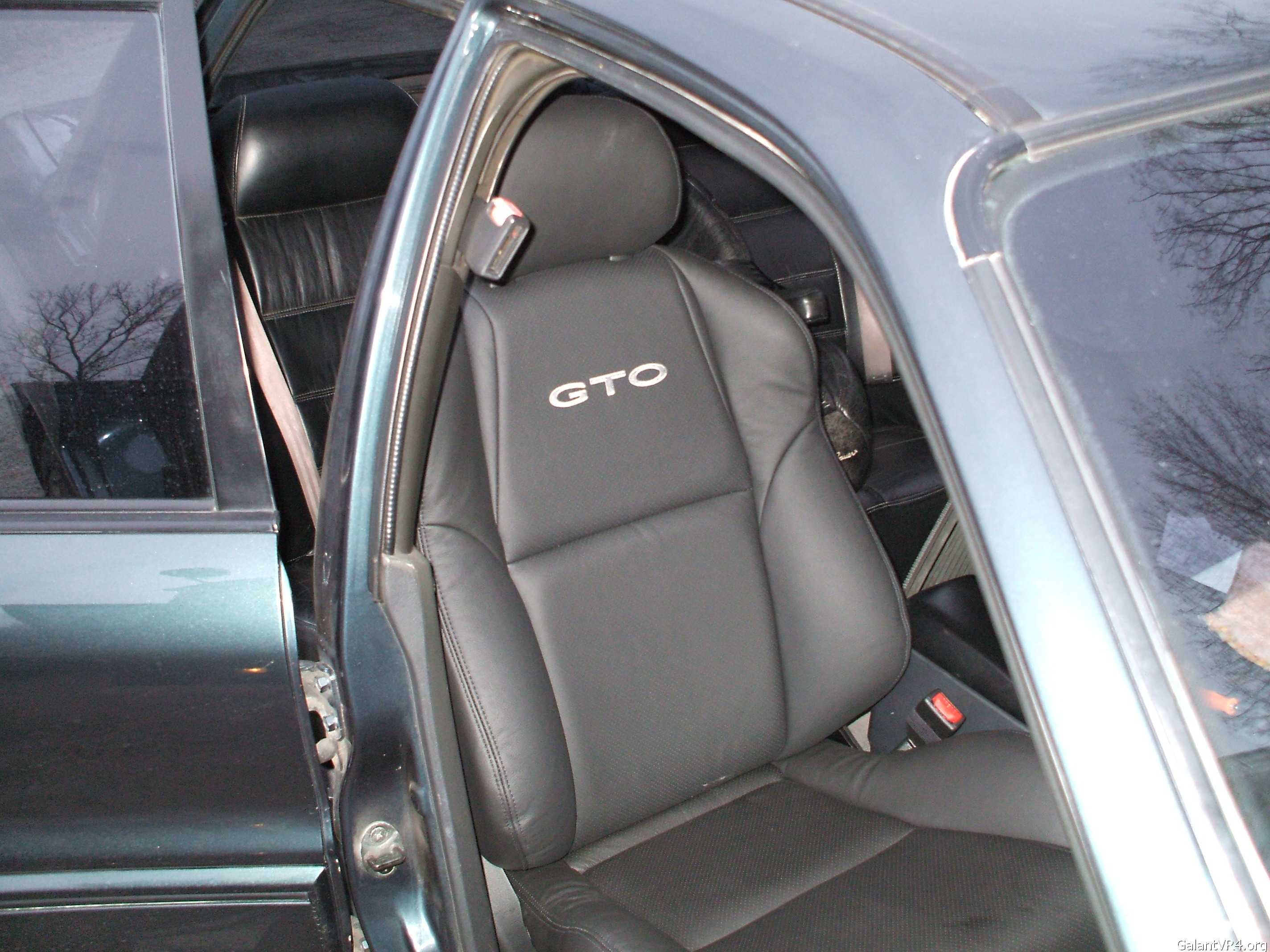

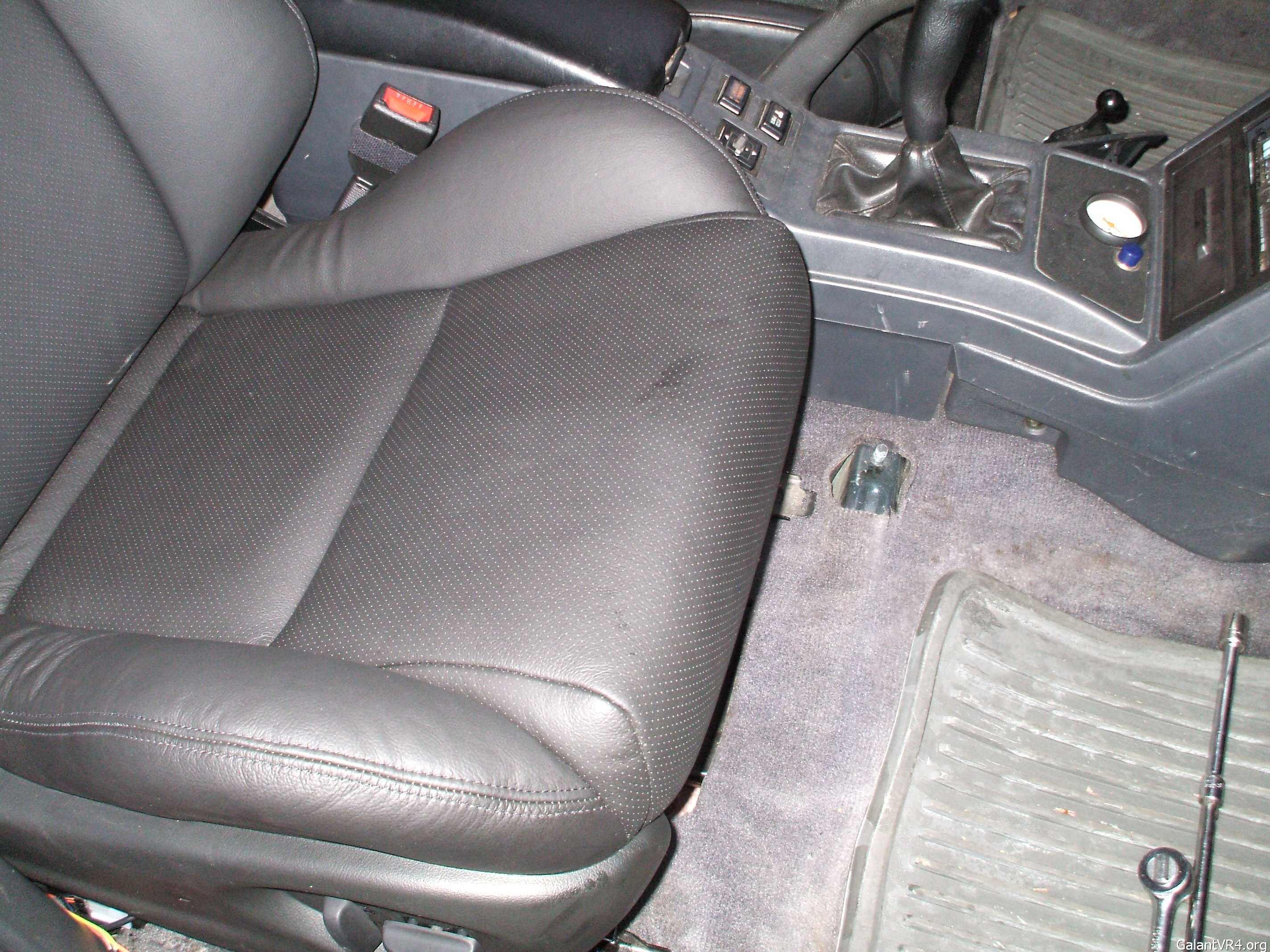

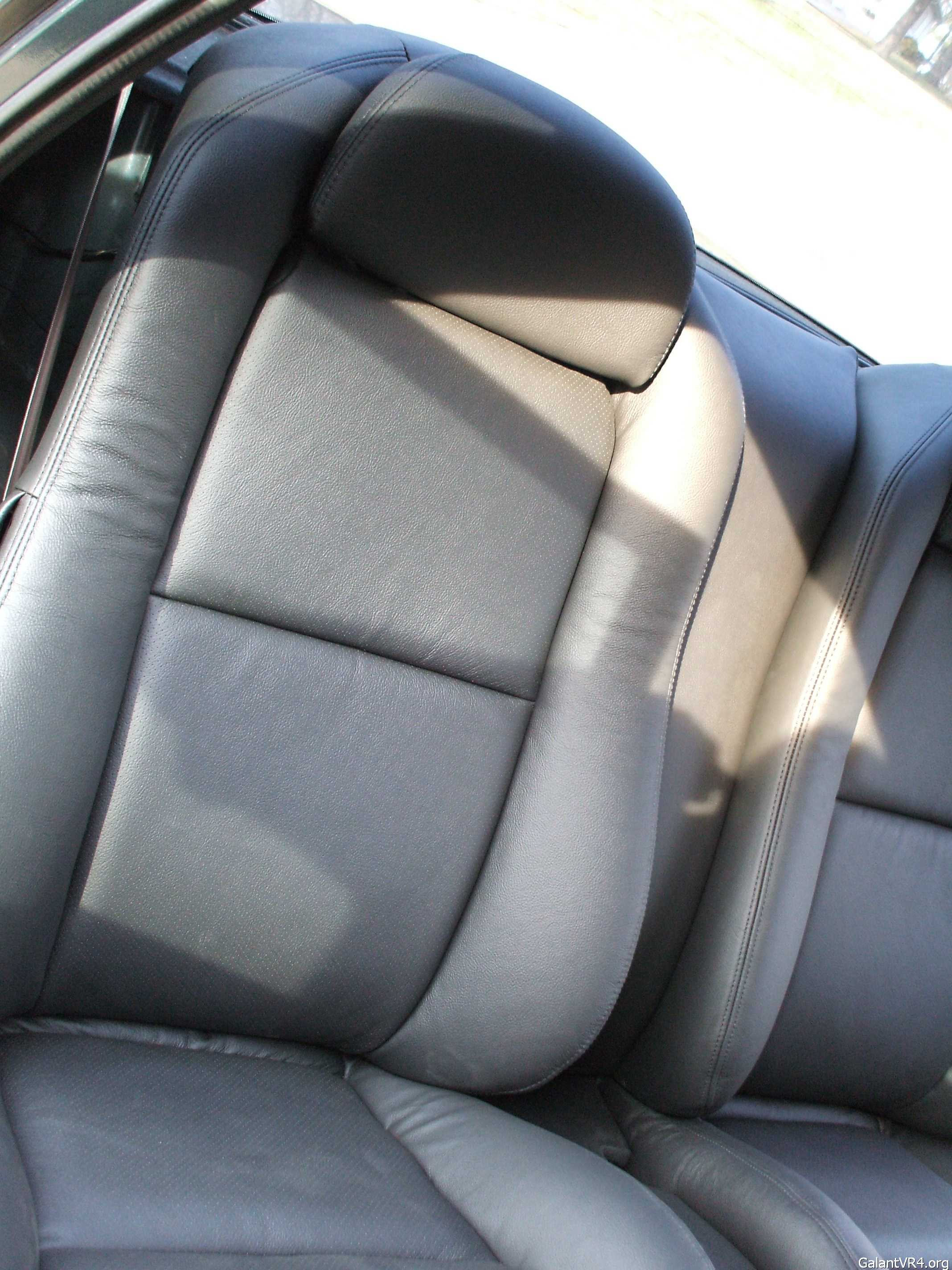

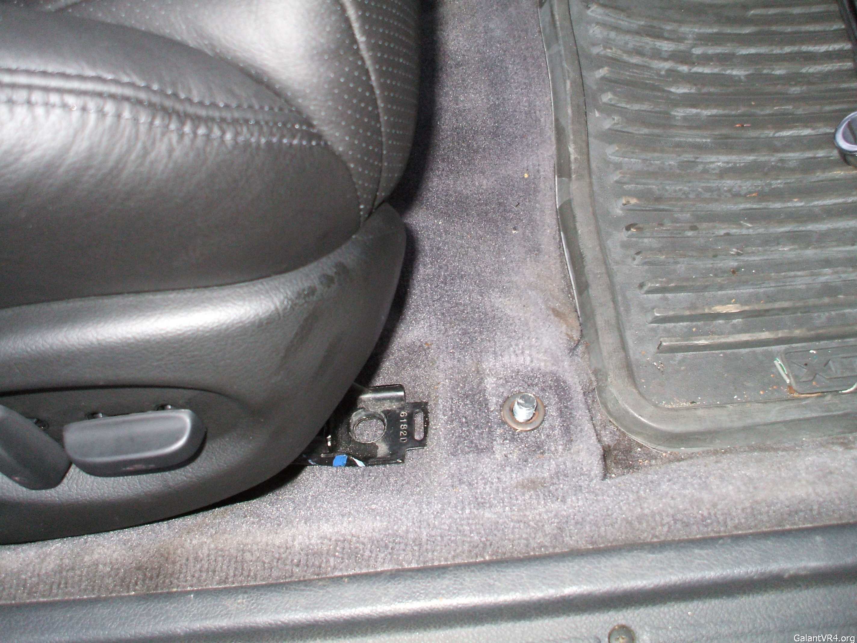

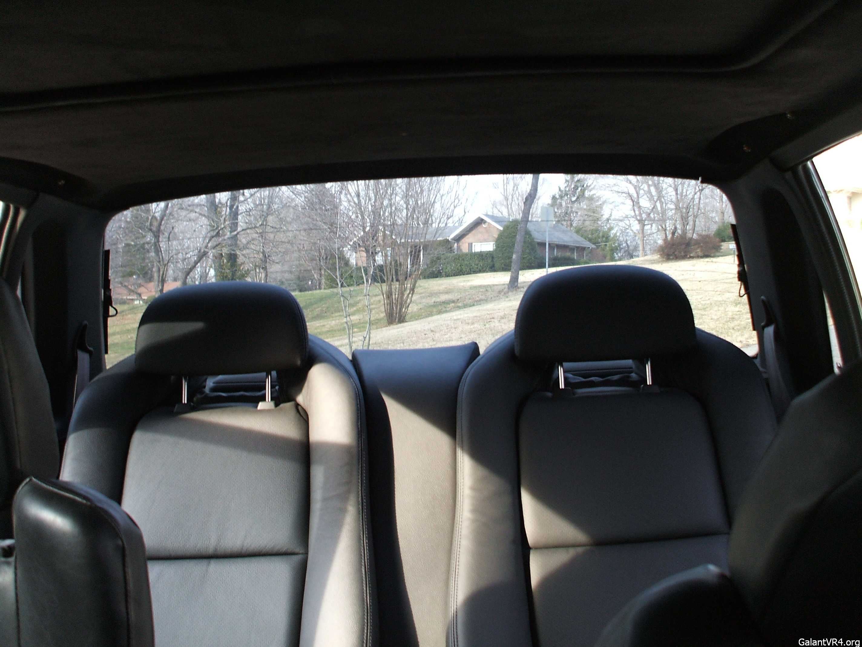

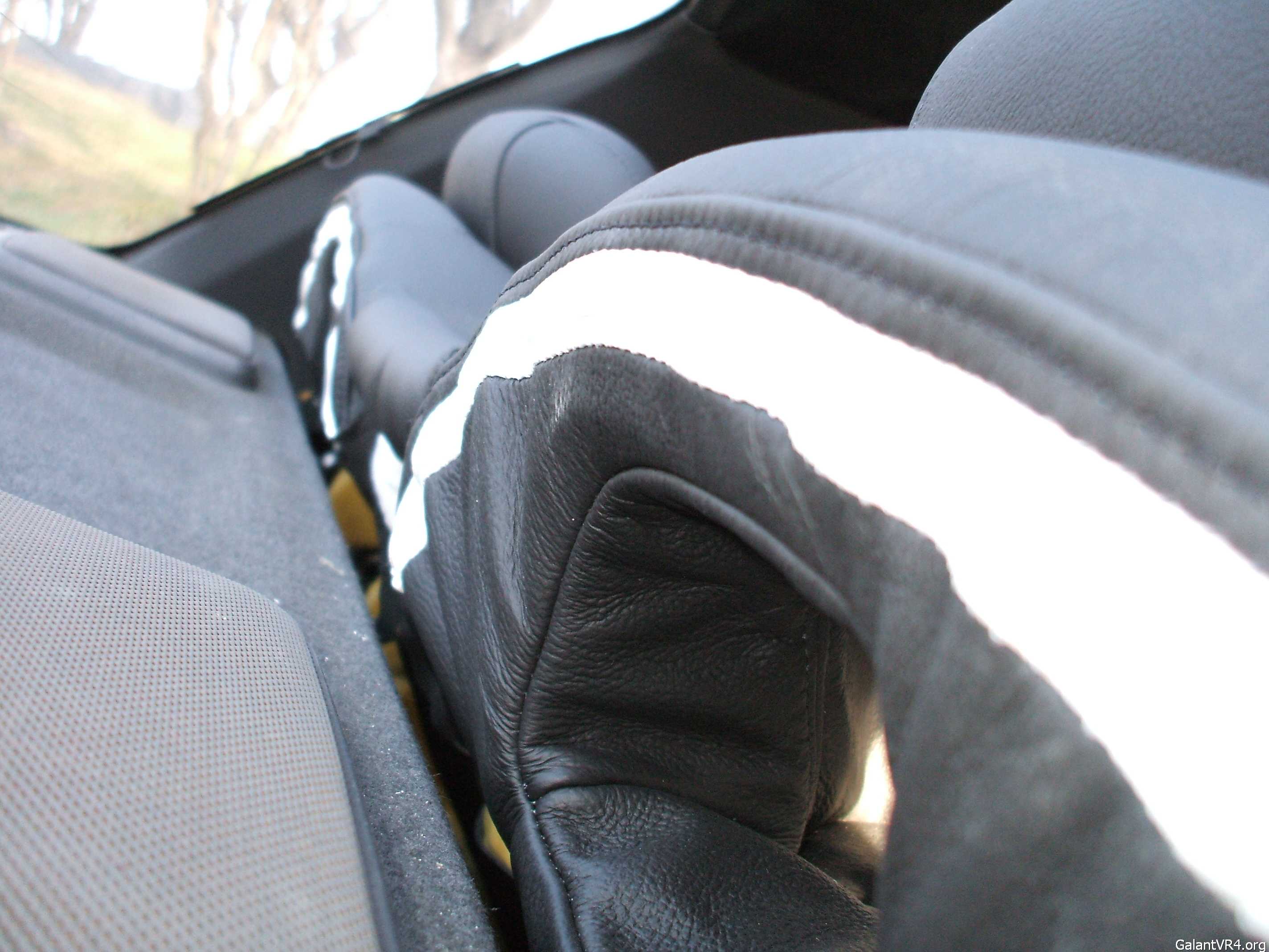

Ok for fab work to the seats for the rear......NONE....They work.
As for the car about an hour and thats it. For the tops Ours have hooks that stick out on the support that holds the package tray. Paul cut them off. Then after you get the seats you'll have to cut 4 small rectangles out for the factory GTO tabs to lock in. As for the bottoms theres to hooks that will line up with two holes you'll have to drill from there you could buy some rivinuts or just get untder the car and weld a nut or just run a bolt through the hole and have someone tighten it. As for the bottoms the factory brace in our cars line up. The problem is that the clip locks in the GTO seats are wider than ours so you'll have to build some small boxes with thin steel and rivit or weld in place these will give support and give the seats comething to clip on. Our resident junkyard guy could cut them off of the GTO in his yard to make life easier but this isn't a big deal.. Done there mounted now what your left with is two voids on the sides. Which have air spaces going to the trunk will help on letting sound and air pressure out so the subs don't rupture the deck speakers. Plus 1 on this. As for the coverings a stereo shop over there that does fiberglass could do it or I can see if I can get it done here with the guy with the zapco hemi magnum I met last week. Then cover in suede to match your headliner. You could use balsa wood or the aluminum honeycomb to save weight and strenght to the fiberglass. Hook ups for electronics could be there inside storage what ever you want could be done its a good sized area and could get as elaborate as you want. Or say piss on it and just cut a piece of carpet to match and attach to a piece of heavy cardboard or aluminum that is cut to fit. Let me know what you think on this one. It really should be done after the seats are in your car so it flows and matches perfect to your installed height etc.
The package tray works fine which I was afraid of the only visual problem I see if from the rear where you see the zipper you could die the fabric or just build a panel with two arches and cover in suede. After we get every thing finalized I get a few extra yards of suede so everything can be covered and you'll have extra.
Now for space I'm six foot and I climbed in the back and had a sit down. Almost wanted a nap. Pleanty of space and are sitting at the perfect angle. /ubbthreads/images/graemlins/devil.gif
Before you ask the little pockets on the outside edges hold a plastic piece on an elastic string to a child can sit back there and route the belt through it and not rub them in the face. You'll need this in the future.
You owe me yet another steak or one of the patty's pork chops for making me pull the baby seat out. /ubbthreads/images/graemlins/grin.gif Patty's is a place about 75 miles from here in Kentucky the pork is to die for, grilled outside and the size of a porterhouse steak except 2.5 inches thick.
Enjoy Paul.

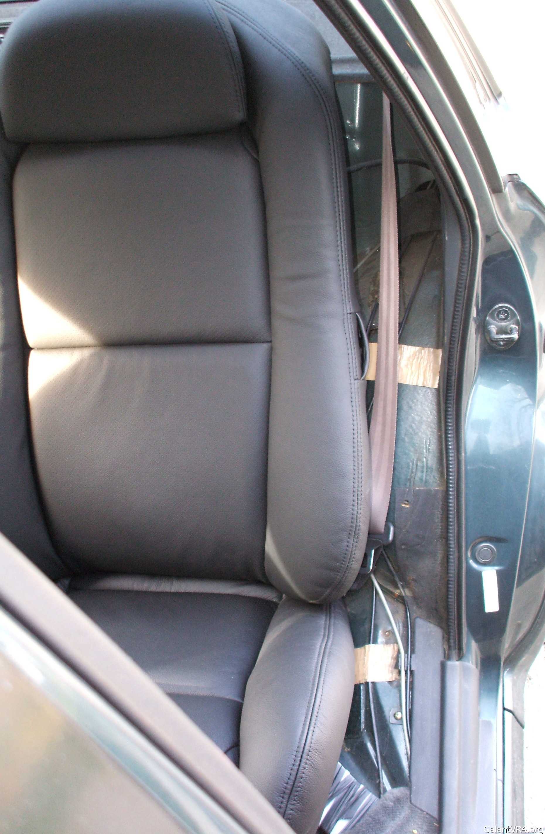

Well nothing to do on my end Paul. They work and fit perfect. The problem I had with the crx seats is there so thin from top to bottom I had to raise them and there still lower than factory...Well yours are thick and have full motion control with memory recall etc. If you position them just as I have your long legs will fit and nothing will rub. The rears will need two boxes / tabs welded to the floor I would bend a piece of steel and bolt to the floor with a large bolt aand then bolt the frame to them. As for the front drill a hole trough the floor weld a nut on the back side done. The only interferance its the forward mount points as the seat moves forwar the rails hit so You'll have to cut them out and weld in a flat plate to the floor this would help on strenght anyway. To beat it all the handle next to the shoulder that unlocks the back to tile even clears the b pillar there perfect. The console will be tight but I thing will work fine. I would sit the seats in move them as close to the doors and b pillar as posible so the handle doesn't hit mark then drill then mount and then start with the center console. Two or 4 tabs welded/ attached with rivits to the floor with nutplates for the console to mount to is all you need. just center the shifter first.
All of the pictures are of the seats as low as they can in the rear with the front about half way up in normal driving position. The diagram I have has the full layout of the seats these have a memory function for different drivers I think all you need is a switch.
My lab assistant says your spoiled and get everything you want. She wants to keep one for her. /ubbthreads/images/graemlins/grin.gif

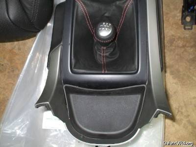

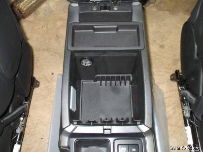

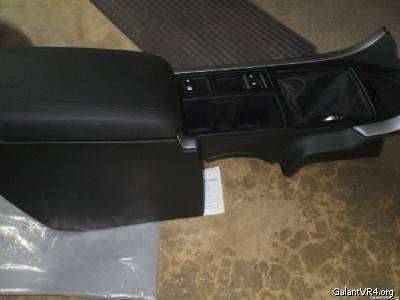

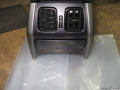

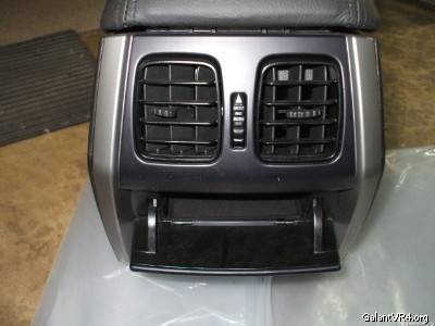

You aren't kidding, this interior is exceptionally cool and I could never have imagined it would fit this good. The seats are actually a godsend. The old seats were far too tall. If I can just mount these on the floor by cutting out the front rail, I'll gain an extra couple of inches of headroom for sure. The only limiting factor will be the cage as that will give less clearance at the sides. Worst scenario is I'll just have to shorten the tilt levers. It isn't as if they'll be used much in a 4-dr!
The centre console is also pretty sweet. I'm looking at getting some pigtails both for the switches and the power seats. It would be nice to integrate the mirror controls and door locks. The console also has some neat storage cubby holes and vent for the rear seat pasengers ... take a look

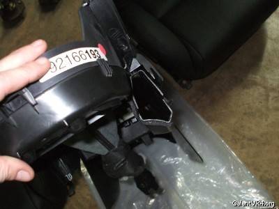

Paul the seat pig tails are there I used the large blue wire (ground) and the large orange (12V) to power them up to move. As for the handle its the only way to unlock for tilt action. Yes it could be shortened or a new one made.
I just tryed to pull up the wiring diagram that the dealership gave me but I don't have a log in or a user id or password. http://service.gm.com Maybe someone here works for GM that would hook you up and get you in or pull up the console and seat wiring and email to you. I'll put the
