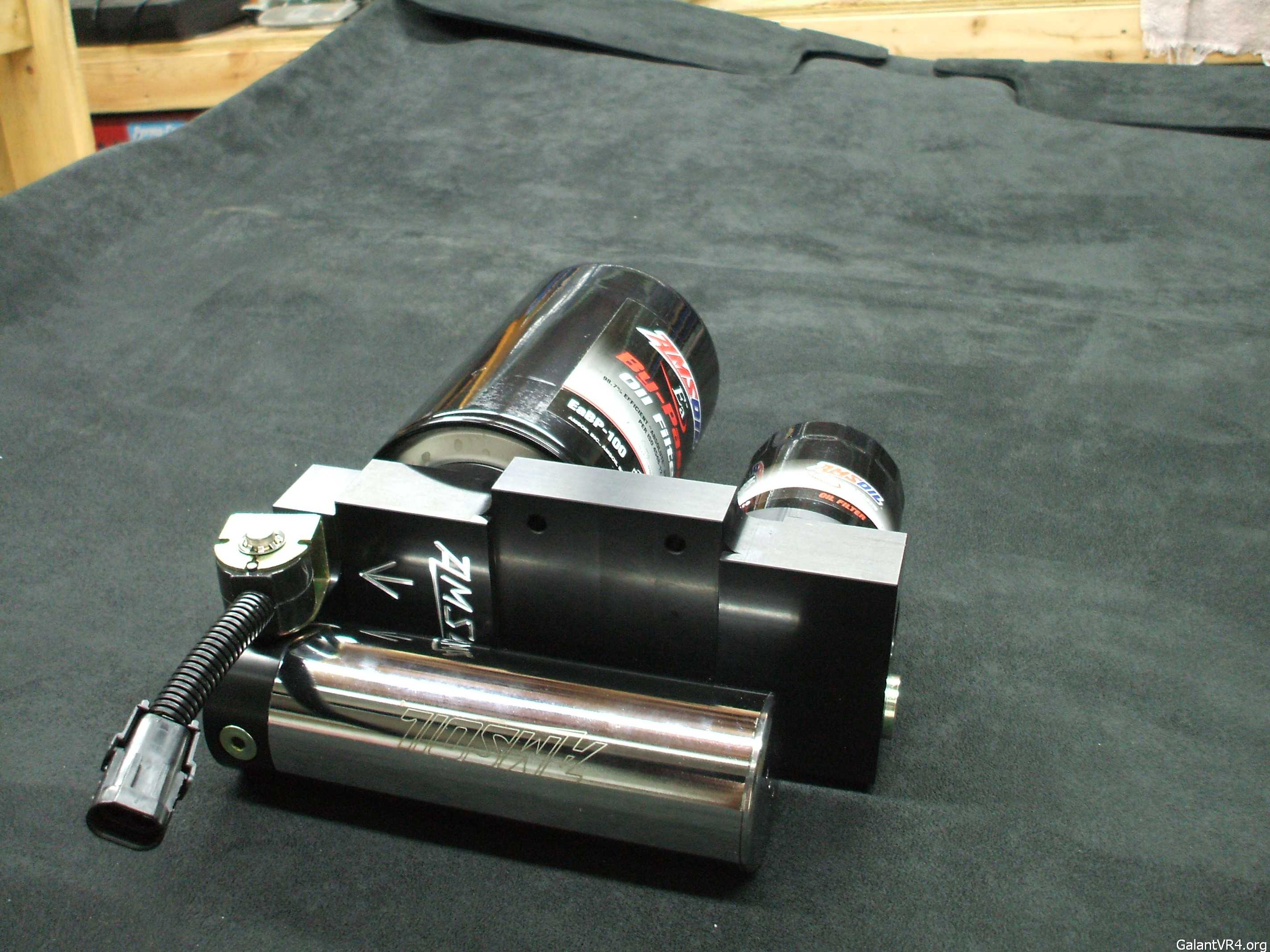

I got the headliner the other day and today all of the amsoil stuff showed up, so I went and picked it up. I pieced it together just for pictures it came with alot more hoses fitting etc. Not sure what all it does but the cnc work is fabtastic. Paul will have to explain the boeing triple 7 oil system he's doing. /ubbthreads/images/graemlins/devil.gif
Merry New Year Paul.
KT
Oct 20, 2003
1,243
Omaha, NE
That looks like Amsoils dual filter set up with the optional preoiler for cold starts. I run Amsoil in my F-250 and Corolla. My next truck mod is that dual filter setup.
