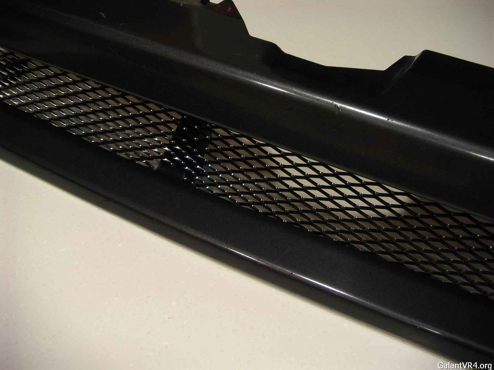

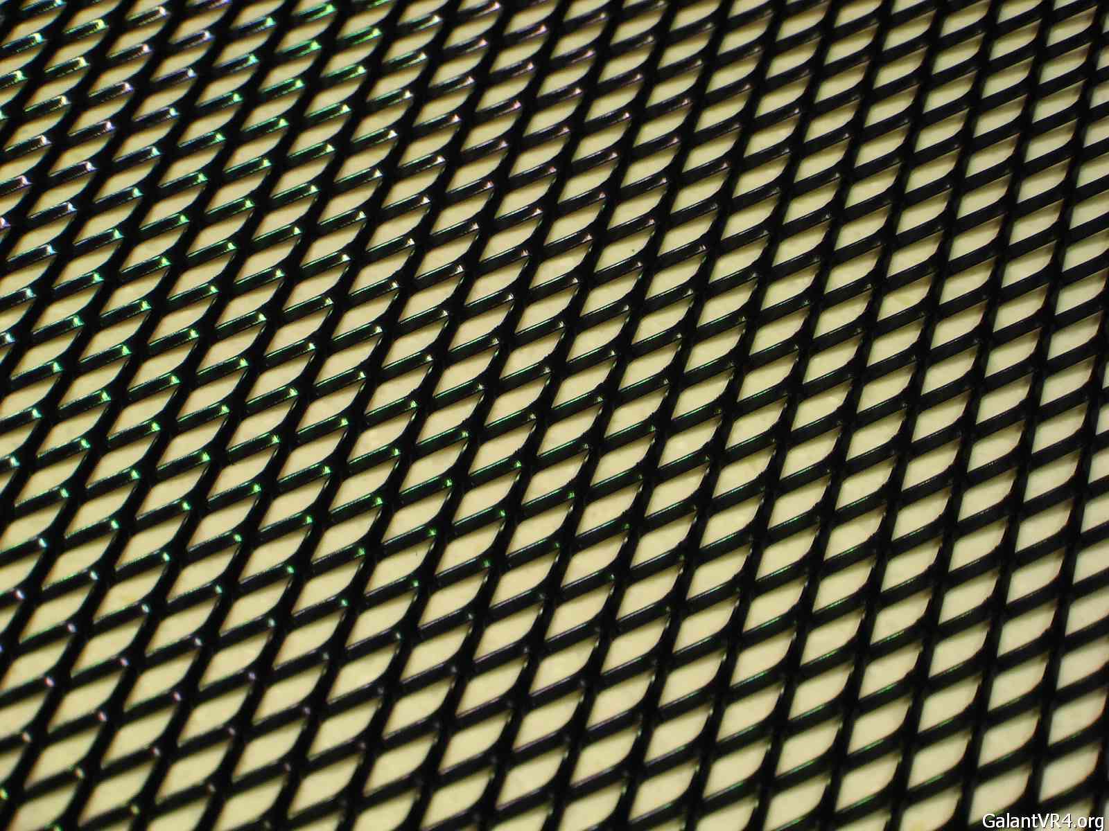

Got some of this to solve my intercooler woes
And it looks pretty good installed on this AMG grille I had lying around

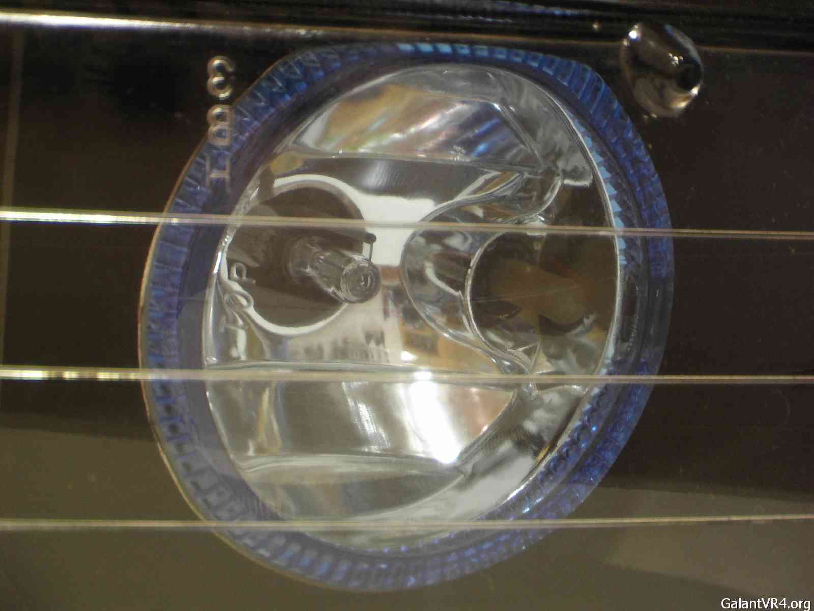

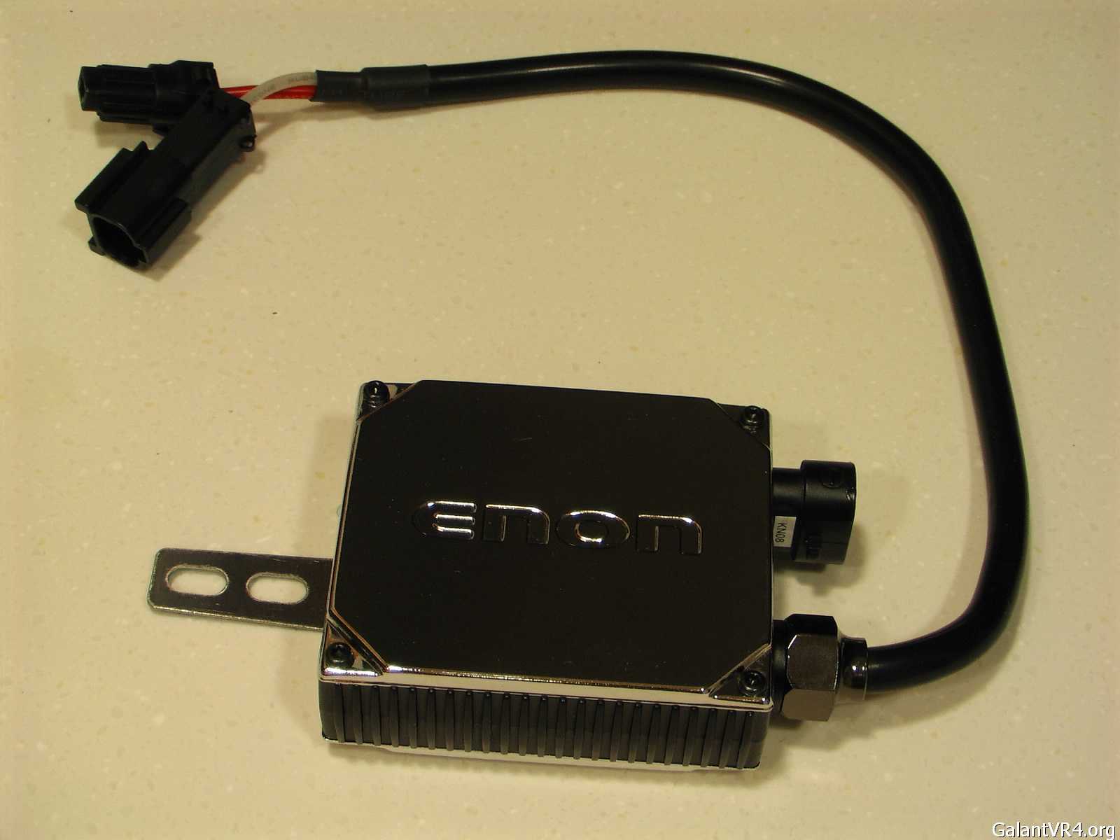

After that I got down to playing with Curtis' lights. Do you think this will be enough firepower?
That's FIVE yes I said FIVE sets of HIDs
HB4s and HB3s for the main lights and projectors and H3s for the Projector Fogs
And they look pretty good mounted
The ballast units are nice and shiny and come with plug and play connectors and nice mounting brackets

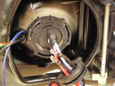

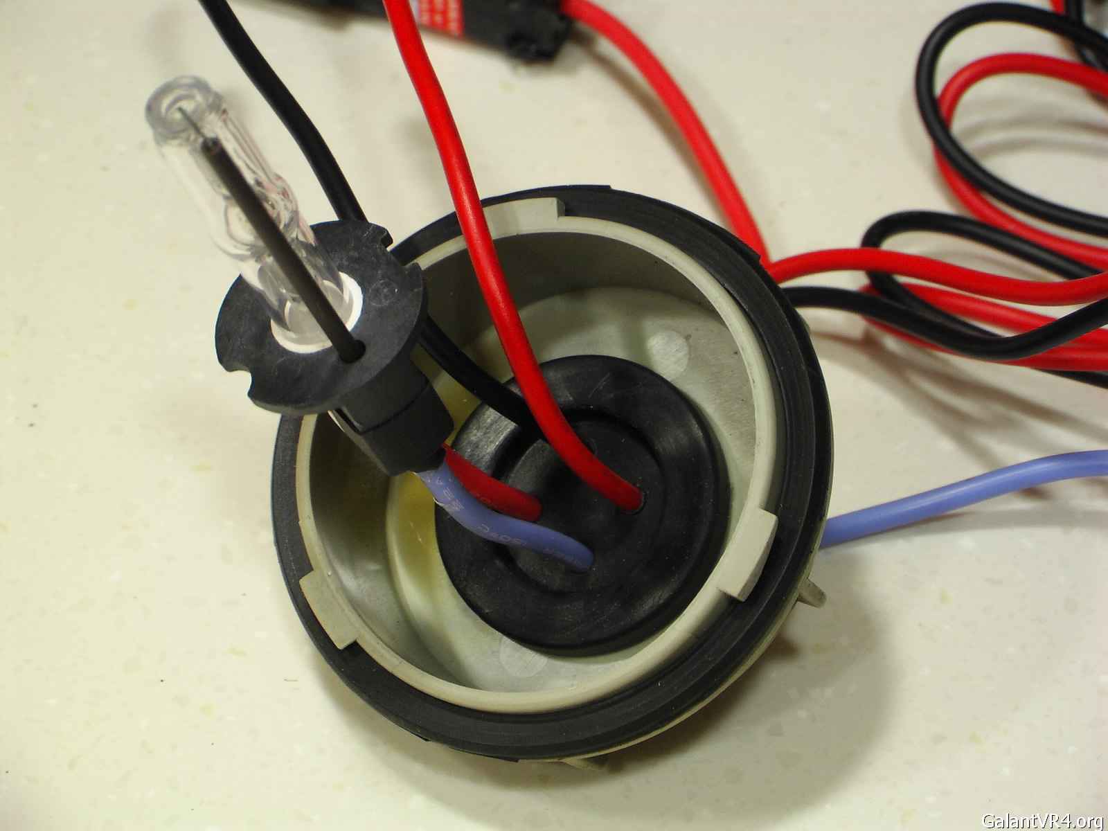

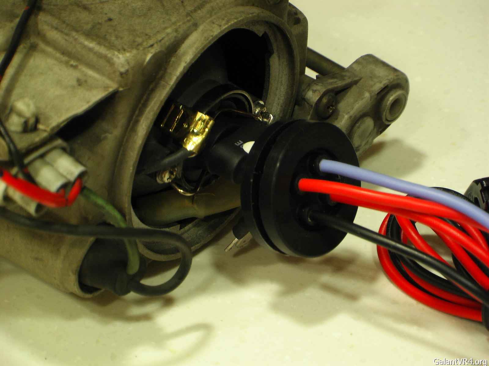

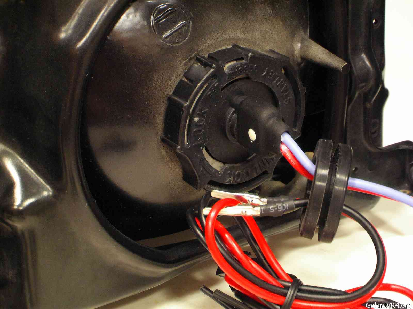

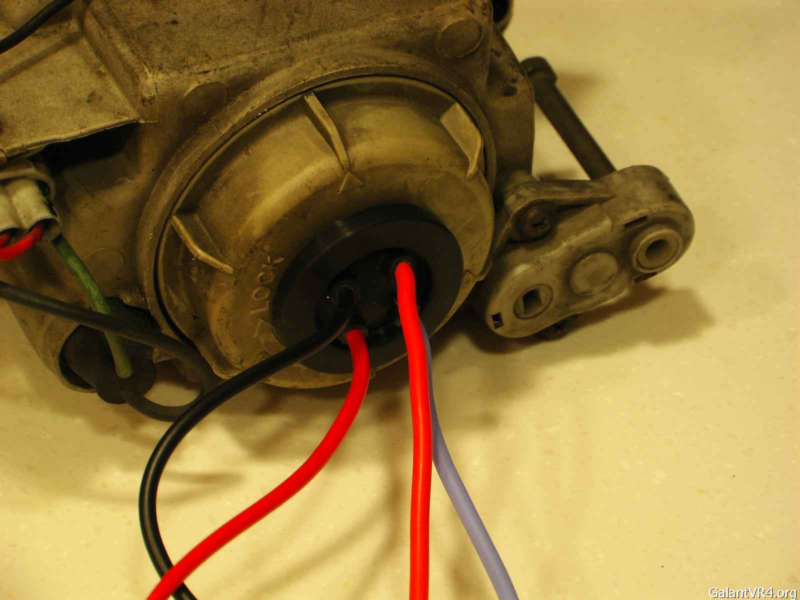

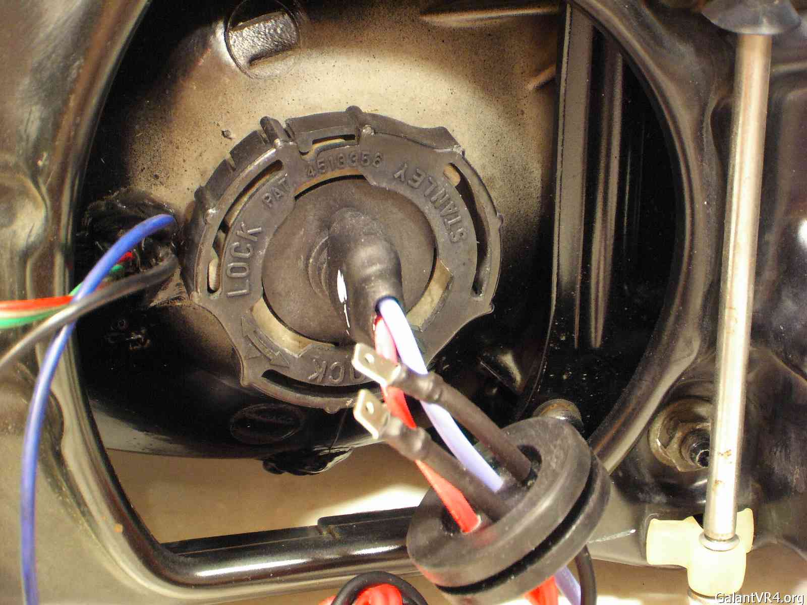

Fitting the bulbs in the Projector Fogs isn't easy. It is a lot more cramped down there

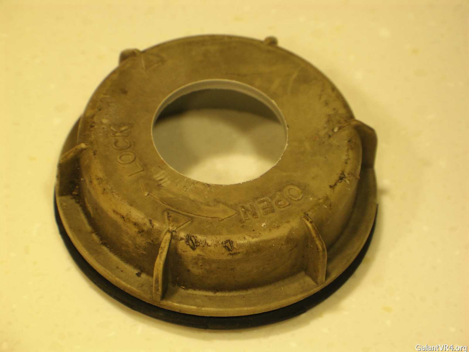

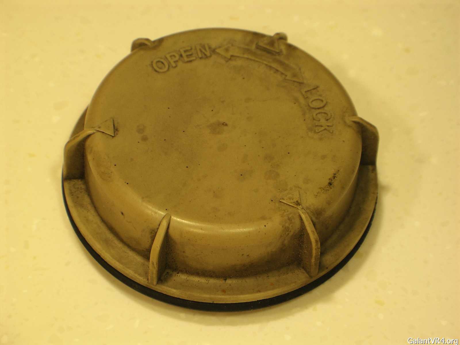

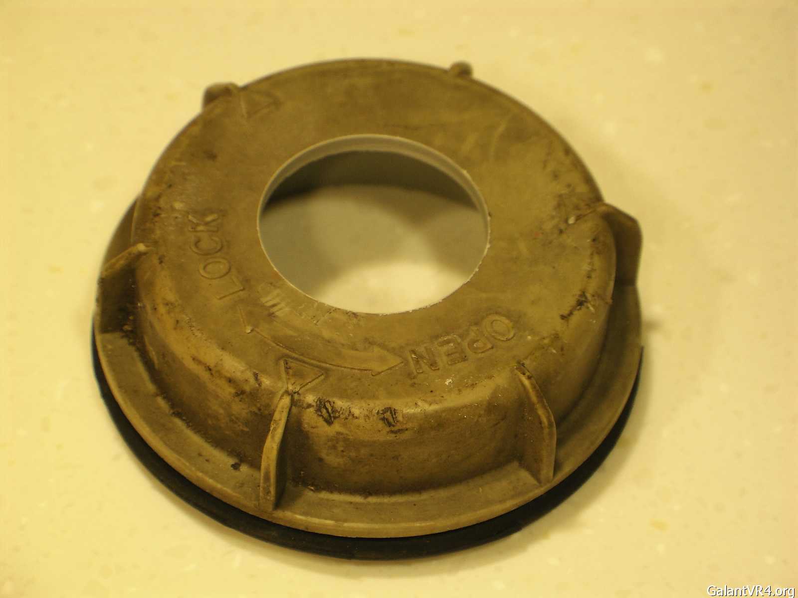

I didn't want to lose these waterproof caps
So I had to get creative
in order to keep things waterproof

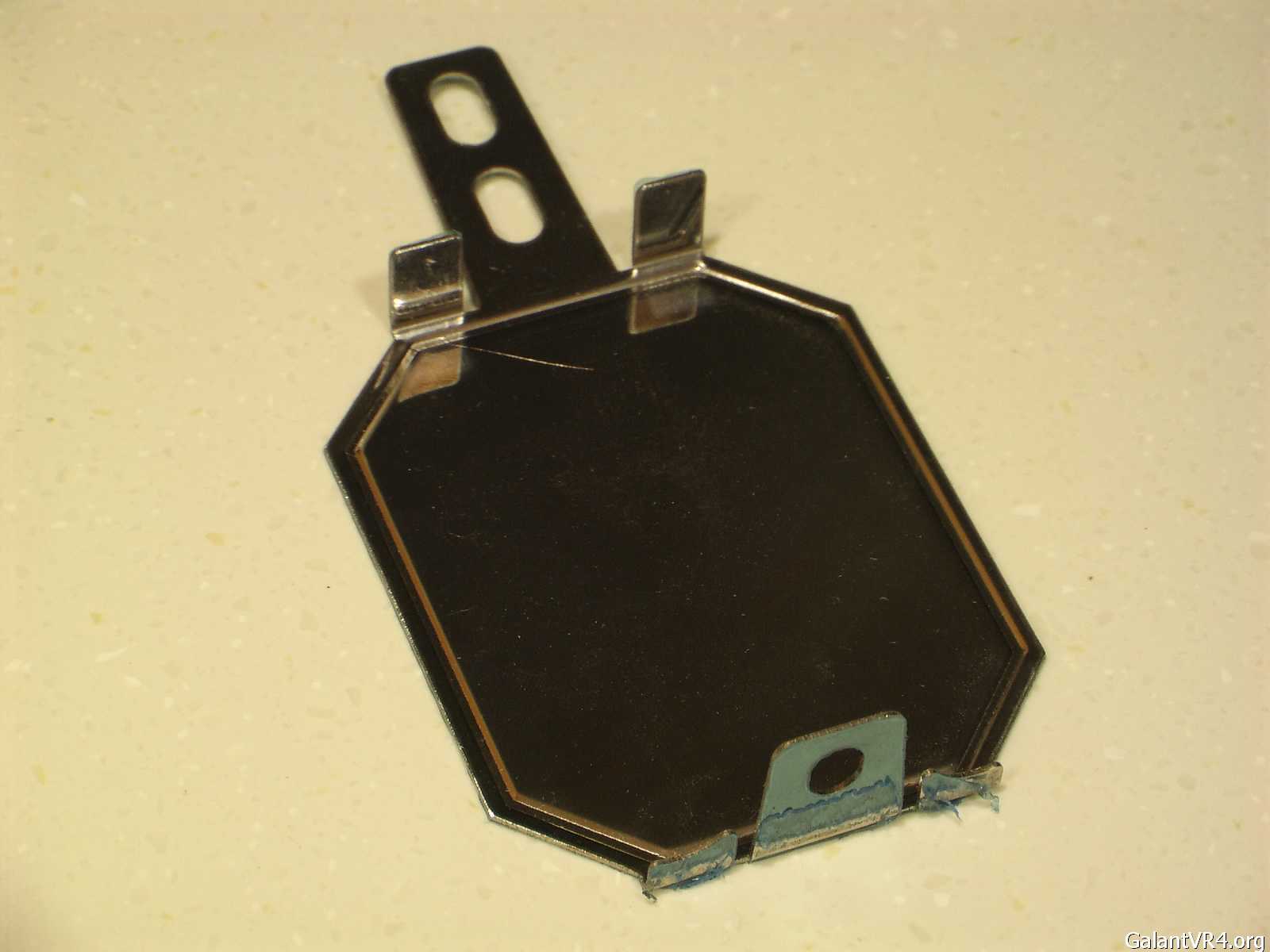

I'm still not 100% happy with it. The grommet is still pushing against the back of the bulb there. I had to trim off all the heat wrap to get it to fit as well which isn't ideal, but at least it is waterproof. Anyway I'll test the fitted bulb and make sure it works and that there are no pinched wires or damaged connections and if it is okay I'll do the other side. Those are the projectors by the way. The fogs are going to be even more difficult. The amber lens that Curtis put in may well not allow the HID bulbs (which are longer) to fit. If they don't I can make up a spacer but that will also lift the back of the bulb even higher making it very unlikely that the dust caps will fit. If that happens I'll have to make a modified grommet that will allow the back of the bulb with the heat wrap on it to poke through and use some silicone sealant or something to keep everything watertight. I'll get there.

Well I got all the HIDs in eventually and they work. I'm still worried about the ones behind the amber lenses shifting. Curtis is going to send me a Lexus bulb fitting to see if I can modify that, but for now the fogs are functional.

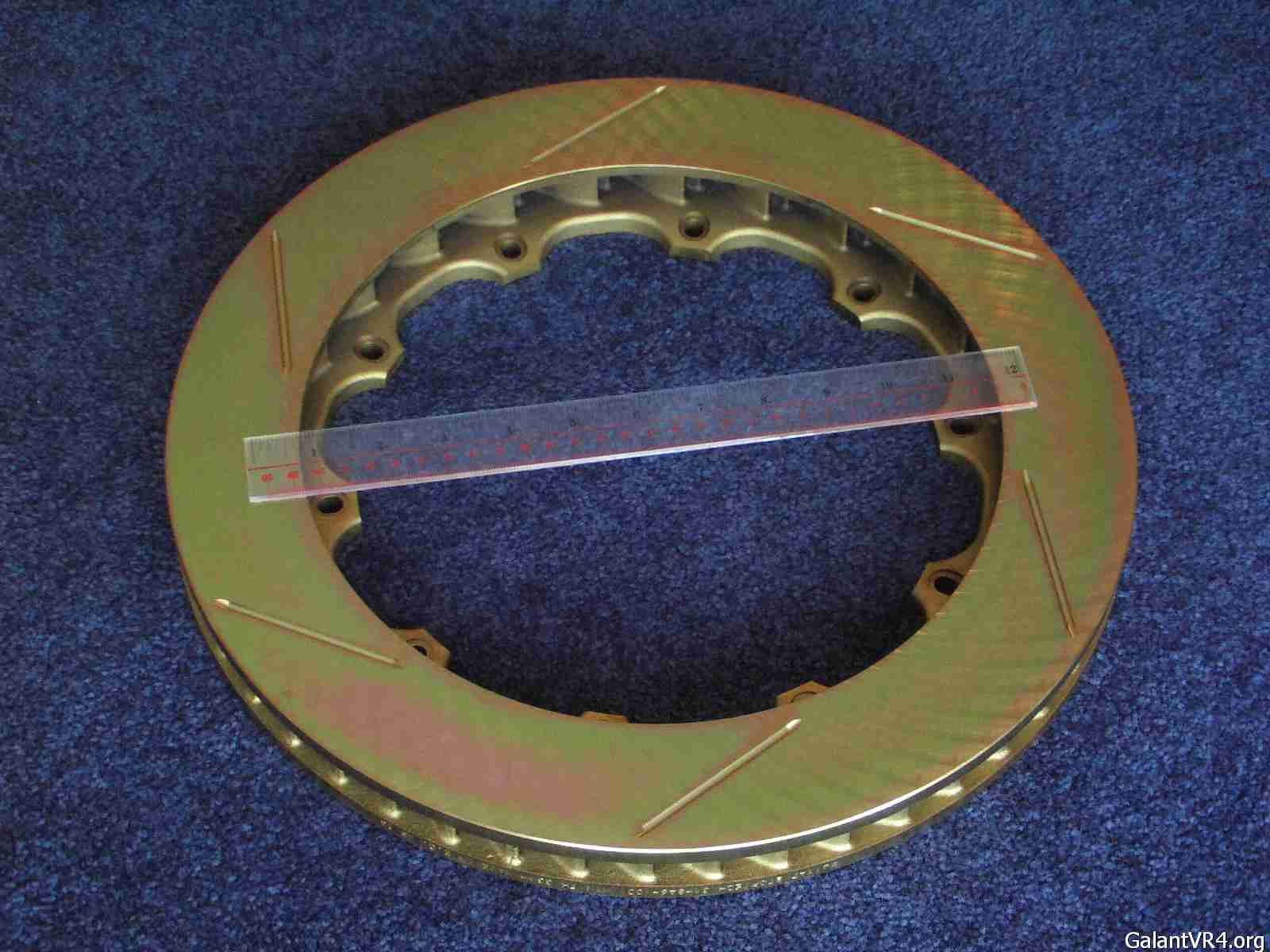

Stoptech e-mailed me and said the front discs are finally on their way after some quality control issue, so massive 380 mm rotors should be here on the 9th June.

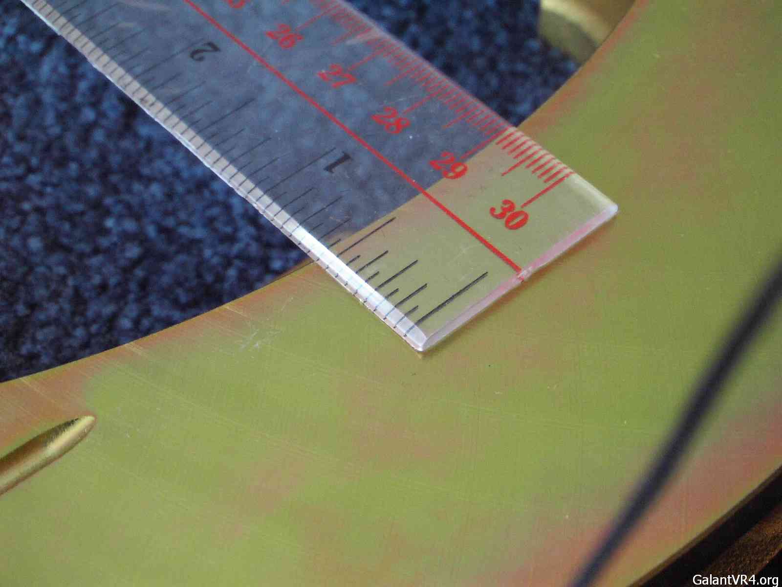

Brake Discs !!!
Or if you prefer a graphic representation ...
