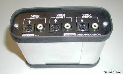

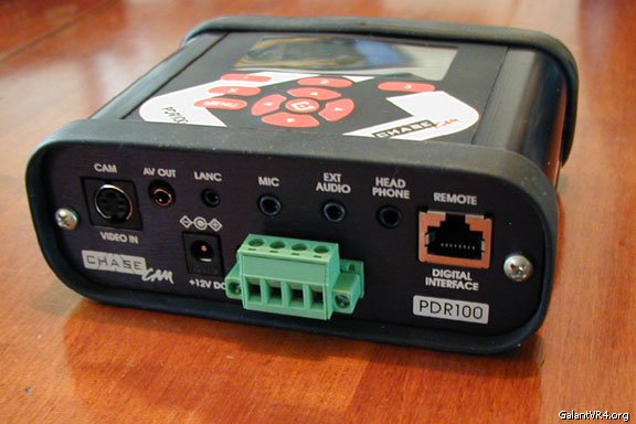

Video is in the house. Yeah I know it's worthless until the car is running but I'm quite excited about this as I've been waiting on this for a long time and the units seem to have been under development forever.
This is the PDR100 solid state MPEG2 recorder

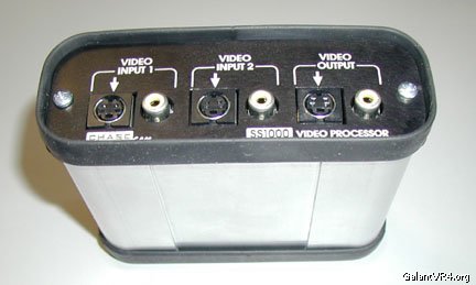

And this is the sister unit, a video switch box which allows me to run a second image PIP (rear view camera or a wide angle of the steering wheel, gear lever or pedals etc). I picked up a 4 source video switcher off of E-Bay cheap that will actually allow me to choose between 4 different camera inputs for the PIP image. I'm thinking a hidden camera focused on the face of the passenger might be fun ... /ubbthreads/images/graemlins/devil.gif
It seems pretty solidly put together and has room for a lot of functionality. Some stuff is still under development like a G-Meter display and interfacing with other data logging products but it still has user selectable positioning of the PIP, a clock display overlay and remote 'arming'.
I intend to wire it up so that it starts to record as soon as I turn on and records in 'loop' mode continuously. Apart from ensuring that I never miss a kill, it's useful ammunition to have in the unfortunate event of an accident (if it really wasn't your fault that is !!!). Cost was a little over $600 for both units. Not cheap but comparable to a video cam which is far more difficult to mount (this is used with remote bullet cameras powered off the unit itself). And it is definately cheaper than STACKS digital solid state recorder. I know STACK stuff is second to none but $7000-USD for a video recorder, yes I said $7000-USD. Ask Alex, he got the quote !!!

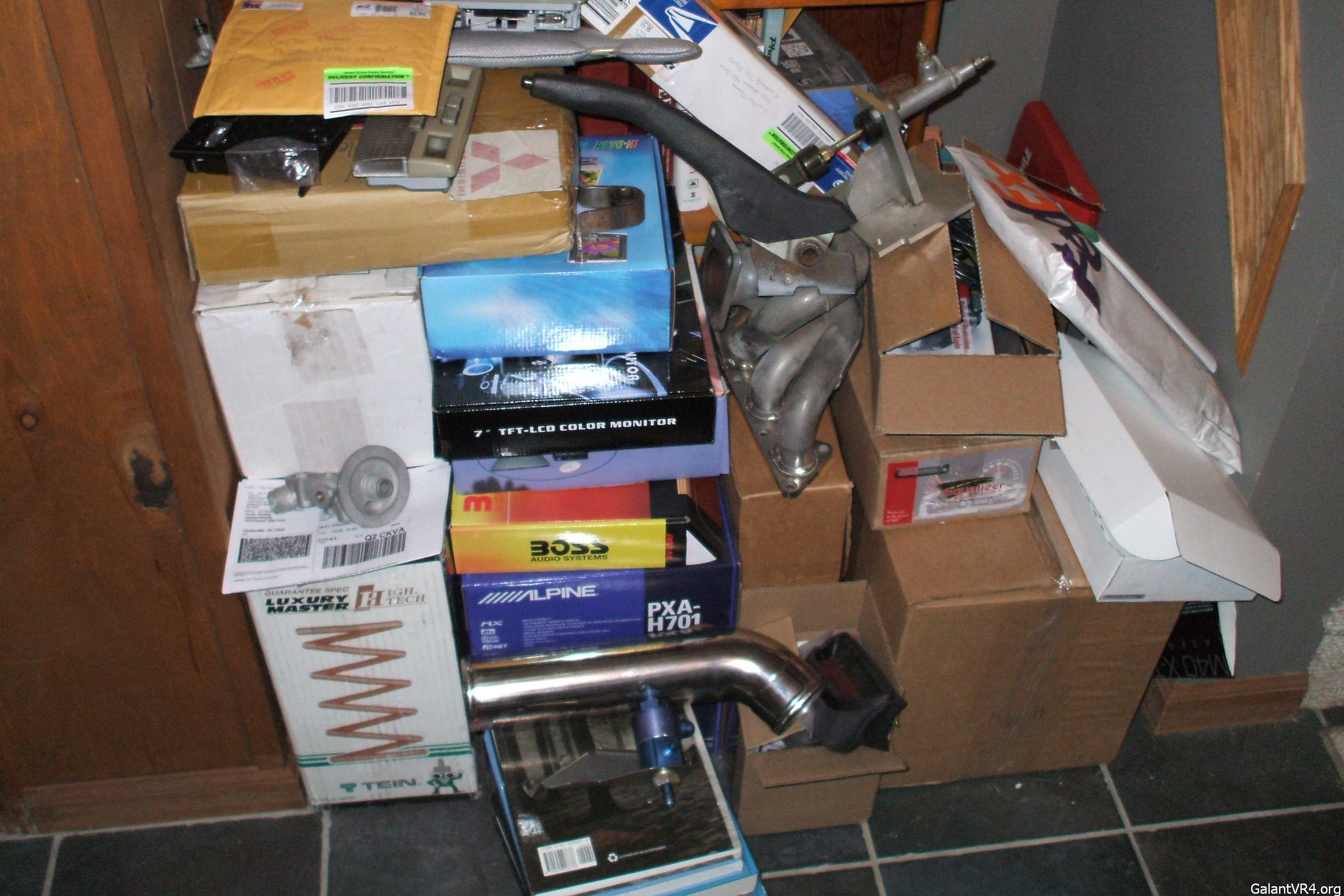

so whats new with the car?

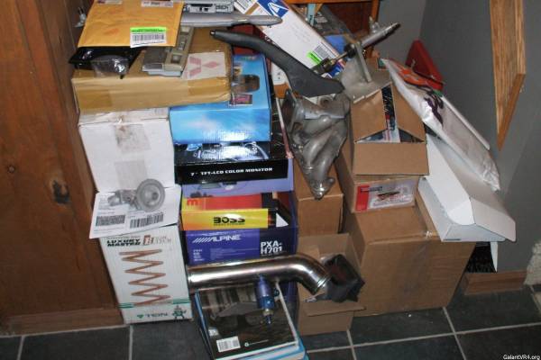

Well Paul updated on his end and here's what he has that needs to be shipped from here.

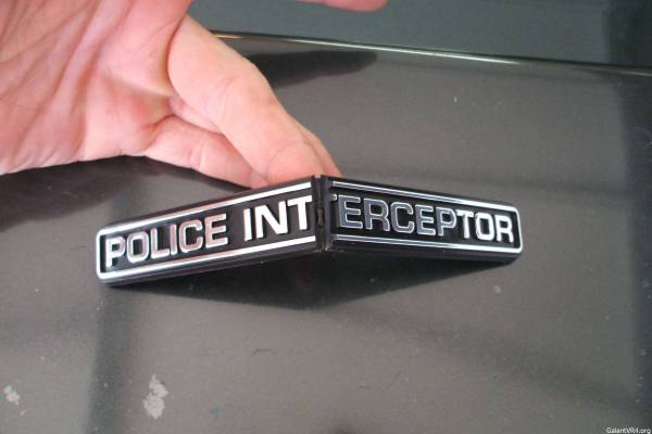

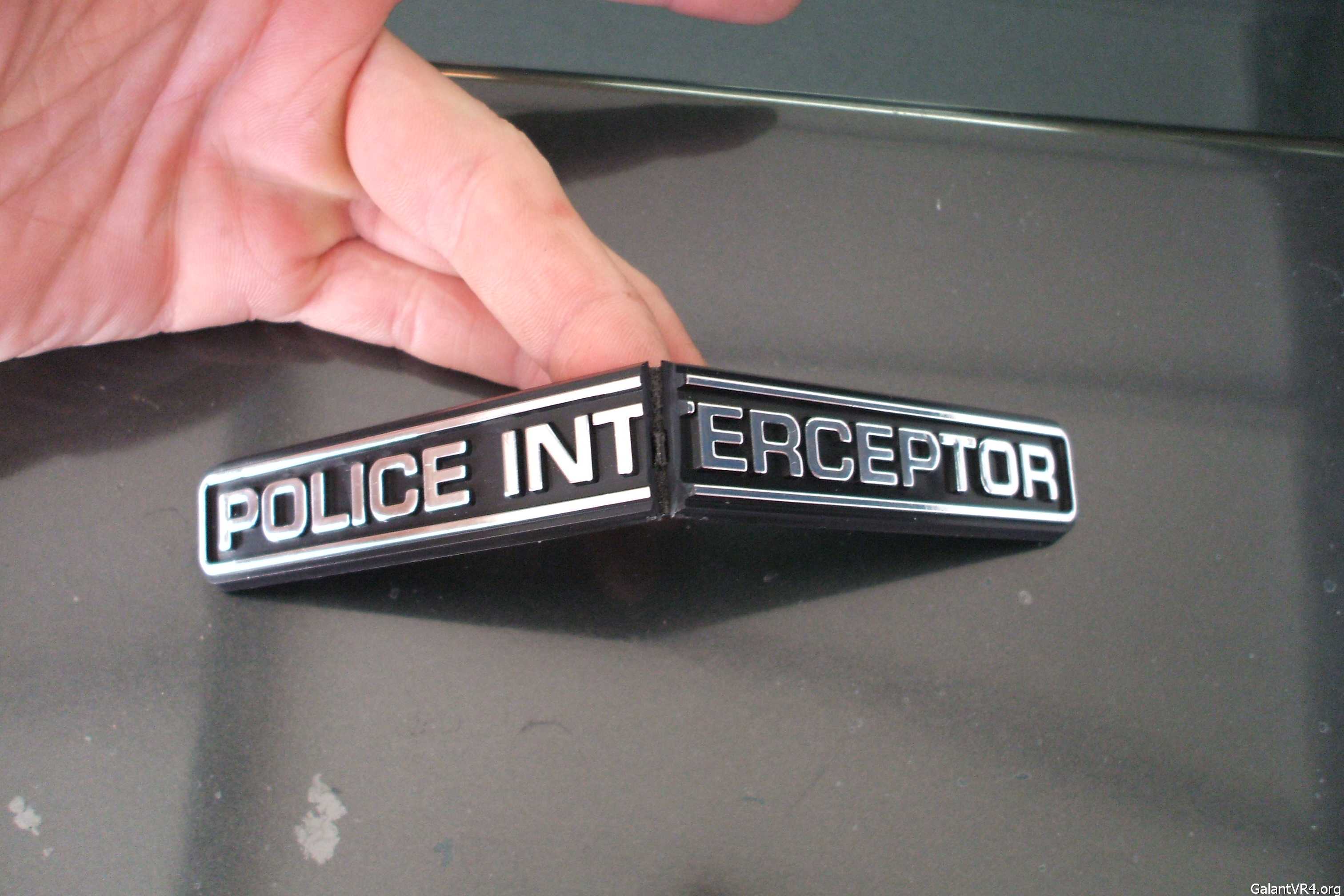

This is one of the stacks. Also he got a toy today but it was broken but here's a few shots of it anyway. Just because the box says something doesn't mean thats whats in it. He has a complete inventory in his head and on paper. I can't wait to fly over and get a ride.

I'm sure you want a new one, but we have tons of cop cars at work. I can get you some used ones for free if you want.
Andy
May 4, 2003
11,892
Clarksville TN
I'll respond for Paul. Yes send some.
He told me he couldn't mark his personal car as a police car but this is border line cheating. /ubbthreads/images/graemlins/grin.gif
I've been watching the junkyards around here for a couple of years now for him but none have shown up and I thought they weren't available new.
