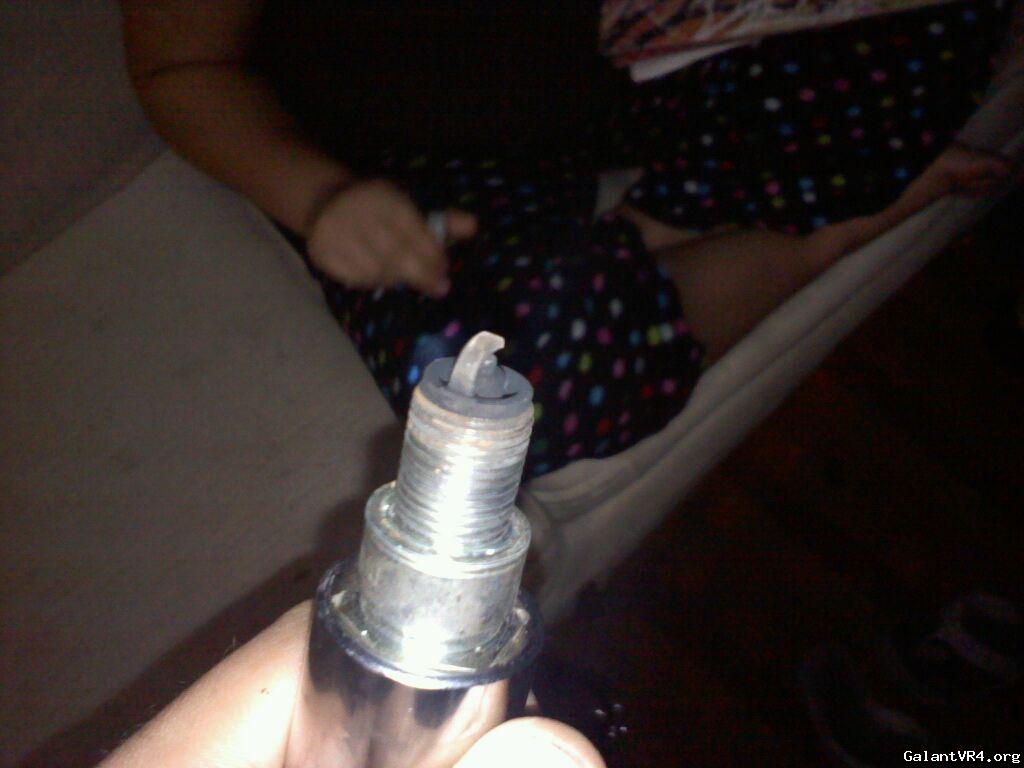

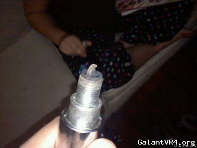

this is carbon deposit?
ALSO Any recommendations on good spark plugs or whatever the guy at Kragen says
the ones in the picture are NGK

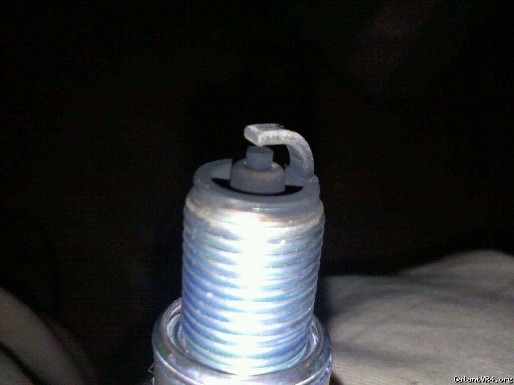

the the bpr7es gapped at 0.028
took it for a spin around the blocks a few times got it to operating temp.
it felt really rough at first then towards the end started to feel a little bit better
THEN MY BATTERY DIED so back to the alternator?>

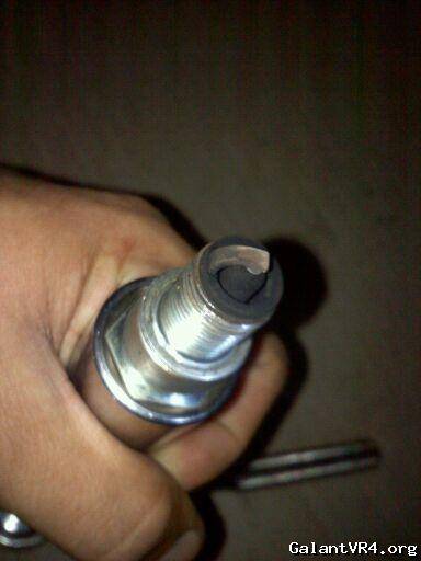

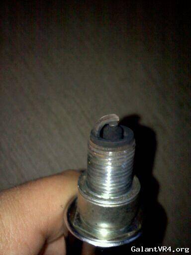

anyways back to the thread i took one of the plugs out after i got back from a test drive
^THAT'S THE BRAND NEW PLUG^
is that NORMAL AFTER A FEW TIMES AROUND THE BLOCK??
any input is appreciated
(still sputtering and hitting full boost at 4000rpm)

What are the causes of this.
And anything I could do to fix?
+book says its carbon deposit and is cause of rich mixture or pre-ignition

Yeah if the voltage is low it can cause that fuel pump to not have enough juice on the top end. That being said it doesn't look *that* lean to me. The flash on the camera may make it look more white than it is. The first pics look gray like what you want. Doesn't look like its too far off.

Is your engine blowing black smoke when you get on it? Those plugs are showing you're running quite rich.
