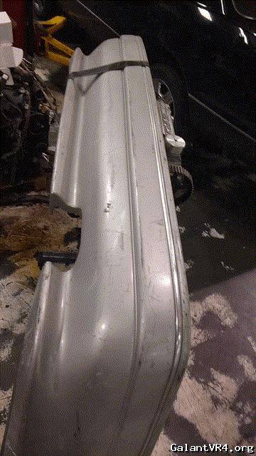

Update:
In case anyone is ever searching threads for JDM Bumpers and/or brackets Ill throw some info on here.
Removed the front bumper using this .
then I kind of had to wing it with the rear...

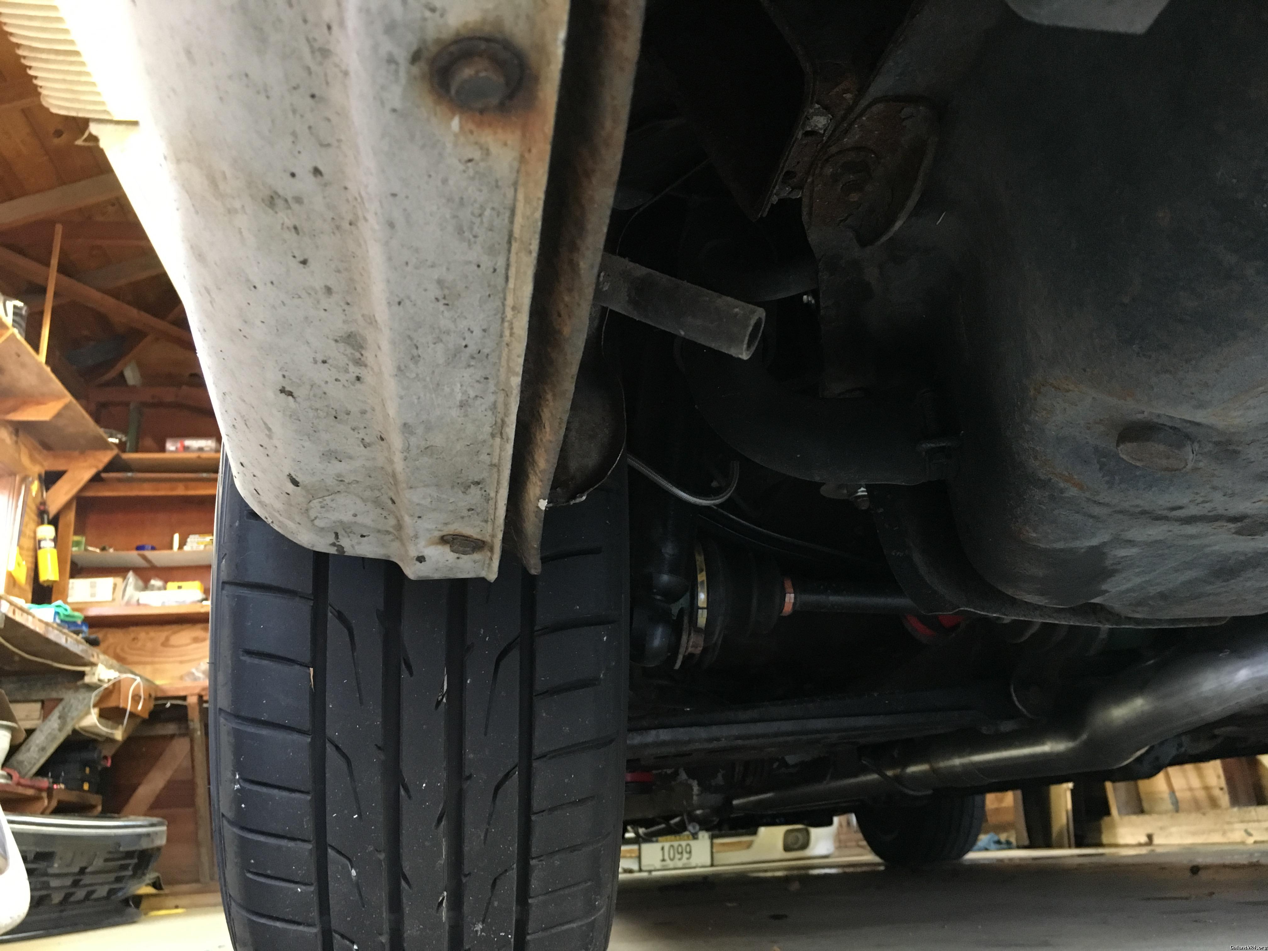

Started with taking some picks of all the bolts.

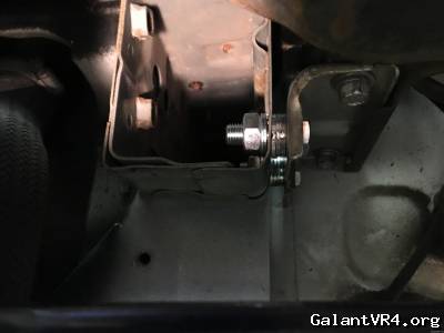

Remove these ones first. Both sides...
And don't forget these.
Now these, hopefully they don't salt roads wherever you hail from.

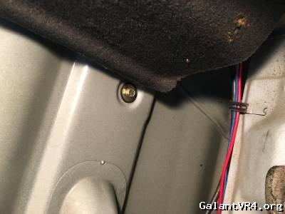

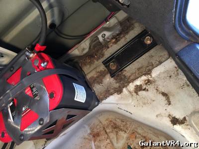

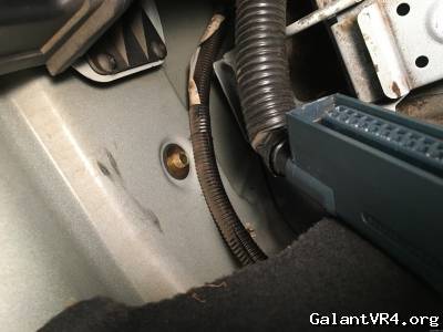

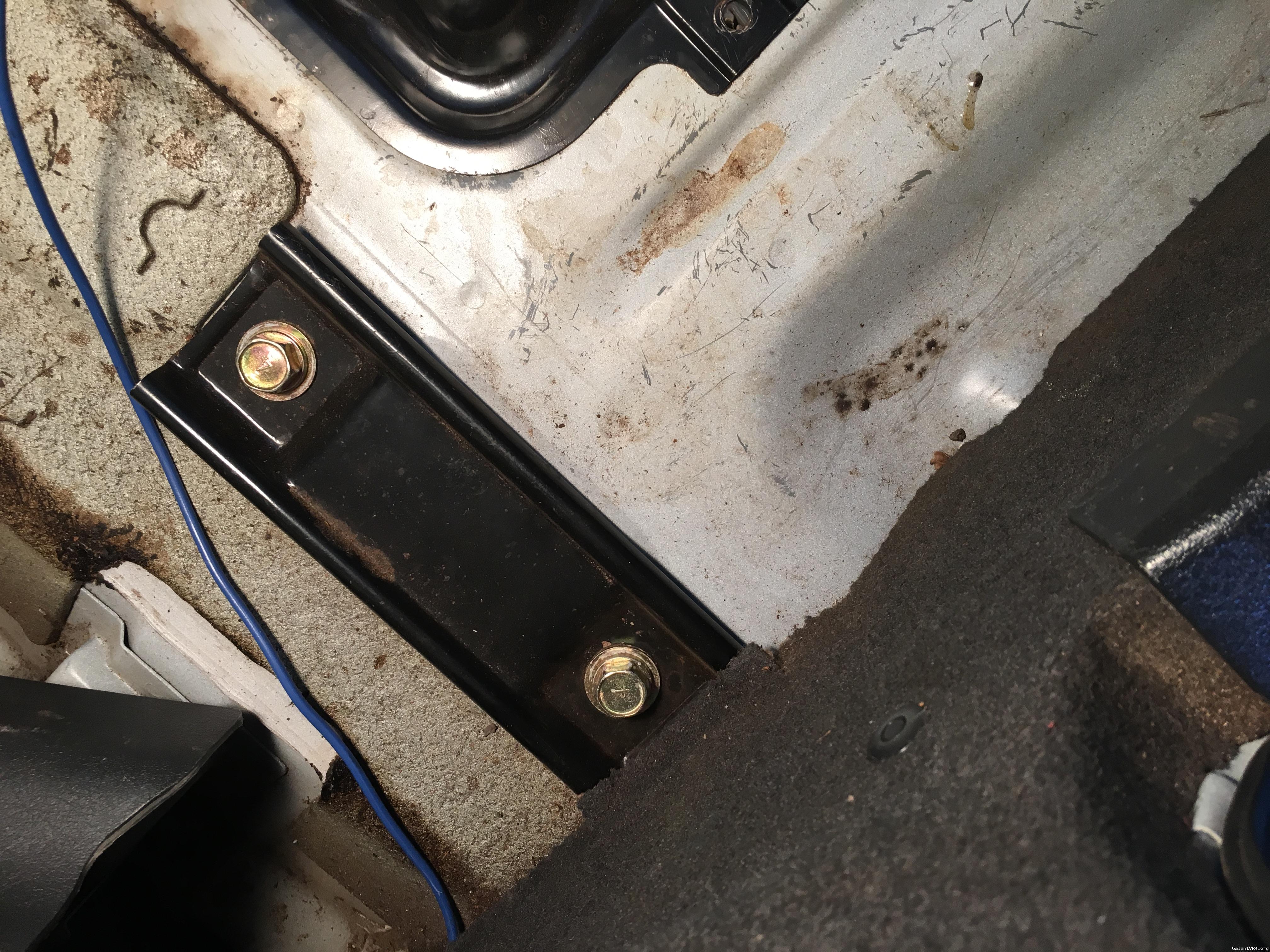

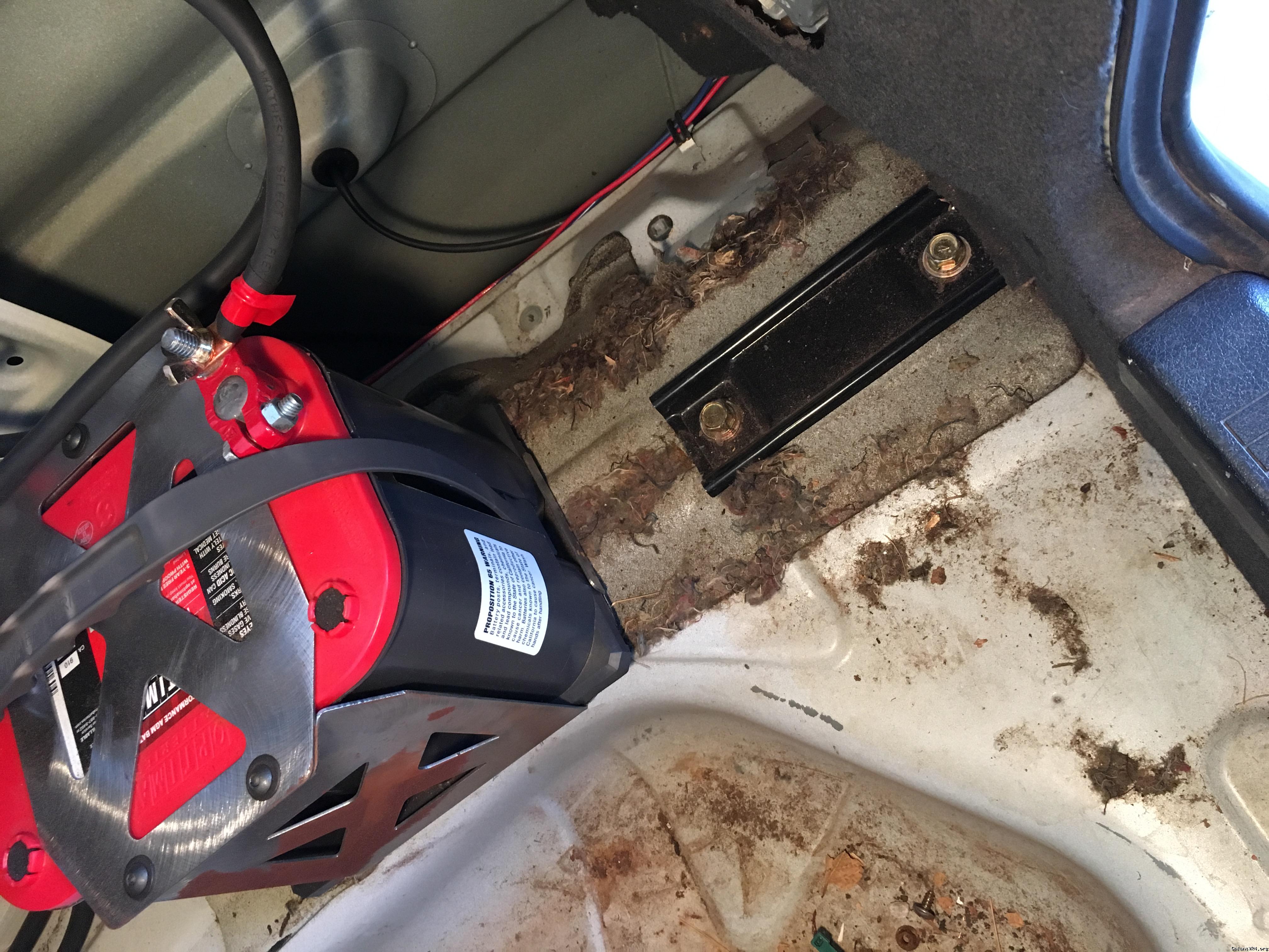

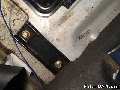

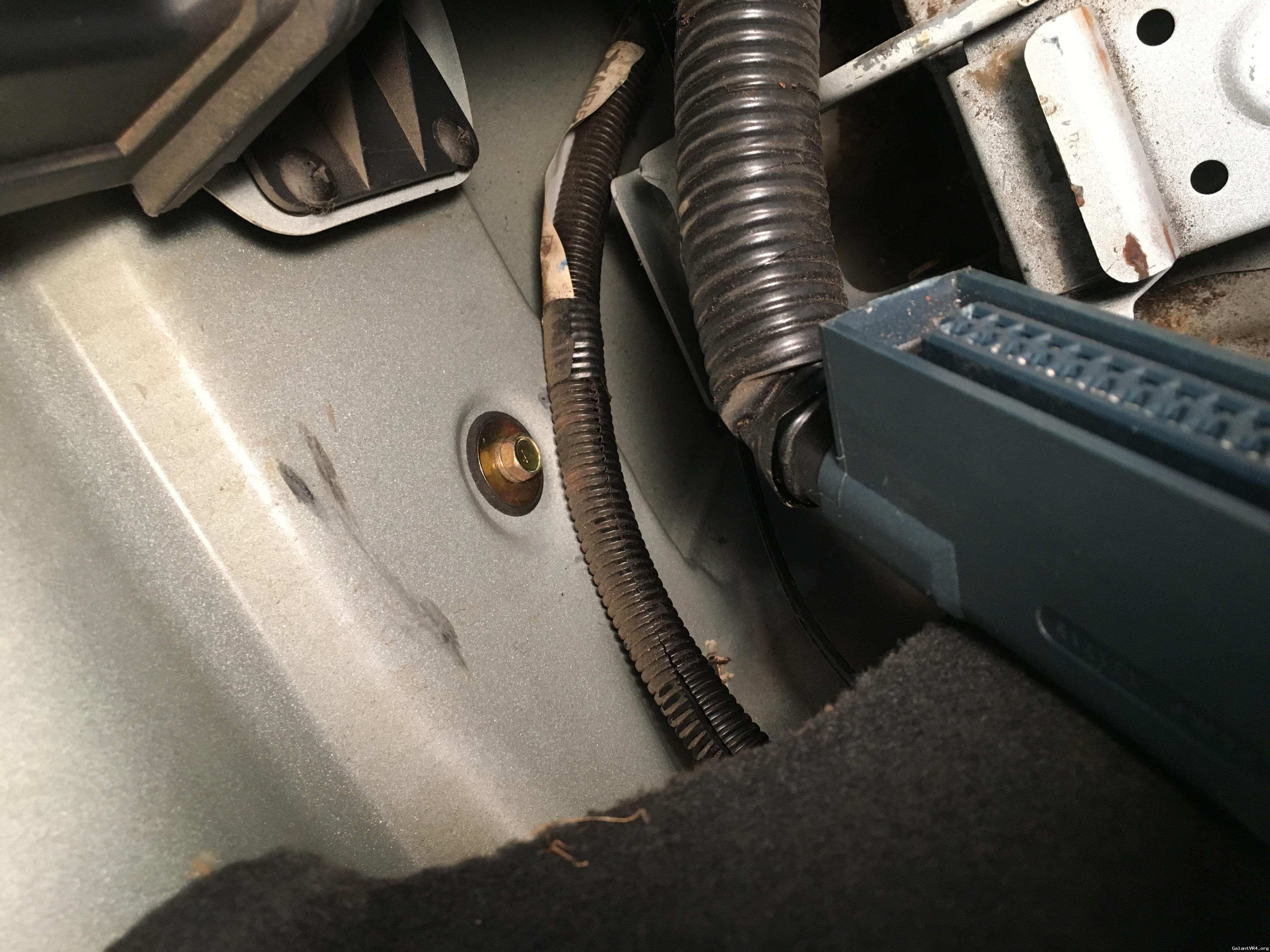

Now go inside the trunk...

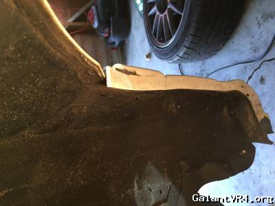

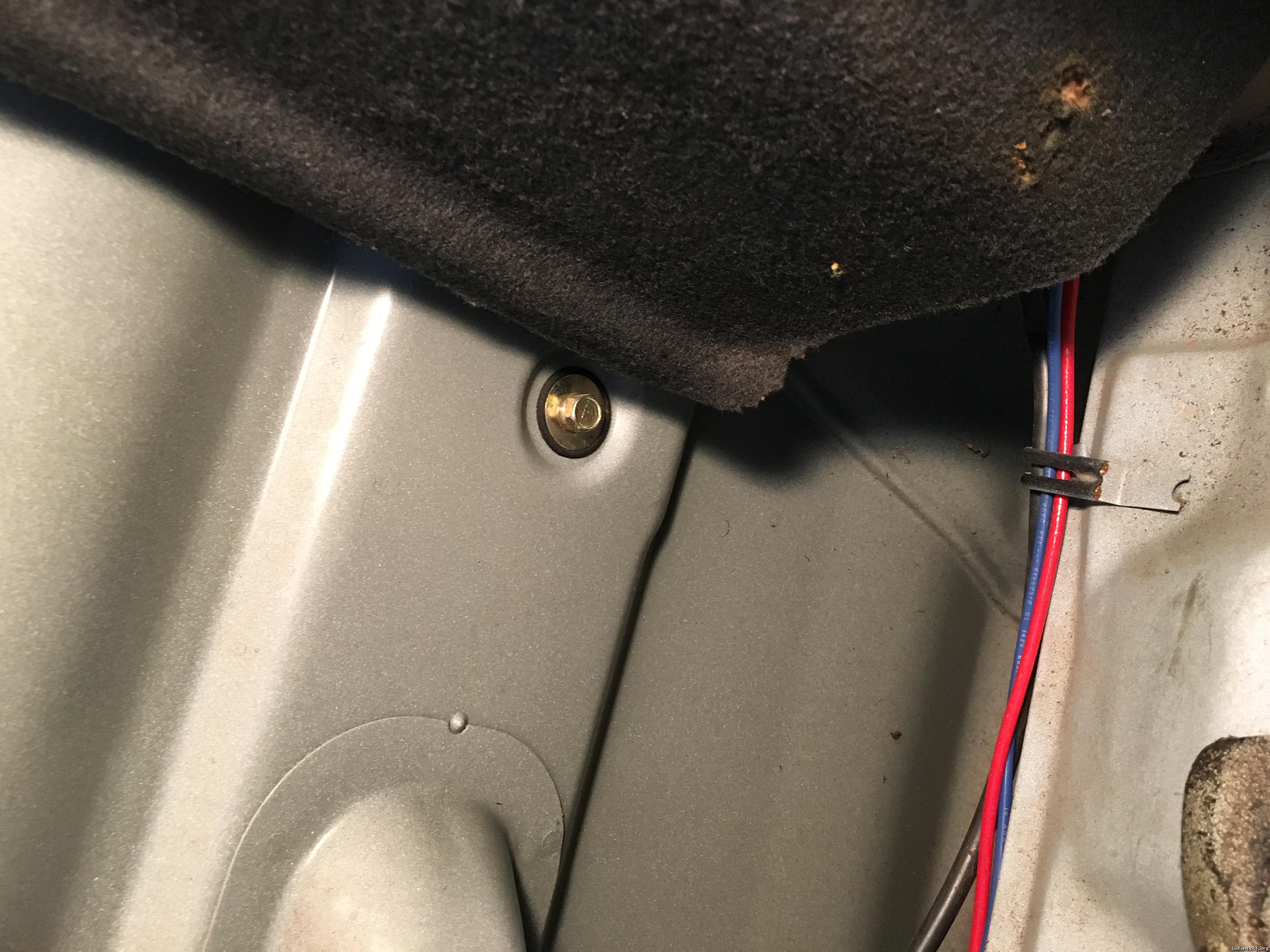

Look in the quarter panel.
Lastly, remove the 4 bots. NOTE the Black brackets with two 17MM bolts.
unfold sides of bumper off the car and pull with your hands under the bumper lip with each hand near where the black brackets were.

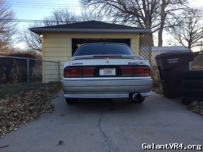

Fitted the rear slightly. Gotta add some bolts yet and make it snug everywhere so I can start prepping them.
Exhaust is going to need some work to say the least. I'm not sure if I will keep the angling, although I might do a straighter style since I have a cutout now :)

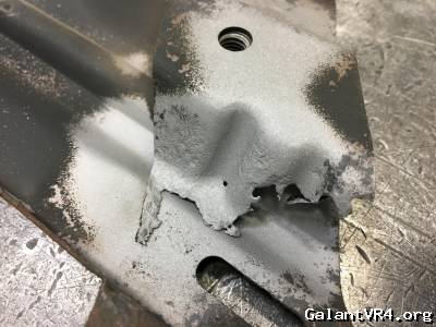

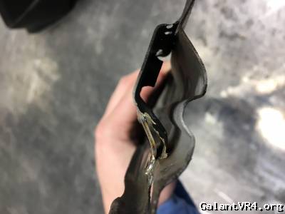

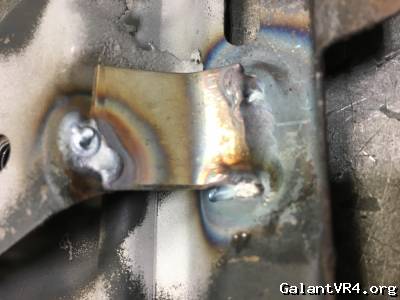

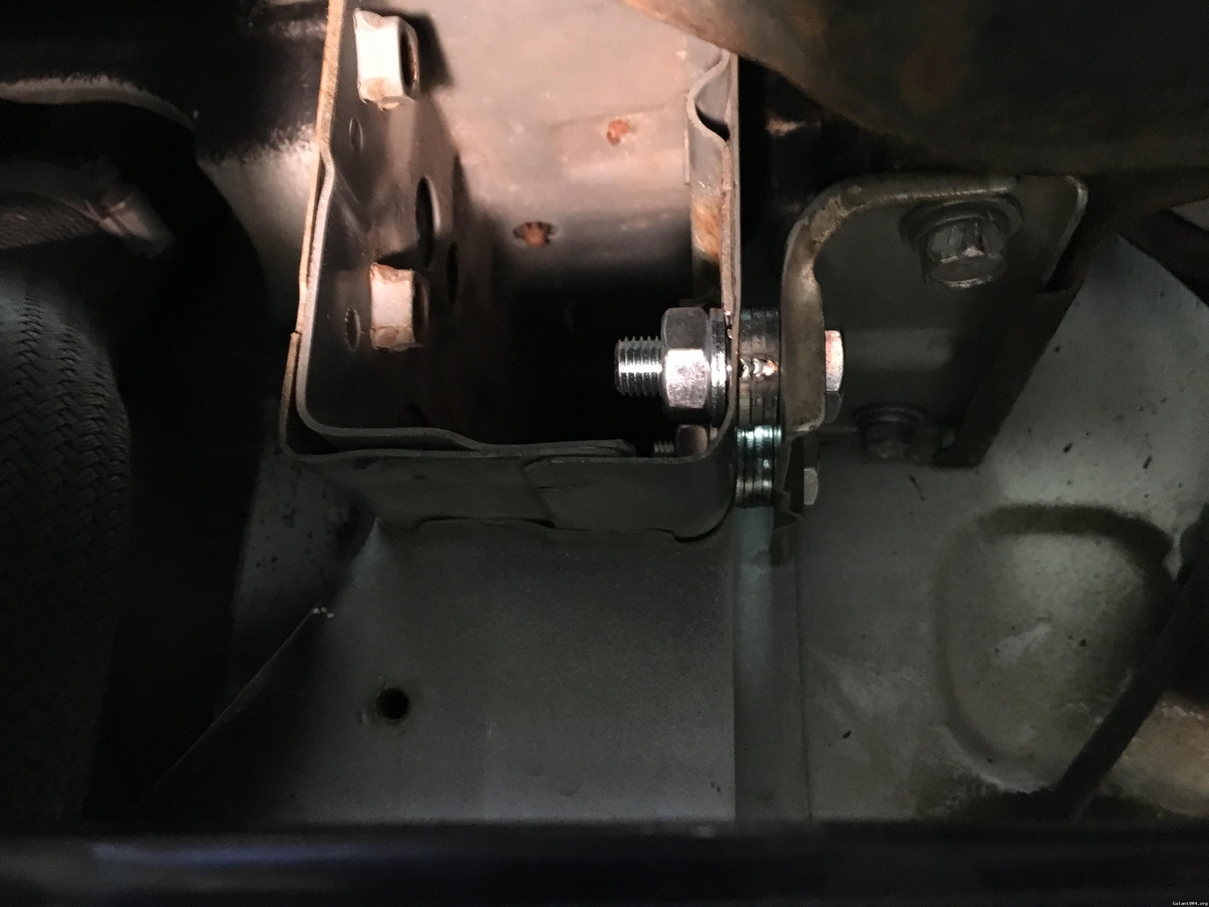

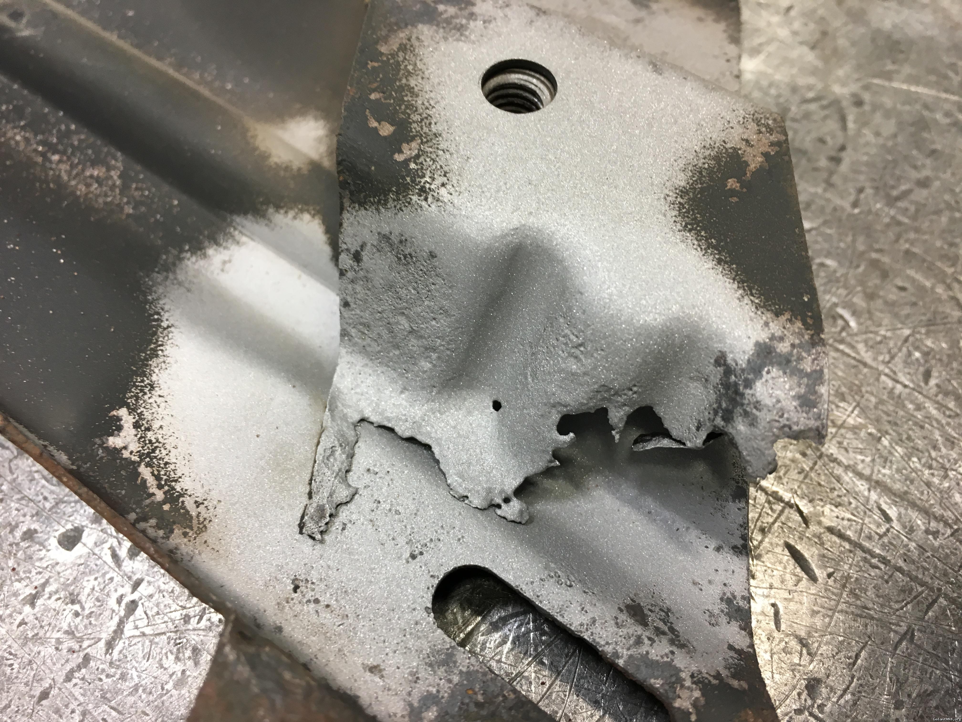

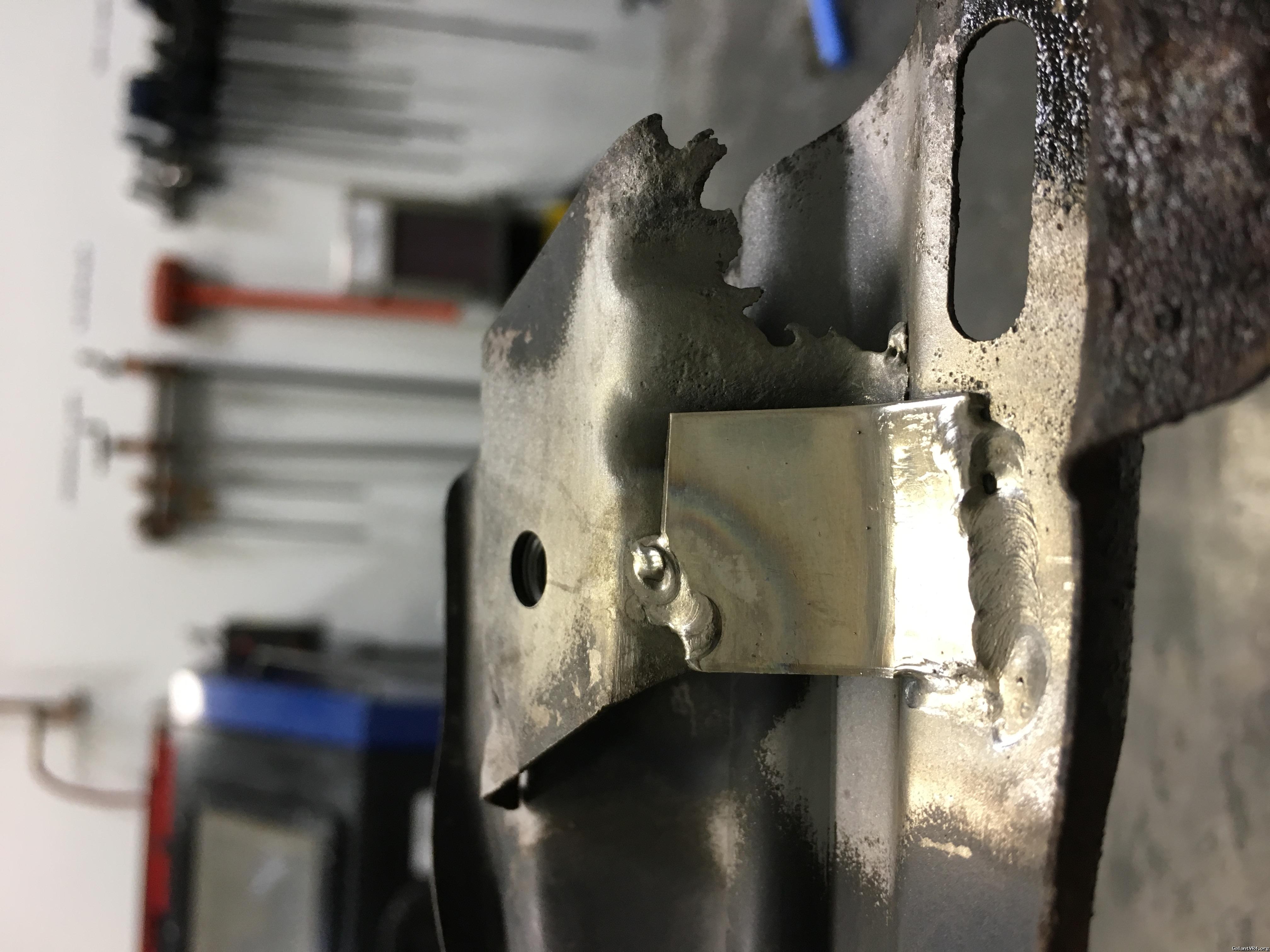

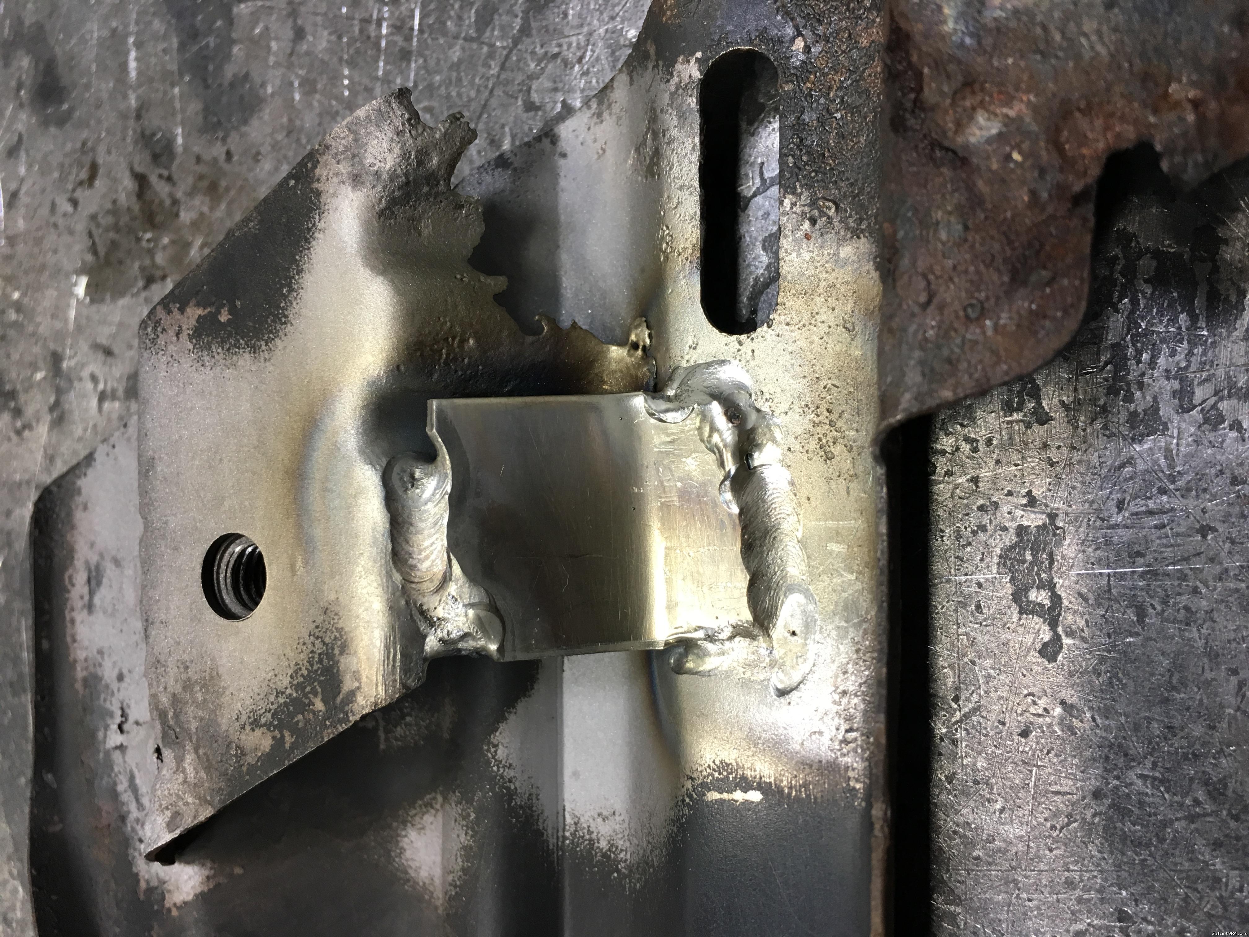

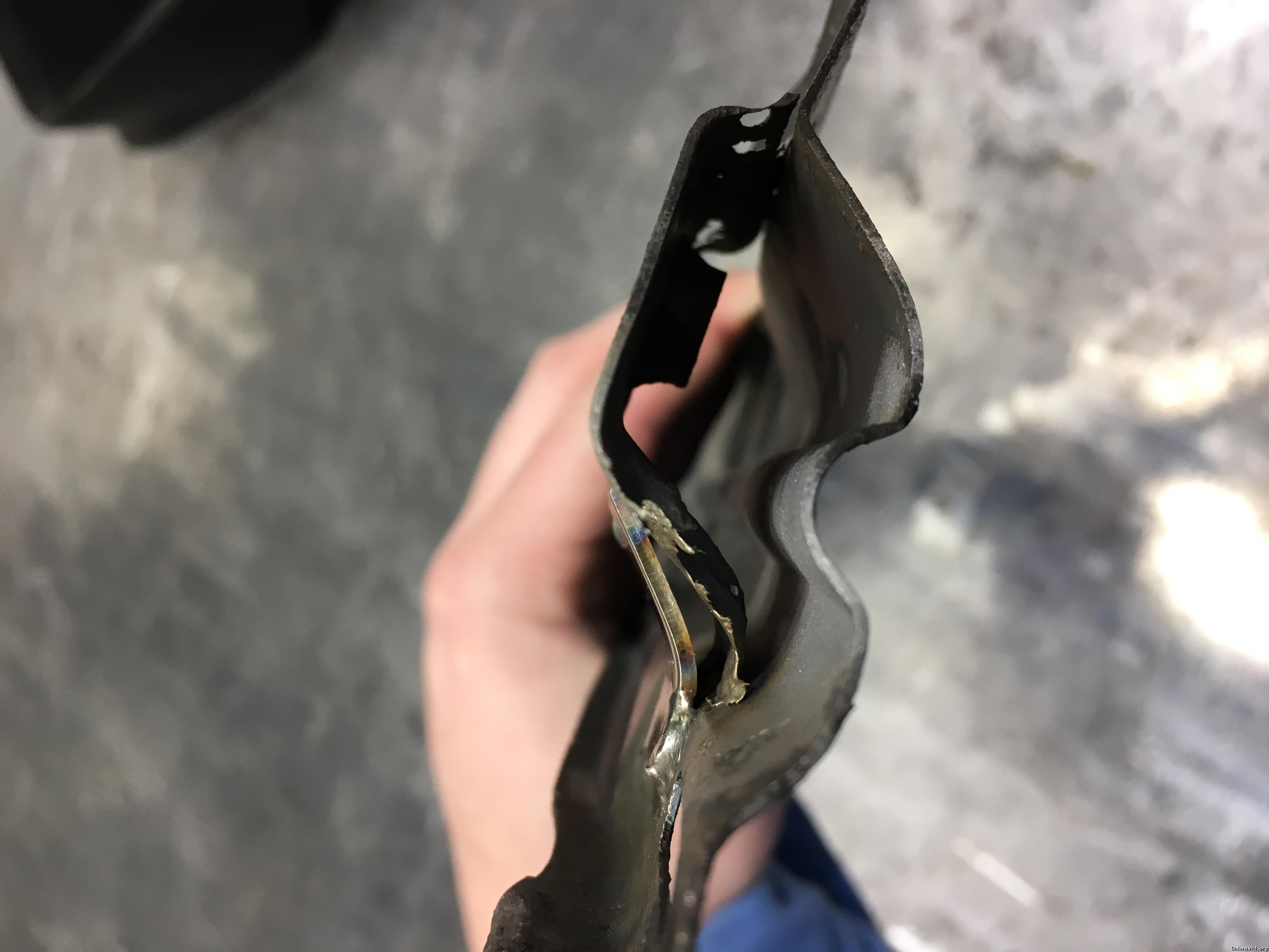

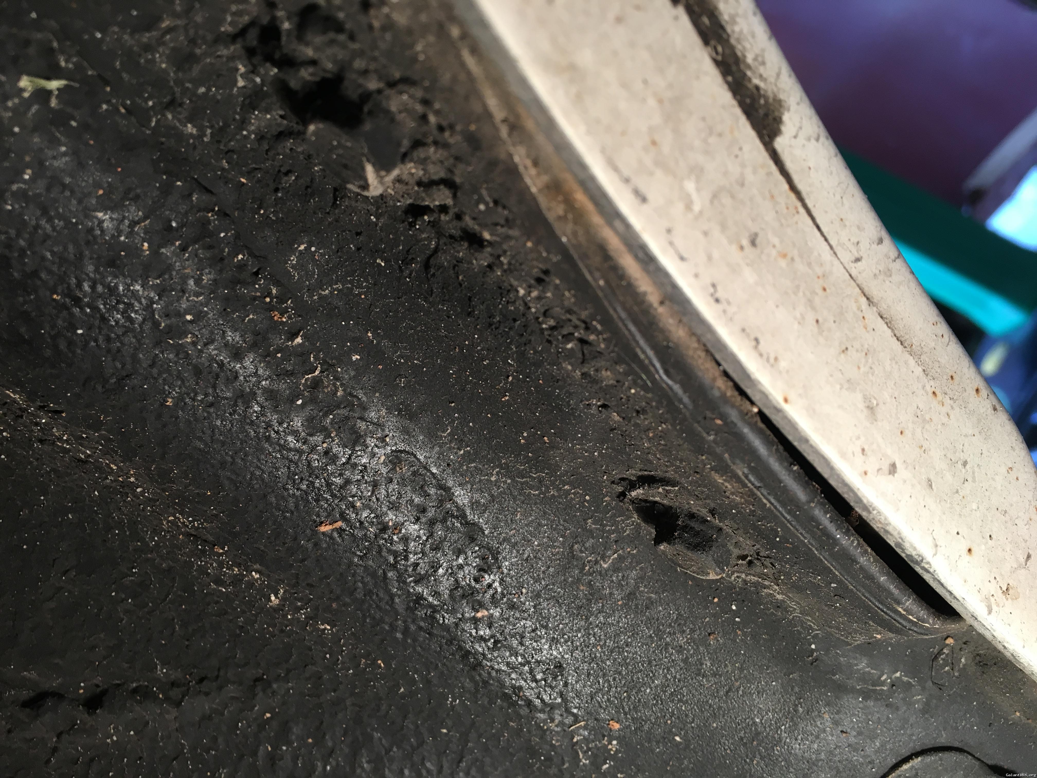

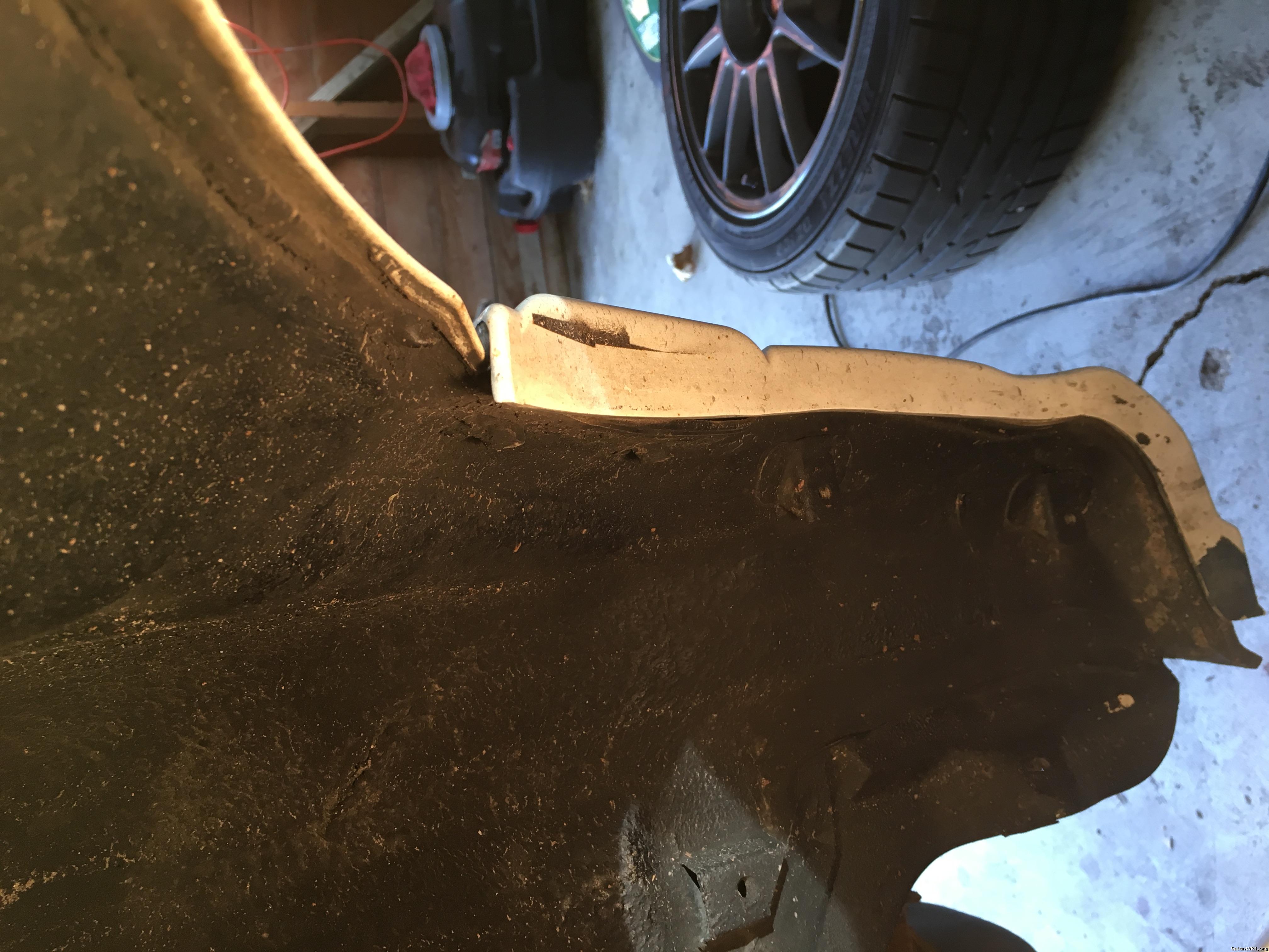

Started playing with the rear bumper more today, started repairing the brackets too. My rear bracket on one side rusted out.
So I thought would play...
Sand blasted area of rot. It was pretty THIN.
Had to clean it.
I was not happy, and OCD kicked in

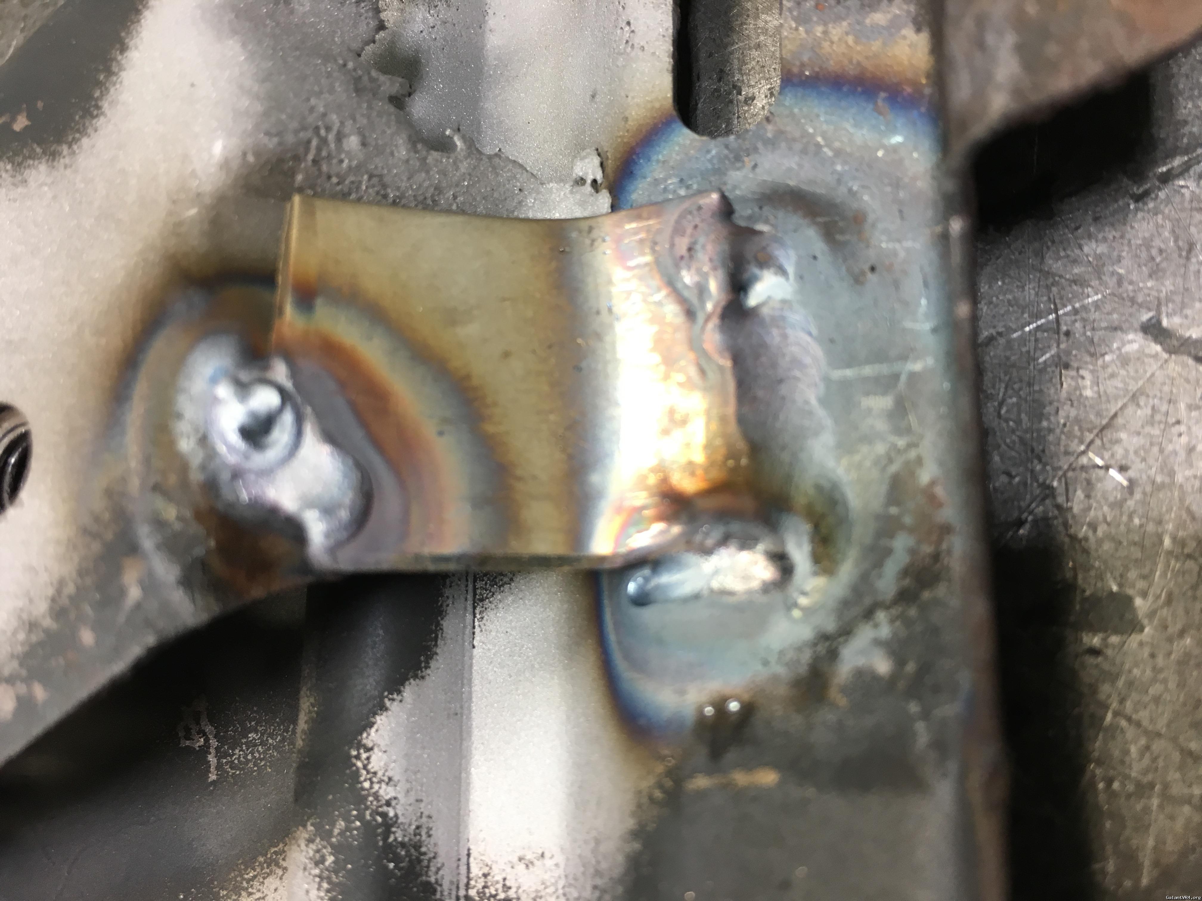

Choice fitment for more durability. Now ready to sand blast and paint.
May remake brackets that connect to the side brackets as mine are rusty nubs.
Nebraska
Apr 9, 2015
140
Lincoln, NE

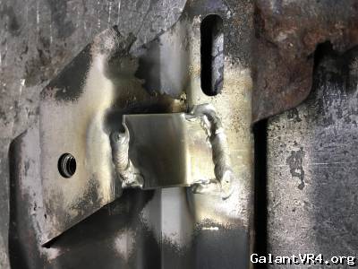

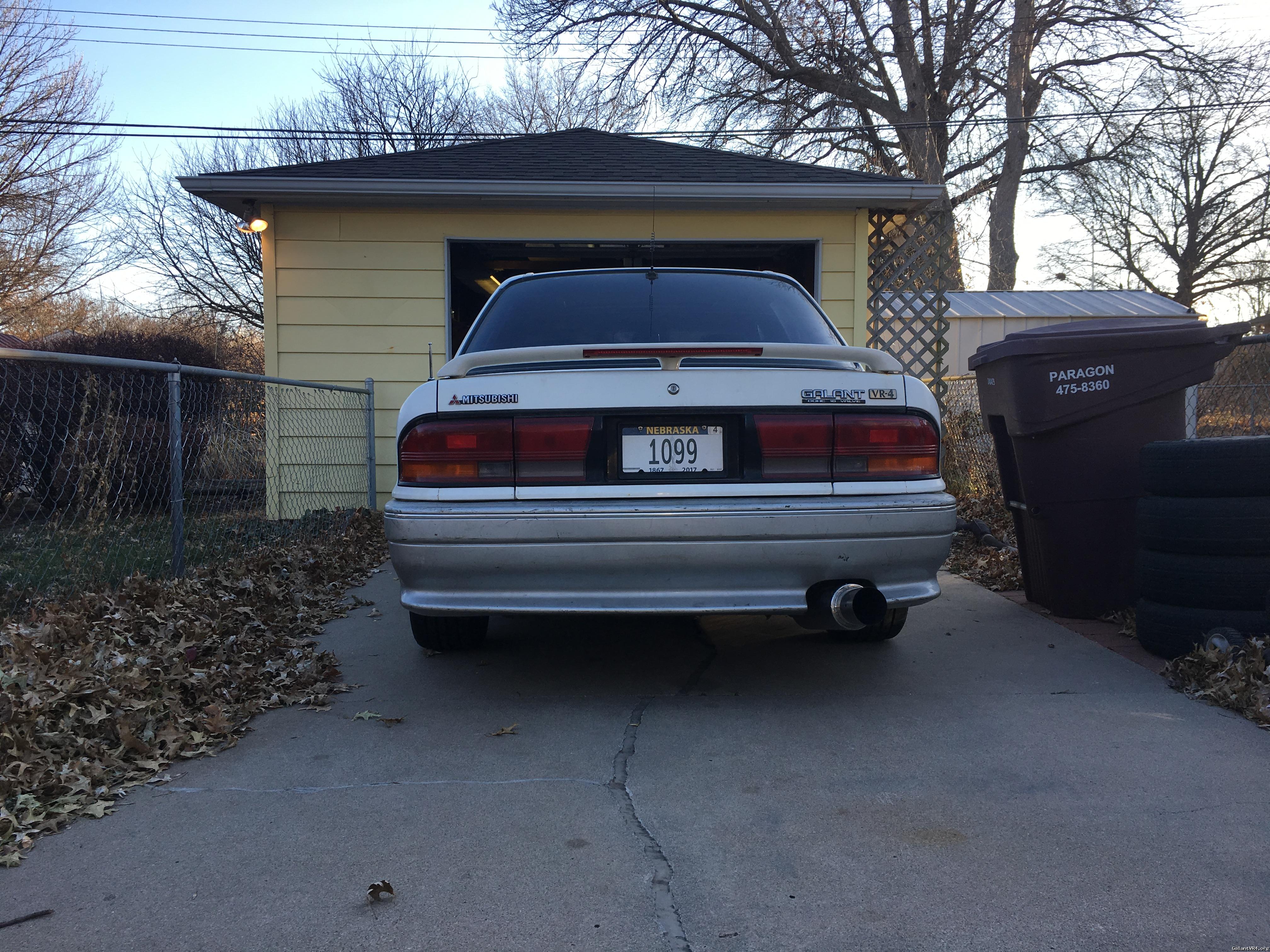

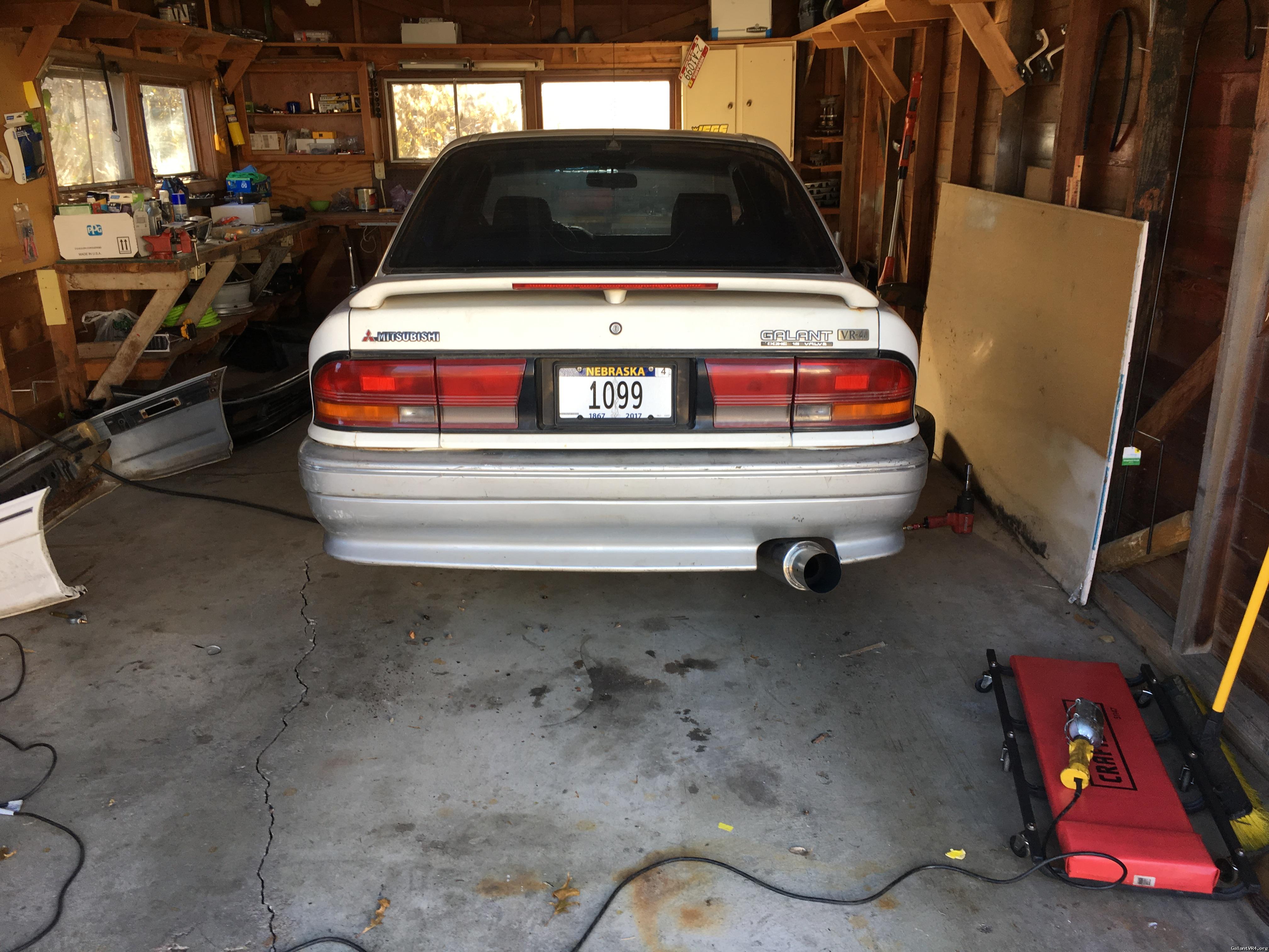

Got the bracket welded and installed. Even had like new bumper clips off my USDM bumper to really get the brackets on!

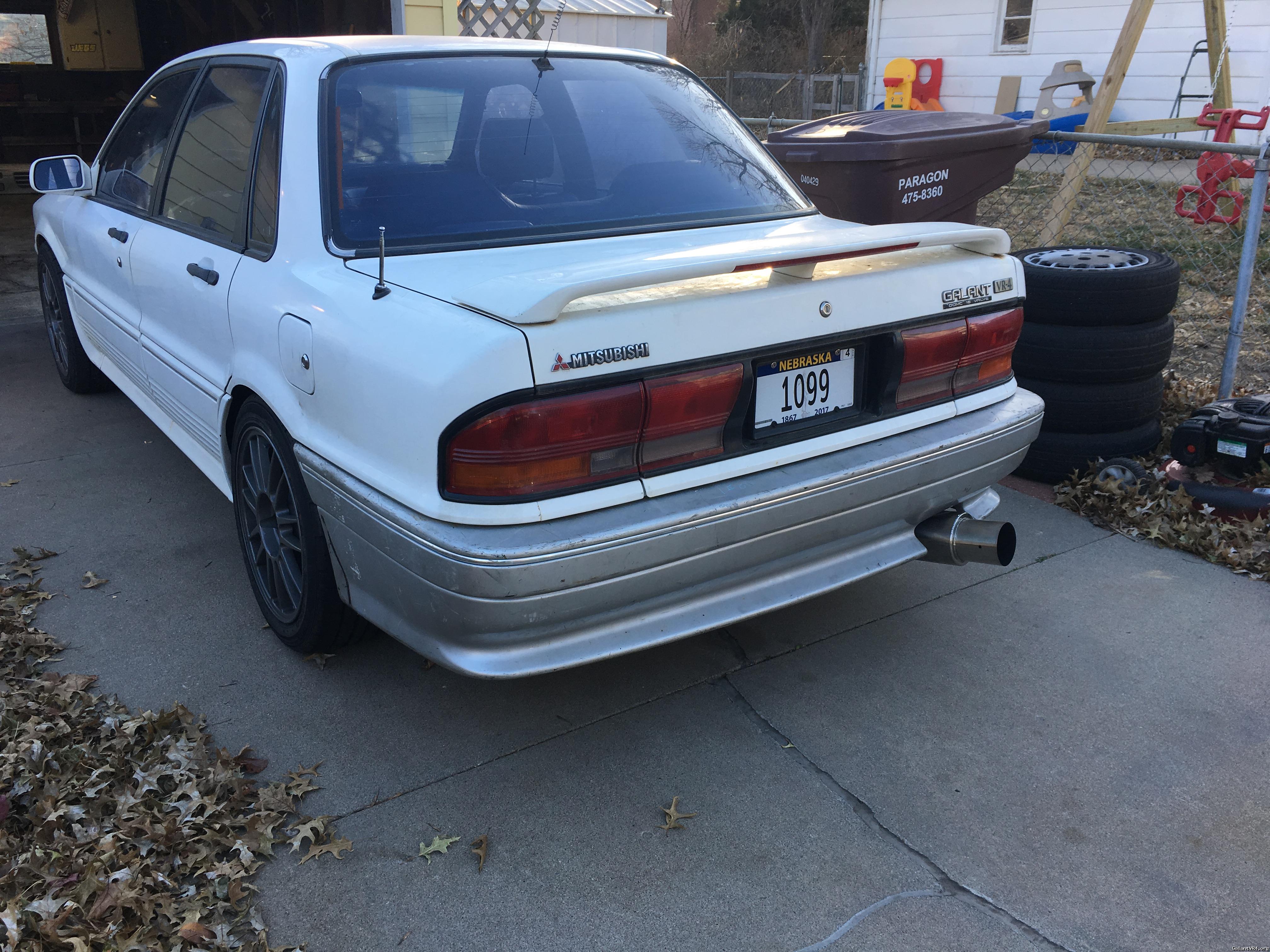

Update: fitted rear bumper with all bolts except the bottoms of each side( need to make new tabs)
Other than that, bolting the bumper up really pulled it in close to the body and I’m happy with the fitment! Before, there was a gap that worried me but not anymore as it’s gone. I can say I’m not a fan of pulling, pushing, and tapping on the bumper to get it into the right places when mounting but in the end I got it.
Check it:
Goodness gracious that exhaust is hideous...

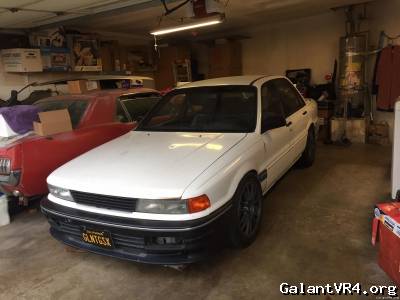

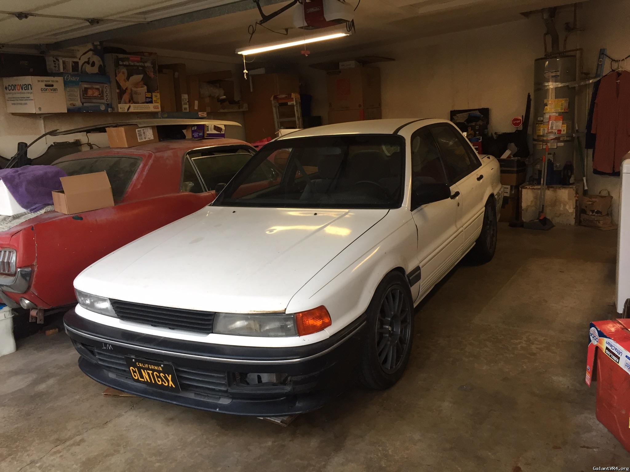

Update!
Still working on getting a cad screenshots with measurements for the front brackets that the bumper bolts to.

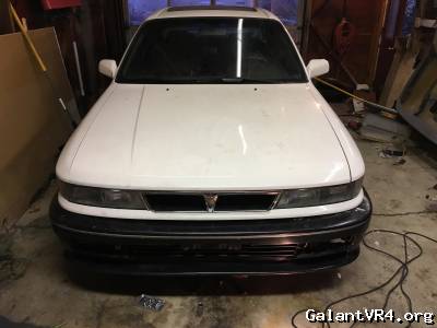

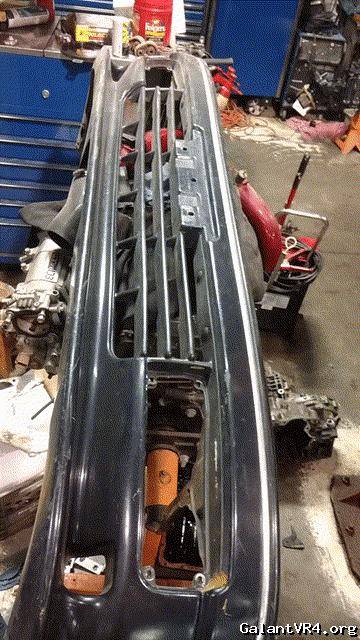

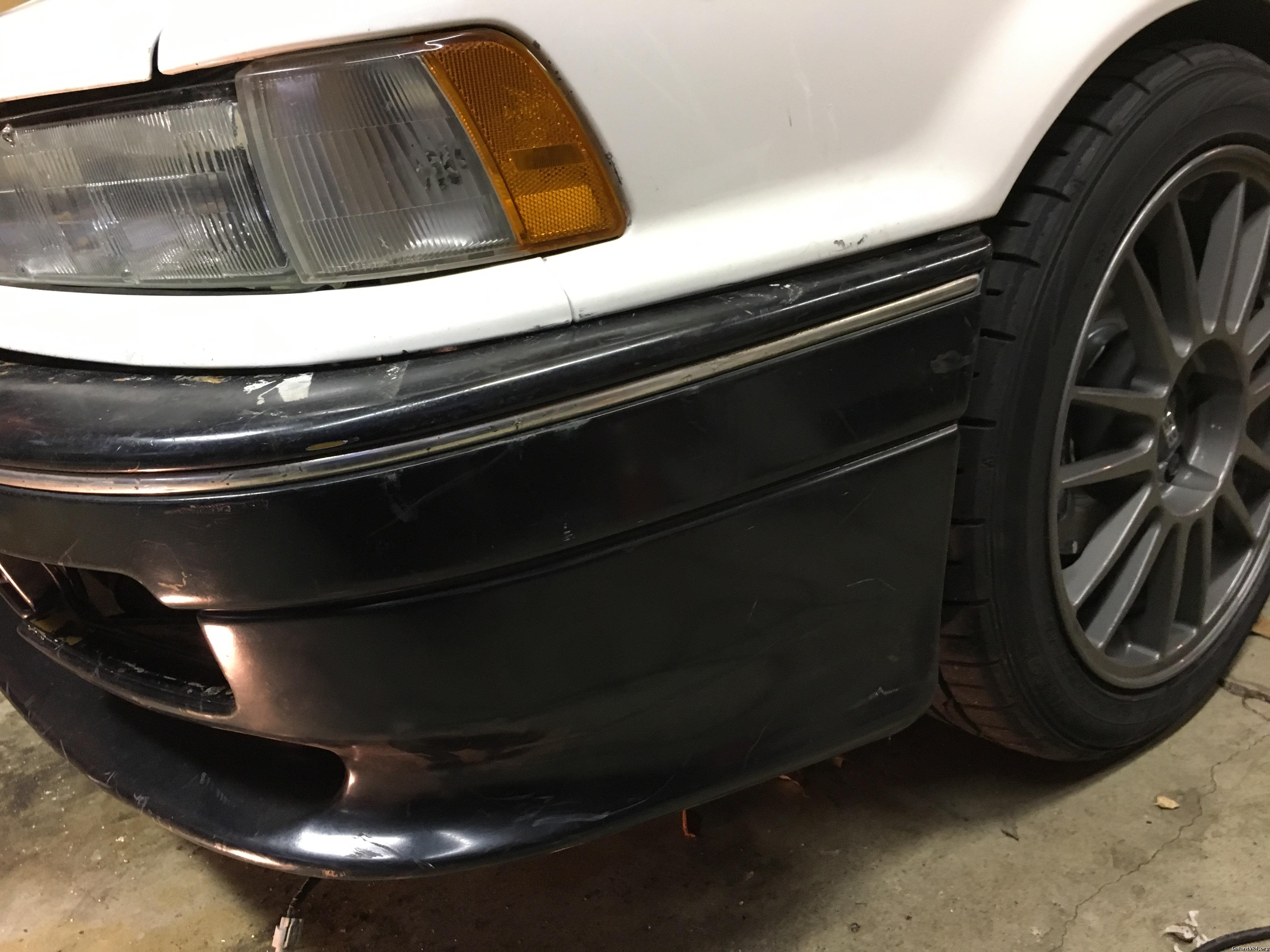

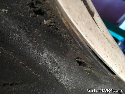

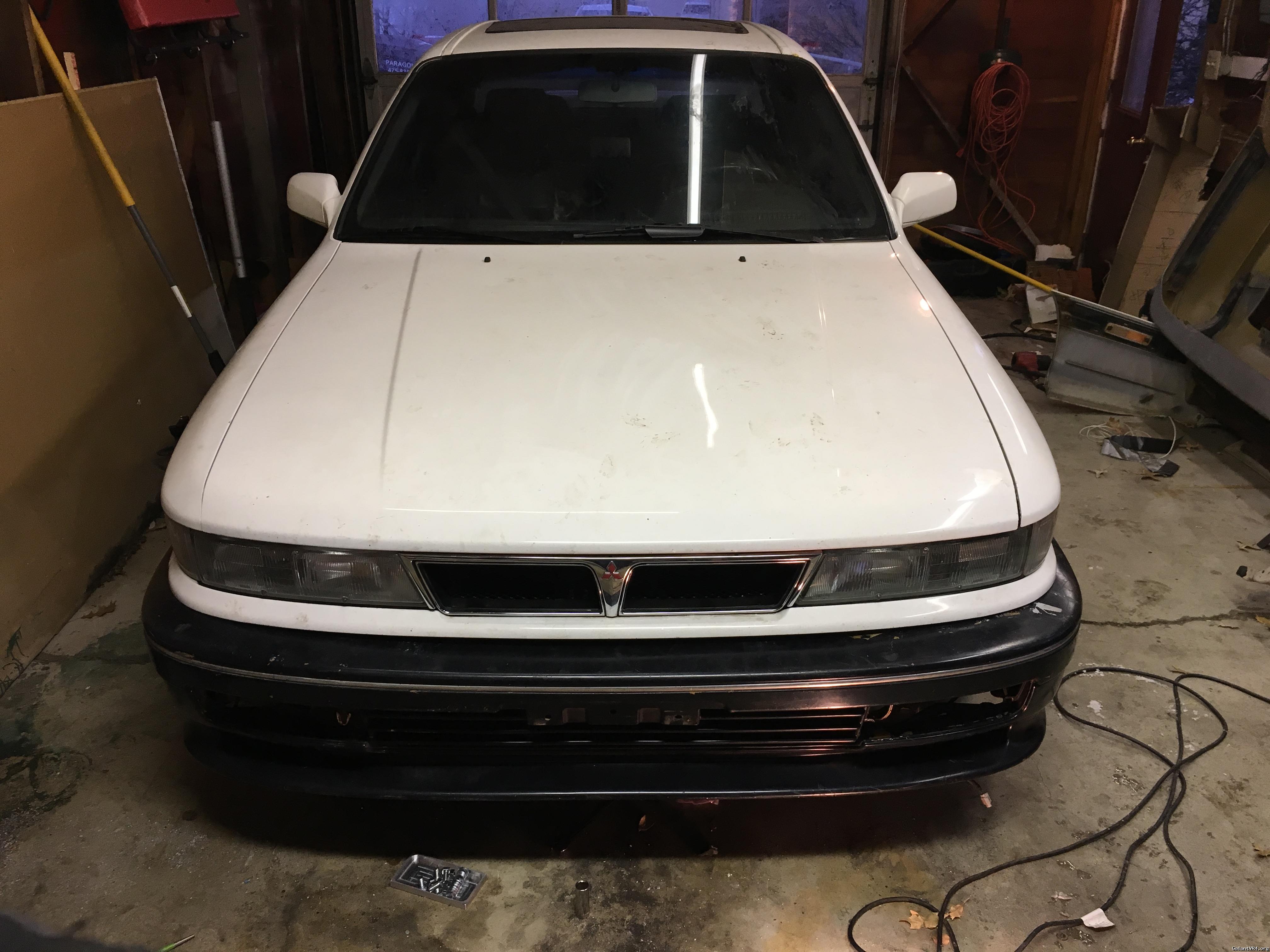

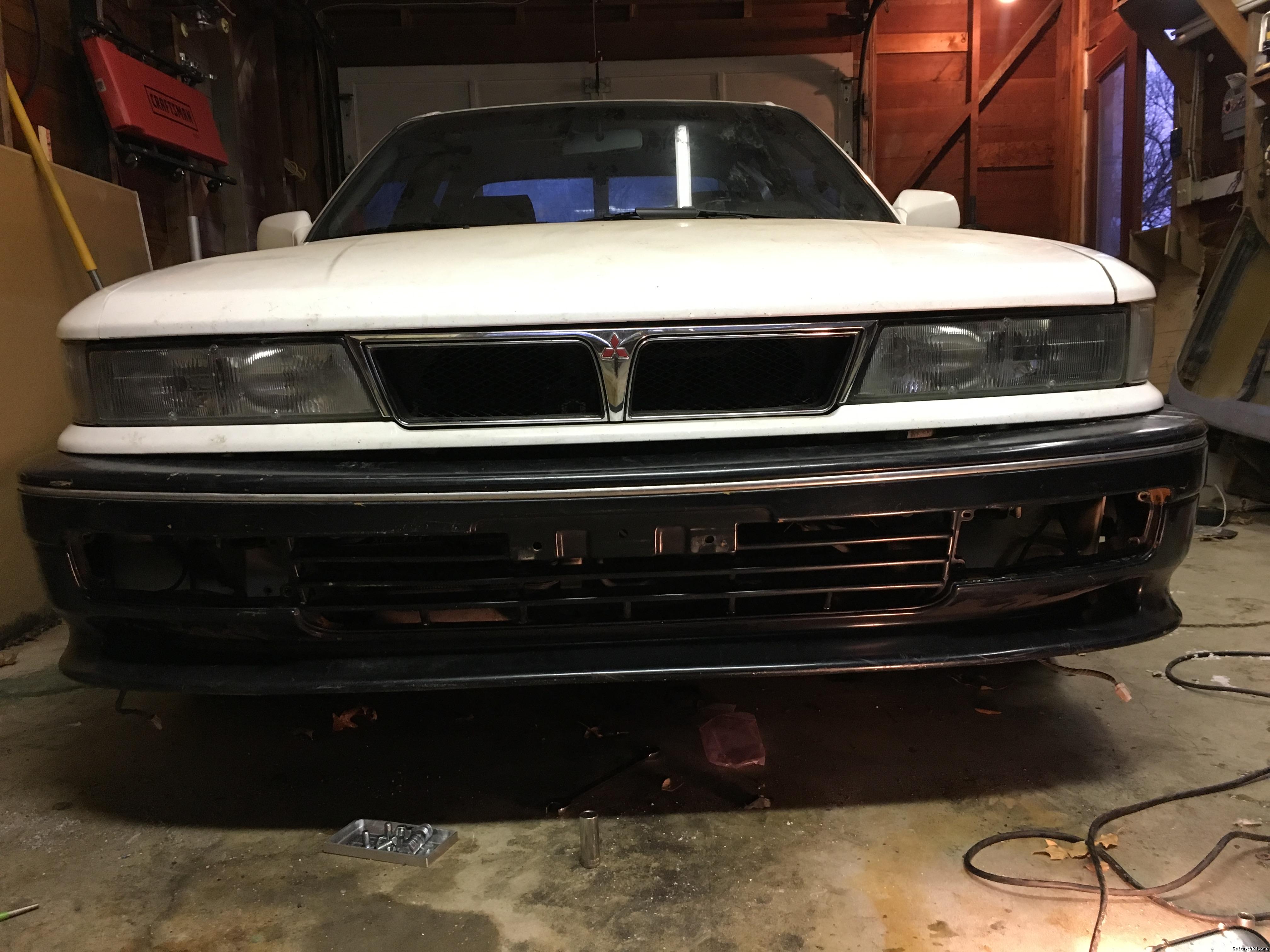

In the meantime I’ve been working on the front bumper, and getting it fitted. Ended up having to shim the brackets to get the bumper arms to align properly because at first one arm always an inch outside of the bracket when the other side was on the bracket. I don’t know why this was the case, maybe it was stored funny (on the face) and overtime the urethane “settled” pulling the arms out???
Now that it’s bolted on, I must figure out how to get the sides flushed up when the wheel well and the front top of the bumper snugged up with piece under the headlights...both seem like headaches kind of. Check out my pics.
I’ll be JDM AS F!$& in no time.
Nebraska
Apr 9, 2015
140
Lincoln, NE
Any auto body guys on here have suggestions for fixing/making the front fit better on the sides and in the front middle beneath the headlights??
3,473
You can cut some hard styrofoam to fit in the bumper channel to provide some bracing in the areas where it is sagging. You can also use a heat gun to try and shape the plastic a bit.
Looks like that bumper has seen better days. Is the factory skeleton all present and still attached to the inside of the bumper?
Nebraska
Apr 9, 2015
140
Lincoln, NE
Yes skeletons are present, that's why I'm thinking previous storing methods may have caused the sagging.
I've heard of the heat gun method. Is it pretty effective? I'm willing to try anything.
