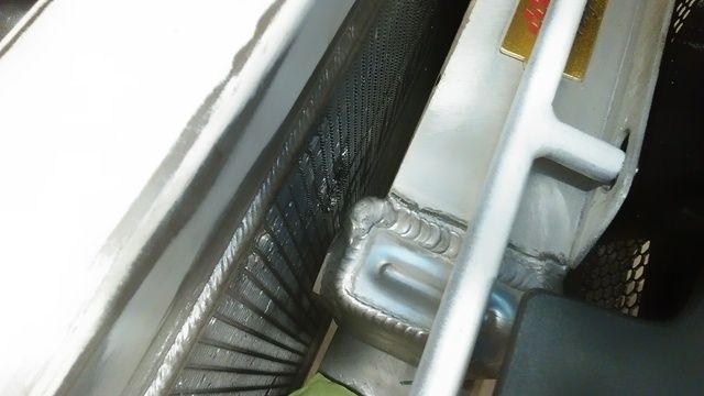

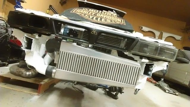

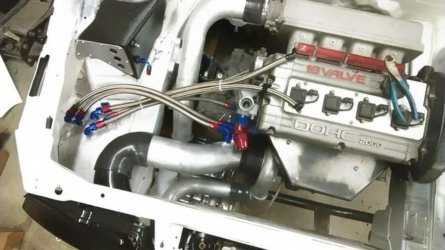

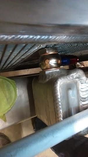

The radiator never fit right under the re shaped upper tie bar. It looked okay in the pictures, but certainly not done. That's sorted now so I was able to work on the oil cooler fittings that are WAY tight to the face of the radiator. I ended up ordering 18mm turbo coolant banjo fittings, with adapters to 6an. I was forced to weld the original bungs up and tapping the oil cooler to suit. I've got the 93 grille trimmed out, primed, and new hexagonal mesh fitted. btw- Anyone know where to get a new badge for the 93 grille? I dicked it up letting the little diamonds dry above the wood stove after painting them black. It was hotter than I anticipated ha ha
Anyway, I got a bunch of sh*t done that was a pain in the ass, but doesn't really photograph well.

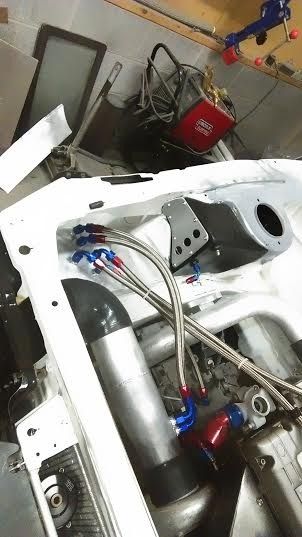

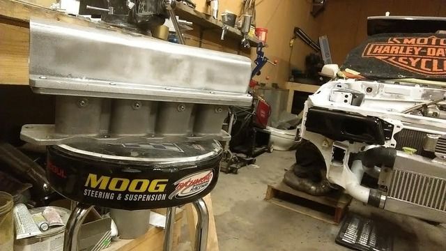

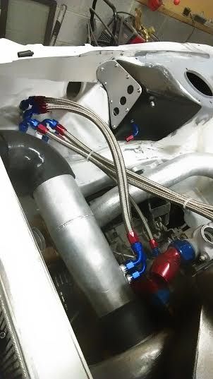

I ordered a billet valve cover, so I figured it was time to knock out the catch can. A few in progress pictures here. The top side is tacked into place now. I want to wait to get the valve cover before I finalize hose lengths and really tidy it up. I know it looks busy, but it's a necessary evil. I have two 8an hoses off the intake tube for vacuum.
The two 10an hoses off the valve cover gets stepped down to 8an as well. Finally, I have a 6an hose running to the balance shaft port on the back of the block. Which I think is pictured above somewhere. 6an is smaller than I want, but I don't want to drill the block out with out taking off the current oil pan. I fully expect the oil pan to come off by itself in a glorious display of catastrophic failure, probably due to a shitty tune on my part.
However, that is when I intend to put the 2.3L in which has an enlarged hole.
Oh, you can see the coolant overflow is finished now. The three holes in the front are actual portholes into the can to act as sight glasses.

About damn time! Glad to hear you are getting back on it. Hopefully you can leverage your new job to help with the paint/body here. Anyway, looking good, particularly the grille and "lamps"/compressor inlet strategy.

I did a front mount,3" turbo back,pod filter,and a boost gauge. 255's on all 4 corners on 17" a8 Wheels. Just an ebay knockoff bumper.

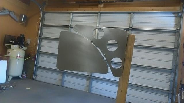

Not a massive update for this weekend, got side tracked a bit making a sign.
My new office is not marked, and customers don't know where to go when they come in. I asked my boss about having a decal cut to put on the door. He mentioned maybe having a sign to hang above the door so it may be a little more noticeable. I agreed, and he finished the conversation with, "now we just need to get someone to make it" I was like /ubbthreads/images/graemlins/confused.gif
I sent him a picture of the sign today and asked him if he was trying to insult me when he pretended we'd have someone else make the damn thing.
He "had no idea I made stuff like that" Anyway, he likes it and is going to let me hang it up. So that's a plus.

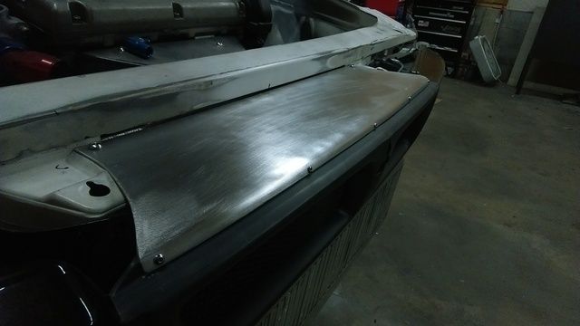

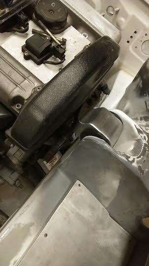

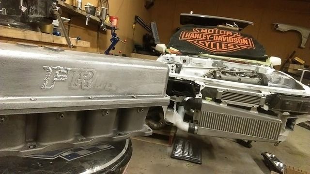

I worked on details today.

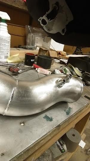

Finish welded the intake bungs
Now that's fitment-

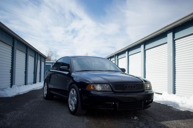

Audi pics are up No rear shots though. My exhaust fit is horrendous,my tips are crooked but I just haven't given enough fucks to fix. The trunk lid is debadged , and my tail lights are all red. Other than that it's stock back there so use your imagination.
