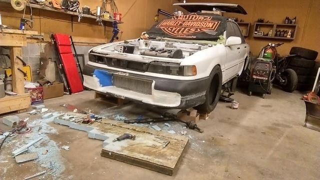

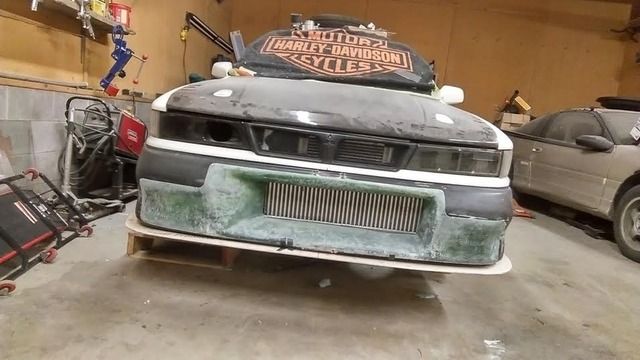

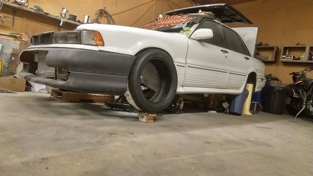

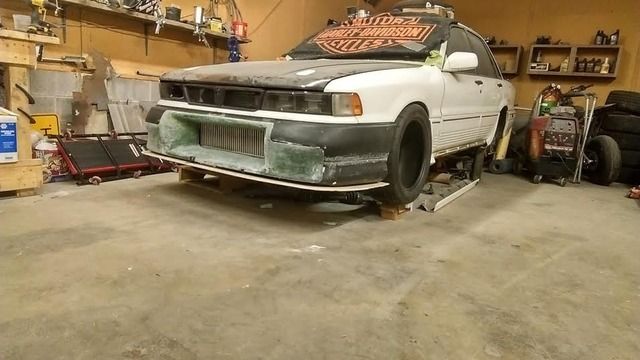

un f***ing real!! kinda love it. now you need a much much larger intercooler or an intercooler/oil cooler combo to fill in the giant hole. i want a straight on shot.
15psi88
Aug 19, 2009
101
State College, PA

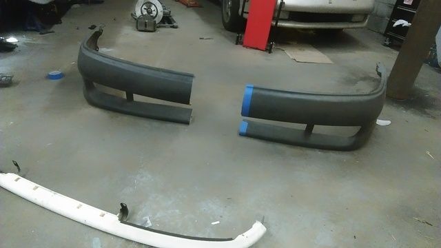

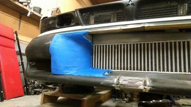

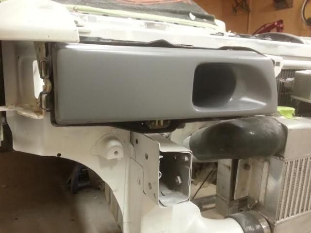

Lots of work to do on this yet. I should have waited to post. I know it will be impossible for some to visualize how it will look when complete.(I'd agree right now it looks horrid) I've got to take almost two inches from the height of it, which will make the opening much smaller. I will be making a "funnel" type insert to fit into the opening that will force air through the intercooler.

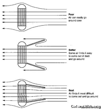

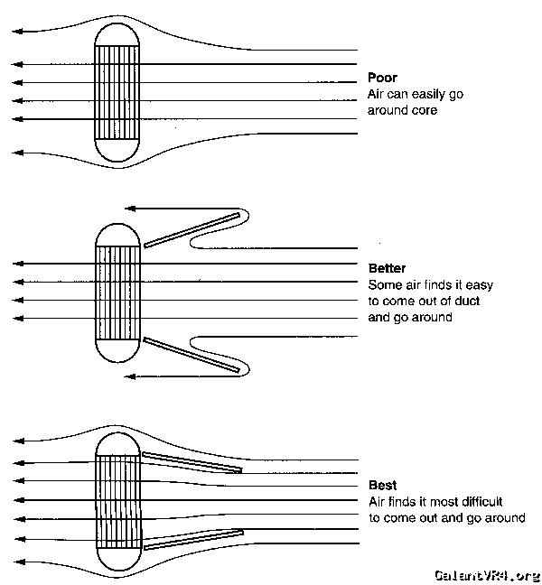

Kind of like this:
but with a larger transitional area so it wont look as boxed off. I guess it's the same idea as the headlight inlet really..

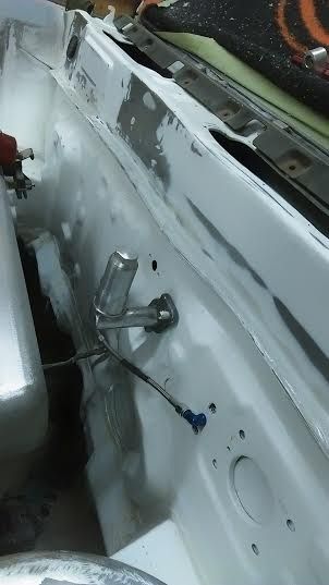

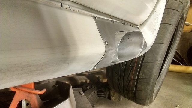

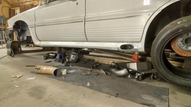

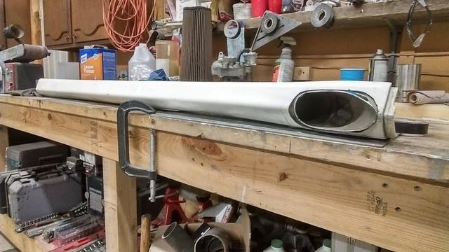

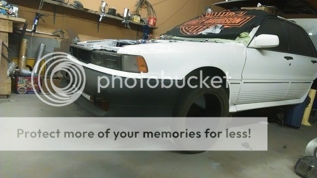

Yeah the exhaust will exit through the rocker. I had some rust there anyway. I figured if I was going to be doing metal work I would make it worth it.
I'm going to level the floor with the transmission tunnel behind the drivers seat to get the clearance I need. You'd better be short if you sit back there.

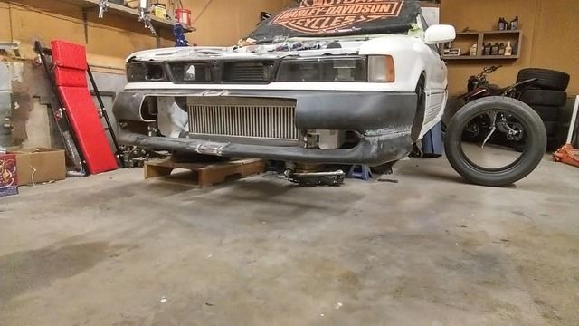

Looks good, different from the common bumpers. Something to keep in mind fwiw if you really want the best ducting to your heat exchangers.

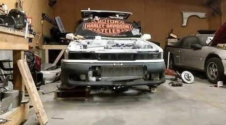

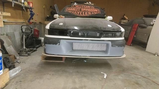

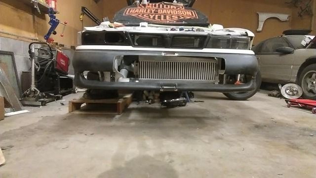

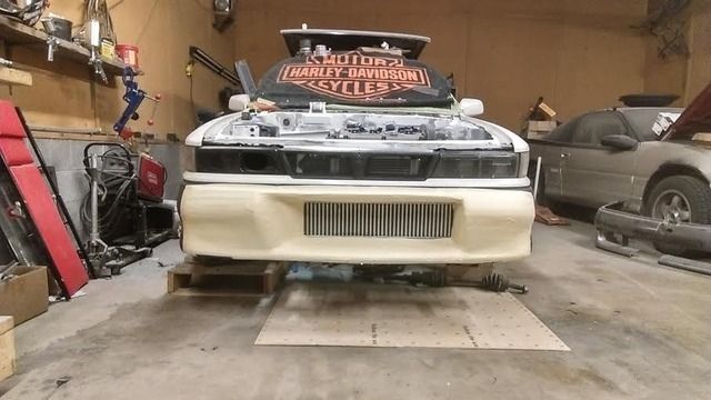

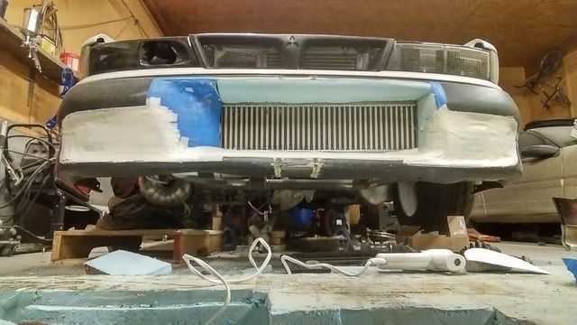

Little slower progress than expected but I haven't stopped.
The insert is body worked and primed. WAY WAY WAY more work than what you'd think to look at it, but it looks MEAN AF.

How's the exhaust routed to the side skirt? Guessing you'll have to wrap it where it meets the plastic?
