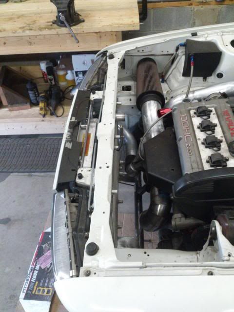

Looking great so far is that a 3in down pipe? ohh yea and what's up that spaghetti farm inside your car what's happening there /ubbthreads/images/graemlins/confused.gif

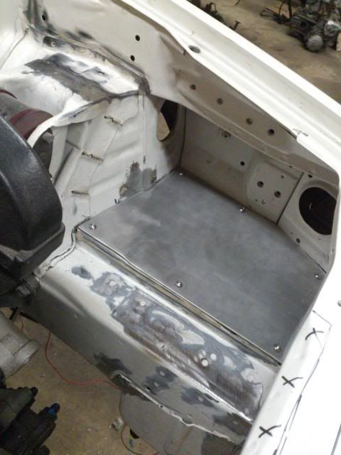

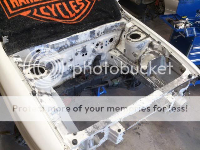

The exact routing of the factory chassis wiring harness escapes me now but, the reason for the spaghetti farm is that the harness used to run out the drivers side a pillar, across the front under the radiator, and over to the original fuse block mounted on the shock tower. I moved the fuse box behind the glove box. "Phase 1" so to speak, I lengthened the harness and ran it inside the passenger side a pillar. Ultimately the wiring harness did a large loop the whole way around the engine bay and back into the passenger compartment.
I removed the dash to remove the HVAC equipment and decided I would shorten the harness.
At this point, two separate harnesses run inside each fender well to (L/R) headlights/cooling fans etc. MUCH cleaner, much more simple.
The PO of the turbo I know had the compressor cover powder coated, but no mention was ever made of ceramic coating of the hot parts. I would guess that it was factory FP applied.
I will be ceramic coating all my hot parts in black anyway, which is why I never thought much about it.
The downpipe is 3.5" btw.

So many one-off mods and parts on this build. Great work. Are you going to stick with that GM MAF setup?

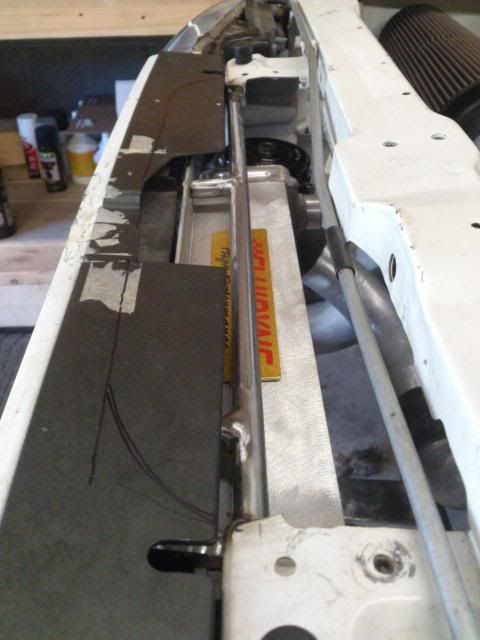

I assumed by asking the obvious you were hatching a plan to negate my usage or need for an oil cooler so I made something up to foil your plan.
3,478

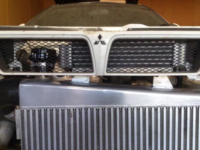

I'm not sure how "obvious" it is, seeing as it's located in the grille. As far as plans go, you got me all wrong, brah. If I were trolling you, you'd know it. I suppose my question should have been: Why are you mounting an oil cooler in the grille area? The front bumper area would have made it too easy for you, or what?

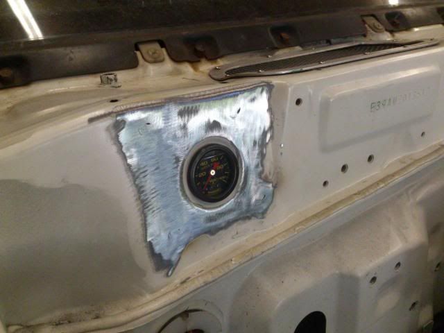

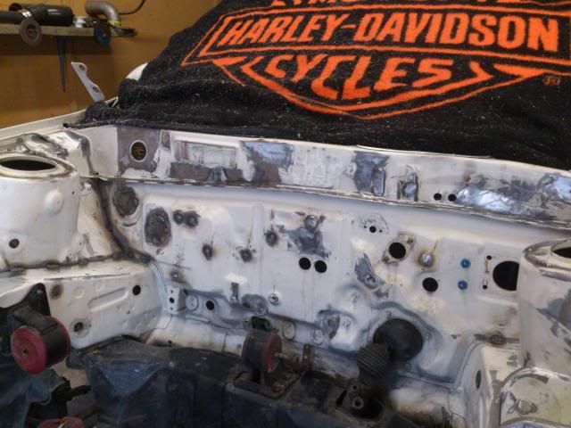

Thanks. I'm hoping the hidden motor mount hardware doesn't come back to haunt me.

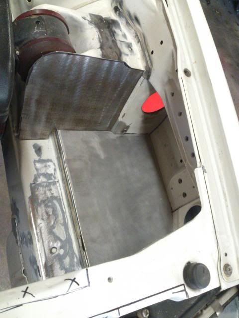

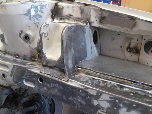

I know it looks rough with half the paint missing at the moment. Since I stitch welded all the seams I plan to dress the welds smooth and re-seam seal over it to blend it like factory.
All the unused holes have been welded/are being welded. Including the hole where the factory engine harness entered the bay.
The upper radiator support was miss-shaped and always set my ocd radar off. I'm working on making it nice and uniform now that it doesn't need to house the hood latch support/prop rod etc.
I can't wait to get it under primer and get a better look at how smooth it's really going to look.
