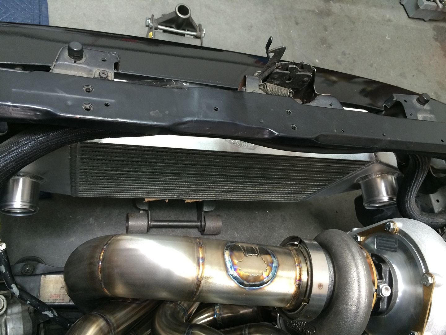

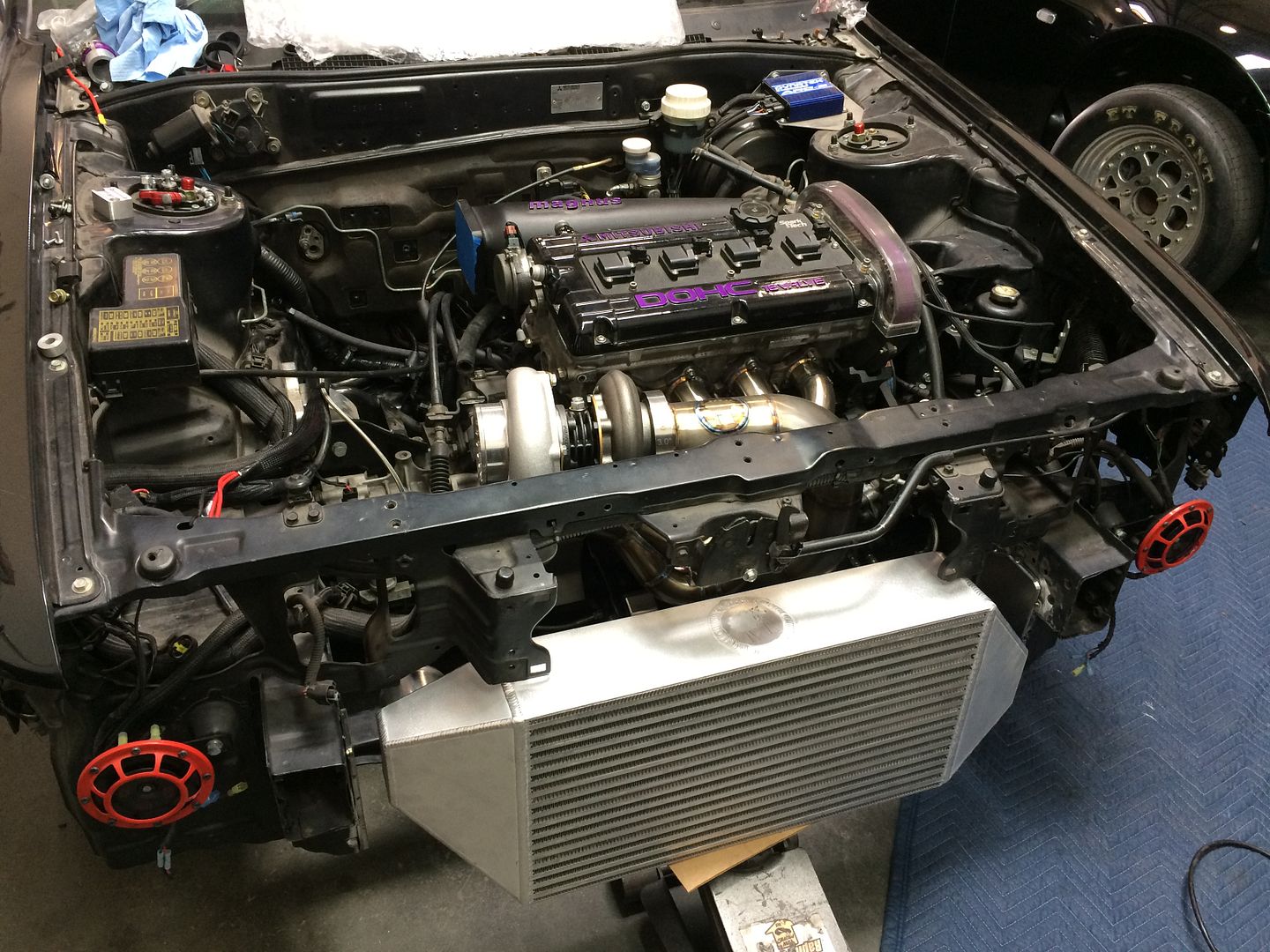

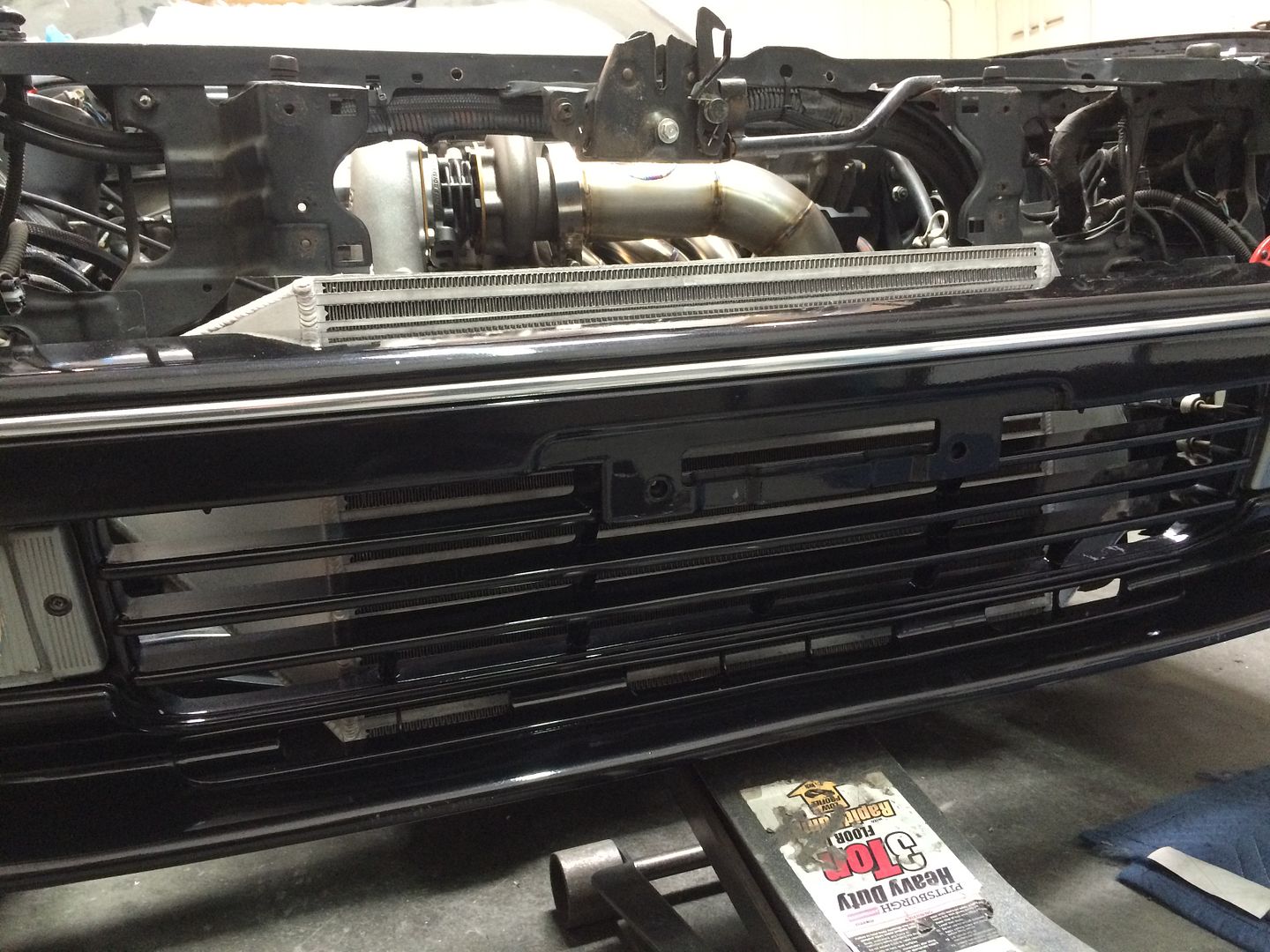

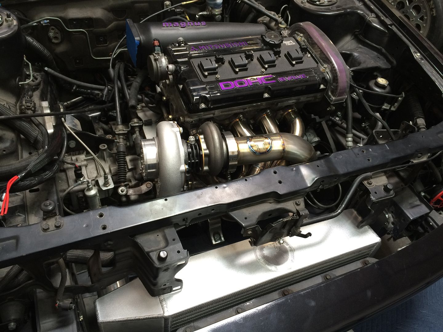

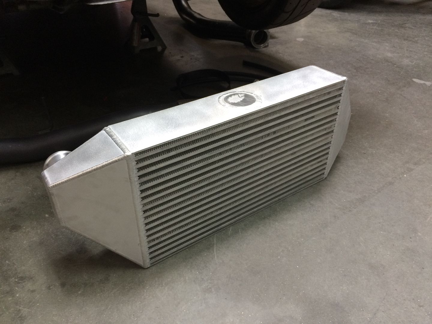

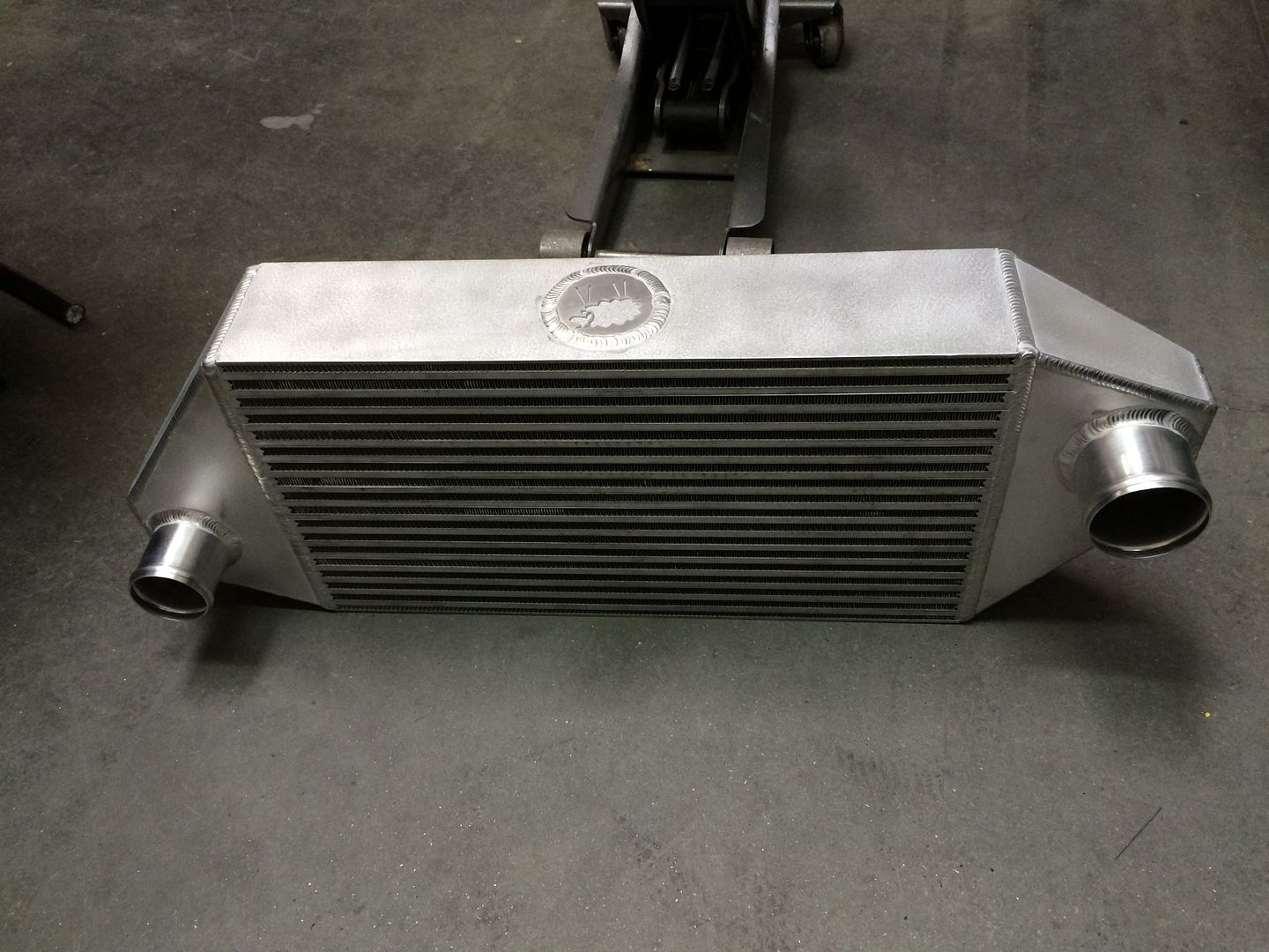

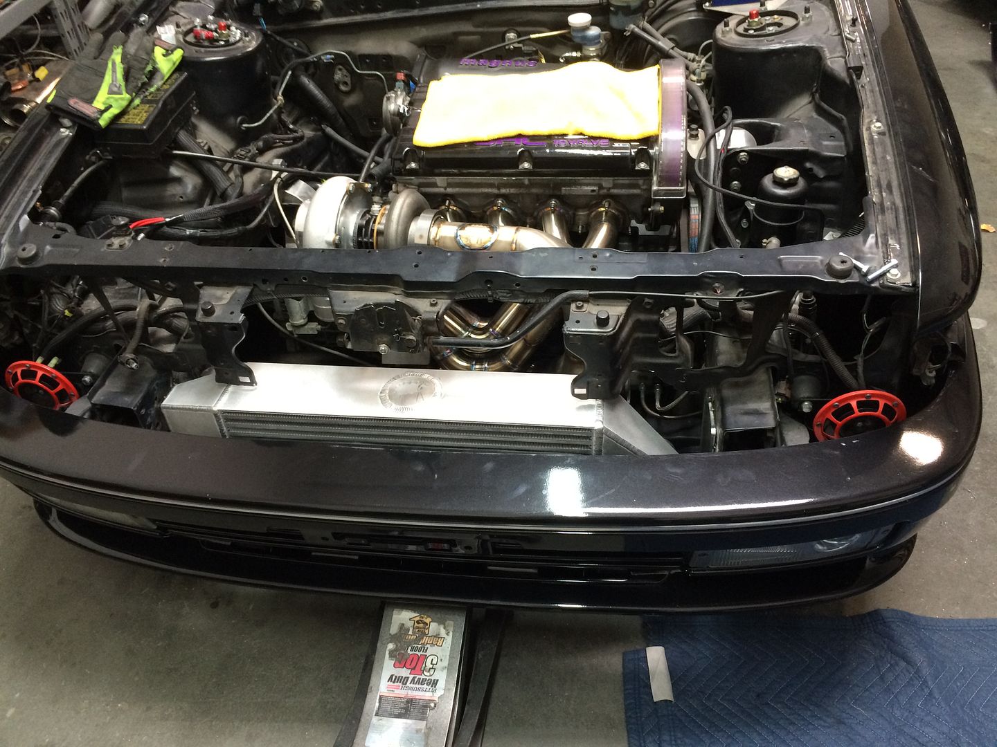

More progress! New intercooler is 4.5" thick. It's starting to look like a car again! Not long now till it's running again... /ubbthreads/images/graemlins/grin.gif

That is f***ing done the right way. Nice build.....I will say the exhaust manifold and the cast Magnus is just sexy. So it's a get out and play car, Go pro your car when you do....would love to see.

The Sheepey guys do some nice work. Manifold looks insane.

Beautiful all-around build man! Welds look like they were done with an orbital, pristine. I as well look forward seeing footage of this monster in action!!

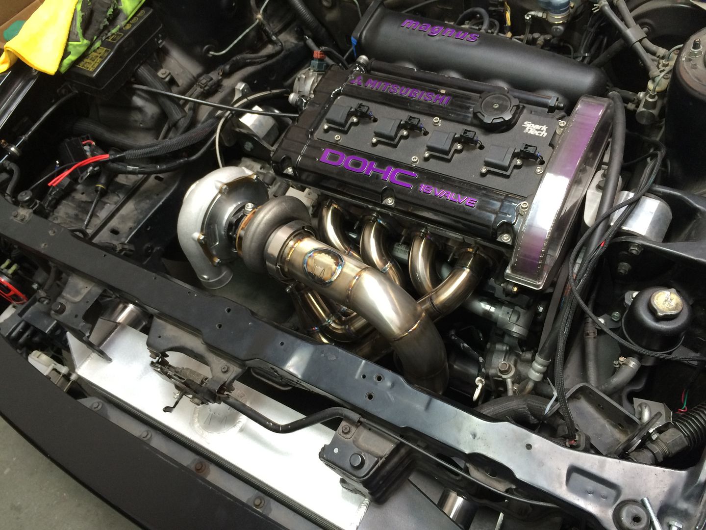

Soooo, she made a ton of power, not as much as we were expecting but still a metric f*** ton of power, and at low boost, we think the smaller .82ar turbine was the restriction preventing more boost. Anyway, it made 730hp 580tq at 35psi, falling to 33 by redline. Would have made more but the back pressure is too high with that turbine. My friend who builds crazy Hondas said a 4 port boost solenoid would do it.
The more we turned up the boost the more it would fall, which is why we think there's a restriction, and the turbine housing is the only thing that would be it.
I'm very happy though, car is insane and I'd rather keep the faster spool with the smaller turbine then have bigger numbers and and a slower spool...
