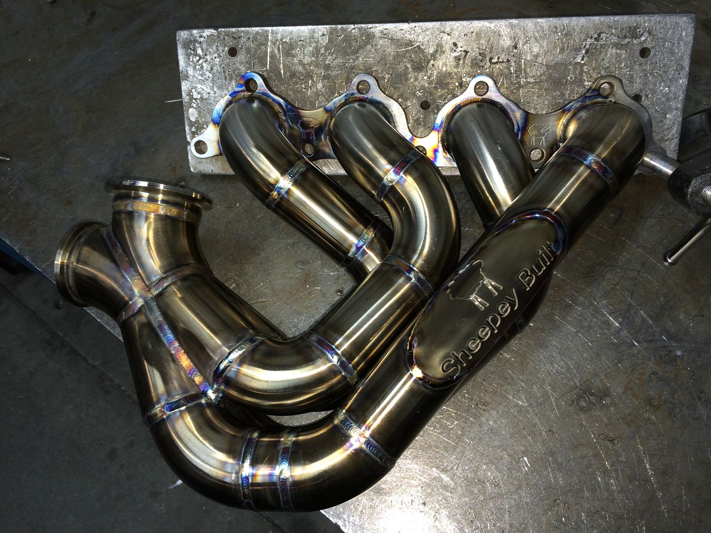

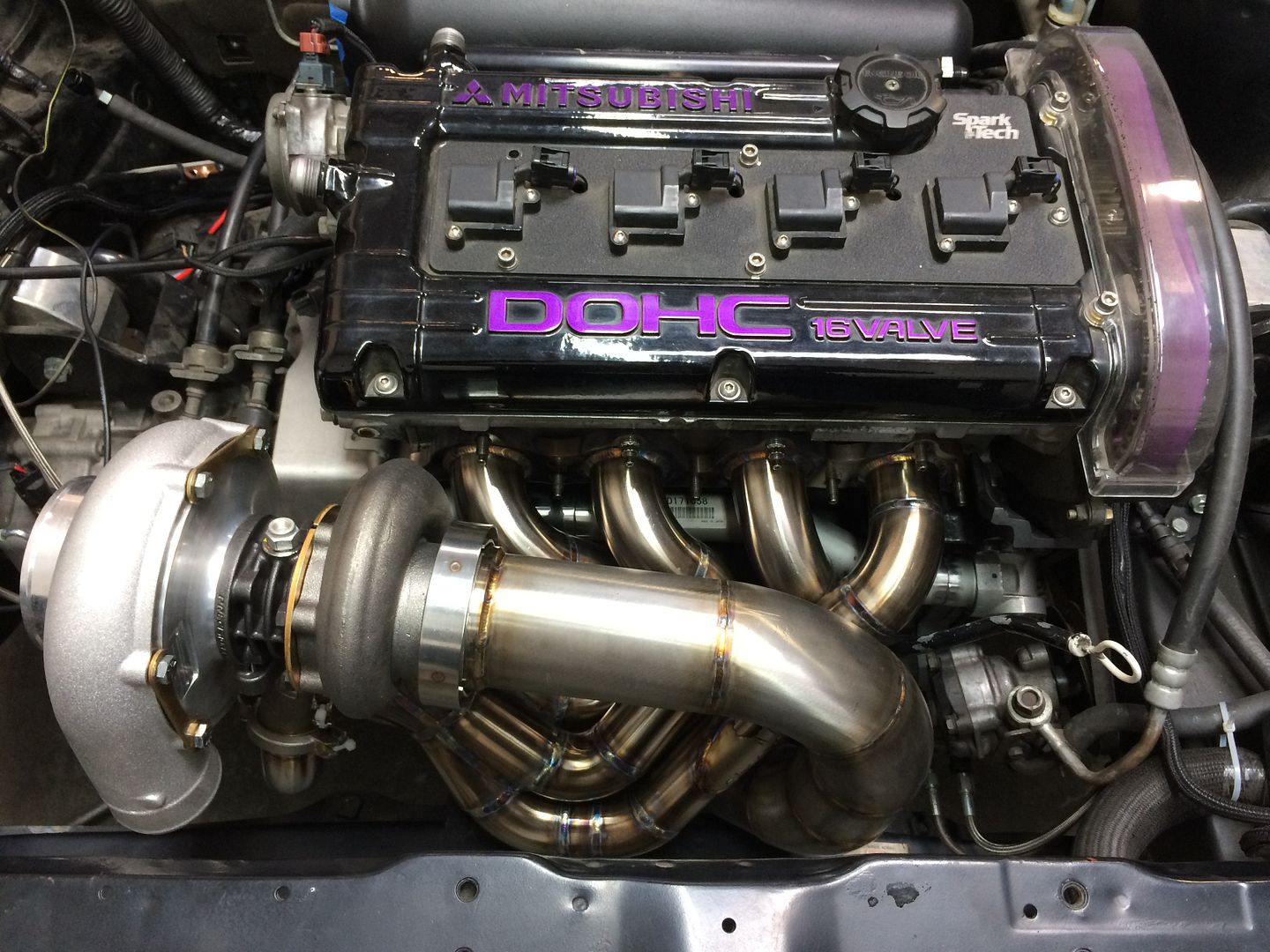

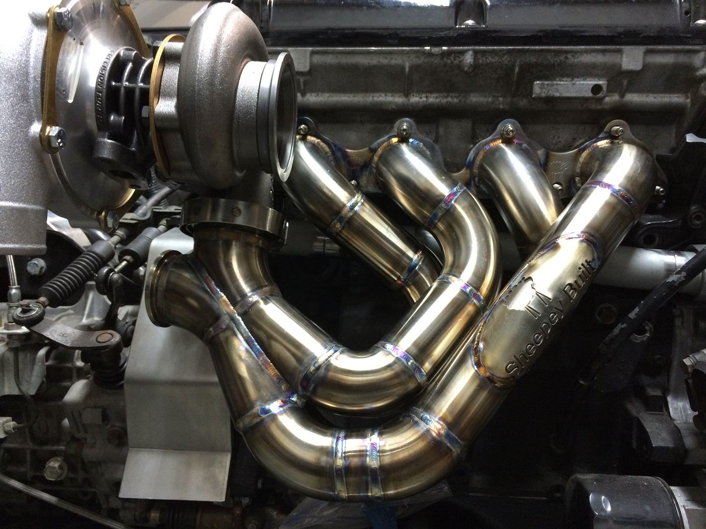

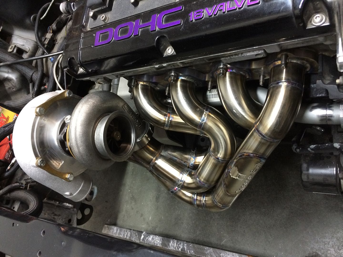

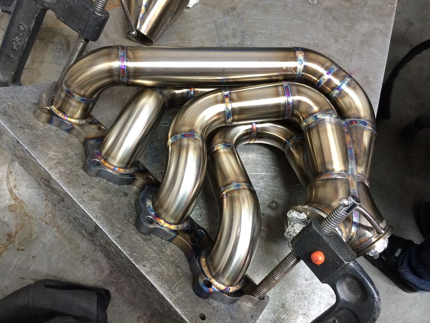

That manifold collector gave me a chubby. Very nice flow and welds.
And I think we all feel the same way Mark feels. /ubbthreads/images/graemlins/rofl.gif
Hey, how well will the oil drain clear your wastegate? Looks like it drains right on it from the angle of the pic.
I just have to clock the turbo and the drain will go between the wastage, manifold and block. I'm gonna put a heat resistant fire sleeve over it.

Looks awesome James! Almost like a badder ass black version of my engine bay. /ubbthreads/images/graemlins/applause.gif Now get thing on the rollers!
Thanks man hopefully will be on the rollers this weekend! btw I really like you car.

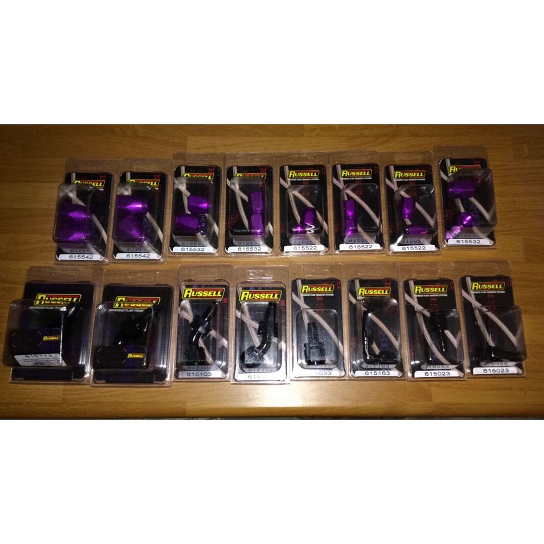

Purple fittings!

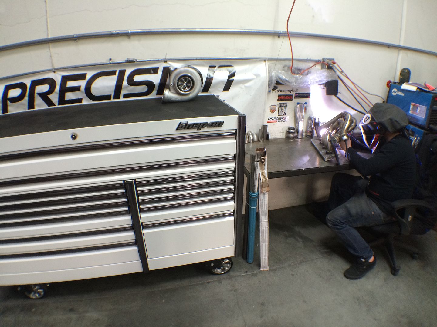

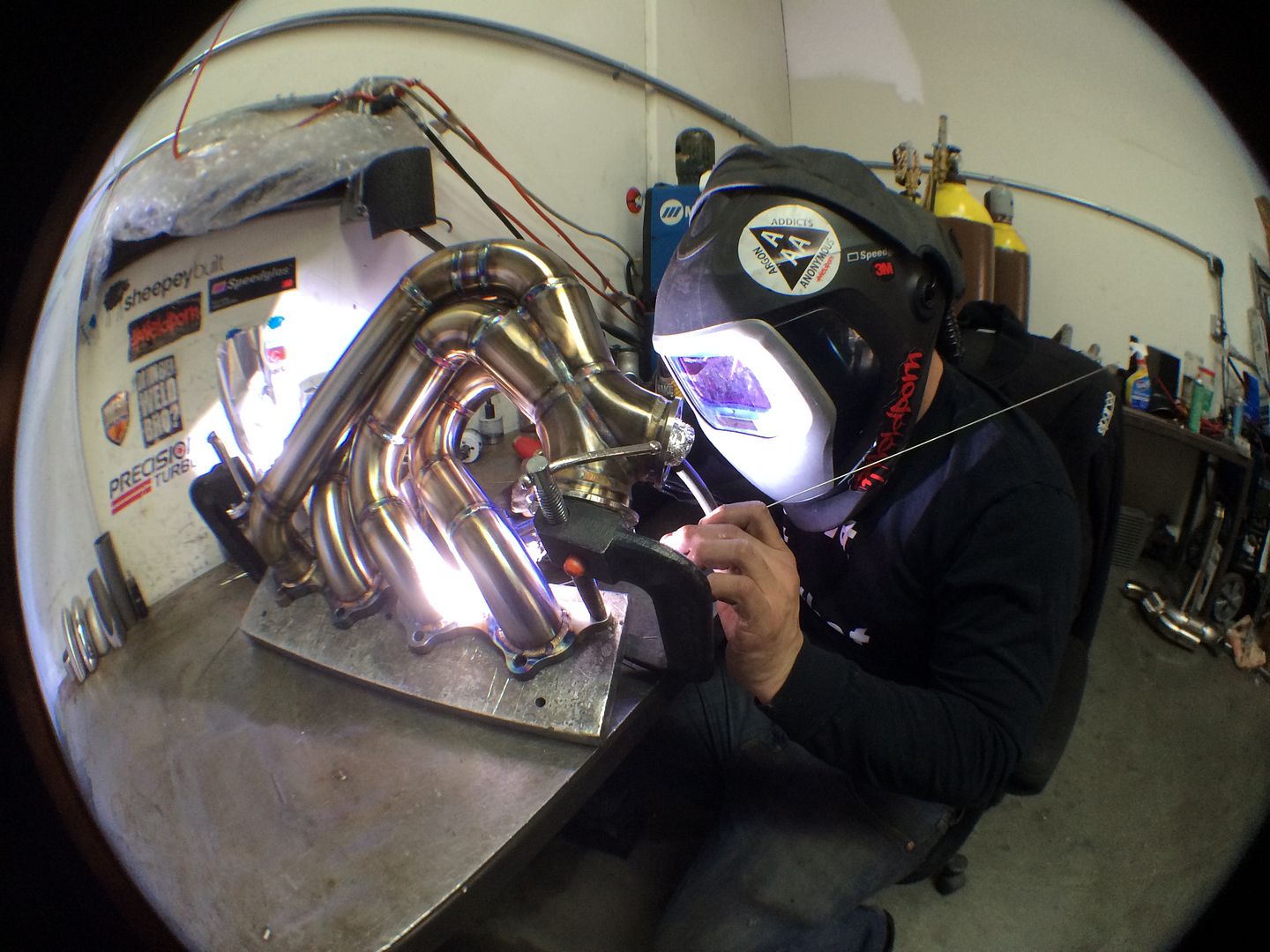

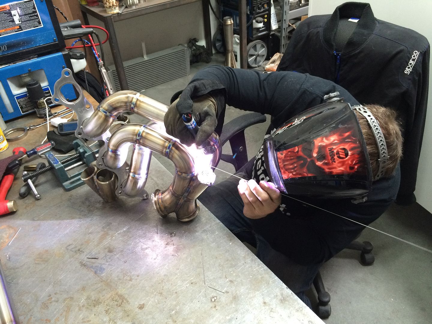

Charlie getting down. Follow him on instagram @charlieturbos for lots of fancy fab work..

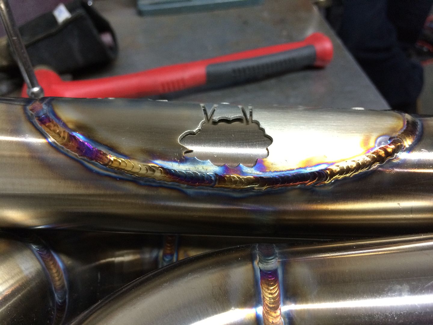

Badass manifold but the sheep logo is kinda goofy, but v band is the way to go.
I might have missed it but what fuel injectors and pump are you using? And what ems?
I can't wait to see some videos of you ripping it up in that car.

Can't get over how amazing that manifold is. Are you having a bracket made to hold up your turbo as well?

Quoting Wookalar:
The sheep is their company logo, I like it!
FIC 2150's and two AEM 320's in the tank, with -8 feed and -6 return. So hopefully fuel will not be an issue. And ECMlink on speed density.
I can't wait to take some!

Quoting coyotes:
Nah she'll be alright

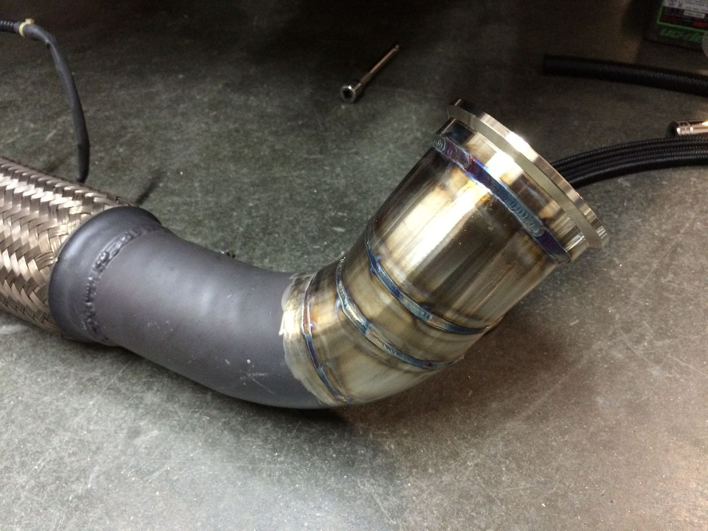

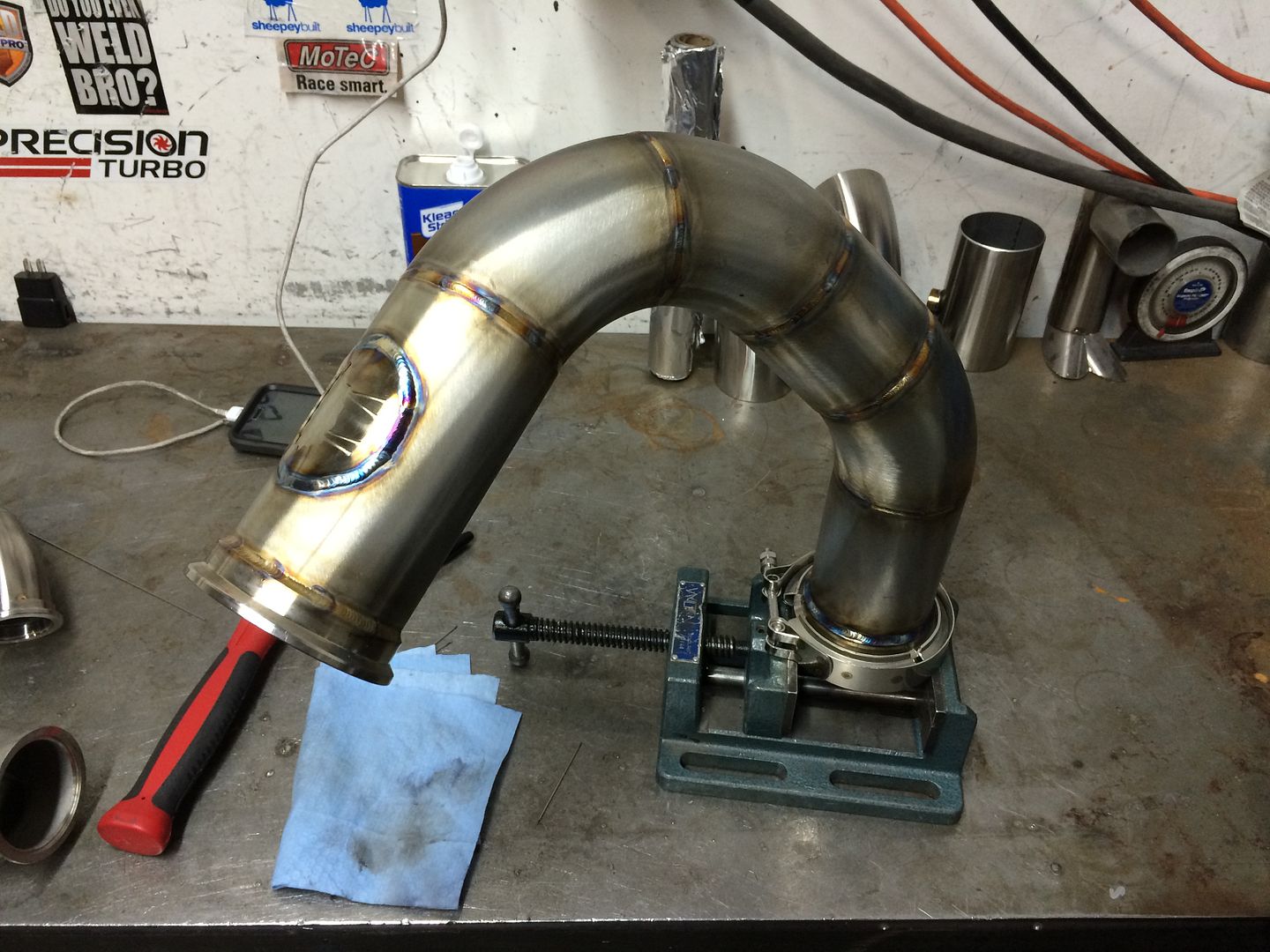

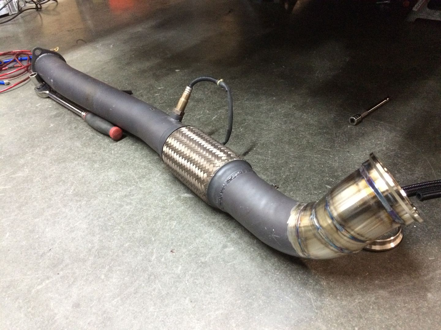

Made a little more progress yesterday, finished the downpipe and exhaust. Got rid of those 2 bolt flanges, I hate those with a passion. I'm gonna replace the other connections with v-band also.

Good job on ditching the 2-bolt downpipe flange. I did the same thing years ago and it has been a blessing anytime I've had to pull the "upper" downpipe. God I love topmounts. /ubbthreads/images/graemlins/grin.gif
