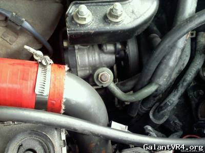

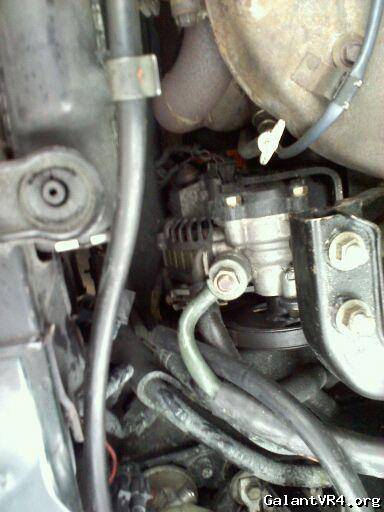

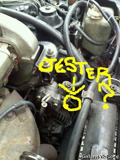

i have pictures that if someone could tell me which bolts to remove
(sorry for so many questions) but if any but could help it would be great

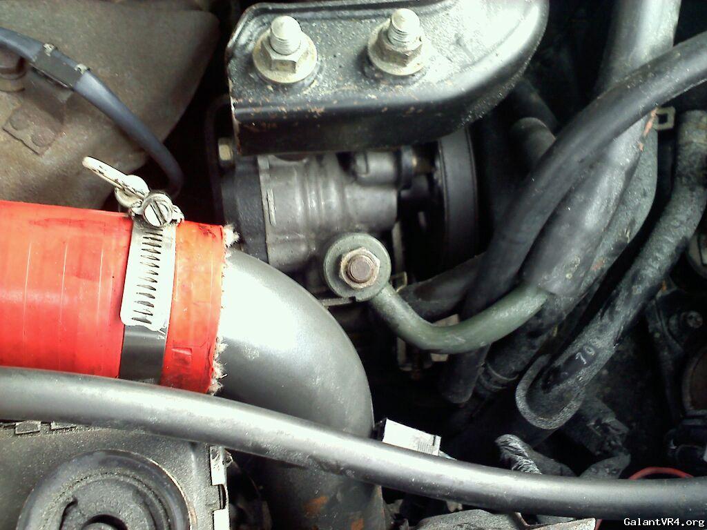

the last one is before i removed ic piping and are the three gold bolt the ones for the power stering
will post more pictures if needed

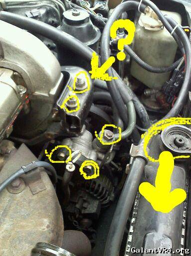

anything i'm missing

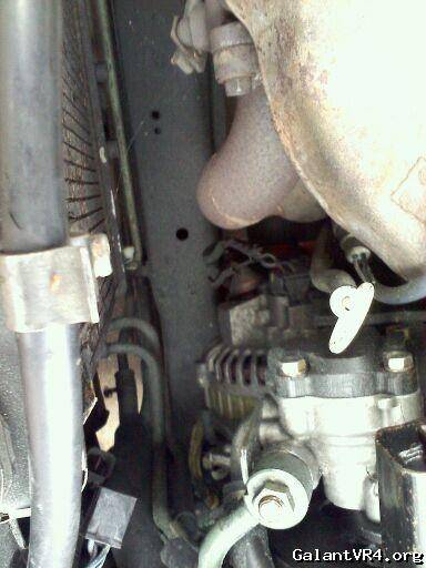

my main problem is i don't know how to remove the power steering
i undid the mouting brackets for radiator but couldent move it over any
do i have to lift it up more than 3 or 4 inches and over?

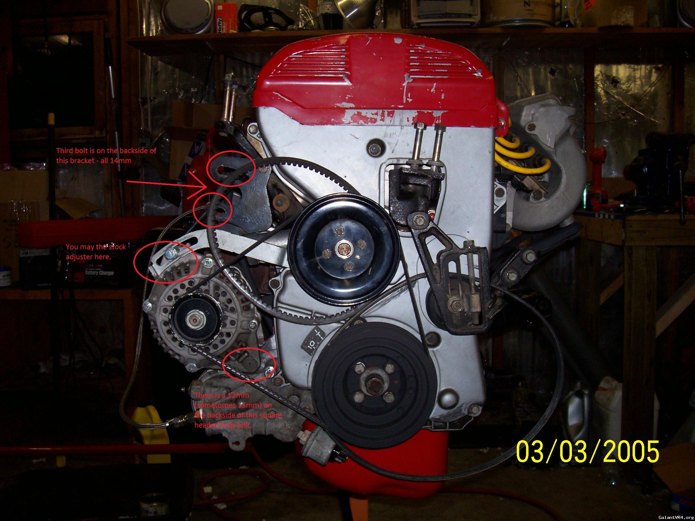

DO NOT remove those 3 power steering bolts.
There are two bolts that you get to through the pully. It has two holes that line up and you can get a deep well socket on them. They are 14mm. And a third bolt dead middle on the back of the pump that attaches the pump to the rear of the bracket.

DO NOT REMOVE THE LINE ON TOP OF THE PUMP! especially if it does not leak yet.
Disconnect neg battery terminal. Remove the hotpipe. Remove the radiator. Move the PS pump out of the way after removing the 3 retaining bolts, and THEN disconnect the alternator and remove the two bolts retaining it.
REMOVAL Should be as follows, IIRC: 2 hose clamps on hotpipe. 4 rad mount bolts. 2 more hose clamps on radiator/engine. 1 radiator electrical connector (goes to fan and sensor, pass side). Radiator. 3 PS pump bolts. Two fasteners to alternator which retain +(pos) cable. One alternator plug. One Alternator tensioner bolt. One alternator mounting/pivot bolt. Belt. Alternator.
Installation is reverse of removal.

considering that actually went threw my head as i have the pipe sitting open

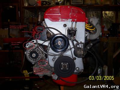

and that picture clears everything up
i thank everybody ALOT

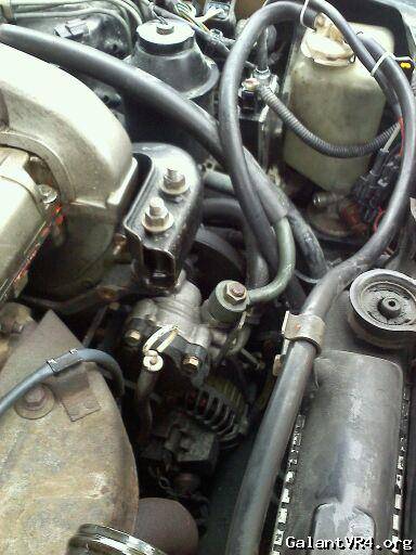

i have every bit of info i need now to remove the alternator
but the second bolt for the power steering resevoir THE PULLY WAS IN THE Way
I COULD GET ON IT SIDEWAYS AND with a normal wrench but could'nt move it past one turn in either direction
is that pully some how moveable?

Yes, if you move the radiator over, it will come out and up.
Remove the alt belt and then you can spin the power steering pully freely. That way you can line up the hole in the pully with the bolt.

should the fan have to come off the radiator?
and there is only the bottom rubber hose and the top that connects the radiator(other than the mounts)
rgeier11
Sep 26, 2004
726
Chicago Suburbs, IL
Don't remove the fan. Just remove the upper radiator mounts so that you can swivel the radiator. The alternator should be able to sneak out.

Don't pull the radiator, just do exactly as rgeier says. Remove the upper mounts only, and you will have enough play to get the alt out.
