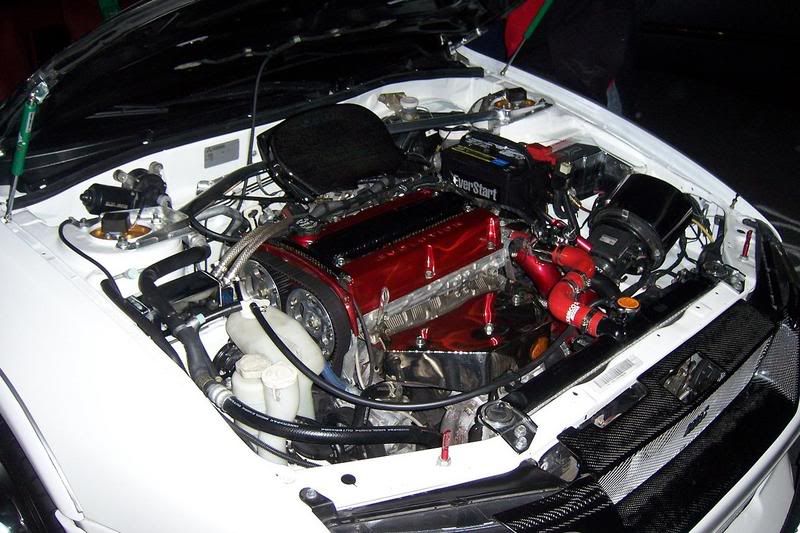

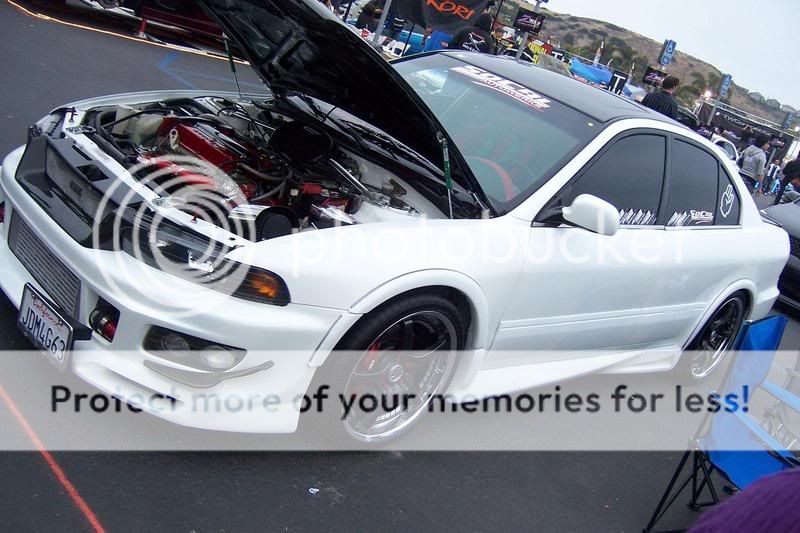

Like this guy? 2.3 built Evo 4G63T

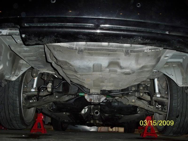

you would probably want to talk to this guy, same car as above, about going AWD, though it's been sometime since the thread was last updated (October 09')
8g AWD swap
