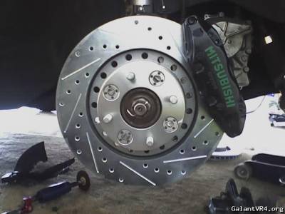

Just realized you still have the ABS rings on the front. SO needless to say you need to press the hub out of the knuckles to do the studs..

I played around with getting the spacing right. It turns out I definitely need a 10mm spacer in front. So, in the rear I'd like to do 15mm to bring all 4 corners flush. I'm just trying to decided what spacer and course of action is best at this point.

Putting in ARP wheel studs should only take an hour or two depending how fast you work. The time consuming part it just taking the brakes apart. I have done this twice with my car.
Pulling in the studs in take maybe 10 mins to do all 20 (Or 16 in your case) No need to take your hubs apart to take the to get pressed in, That's just a waste of time and money. A breaker bar, jack stand, some oil for the stud, some washers (I used 6 bolt head stud washers 2 or 3 stacked)a hammer and a wheel nut. Like I said takes all of 10 minutes to pull in all the studs.
This is how I did my Galant, Mr2, my old Jeep and countless others I have done this for /ubbthreads/images/graemlins/smile.gif
BTW If you have the ABS rings on the front still this method won't work on the car!

Wow those are expensive wheel spacers /ubbthreads/images/graemlins/jawdrop.gif For those prices you may as well install extended studs. I run 10mm spacers on the front of my MR2 and they only cost me $30 from Allstar performance, ARP extended studs (Front only) were $80 and open end wheel nuts were $15 for 25.
You over thinking about what god damn wheel spacers to get /ubbthreads/images/graemlins/banghead.gif Get ARP extended studs and normal 10mm spacers and spend a day off installing them. At least this way your setup will be more proper...

Eh, yeah, I overthink things sometimes. I was under the impression though, that extended studs weren't the prefered method here. Are 15mm spacers in the rear on extended studs still in the safe zone? Lastly, the reason I'm not picking up one of the cheaper spacers is because they aren't hub centric.
