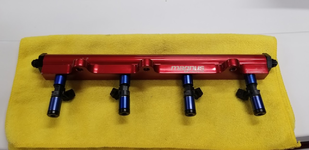

I went back to the fuel pressure regulator, and once again found increasing pressure made the car run better. At this point, I started to think my injectors were the culprit. In retrospect, this should have very obviously been my first check, but I digress. Can;t be great all the time I suppose.
I pulled the lines, fuel rail, injectors, and fuel filter, and confirmed some of my suspicions:
The filter was full of this mood dust sh*t. When wet, it was solid. As soon as it dried, it crumbled into nothing. At this point, I was convinced my injectors had ingested a metric shitload of mood dust, and needed a good cleaning. So, I sent them off the FIC, who confirmed that suspicion:
Once FIC sent me the flow sheet confirming the injectors were likely at fault, I started putting the pieces together:
1) The car sat while I was on deployment with E85 in the tank for nearly 8 months (f***up #1)
2) When I got back from deployment, I upgraded the fuel feed line with a 6an tank to rail, and swapped from a 10 micron paper element to a 40 micron stainless (f***up #2 and #3...you're not supposed to use paper elements with E85 and 40 microns doesn't filter out all the particulates).
3) The combination of stagnant fuel coupled with the 40 micron filter element let debris in the system pass into the injectors, clogging them up.
Somehow I couldn't put all thins together until this point in time.
So, got the injectors back from FIC and installed them in the car, crossing my fingers and hoping my issue would be fixed.
Additionally, I wised up and decided to run a dual filter setup to try and minimize and future occurrences of this happening. Probably overkill, but whatever. The 818 filters are cheap insurance. I decided to fabricate a Fuel Lab 818 dual fuel filter setup with a 40μ stainless element feeding into a 6μ fiberglass element (all E85 compatible this time...). The dual pass filters just before the rail should take care of any crap heading toward the injectors.
Put everything together, and used ECMlink to activate the pumps and check for leaks. With everything dry, I cranked the car up and went for a drive. SMOOTH AS BUTTER. In fact, this thing hasn't ran this good since I had it out at Streets of Willow.

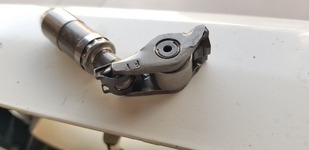

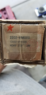

Just getting around to posting an old update. Swapped in a 272 intake cam a while back, so I'm 272 in/ex at this point. Used the olé zip tie trick because I'm old and lazy. While I as in there, added some Evo rockers and rocker retainer clips.
I was kind of surprised at how much more air the top end was flowing just from changing the one cam. I had to make a few small adjustments to the fuel tune, but overall nothing major.
