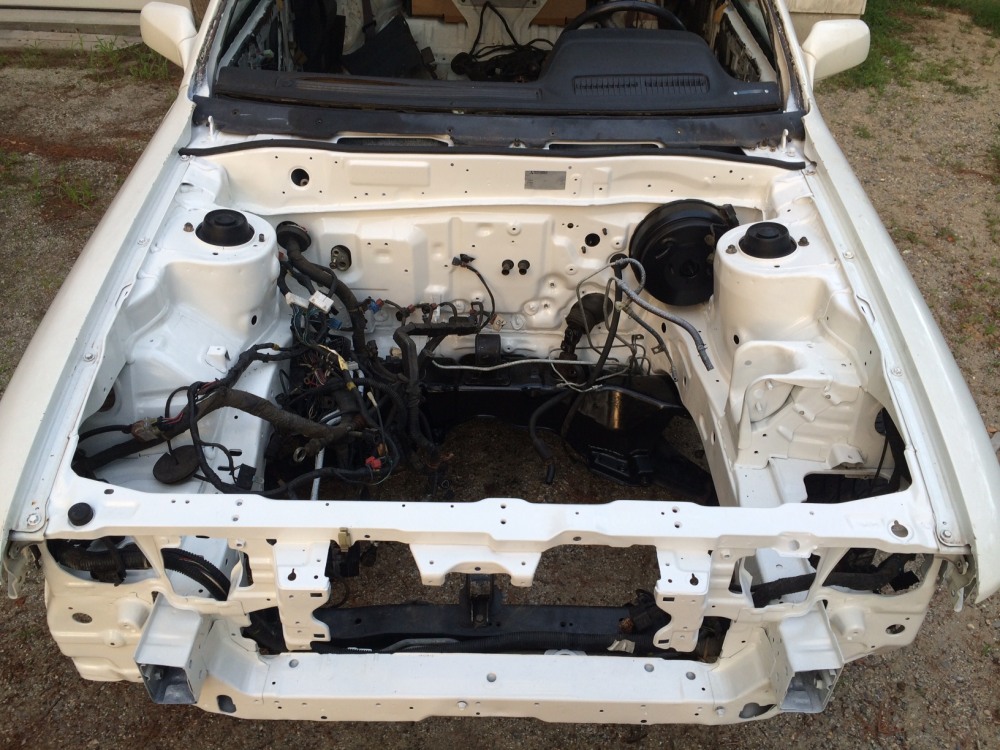

Thanks! I am definitely getting a little crazy with painting some of these brackets and things, but it will be really nice knowing that 1803/2000 will be one of the nicer ones out there!

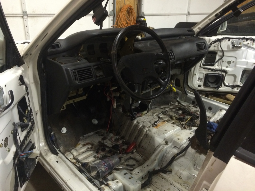

If all goes well, I should be able to get the dash installed this weekend. I'm quite pumped for that because I have never seen a dash installed on this car!

Tada! Dash is bolted in.

I am finally wrapping up my major house/life projects for the summer, which means I can exist again. I apologize for the delay, and leaving you on the edge of your seat.

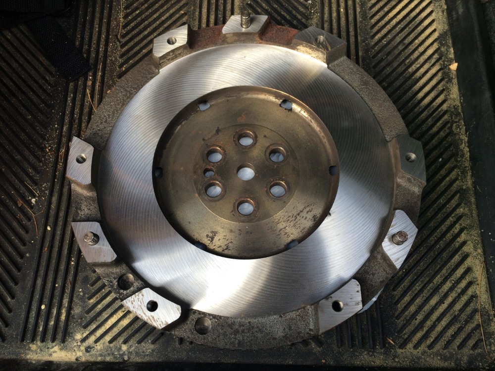

This week I got my flywheel machined so that I can finally throw the engine and trans together and stuff them into the car
I also glued the dash back together because it was lifting around the defrost vent. It worked surprisingly well. Gorilla Glue FTW.

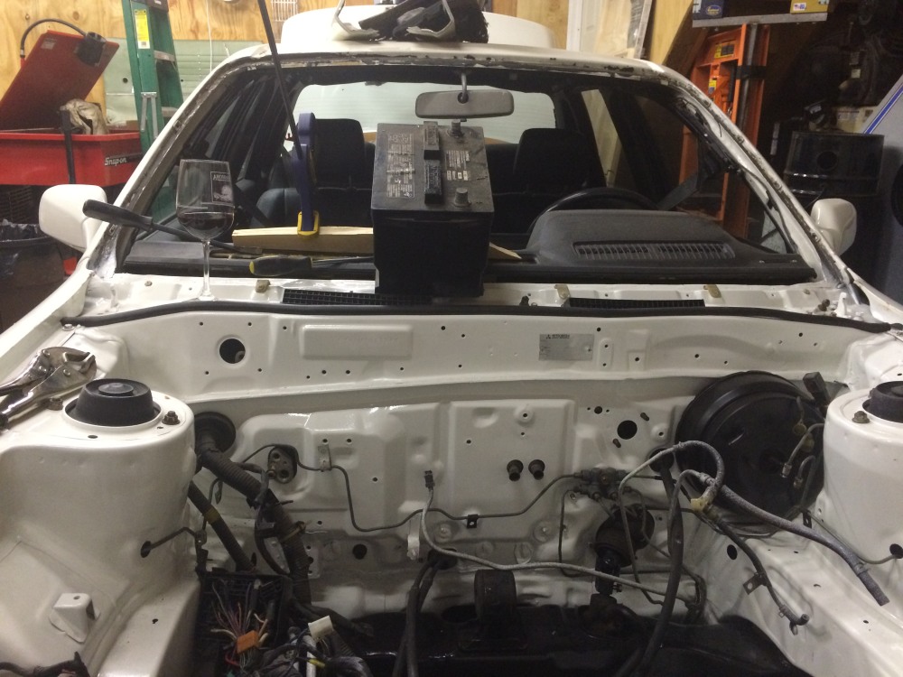

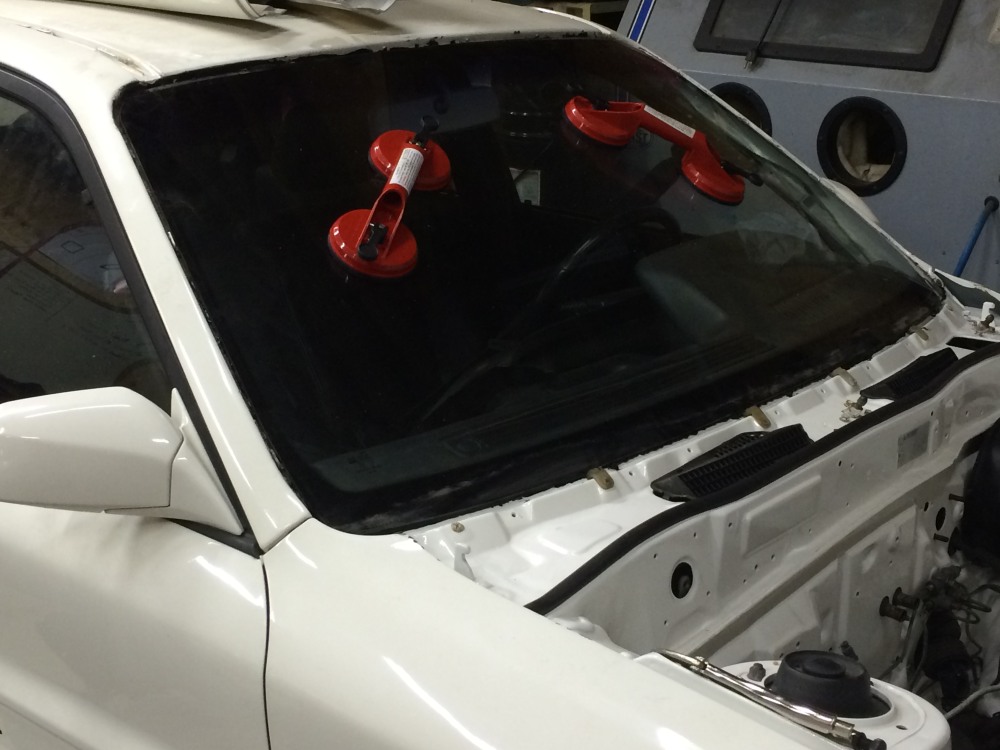

Tonight I install the windshield! First time for me. Hope I don't smash it.
4g63mightymax
Apr 6, 2013
195
MA
Done. It was easier than I thought it would be.

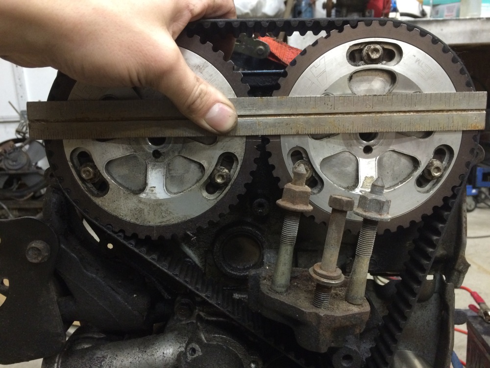

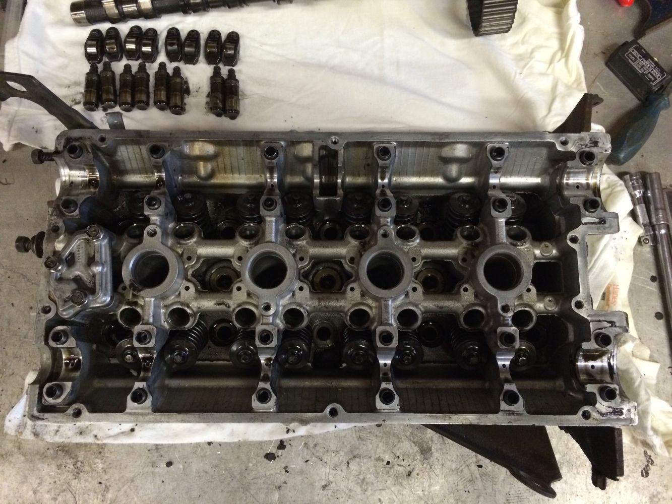

I checked my compression on the mystery engine last night.
150.130.150.100.
So then I did a leakage test. Here is the result. link
I am hoping that it may be due to the adjustable cam gears being misaligned.
Oh and here is a picture from last weekend.

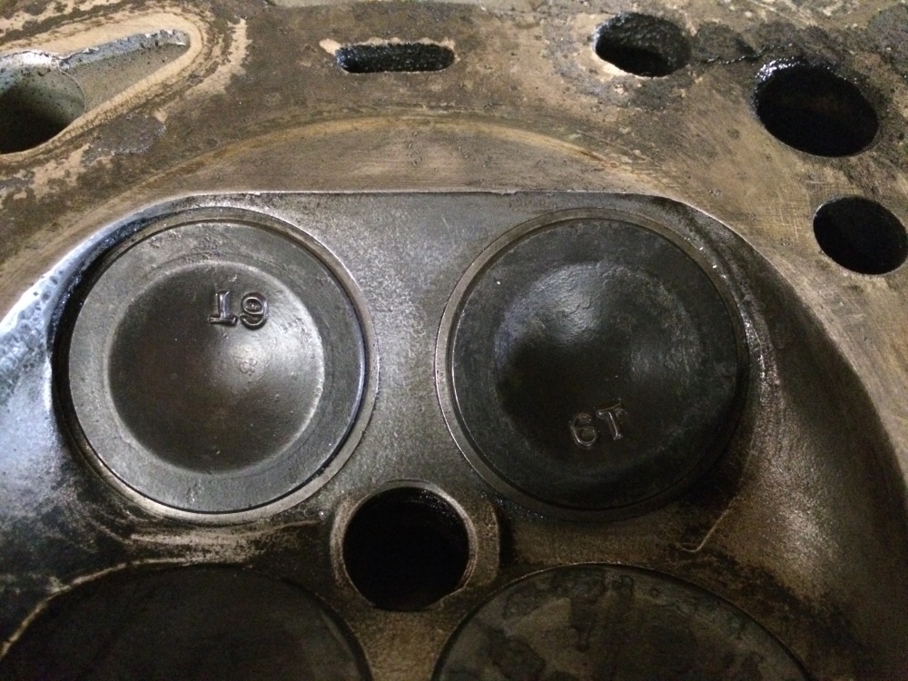

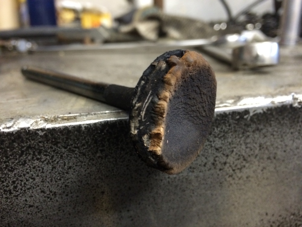

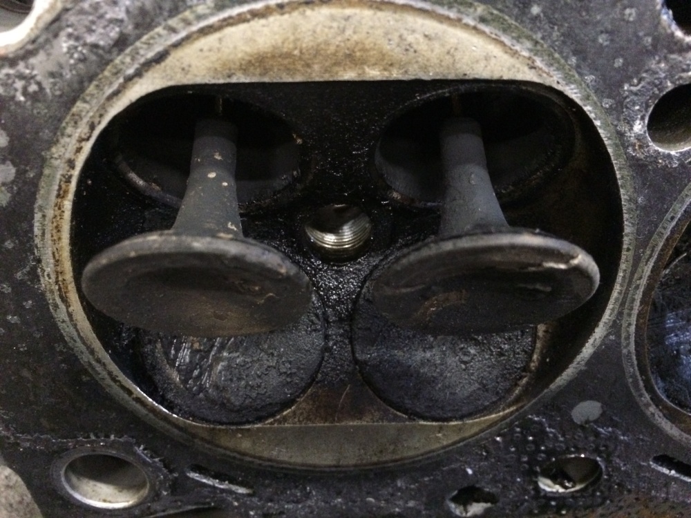

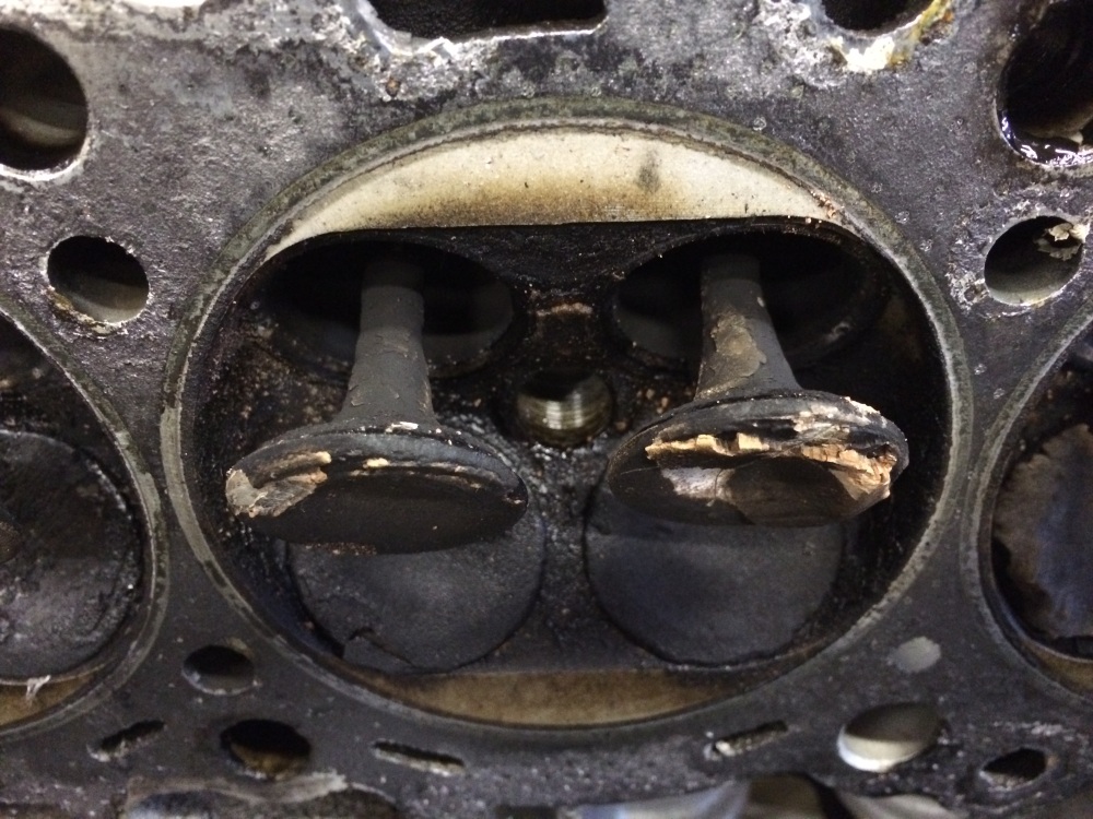

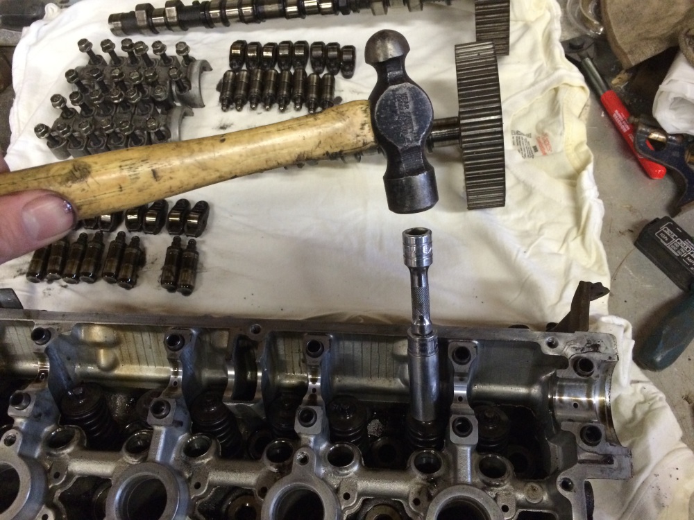

Pictures because that's what I do dogg.

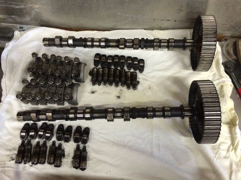

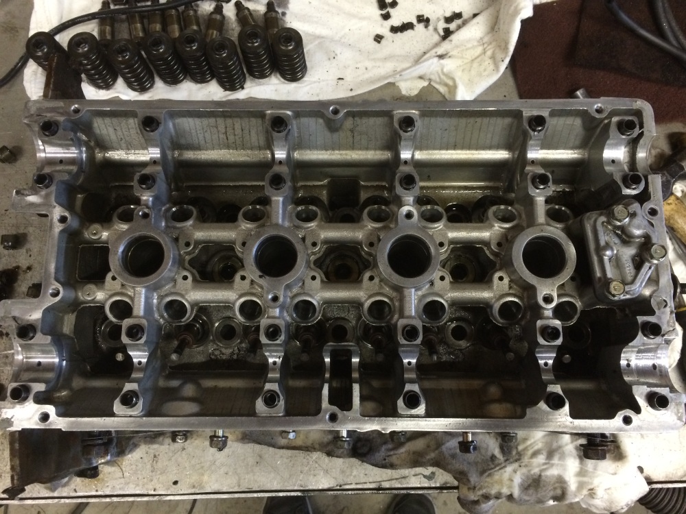

Remove cams
Organize your stuff

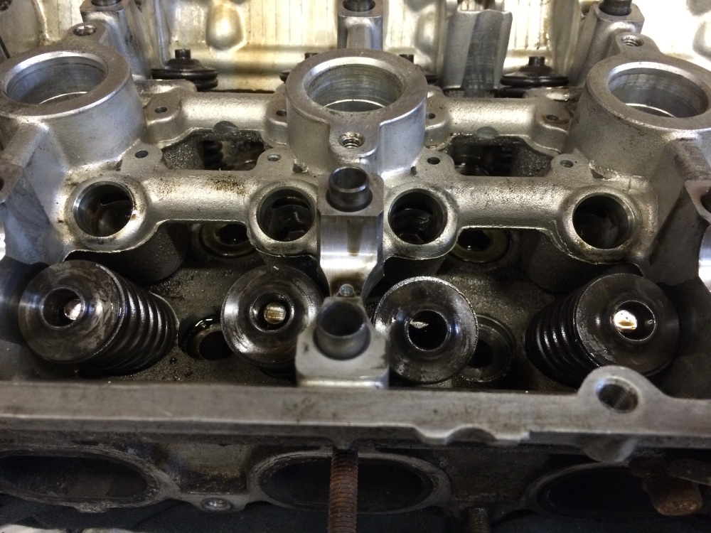

Tap the spring caps to loosen the keepers
Remove the keepers
Go to 5 Guys and eat a cheeseburger.

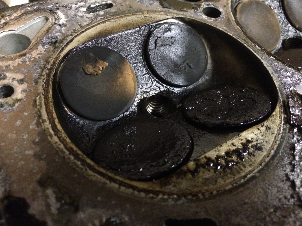

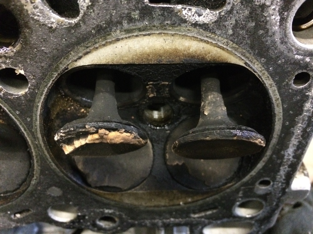

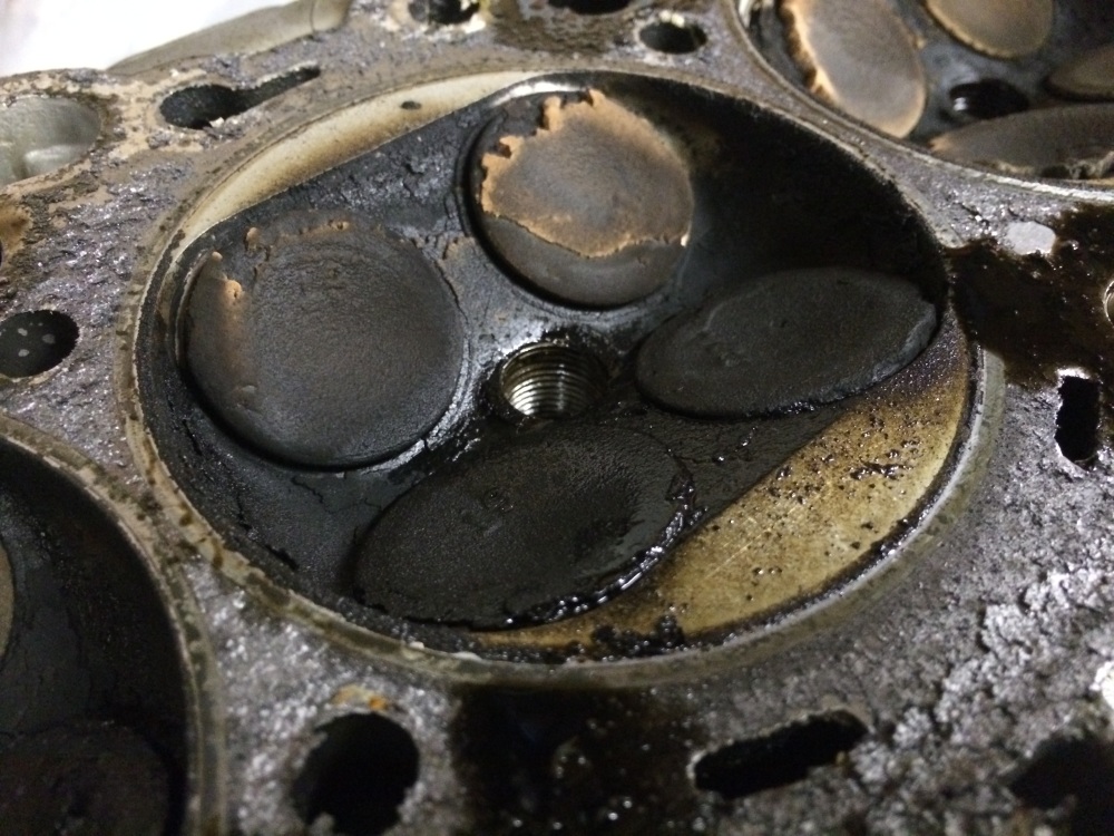

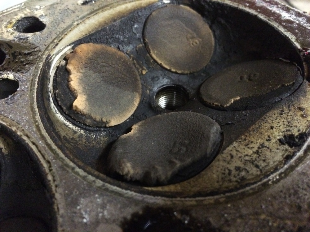

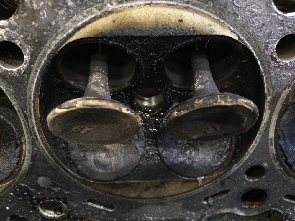

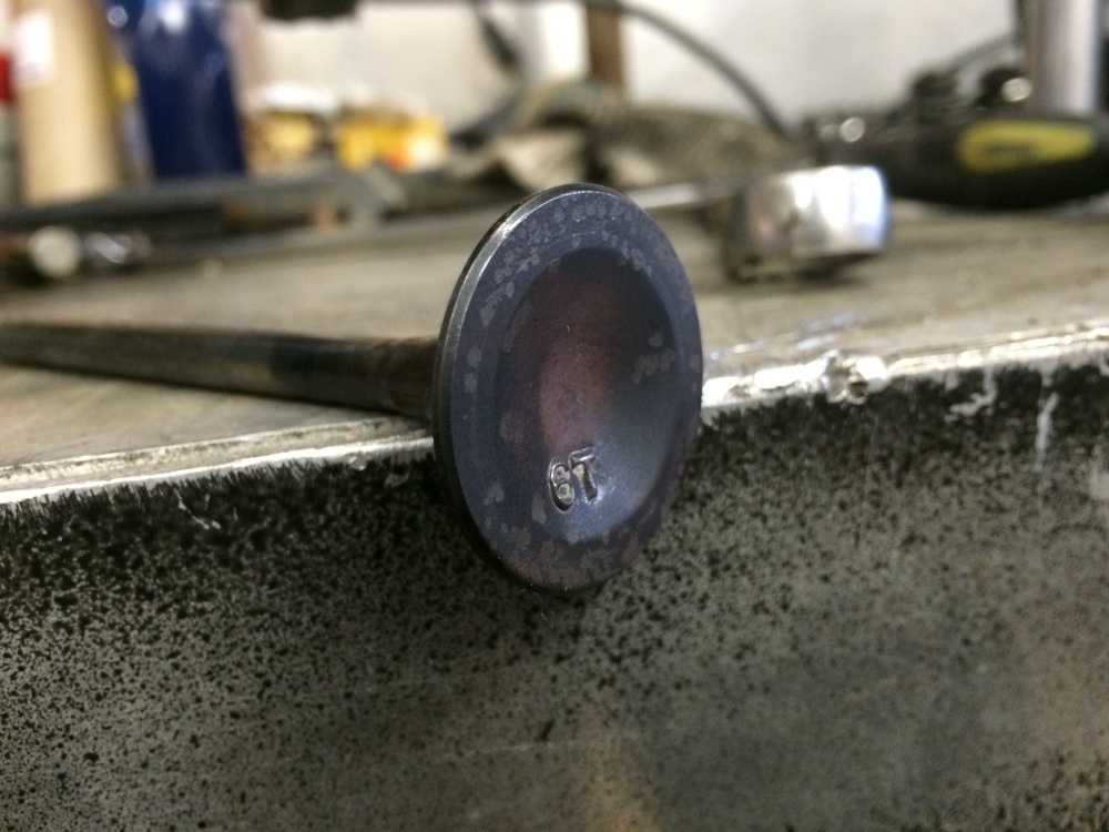

Look at the valves #1
Open #1
Look at the valves #2
Open #2
Look at the valves #3
Open #3

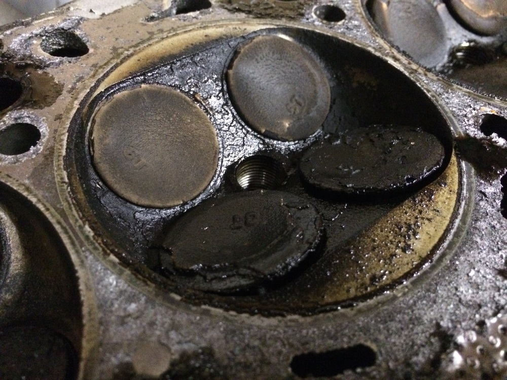

Look at the valves #4
Open #4

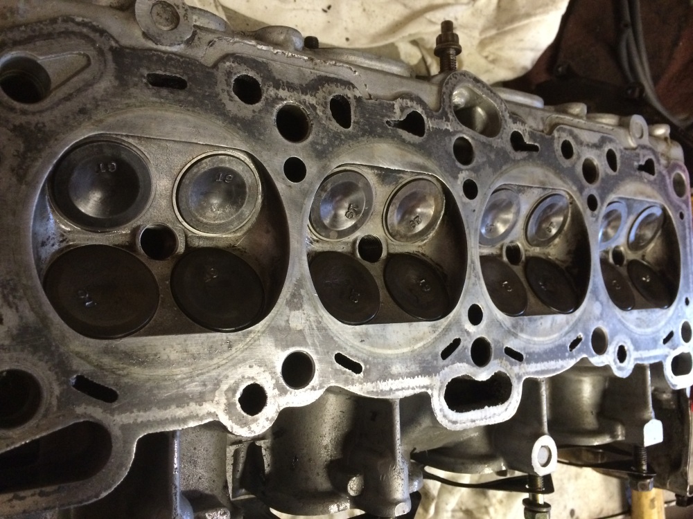

Before
After

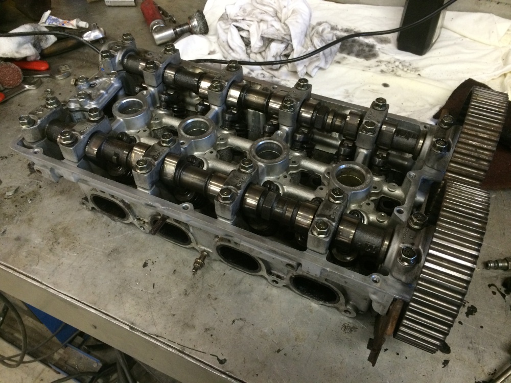

Cleaned, Lapped, Reinstalled.
New valve seals
Almost ready to reinstall!
Still need to torque errrthang.
11,016
Looks like you had the special "high compression" valves. /ubbthreads/images/graemlins/jawdrop.gif
4g63mightymax
Apr 6, 2013
195
MA
Yeah, once all the carbon was removed, all looked great. I did replace two intake valves that were a little wonky looking, but overall, the head is probably the cleanest one I have owned. I should be able to get it back on the block tonight, which means I can recheck the compression and cylinder leakage. I can't wait!

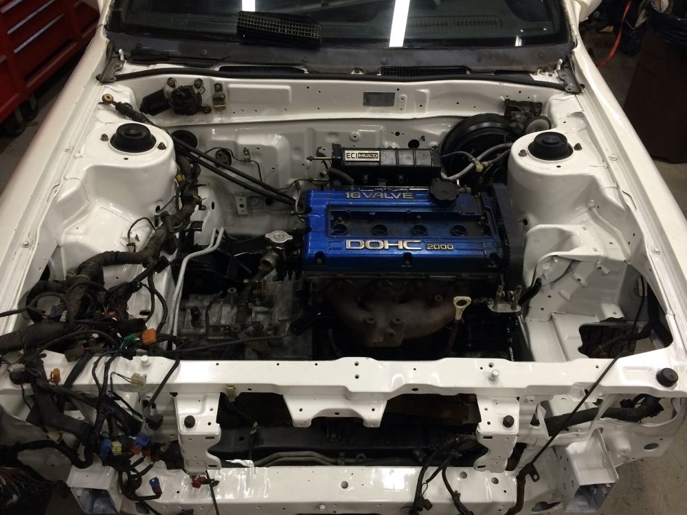

If all goes well, I will have the engine in the car and running in the next two weeks.

Small update:
- Engine cleaned
- Engine painted
- New rear main seal installed
