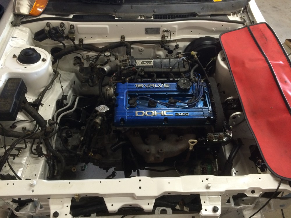

UPDATE:
- New timing belt, pullies, & hydraulic tensioner installed
- Timing cover, harmonic balancer, engine stuff, etc, etc. installed
- Entire fuel system installed!
- Lots of wires connected
So what was gained?
- Windows go up and down!
- Gauges work!
- Wipers work!
- Engine turns over with the key!
- Tail lights work properly!
- Fuel pump turns on!
What's next?
- I just ordered a rubber fuel filler neck hose, because mine is ripped.
- I need to get the shifter cables sorted out. They are wonky.
- I need to get a 14b/16g for it
- I need to install the axles and driveshaft
- I need to completely rebuild all the brakes
- I need to install the clutch master cylinder
- I need a radiator and upper/lower hoses because I don't like what I have.
(I'll add more as I think of it)
Oh, and I know the harness is ugly at the moment, but don't let it stress you too much, I'll get to it.

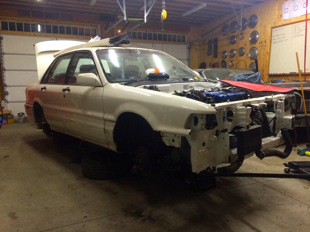

Sooooo close! I have spark and fuel now, but somebody before me hit the fuel line with a cut off wheel in two different spots, which led me to spraying fuel everywhere. The fuel line was also damaged under the car in one spot. Ugh. I then removed the entire fuel line from front to back and threw it in the trash because it was crap.
I bought 25 feet of new steel fuel line and started making a whole new fuel line setup. The rear half is done, the front half is not touched yet. Overall, it sucks. I would not recommend this job to a friend. Luckily, when complete, the car should start in naturally aspirated mode, since I don't have a turbo for it yet. Maybe next weekend...

Big things are happening Friday.
I have created an updated project list:
- Eat Donuts
- Drink Coffee
- Wash out intercooler hoses
- Install intercooler hoses
- Install MAF in proper location (Sandblast? Paint?)
- Install subframe parts
- Install radiator
- Install radiator fans? (Find? Sandblast? Paint?)
- Install radiator hoses
- Install heater hoses
- Install proper motor mount bolts
- Install turbo
- Install turbo feed
- Install turbo oil drain tube
- Install brake rotors, pads, and hoses
- Install brake master cylinder
- Install clutch master cylinder
- Install slave cylinder & line
- Bleed clutch / brakes
- Install transfer case
- Install drive shaft
- Install front axles
- Fix shifter cables & shifter boot
- Fill trans with fluid
