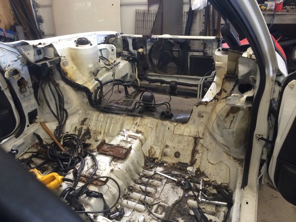

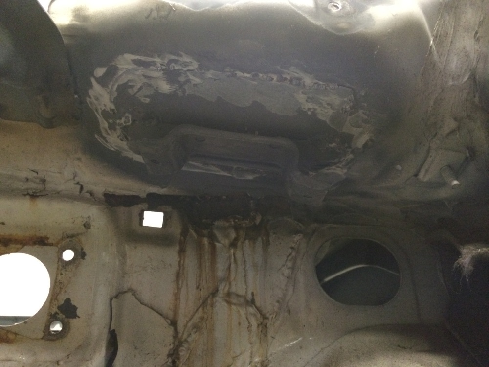

Over the weekend I decided to start preparing for Friday's big event (swapping the car back to LHD). During this preparation, I discovered that swapping this car back to LHD is the best thing to happen to this car. Let's take a closer look at some of the "quality" work done by whoever swapped this car to RHD originally, shall we?
1) They didn't swap the whole firewall (just the part that mounts the brakes, clutch, steering, etc. The upper section was left alone), which meant even if I DID have a RHD HVAC box for the car (which I don't), it would never have worked. Instead of doing things properly, the HVAC inlet was covered with a steel plate, and coated with seam sealer. As you can see, the area is already rusting on the inside of the car, so clearly there were leaks allowing rain inside the car. Bummer right?

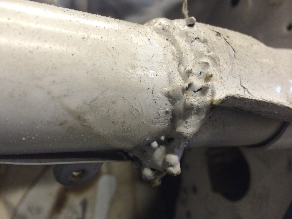

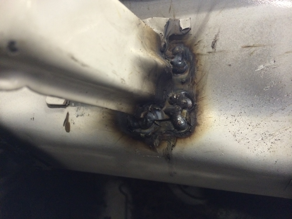

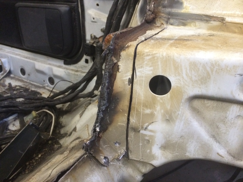

2) Speaking of booger welds. This is the crash bar that the steering column and dash mount to. The part that is visible from inside the car is booger welded to the max. The part that you can't easily see (the backside) isn't welded at all.
3) Like I said, the whole interior section of the firewall wasn't swapped, so they cut the LHD brackets off, flipped them all around, closed their eyes, and welded the brackets on the opposite side of the car without removing the paint.

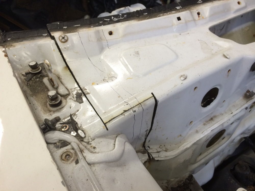

4) And lastly, just to show you that things are about to get real. Here is a picture of the first cut.

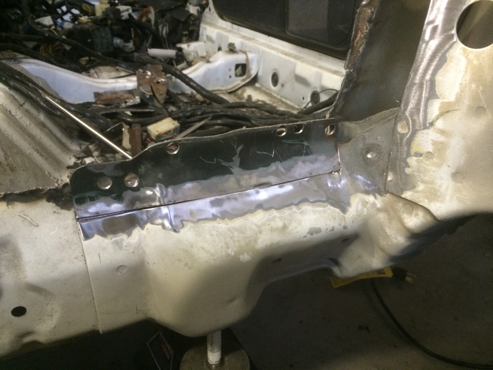

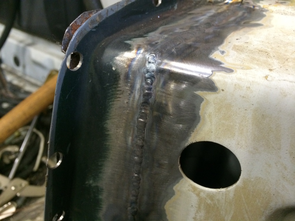

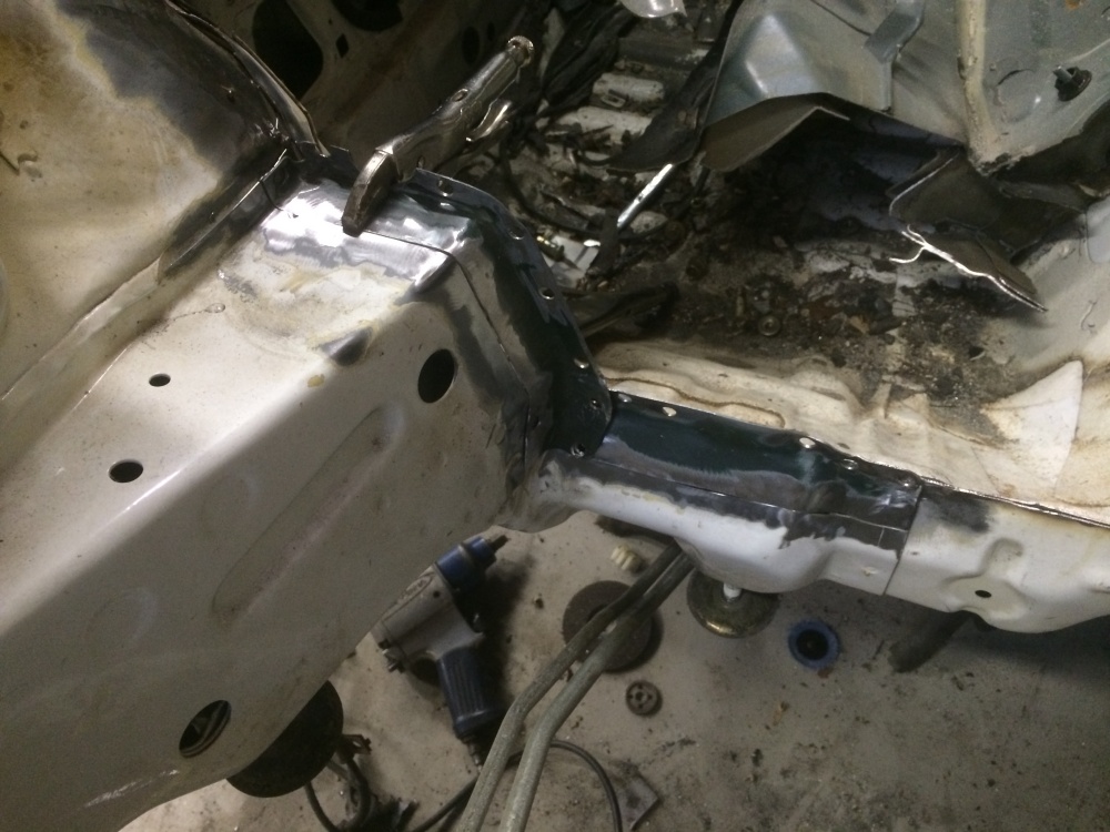

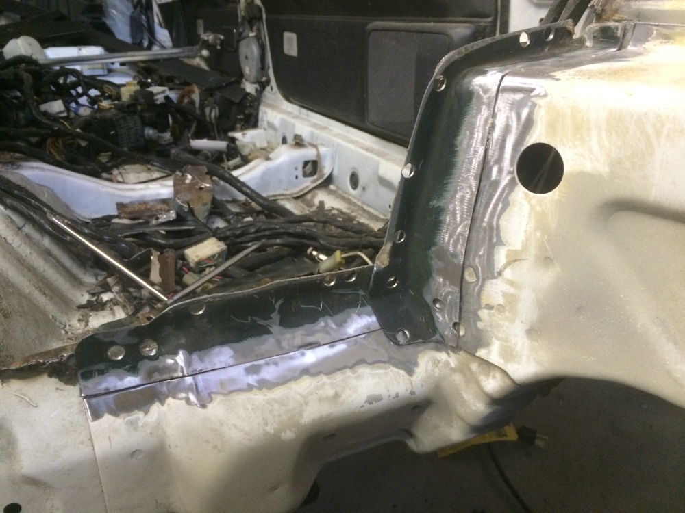

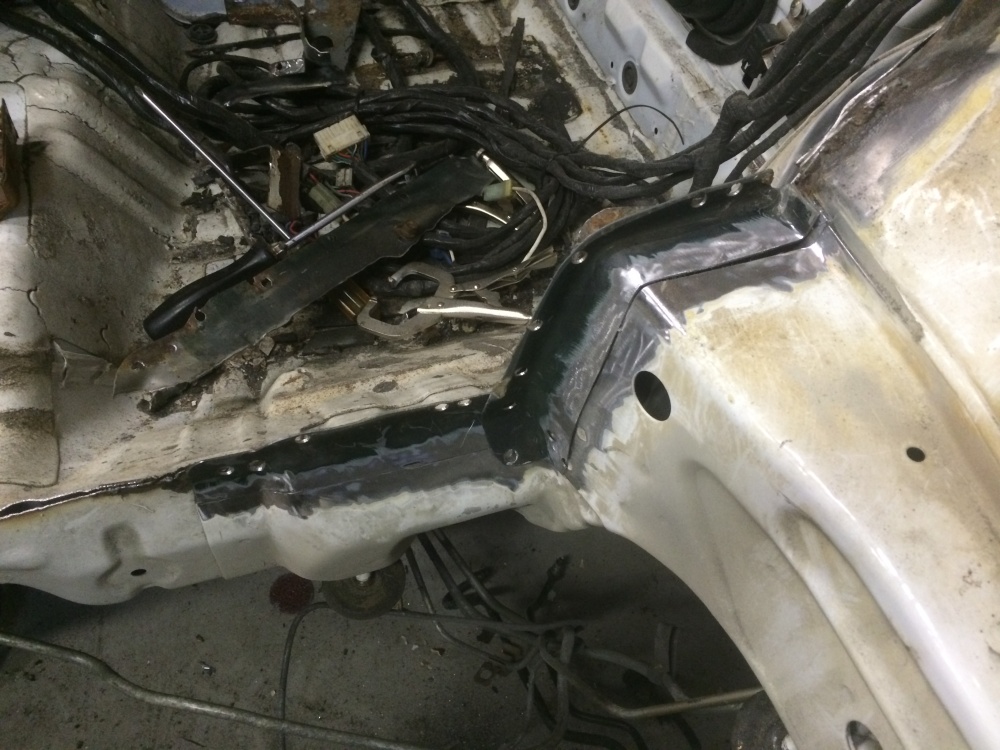

I spent a little more time on this today, and began the reconstruction process. Since the previous firewall was hacked in with the worst welding in history (and a whole lot of seam sealer), I was forced to start from scratch and rebuild the firewall piece by little tiny piece. I began with the flanges at the bottom of the firewall, on the engine side.
To do things nicely I had to get rid of all that was wrong and replace it with all that was right. I haven't welded anything in yet, so everything you see here is being held by gravity and will power. When I am ready to weld, everything will fit tight.
Anyway, here are some pics.
Next, I will do the middle flange. That one will be a hassle because the one I was hoping to use is pretty rusty. So I may have to make one from scratch. Yucko.

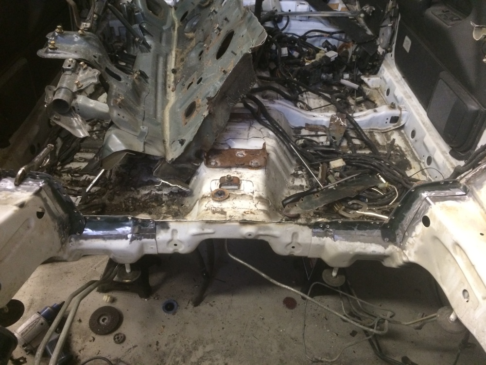

Update: All lower firewall flanges are now welded on, and ground down smooth (mostly). Annnnnd I'm now 100% out of argon.
BUT: Next step - trimming the LHD firewall to fit. Oh shnap.

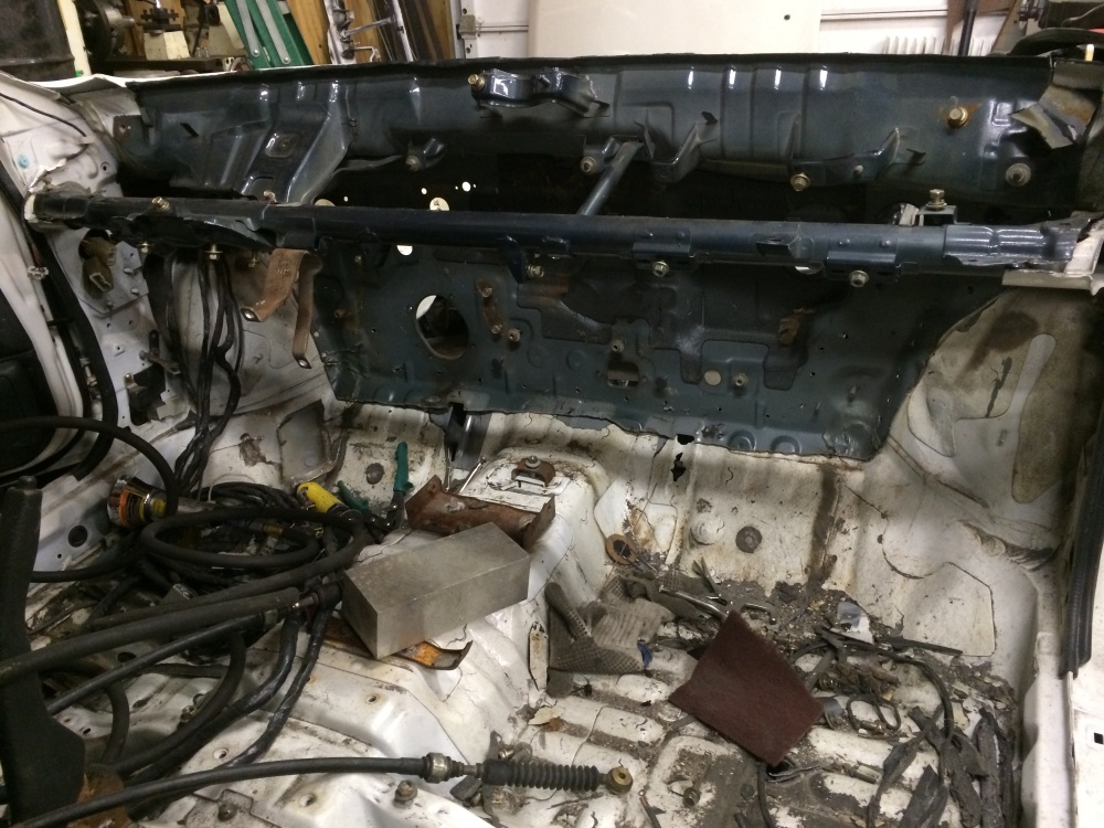

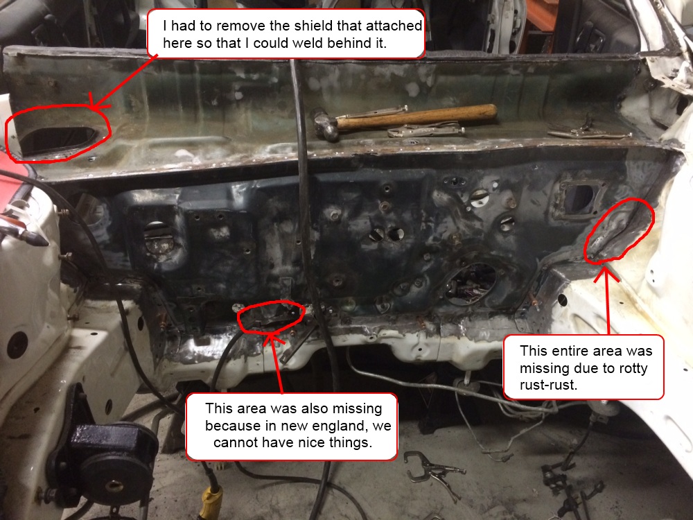

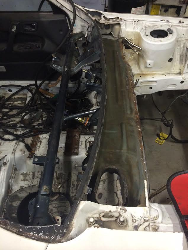

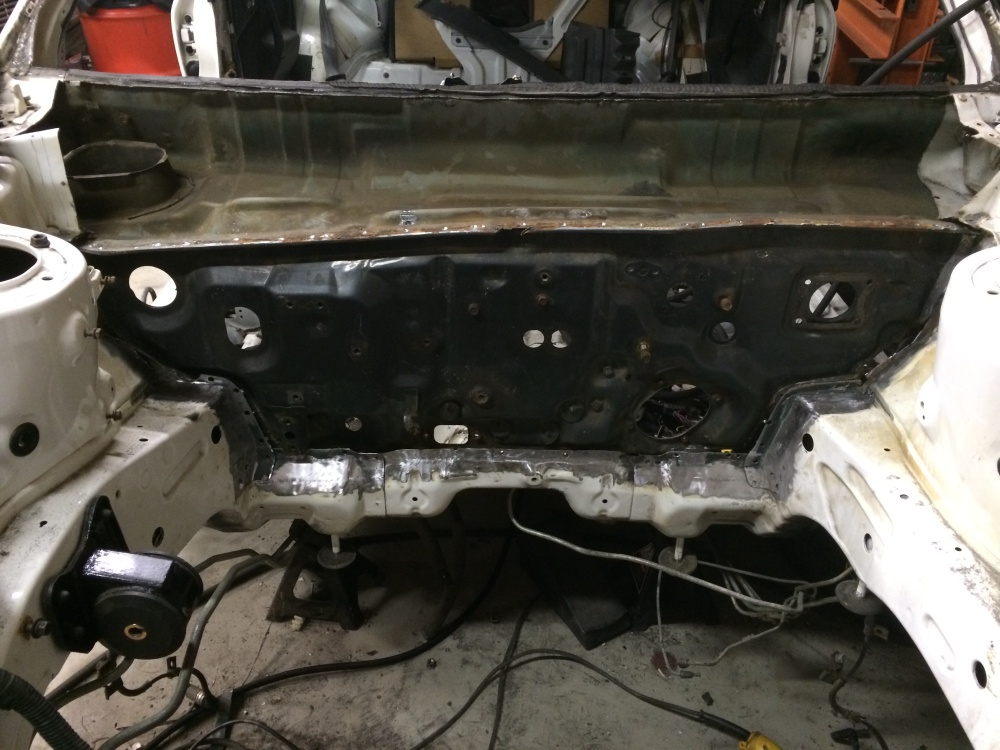

Just when you thought I gave up, I spent another hour on it. The top half of the firewall is fitted into place now. Now I need to do the bottom half. I'm thinking ~6 more hours of work before I weld it all in.

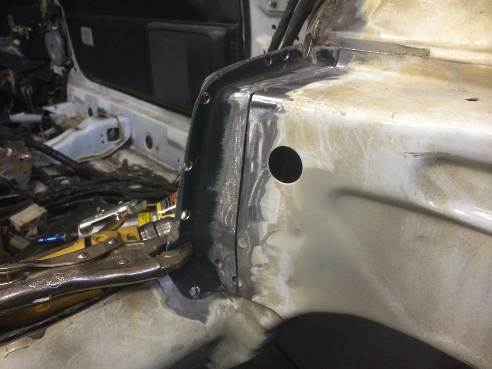

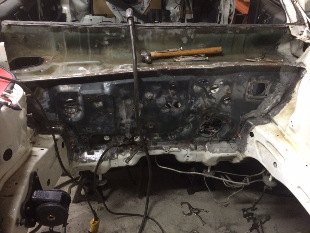

Well, I finally started to weld it in place last night, though I'm far from done.
Here is what it looks like as of 9:30 pm 3/27/14. You'll notice it looks nearly identical to the last picture I showed you, except dustier. This time though, it won't come out again /ubbthreads/images/graemlins/wink.gif
Now maybe you are saying to yourself, "Jeremy, that doesn't look like much work, why did it take so long?" Well, the "new" firewall was crustier than a bus station, and the firewall is two layers thick. It was also full of compound curves, so it is sort of a complicated item to recreate and not have it look like amateur hour.
