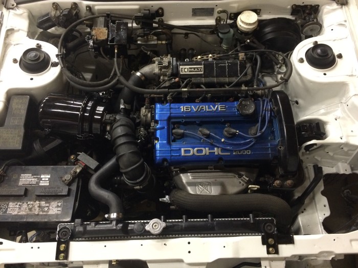

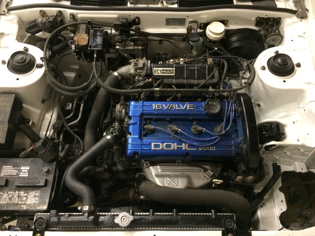

It's becoming so nice, that I'm tempted to keep it! Under the hood of this car is looking so sweet right now, and I can drive it around my yard! I hope to have it on the road legally in a month or so. It won't be perfect, but should be drivable.

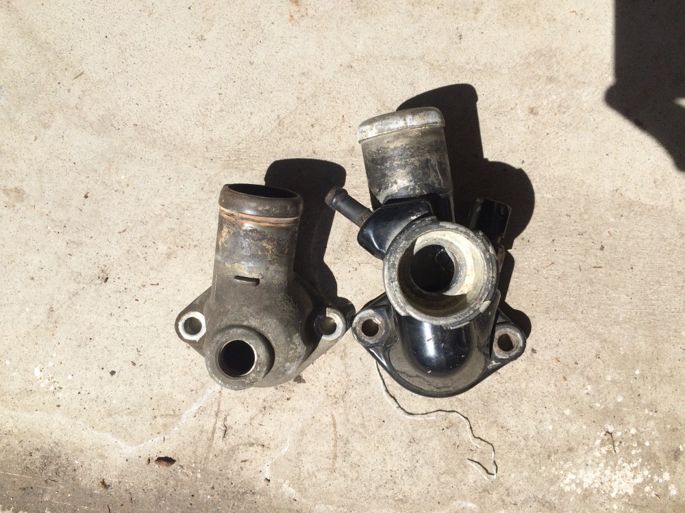

...and if anybody is curious, this is the difference between a galant vr4 and 1G dsm thermostat housing cap.

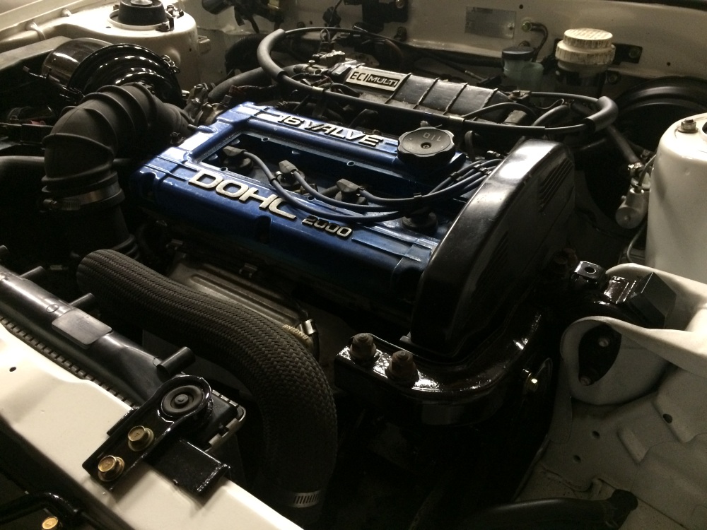

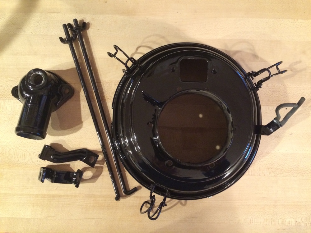

Sandblasted and painted. Stock MAF FTW.
Engine bay needs a good cleaning, more parts, & I need to install my fancy valve cover.

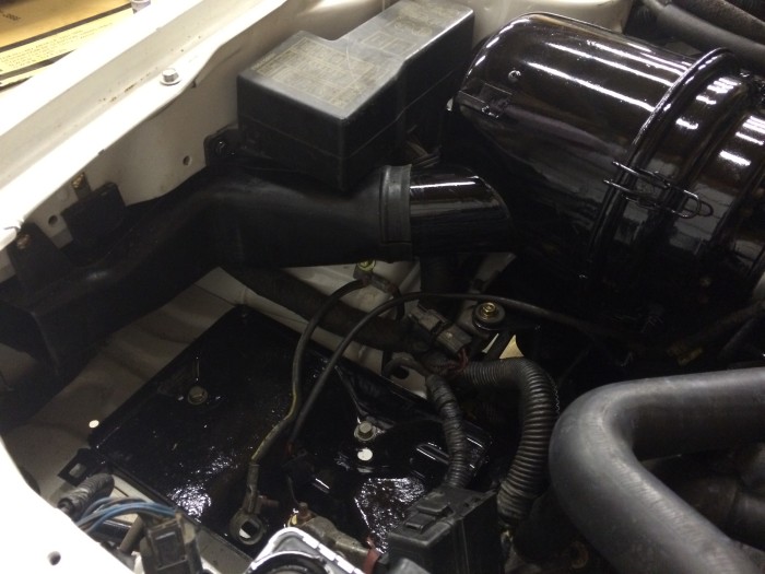

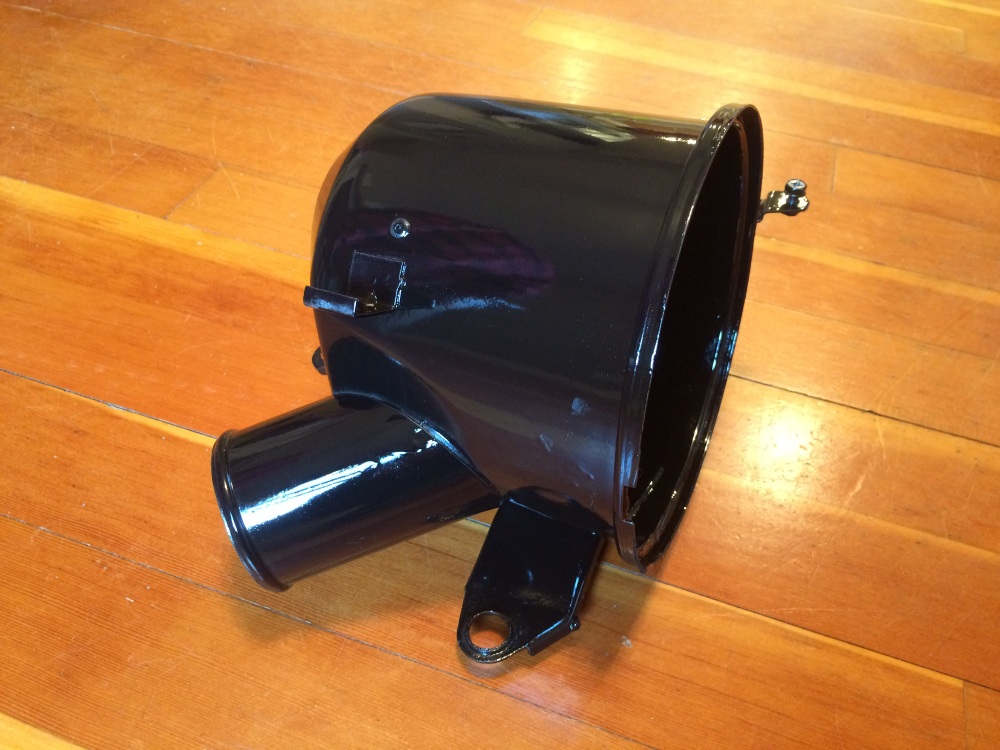

I even added the plastic air box duct. Oh and I made the intake pipes look new! Sick bro.

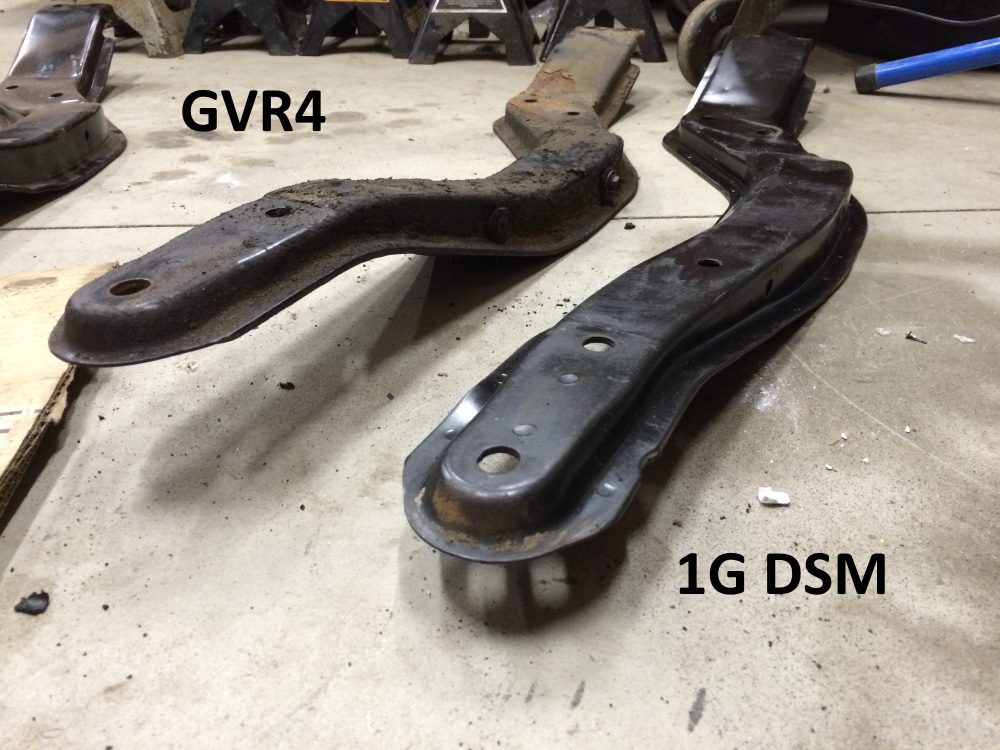

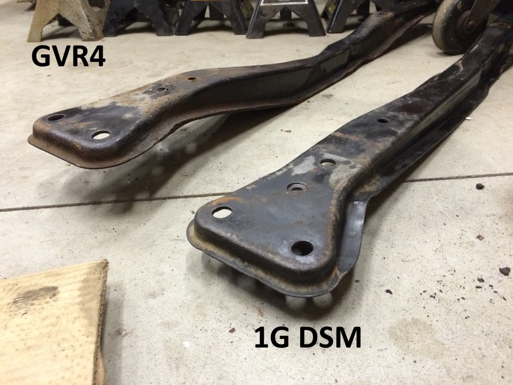

Yes, they are the same shape and size, but the GVR4's are bent up higher in the front by an inch or two. Laying on the floor, the GVR4's are taller. Maybe I will take another pic with a tape measure... for science!

Wow. I have to check mine. Another reason my drivetrain may make noise.
Edit: yep I got the wrong one installed. If it's not touching anything is there a difference? None of the mounts attach directly to this. Is the front piece this connects to different?

I think the 1G ones could possibly attach if you force them into place with some long bolts, or if they are bent slightly upward at the front. I do have a third one that looks like it could have been a 1G cross bar at some point that was bent with some serious force. It is way too ugly to put on this car though. lol.
Also - I don't *think that the front bar with the motor mount is different between the 1G and GVR4, but I may pull that out again to check. If I do, I will most definitely do some caparisons for fun, because I have a pile of them.

You will probably find that the front bar is a bit different. Since the VR4 uses a different engine bracket for the front motor mount, they are at least different as far as where the front roll stop mounts to it. Although, it would be interesting if they are the same as to where they mount to the frame. If so, then that item would be an option for those rebuilding a VR4 that can't come across the front engine bracket. Swap in a DSM front bar, or a Bullfab unit and use the stock AWD bracket from an AWD and the front is good!
I eagerly await this as my son also has a VR4, and his motor is wedged in pretty good at the tin=ming side bracket because the front engine bracket is from a DSM.

Last night, I sandblasted, painted, and measured the cross bars that we talked about yesterday. I have some more pictures that I will get up here in a bit. The front subframe with the front engine mount - I have three of them to compare. The one in my car right now is from a 1G DSM (90% sure), and I'm using the 344 engine bracket. I have two more of these with mounts attached to them. One is definitely GVR4, and the other - I have no idea. I'll compare them as soon as I get a chance. Hopefully in the next couple days! (Maybe tonight)
