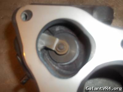

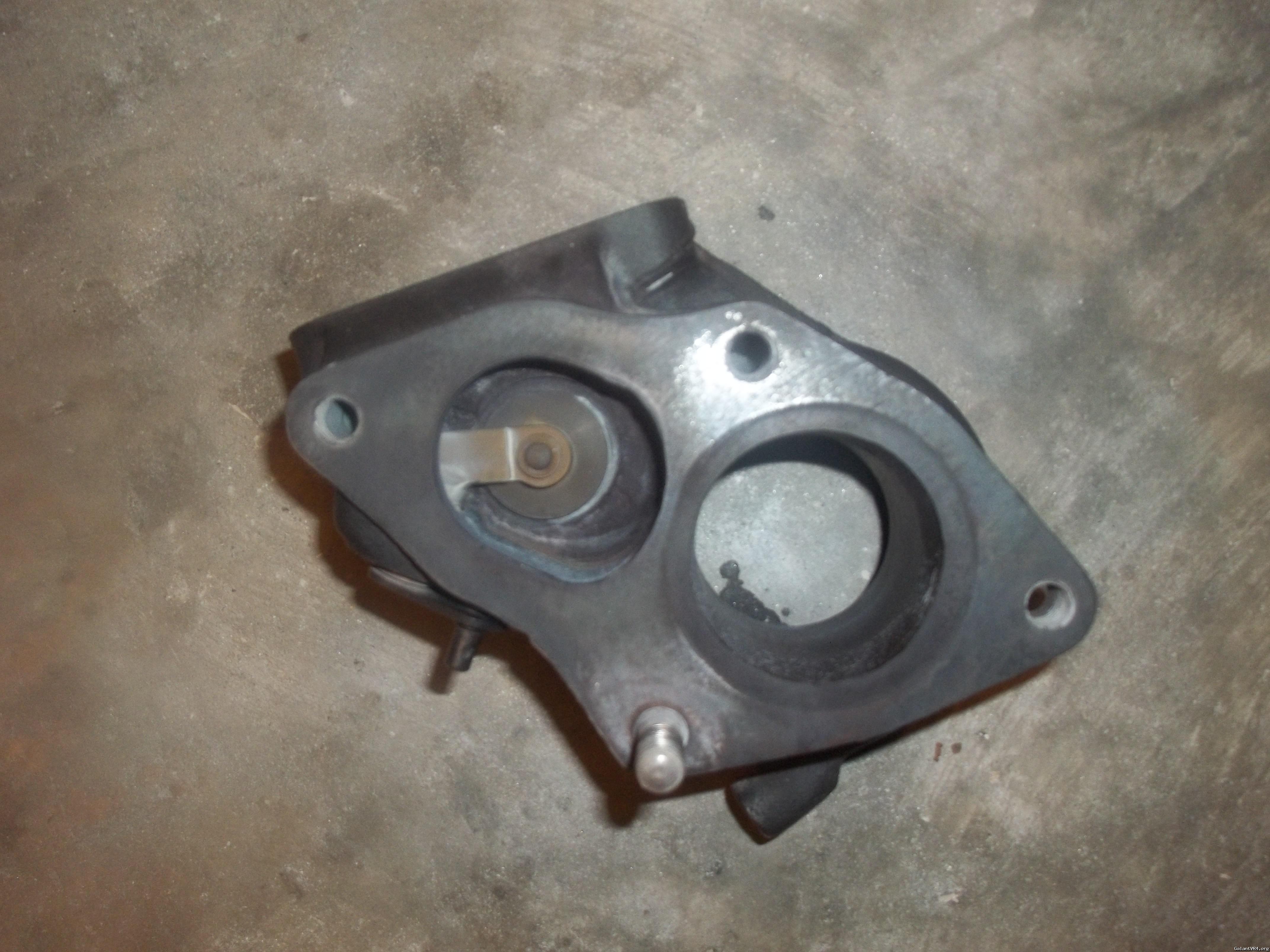

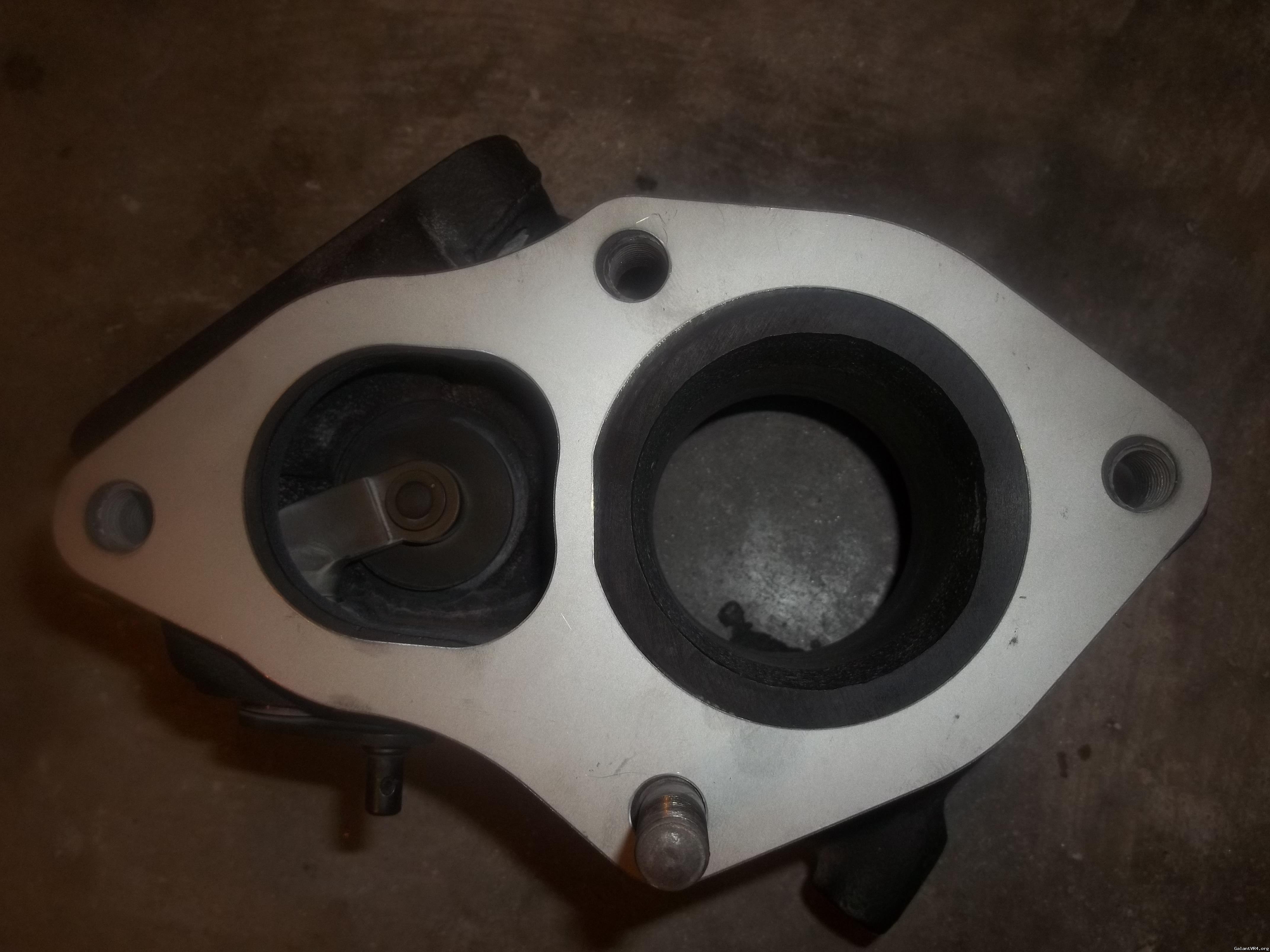

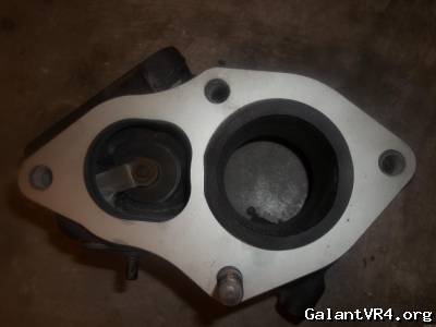

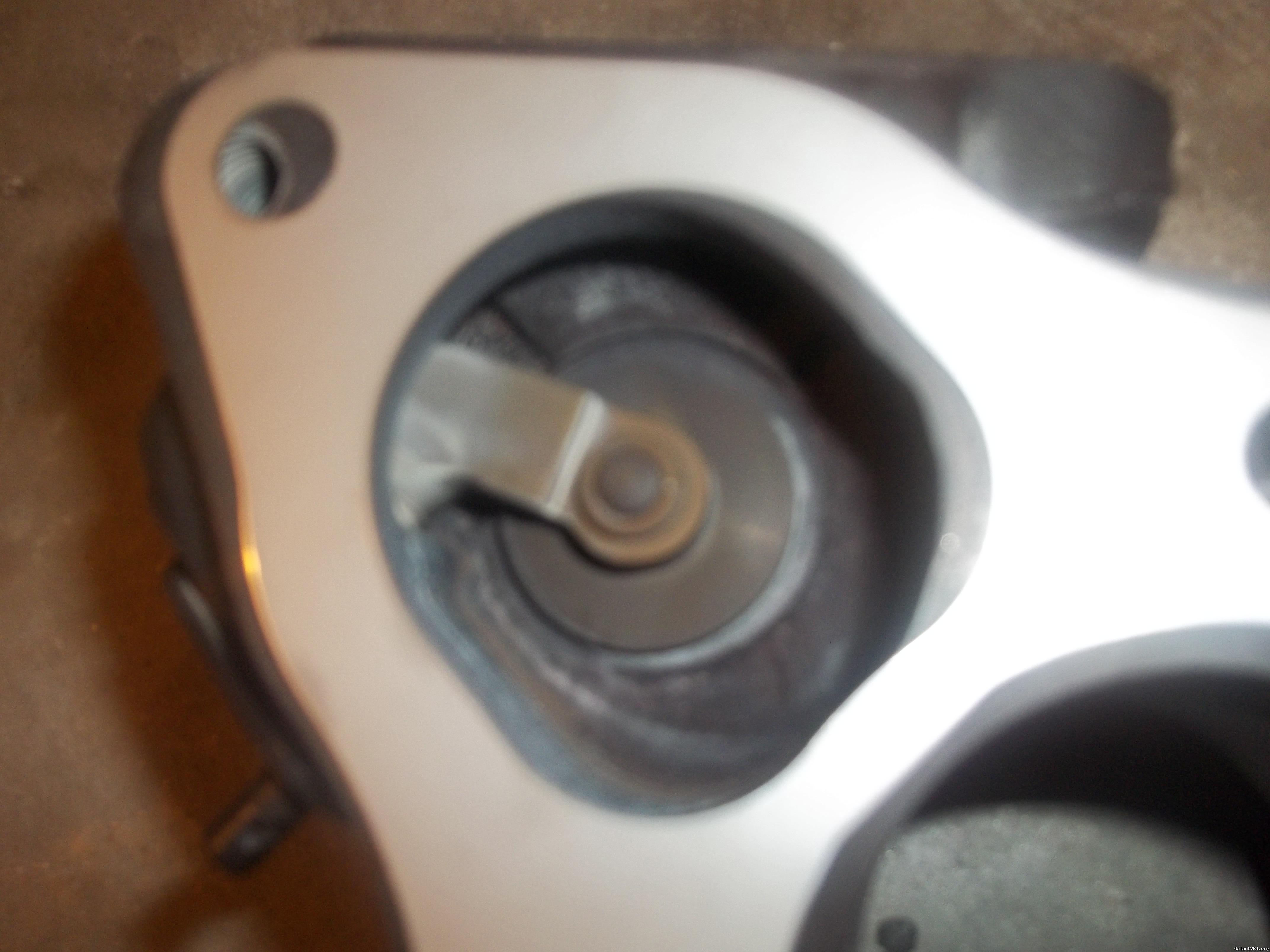

All the factory 16g type turbos use a TD05H turbine wheel. The small and big 16gs use the regular 7cm housing. If you look on the 68 HTA compressor cover it has the part number for a big 16g.
The Evo 3 16g has the exact same turbine wheel (td05h) but the housing is a little different. Like you noticed with the gasket, the exhaust outlet tapers out a bit more than the other housings. It's actually the same size where the wheel is, it just opens up a bit more as it gets closer to the o2 housing. The flange on an Evo 3 housing is different too. They removed some material to make it lighter. This is really noticeable if you look at a 16g housing and an Evo 3 housing side by side. There might be other differences with the inlet and volute, but I've never personally seen an unported Evo 3 housing.
It's not much, but this is one of the reasons I went with a very heavily ported ebay Evo 3 turbine housing. I'm trying to max out the 68HTA and it is very much exhaust limited. The 47 lb/min compressor pushes the td05h turbine to its limits.
