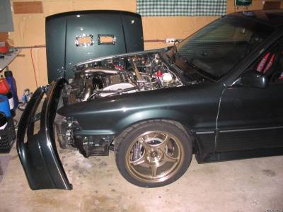

The One Lap VR-4 has jdm hood vents on a US hood and its not a job for the faint of heart. You have to cut the hood and the under hood support and then fab up a clip system to hold the vents in place. Even then you might need some 3M tape to help hold it flush.

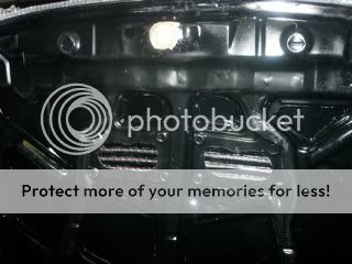

Even if you were able to get the top to look "factory", the underneath will still look like sh*t since the hood skeleton is in the way on the non-vented hood. The braces go around the vents on the OEM vented hood.

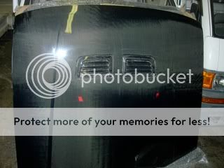

i have a friend that has a fiberglass copy of the JDM hood
its an exact replica so the skeleton is JDM also not a hacked USDM hood.
if that helps any /ubbthreads/images/graemlins/grin.gif

Well sweet...get him to have it molded for those of use that also want one.
Or at least let us know where he got it.
Quoting scout:
here's a few pics.
