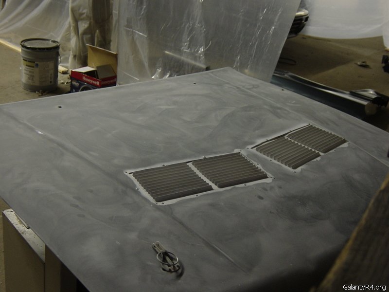

I think this is what you are talking about right jim? Cutting out all the skeleton so its easier to cut in a vent? Its pretty easy with a grinder, and I was able to feel a difference in this hood and my stocker, but it wasn't a ton lighter. If you cut the skeleton all the way back to the edges there would be a greater benefit. In the pic you can see I didn't cut mine back far enough.
BTW, this hood was very very stiff, but that is because of the "walls" of the vent being welded in. If you were to do drop in vents it would be a little bit flimsy, but nothing that you couldn't deal with on a weekend racer.

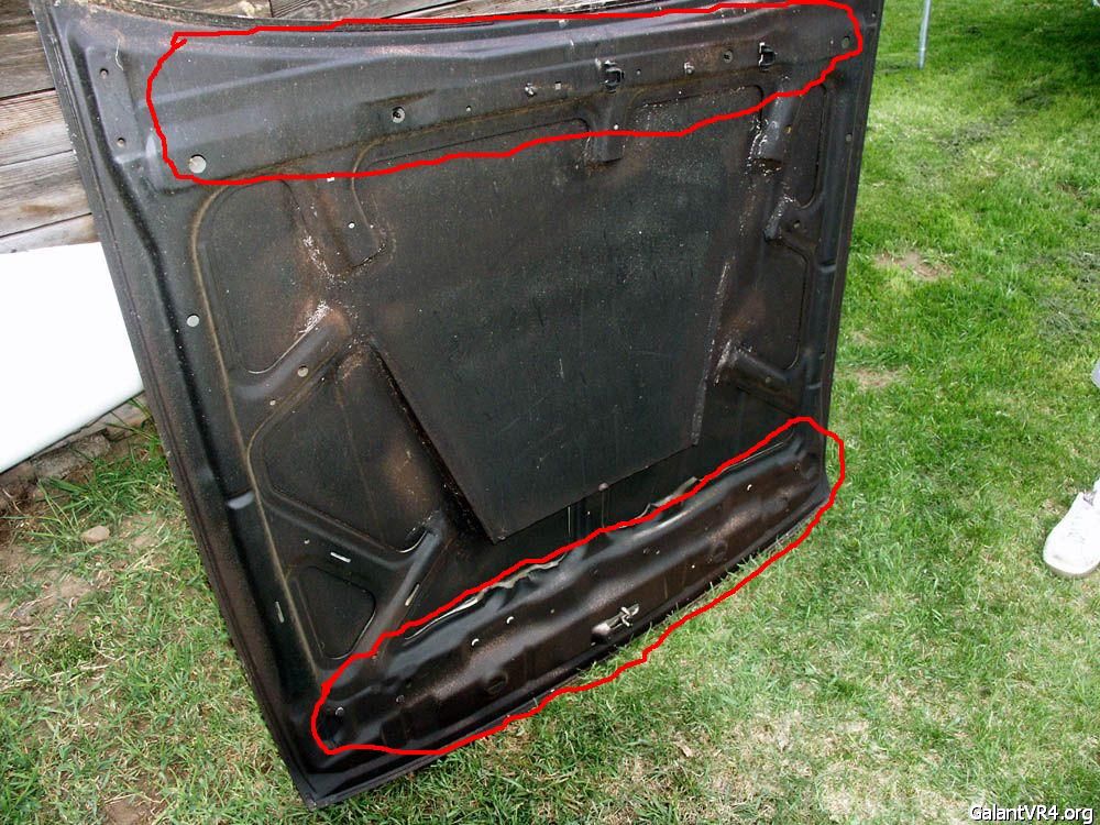

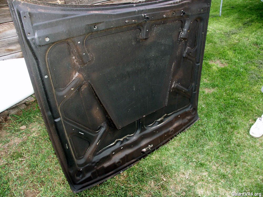

I circled the areas in red I am talking about. These are much thicker and I'd say are a large percentage of the hoods weight.

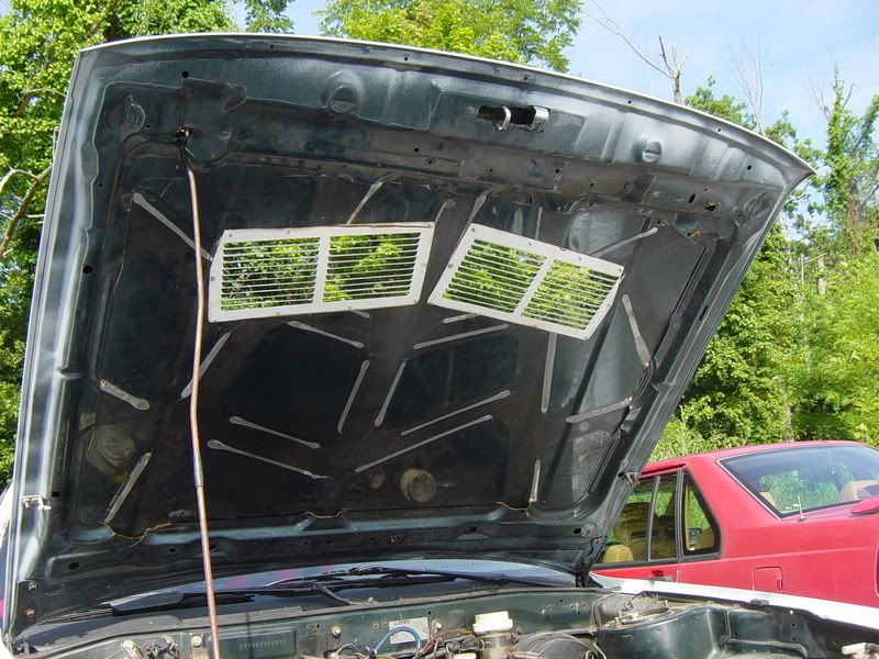

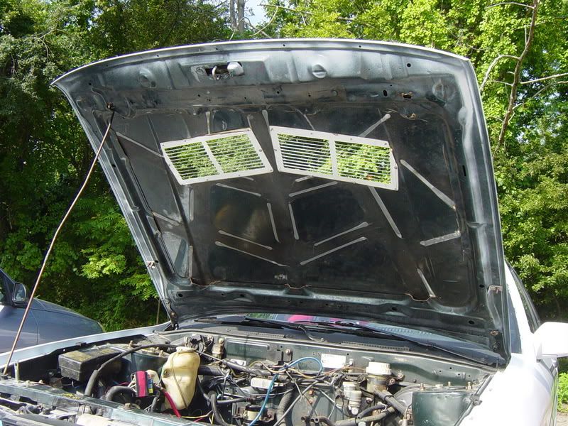

I don't have any pics of the under side, but I can take some tomorrow at work. I cut out the inner portion of the structural support, similar to the pic in the post above mine.
It wasn't as much weight as I was hoping to shed, but I needed to do it for the vents, and every once adds up after a while. It does have a bit of a gangsta lean when its up and on the hood prop, but it falls right back into the body lines, so none of the "warping" is permanent.
Pics to come. . .

Pics as promised:

Are those home AC vents?
Intersted to see pics of the other side with the hood closed.
So I guess they are. Dont look as terrible as I thought they would...To each his own, I bet they let out A LOT of hot air that would otherwise be trapped. /ubbthreads/images/graemlins/crazy.gif
