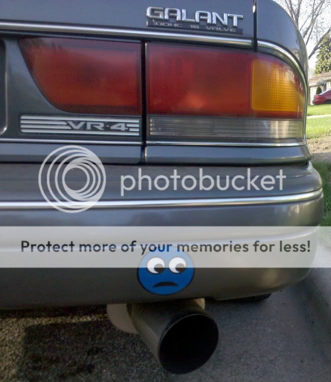

I'm started recirculating my hks bov today and what a huge difference! /ubbthreads/images/graemlins/worthy.gif No more sputtering, kicking, car dying and turbo over working itself. To anyone venting to atmosphere on a stock mas, please recirculate. That is all.
PS: I'm still working on kicking the rest of the ricer habit out though /ubbthreads/images/graemlins/uhh.gif

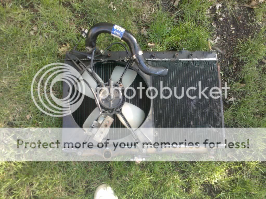

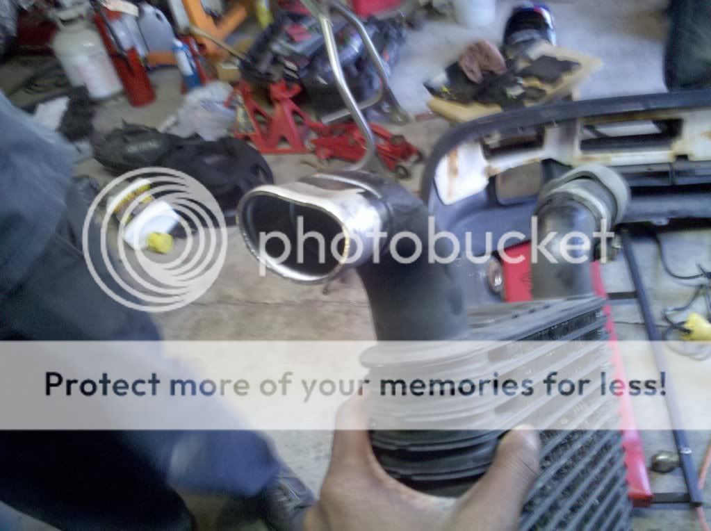

Well I found out why I couldn't hold 15psi after 6k. I still hold my stand that recirculating the stock maf will feel better than going non recirculated. The bov is still loud too. With a non recirculated setup, I couldn't hit boost then go to neutral without the car dies. Same goes for quick stops.

That looks like a boost leak to me. That was the main problem. Full boost then going to neutral and it dying IS a symptom of VTA on a maf. Breaking up and hitting fuel cut isn't unless something else is going on, IE you had the boost turned up on an intercooler that is the size of a baby's fist.

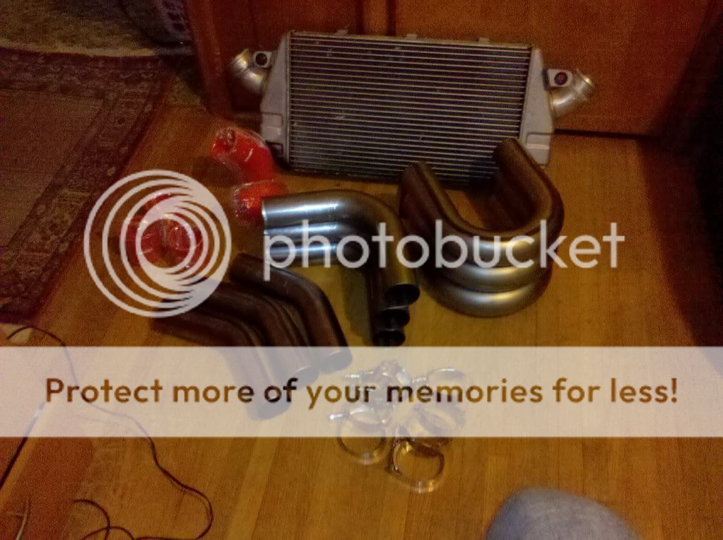

Yes, my oil cooler was causing a lot of issues because all the oil would flow out and not lubricate the boost that was being forced into my vtak engine. On the other hand my Intercooler wasn't doing it's job too well either...
I ended up switching to an Evo 8 oil cooler instead.
