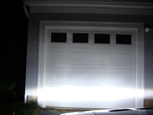

I just converted the Galant over to HIDs. Never really planned on doing this but a great deal came along on another forum I'm on and I figured I'd give it a try. The seller is happy to extend the coupon to this forum as well so I'm posting the code if anyone else is interested. I'm not affiliated in any way with the seller or the product, but I am happy with the results and the price so I thought I'd share.
More info including pics of the product and samples of each temperature/color are here along with the original post:

I didn't change the housings at all, just swapped bulbs and installed ballasts. Surprisingly they seem to aim just fine and cast a pretty decent pattern on the road in front. If they didn't work well I wouldn't have been too broken up about it for the price though.

I'm curious to know how many oncoming drivers will flash their lights at you.
Your cut off doesn't look sharp at all and it looks like you'll blind oncoming drivers and annoy the ones you're following.

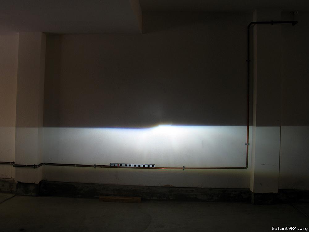

A good hid setup will have a very sharp cut off point and this can be achieved by using a projector setup.
This pic shows a decent hid cut off point without any hot spots like in your setup.
