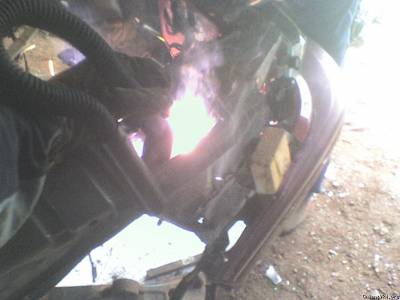

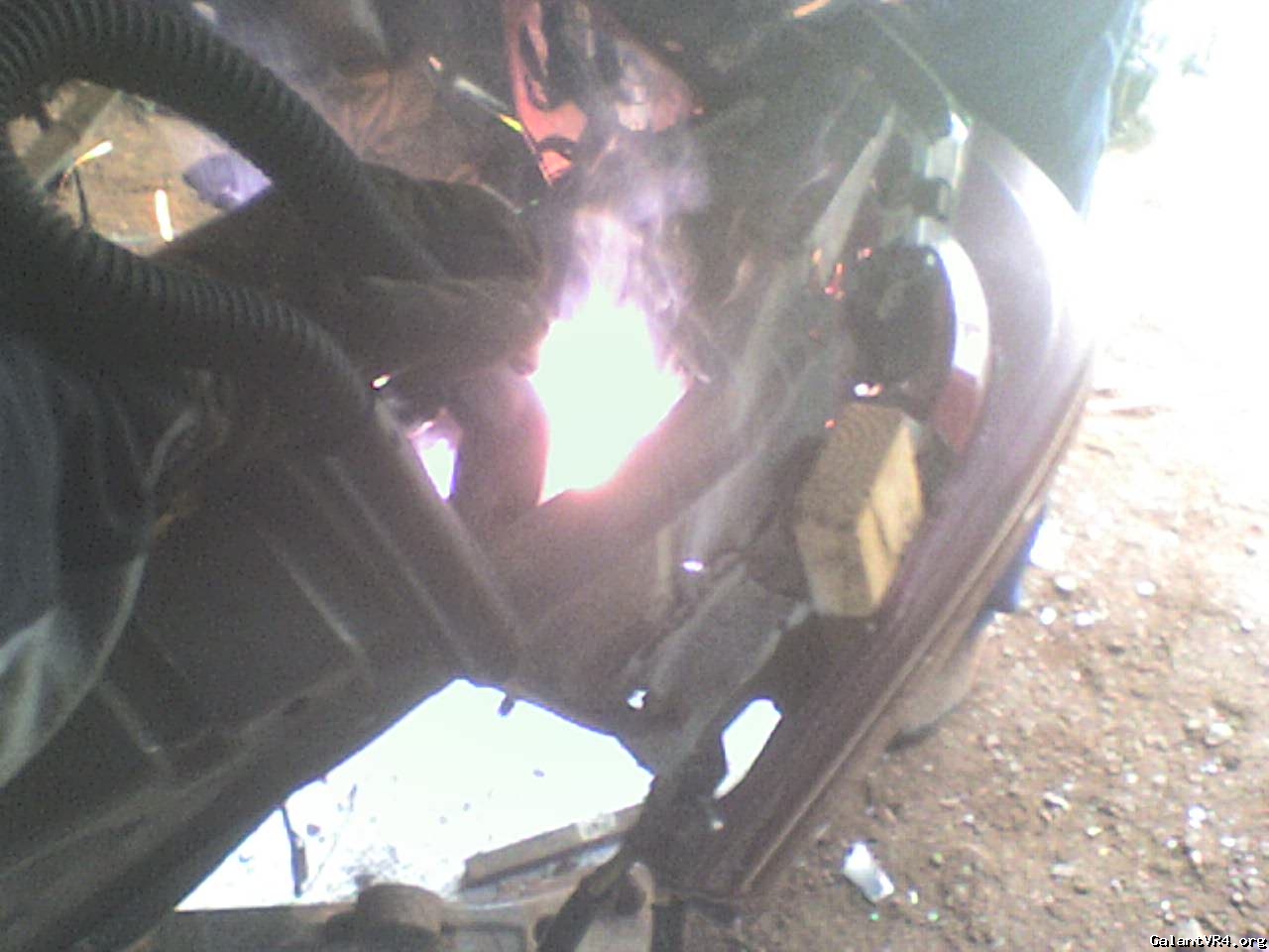

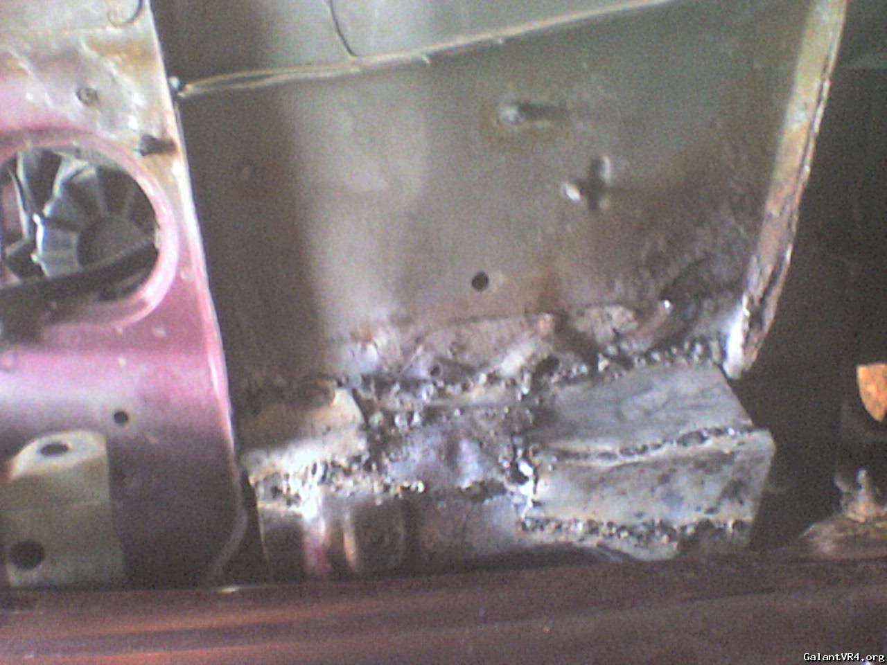

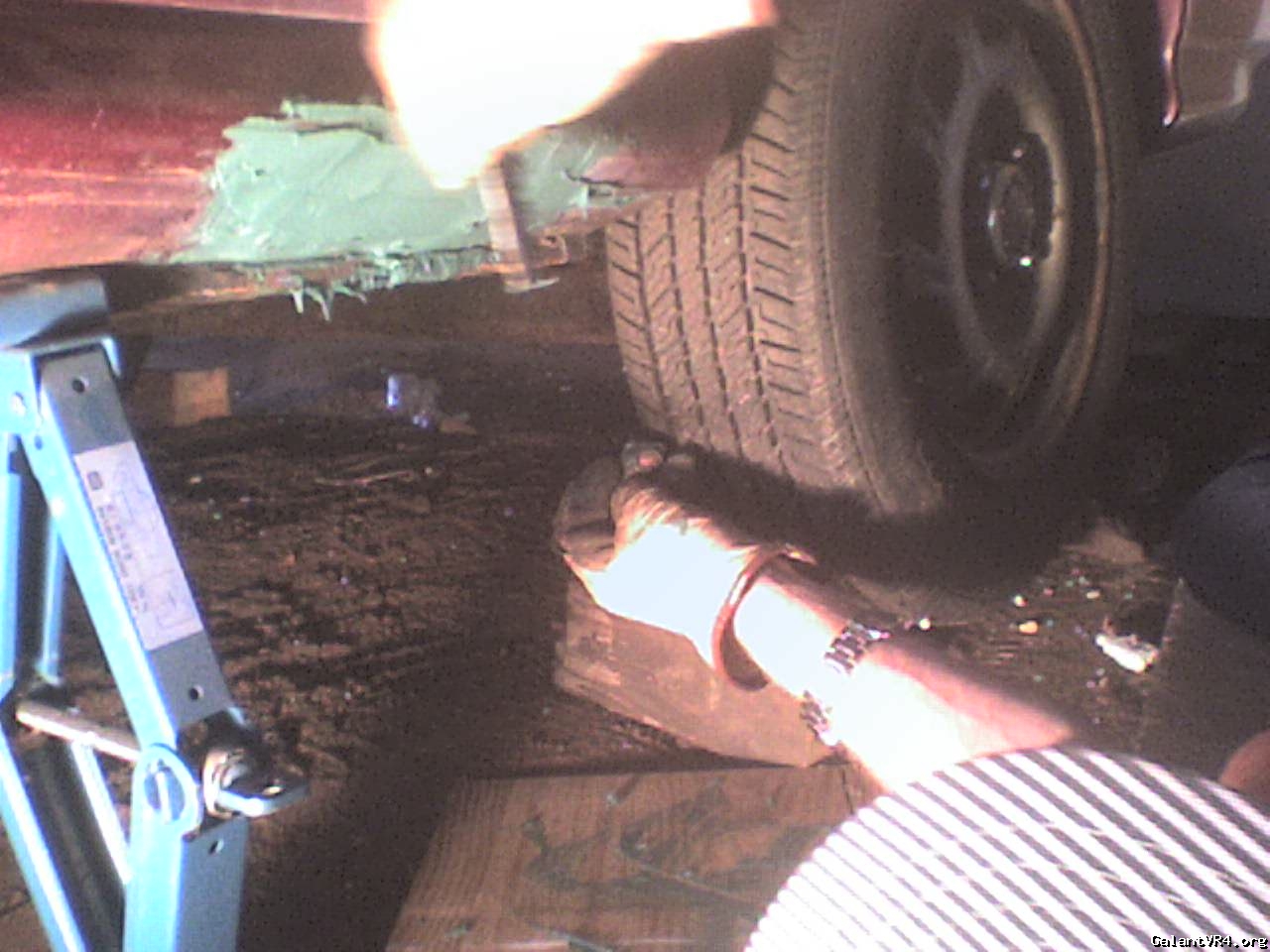

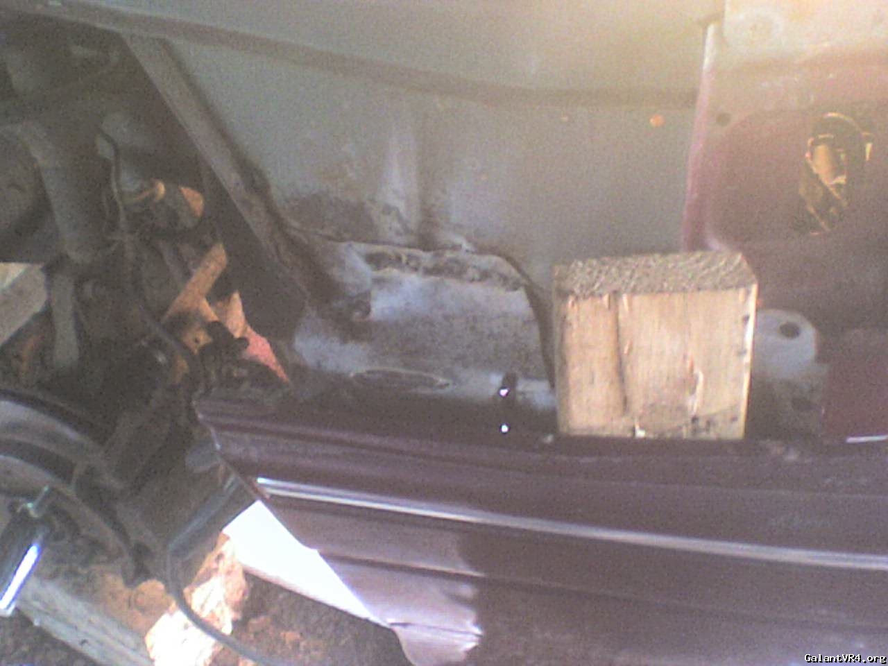

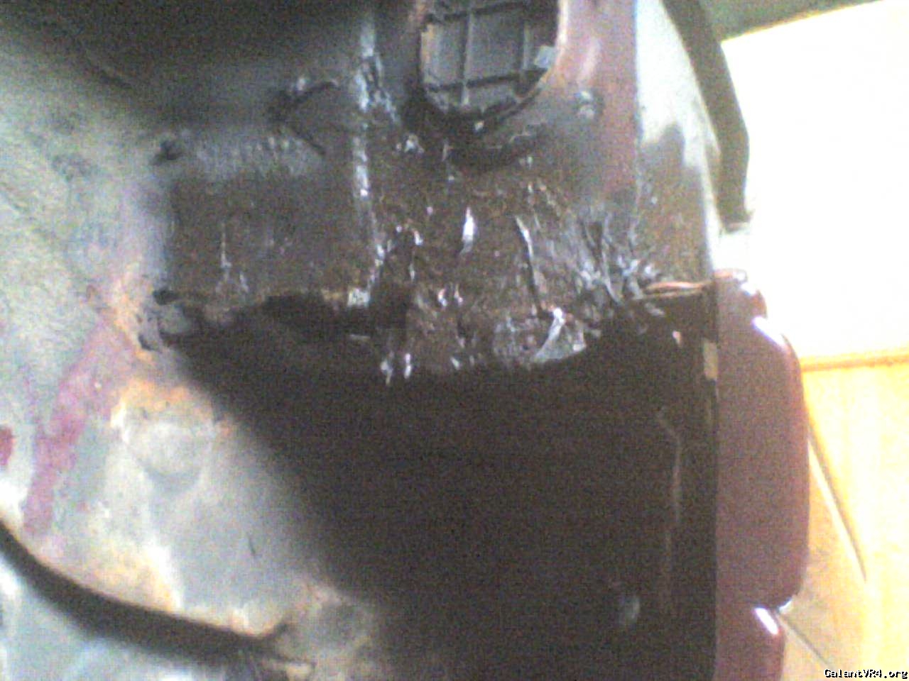

alright, so heres a few more pics of the work that has been done so far yesterday.
welded on the places to attach the fenders, right under the bumper.
did the same thing on the other side, but this side wasnt so bad. so it was more of a reenforcement, and also a spot for one of the bolts that had ripped off, seeing as the bolts was slipping.

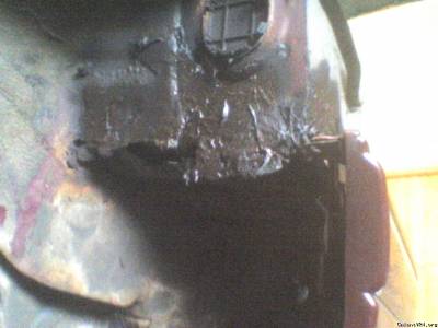

there was a spot in the wheel well that had rusted out, and cracked. it was right by the battery holder.
so it was welded, and patched up.
and put some undercoating on it.

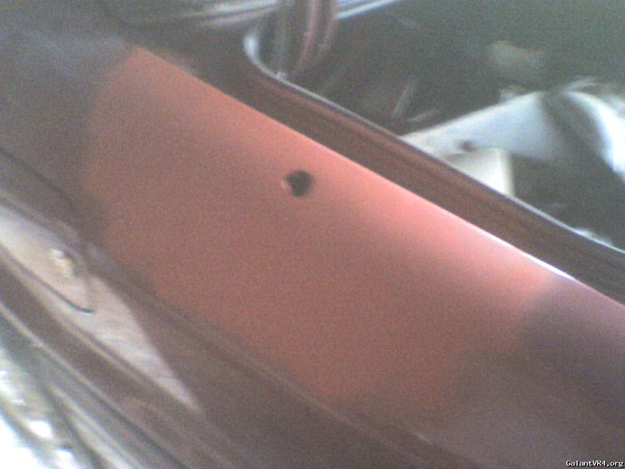

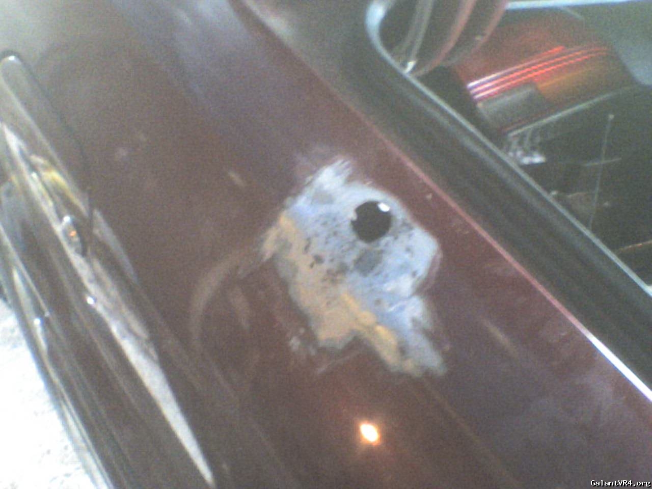

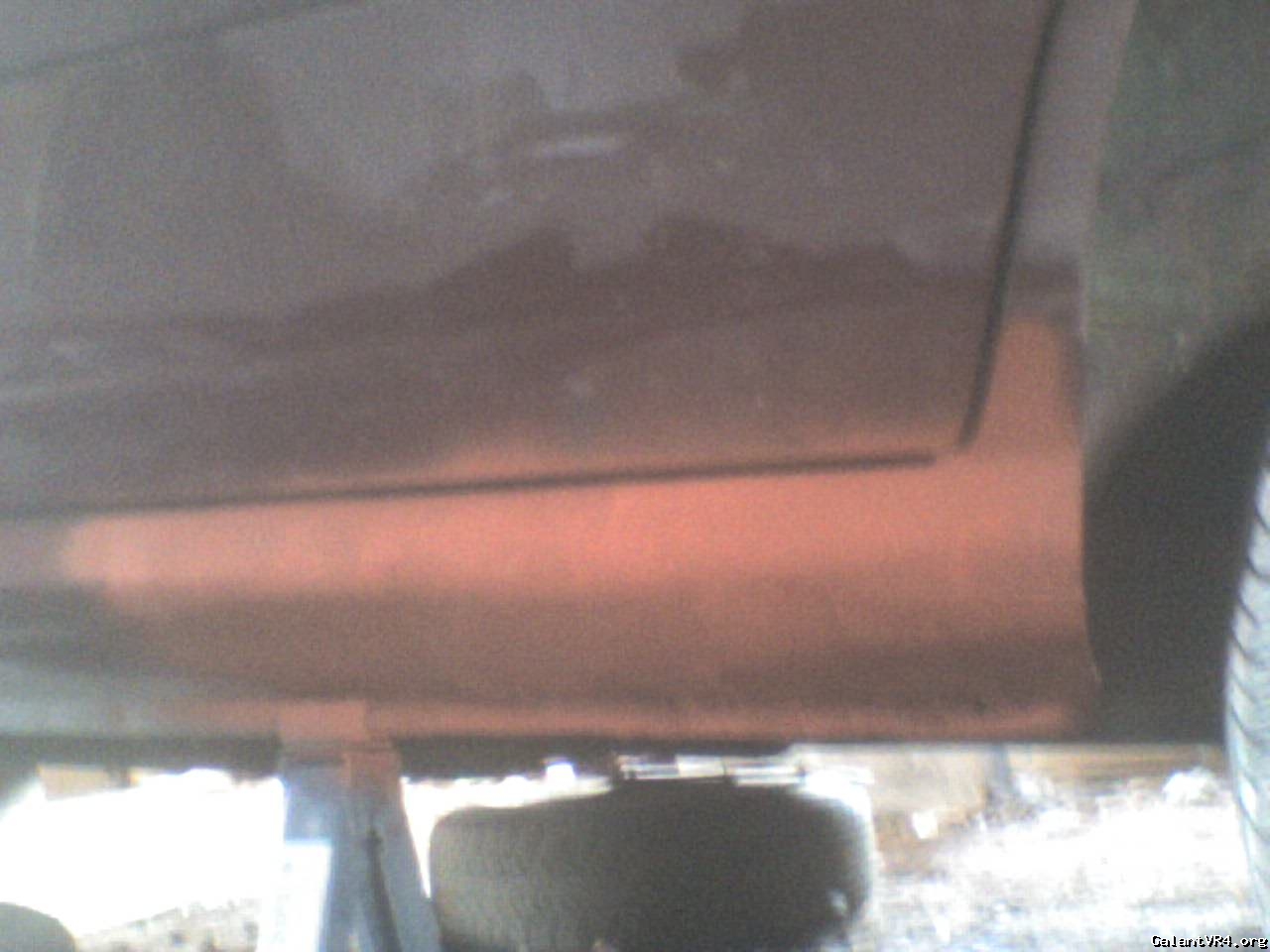

and then there was a spot right under the back drivers side door, that had rusted thru, so we cut it out, put in a new piece of metal, welded it in, and then covered it up with fiber glass body filler. i will sand it smooth later.

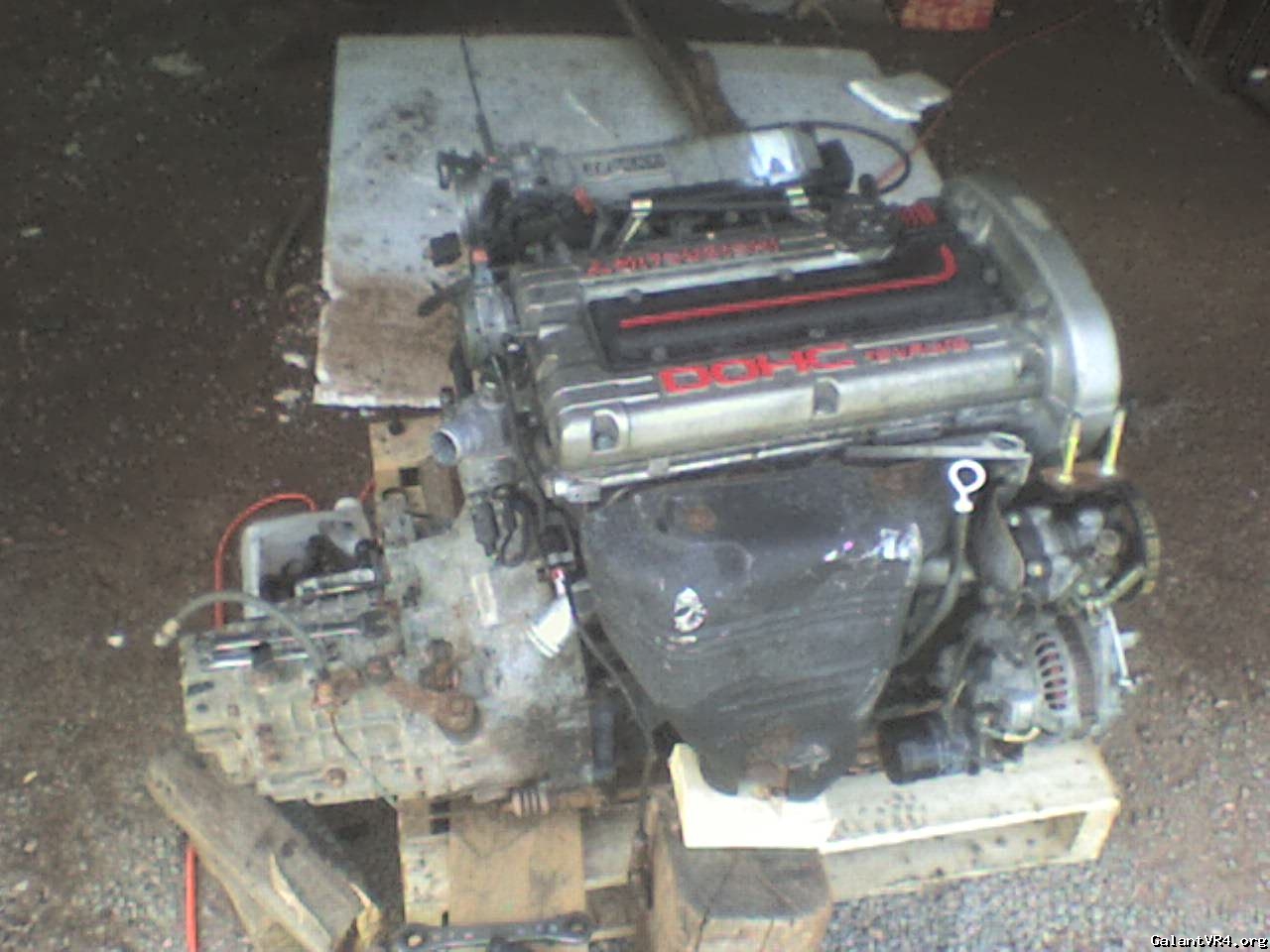

If I were you, I would remove that AC belt and the tensioner along with it. Also, I would put a new waterpump, timing belt and components, and new accessory belts on before you install that motor in the car. A little money and time spent now means less issues to deal with in the near future. Go through and replace *all* coolant hoses while you're at it as well.

definitely agree. a new timing belt is a must. hell for that matter all belts. since the car is out you could think about doing the BSEK too. just so its easier. water pump is also a good plan.

so we cleaned out the rust area that was around the antena.
sanded it all down, put on the body filler, smoothed that down and sprayed on the primer. that spot is done minus the actual paint. will paint in the future, but doesnt need to be done right now.
mounted on the trans, and filled the engine with oil. installed starter off old engine.

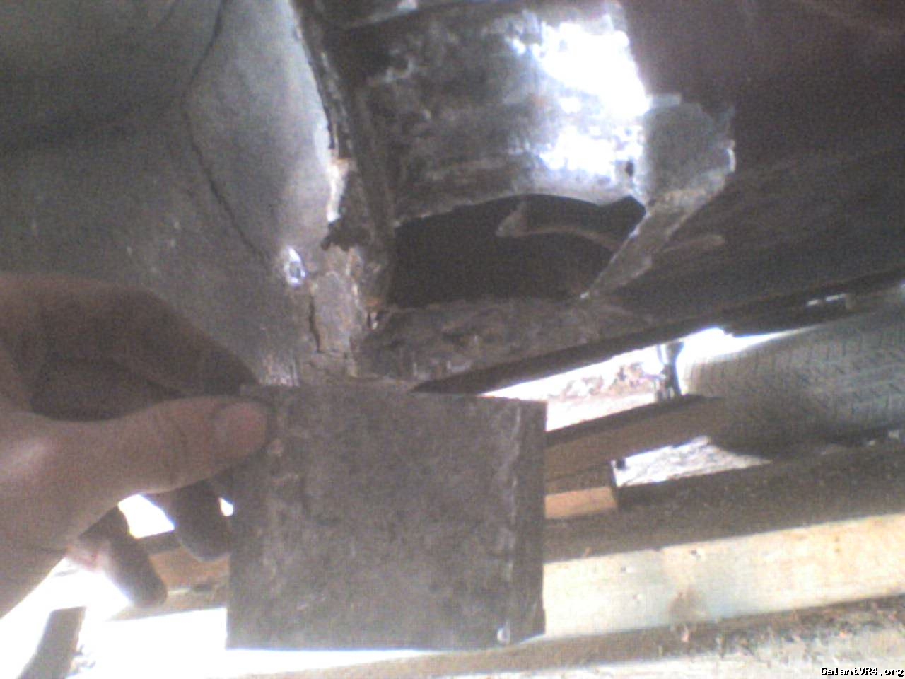

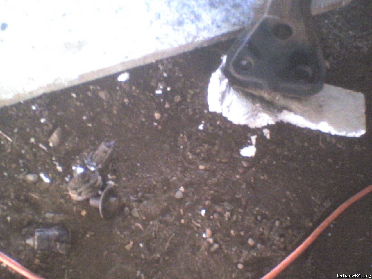

cut off the bolts for the cross brace, so that we can get new ones mounted up and thru.

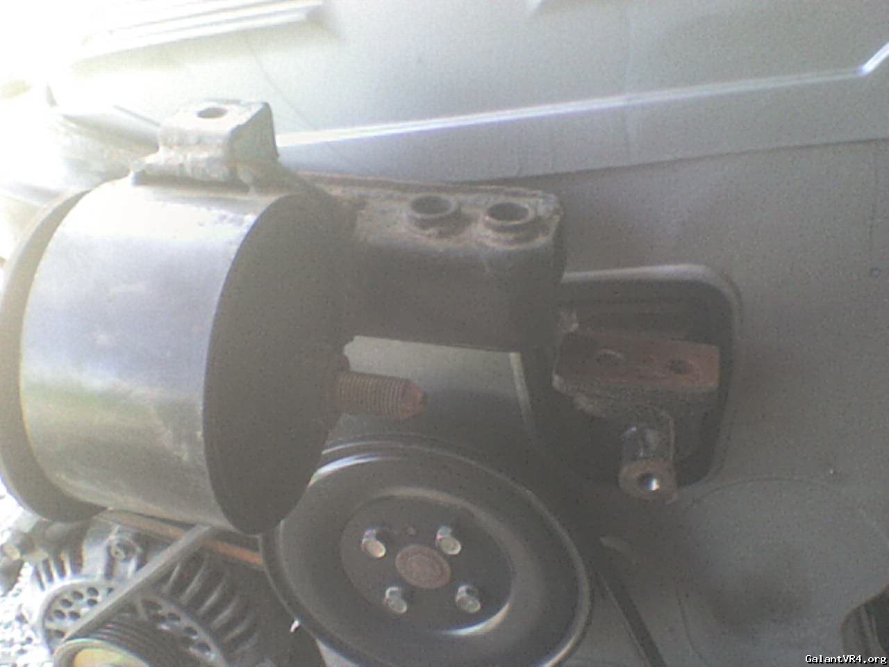

i have ran into a small problem. one that i think somone mentioned once, but i guess i forgot about it. i need a drivers side engine mount. seeing as my old one is just a little to short. please help! if you, or anyone you know, has an engine mount that they are selling, please let me know! i need one asap!

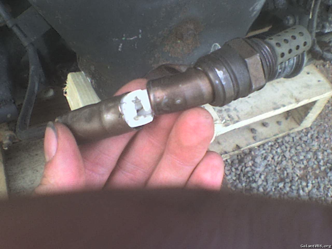

i also need a new o2 sensor, seeing as they broke the one that came with it.
again, if you have, or know anyone that has the o2 sensor for the dohc n/t, and that they are selling, please let me know asap!

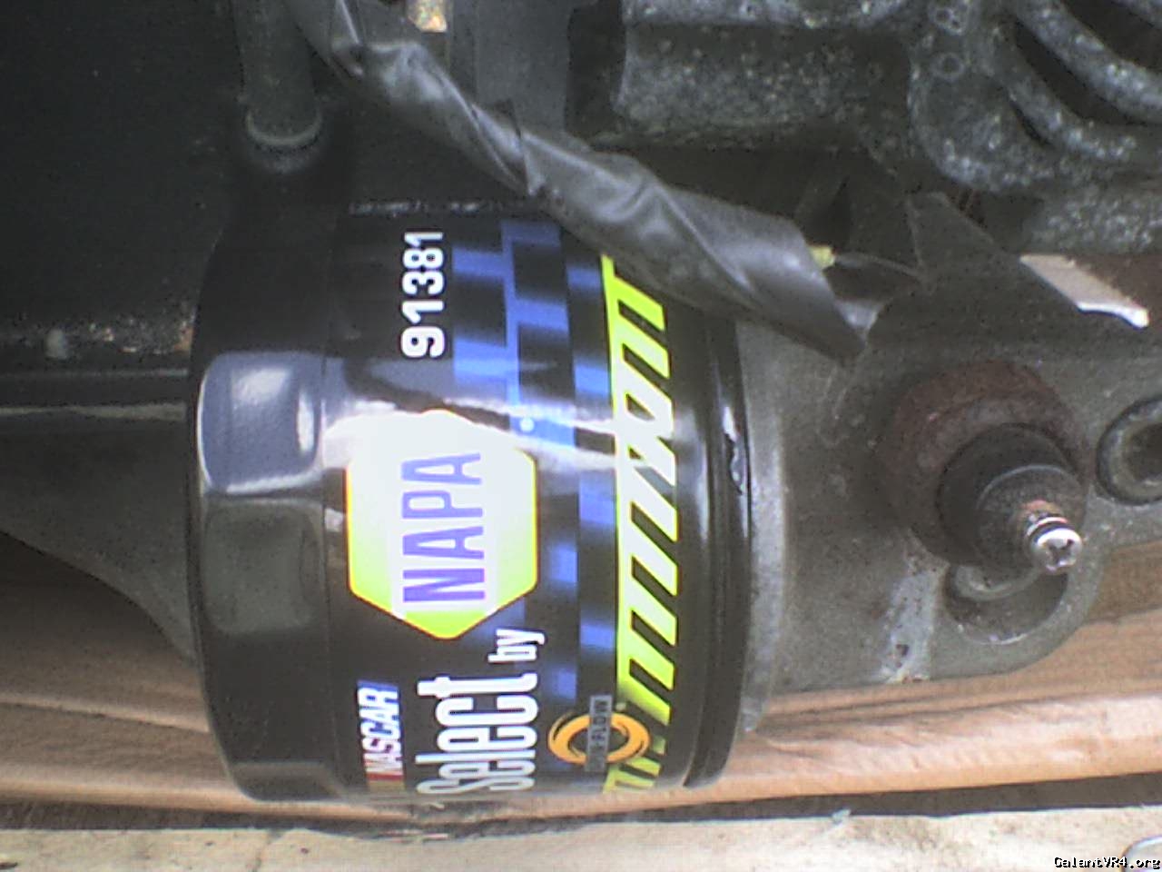

bought and installed new oil filter from NAPA

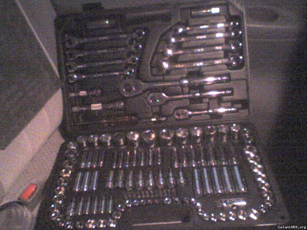

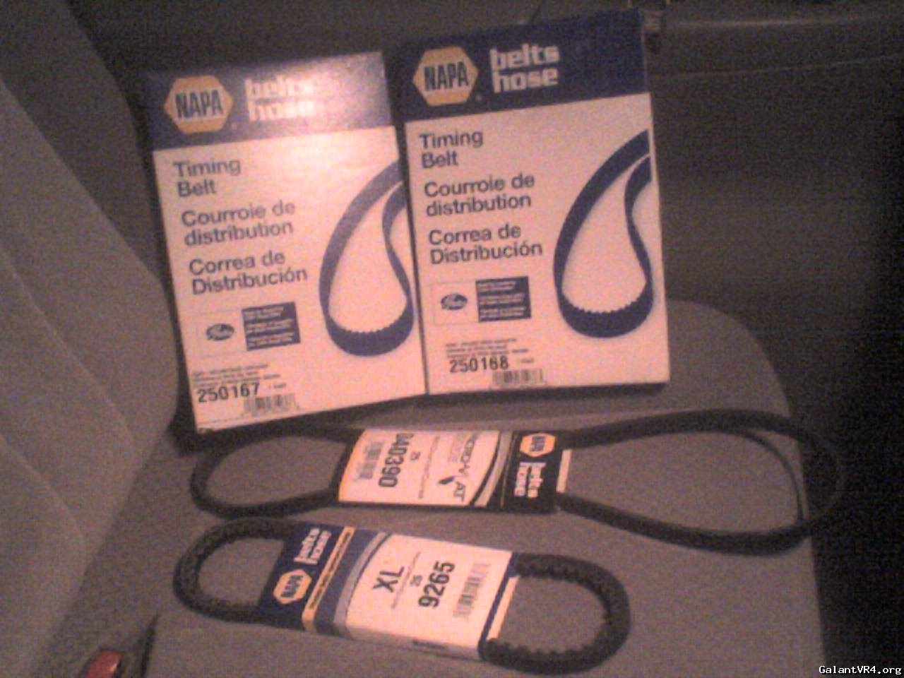

i didnt actualy get to go work on my car today, but i did buy the belts, and a new ratchet set!
here are all the belts that will be needed. i spent just over $100 (CAD) on these belts.
and here is the new ratchet set. cost me just over $120 (CAD) at NAPA. lifetime warranty. /ubbthreads/images/graemlins/grin.gif
