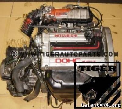

I HAVE BOUGHT THE ENGINE!!!!!
4G63 DOHC non turbo. complete engine.
ended up being $892.30 (can) total - shipping and taxes included.

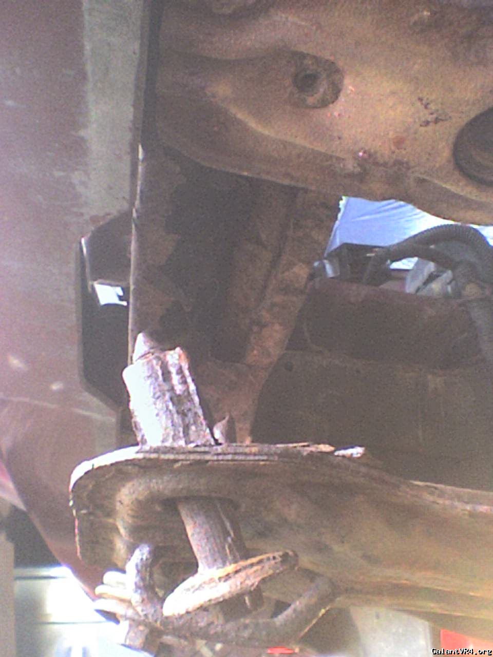

any ideas on how to fix this? the front of the engine mounts to this.
i need some way to weld the threads to a plate, and welding that plate to the rest of the car. its gonna take some custom fabrication. but i just need pointers on how to do this best. thanks.

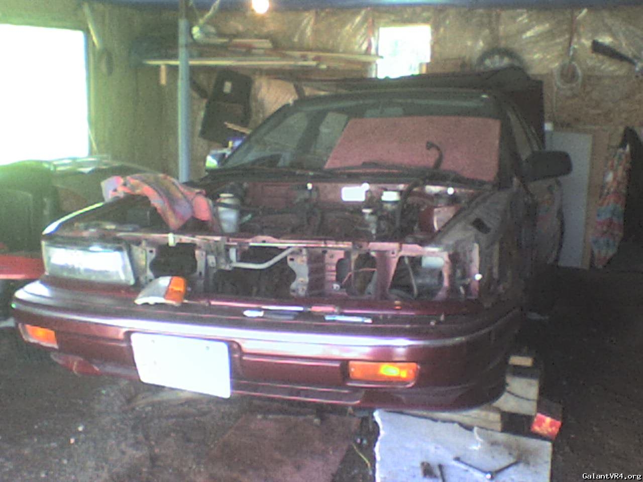

so heres an update of the work i did on friday.
i installed the rack and pinion that i bought. no looseness in the wheel anymore! /ubbthreads/images/graemlins/laugh.gif
i got the drivers side fender off. the grill, and the light.
next is gonna be taking the other fender off.
there is a little bit of rust that was under the fender, but were gonna cut that out, and weld in another piece. if you look, you can see one of the bolts that holds on the fender is still there, and with a little piece of the fender. the bolt was slipping, and it was impossible to get out. so i just cut around it.

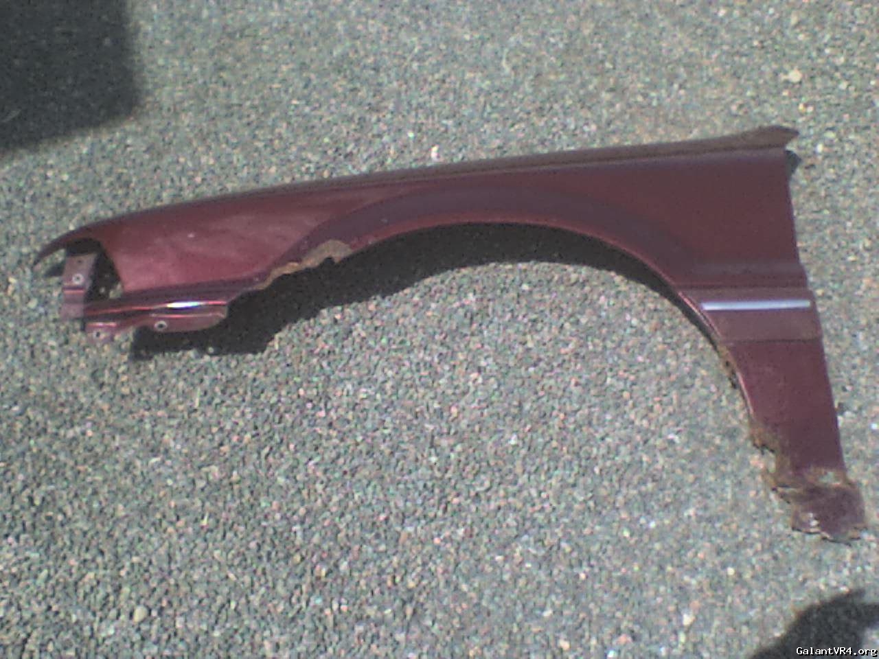

here is the fender when i finaly got it off. as you can see, one of the corners is ripped off. that thing was in bad shape.

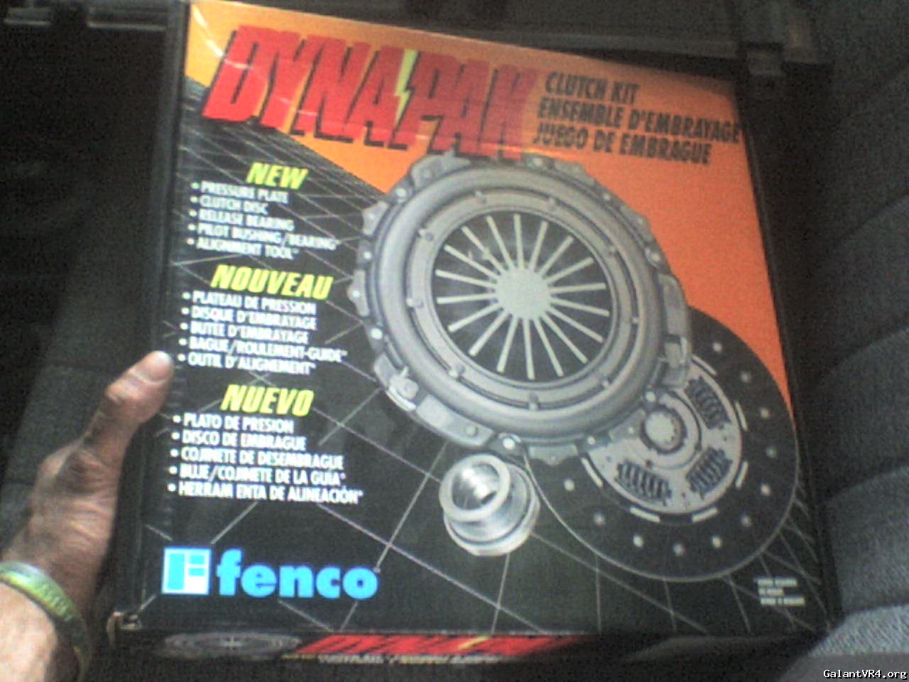

and this is the new clutch kit that i bought.

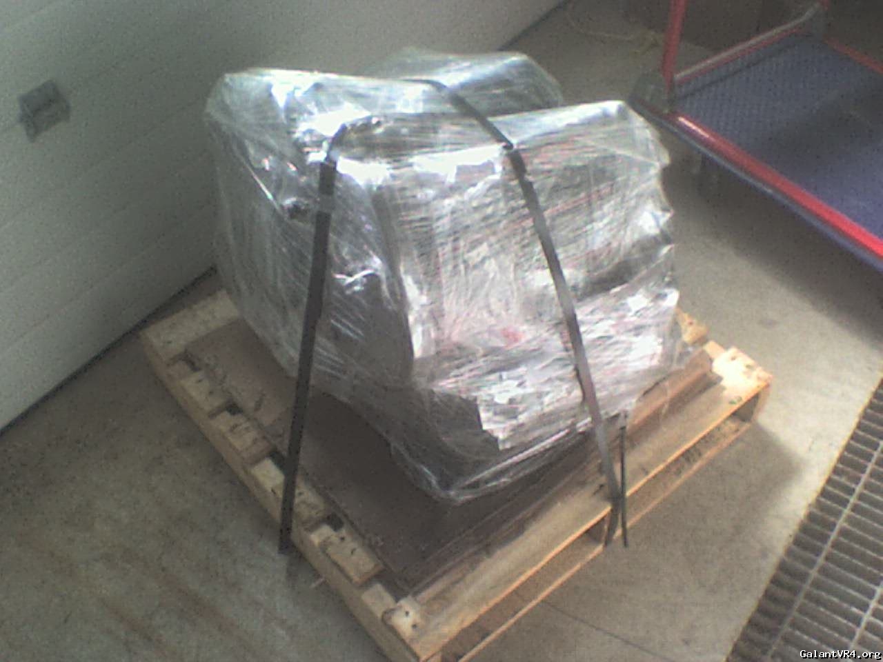

just got the engine yesterday, and took it to where im working on the car.

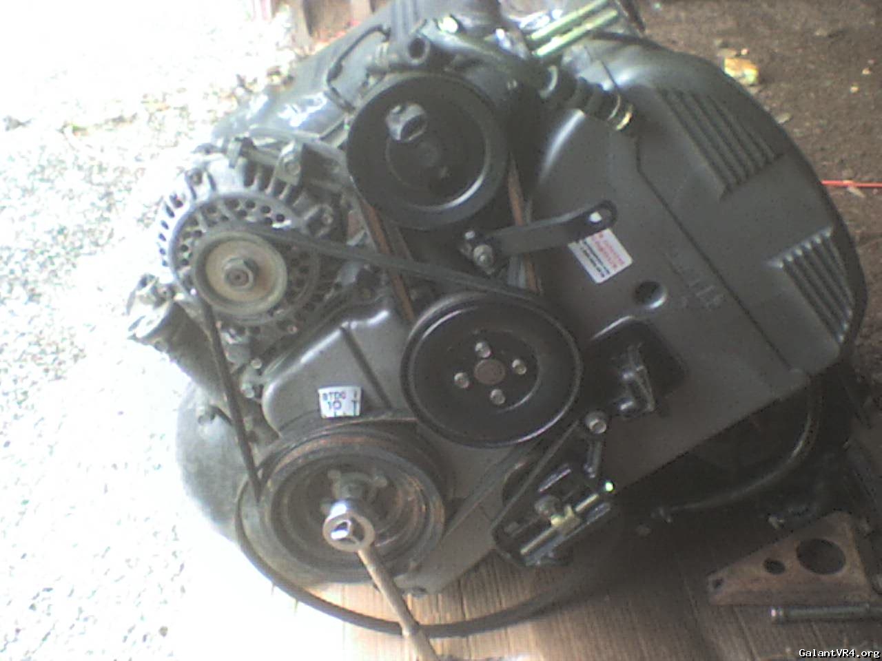

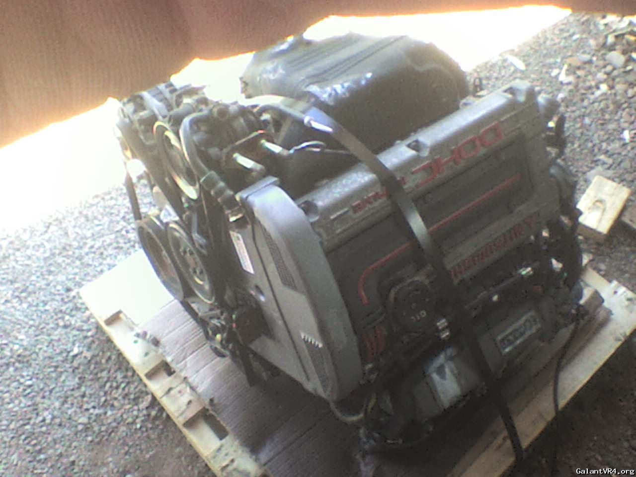

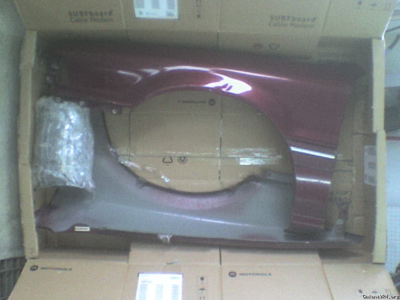

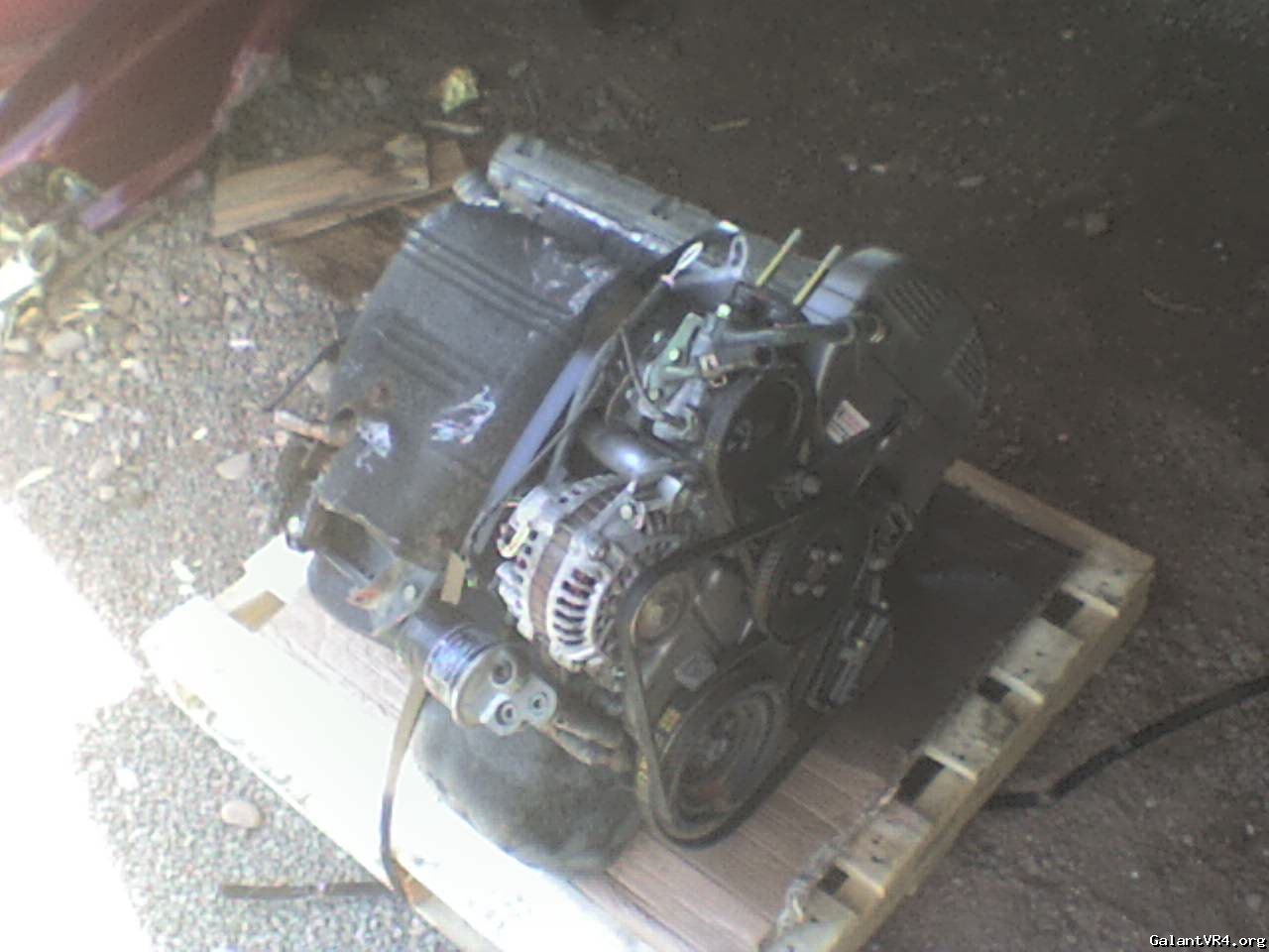

alright, so heres the pics i said i would put up.
so the engine arrived. i was soooo stoked about that.
and the fenders and the tail light came in the next day.
unwrapped the engine

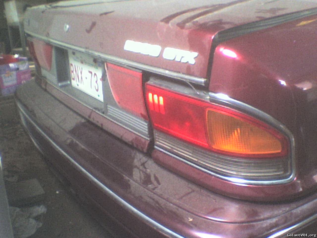

i installed the tail light in today. finaly after 2 years, i have the right tail light!
and it looks good. /ubbthreads/images/graemlins/grin.gif

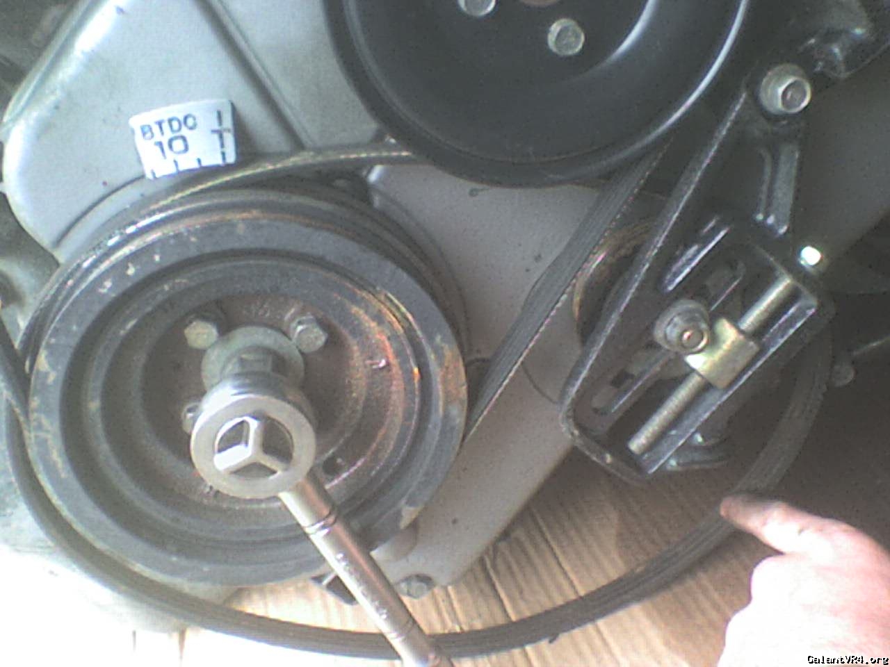

there is the one belt on the engine that confuses me.
is that the belt for the air conditioning? if it is, i dont have ac. should i go thru the hassle of taking off the belt, or just cutting it off? it looks like a good belt.

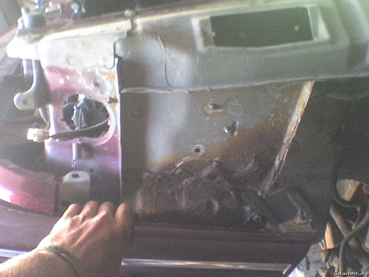

the main part that i am concentrating on right now is the metal frame work, where its rusted thru. there are only three realy major spots that need to have new metal welded in. the cross member, and the parts just underneith both fenders.
