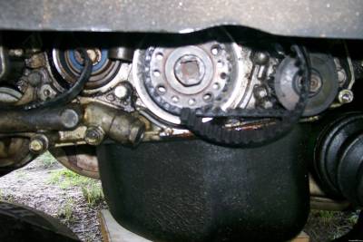

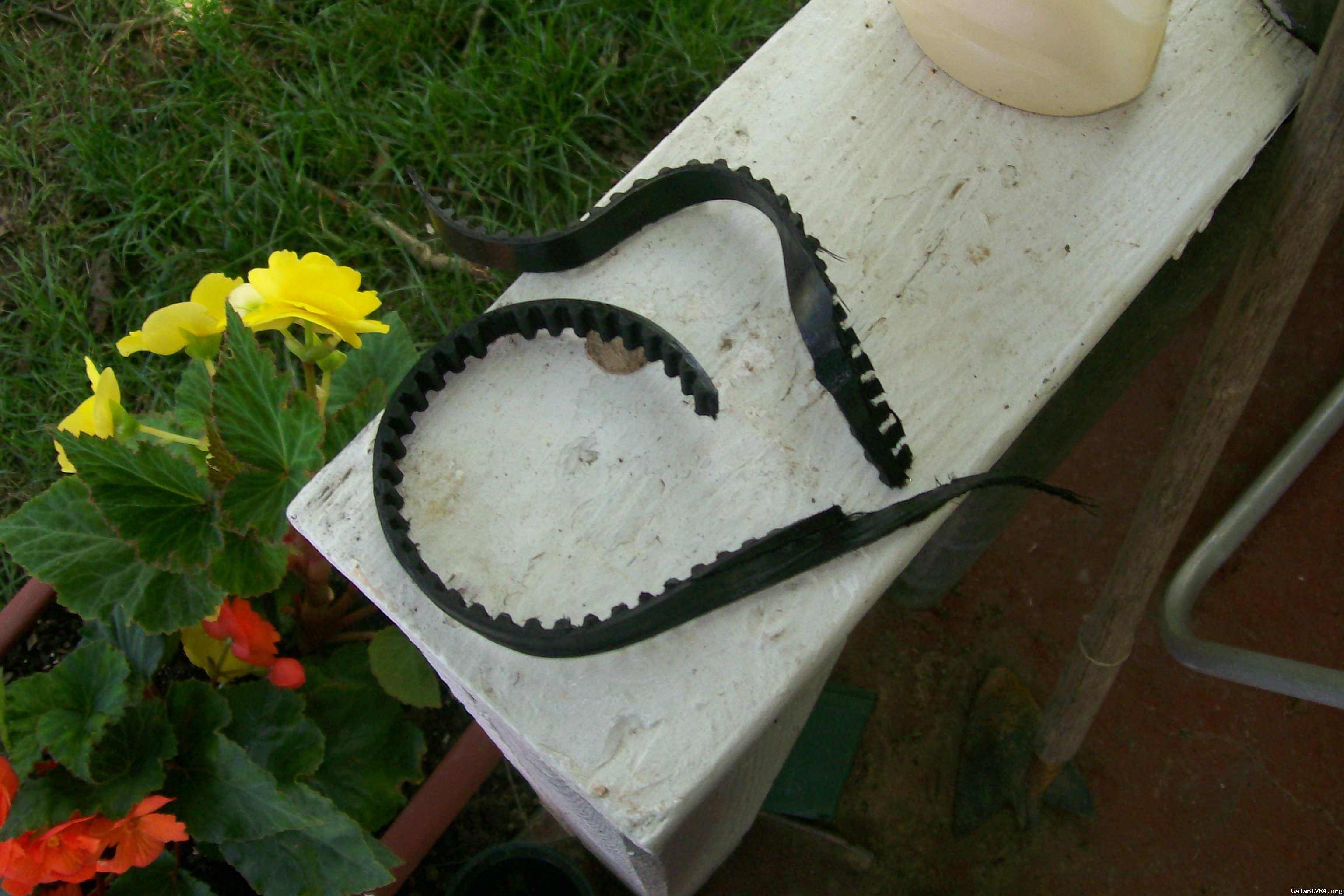

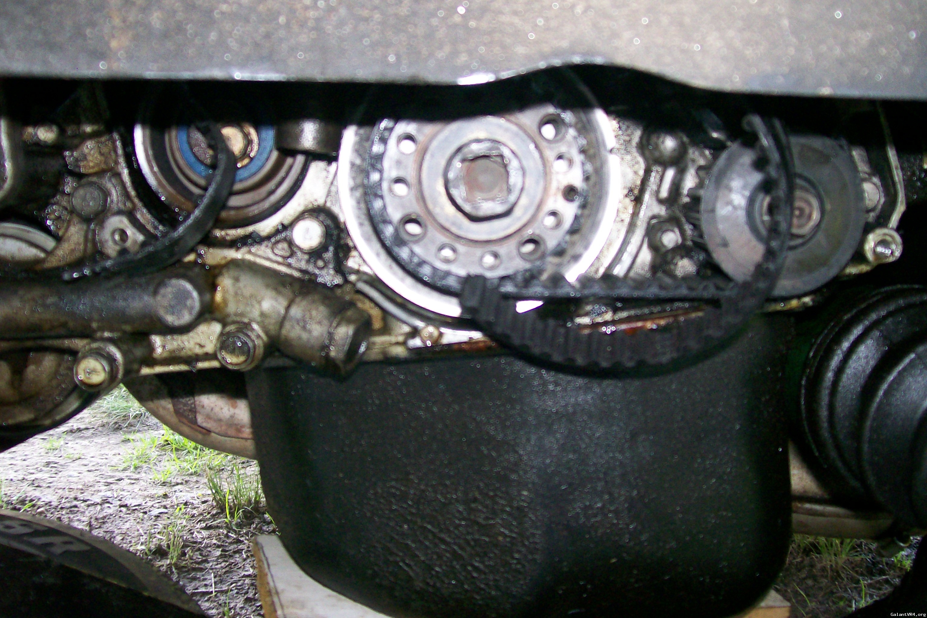

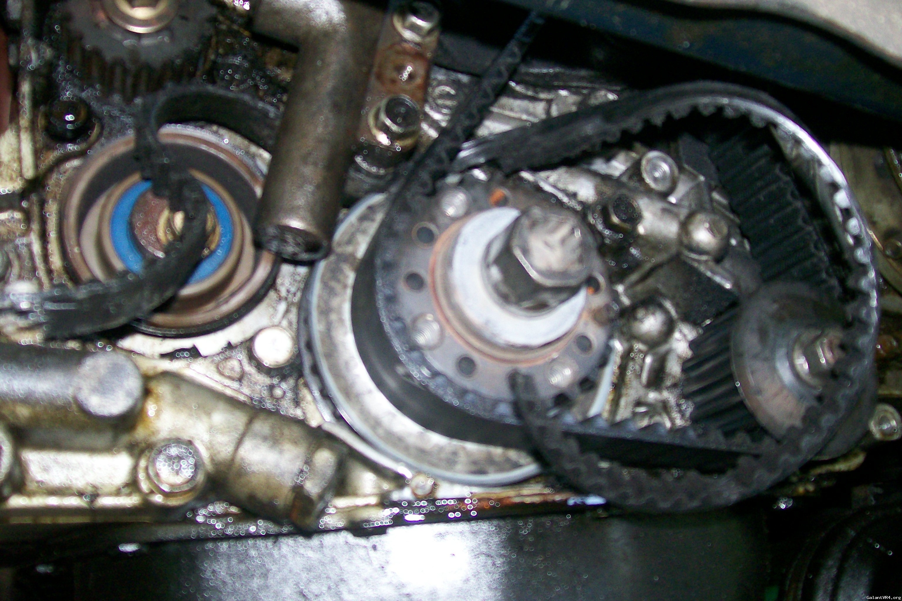

See below the first addition to my collection of obliterated timing belts (oil leak fixed, BTW). It didn't take out the primary timing belt, but it came close...

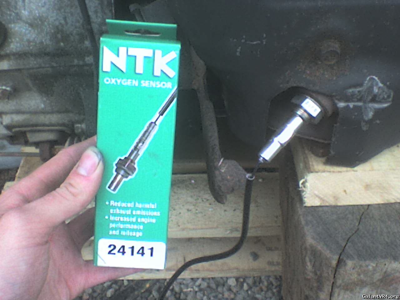

am going to be buying a new o2 sensor tomorrow.

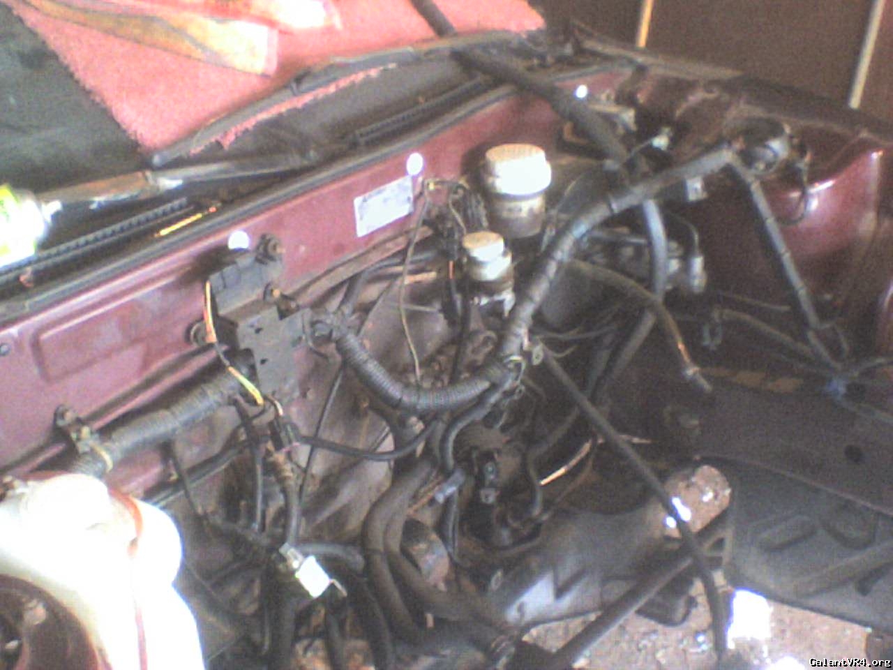

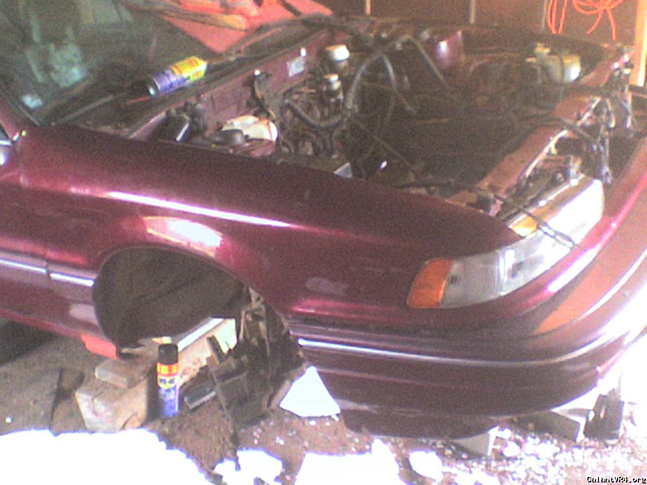

update!
but first some pics from yesterday.
i got the wiring harness in.
come to think of it, that was the only pic i took yesterday.
so on to what was done today!
bought the o2 sensor, and find out its got the wrong end on it. ill have to go and get the right one.

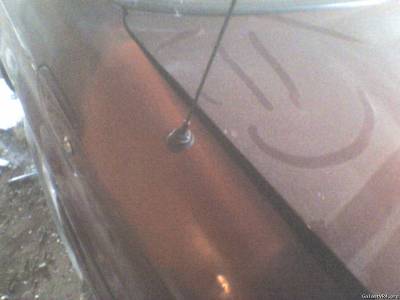

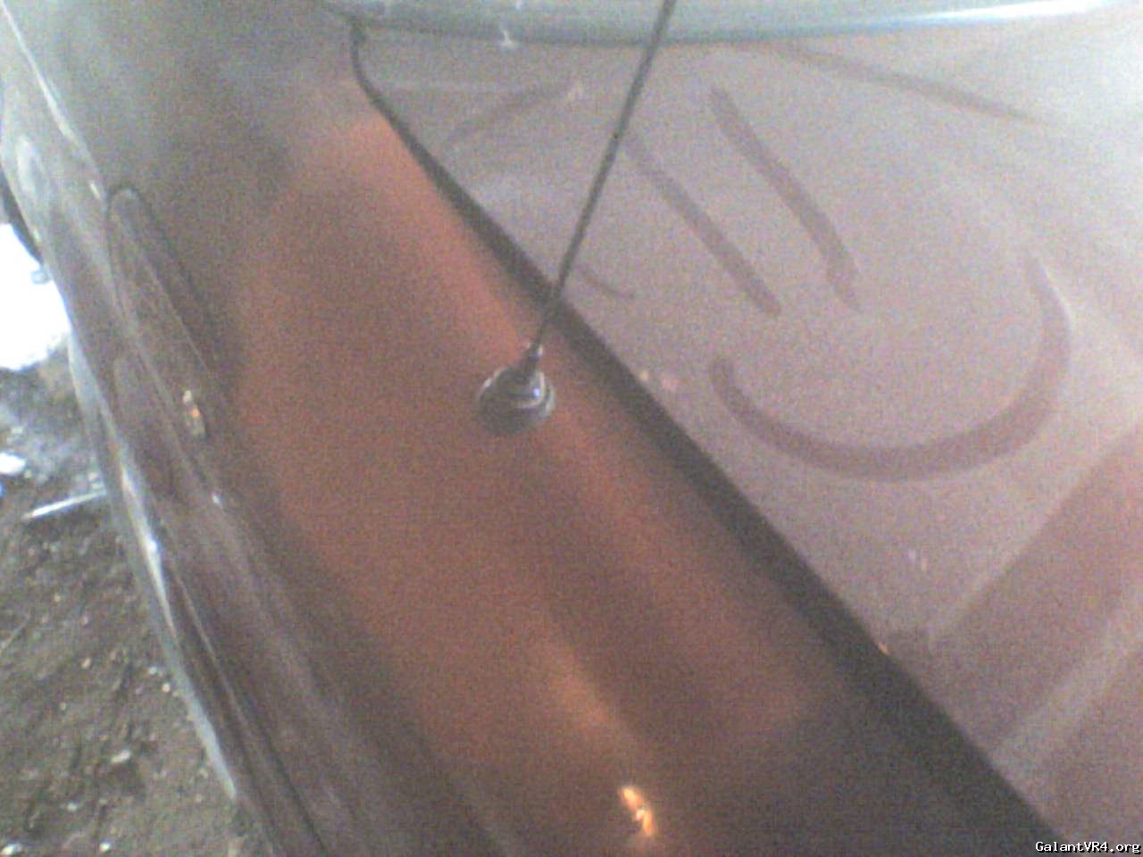

put the antena back on. /ubbthreads/images/graemlins/smile.gif

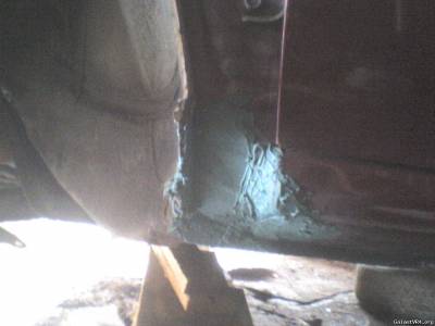

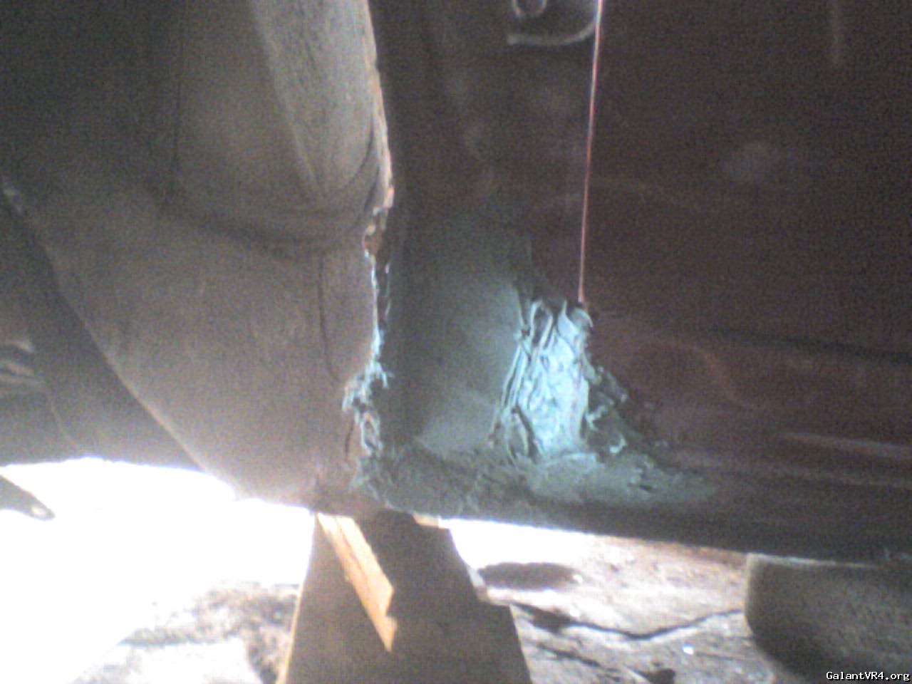

applied the body filler to the repaired area in front of the door. ill need to drill holes for the fender bolts.
got the right fender almost installed, just have to put in a few more bolts.
well, thats all the pics for today. but ill get some more up tomorrow.

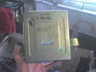

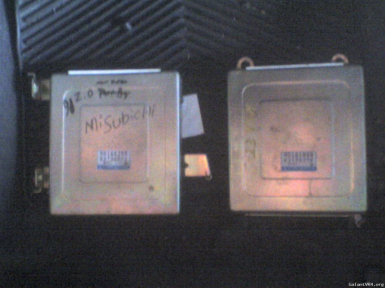

i installed the ecu.
since the case mounts were different, i just switched the back mounting plates, and installed it that way. /ubbthreads/images/graemlins/smile.gif

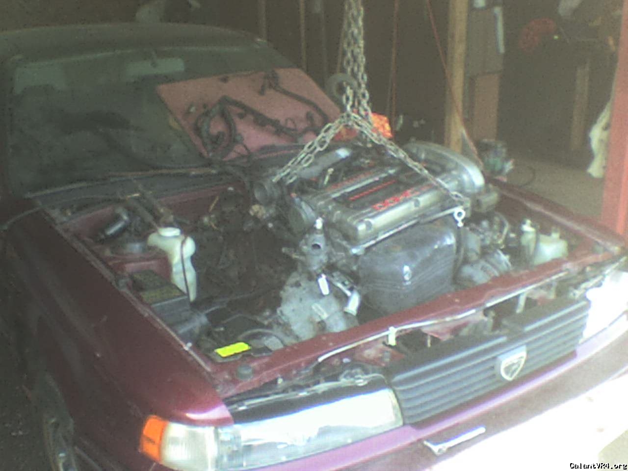

no, the cars not running yet...... but i dropped in the engine today!!! /ubbthreads/images/graemlins/grin.gif/ubbthreads/images/graemlins/grin.gif/ubbthreads/images/graemlins/grin.gif/ubbthreads/images/graemlins/grin.gif/ubbthreads/images/graemlins/grin.gif and its all bolted in too.
so today we packed everything up that was mine, stuck it all in the car, and towed it back to my house.
all that is left now is to wire it all on, and fix all the broken bolts. /ubbthreads/images/graemlins/wink.gif

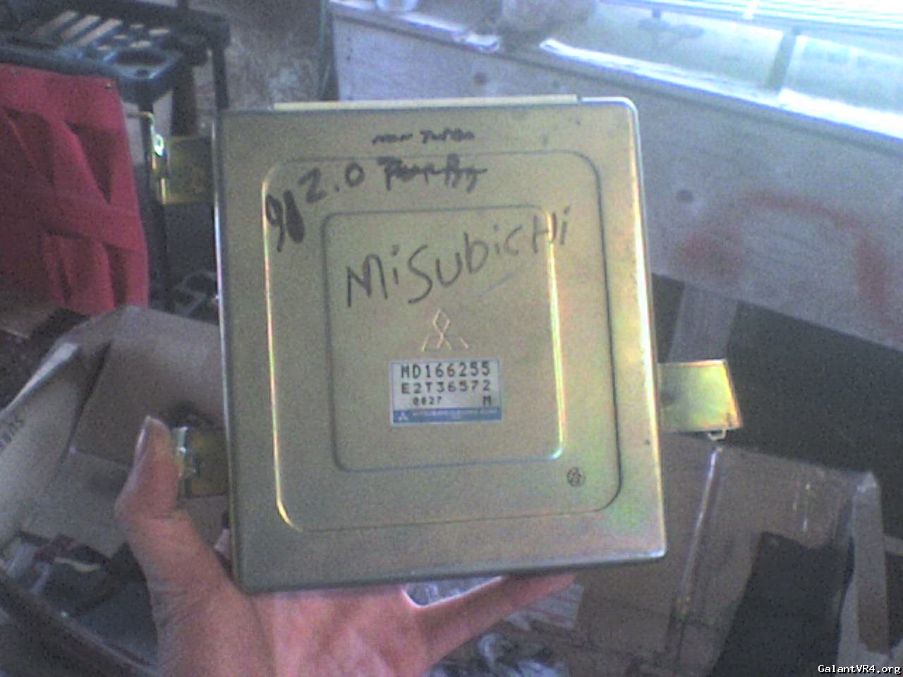

so just a couple of pics from two days ago.
this is the new (used) ecu that i got.
these are both of the ecu's.
they had different casings.
so i swapped them so it would fit.

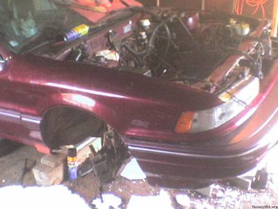

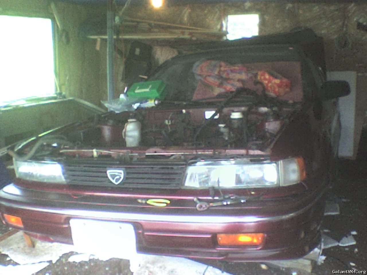

so this is now from yesterday when i got the fenders back in place (not completely attached mind you), and got the lights, and the grill back.
and now for today!
my dad and i putting the engine in.
got the ingine in, bolted the hood back on, and packed everything into the car.

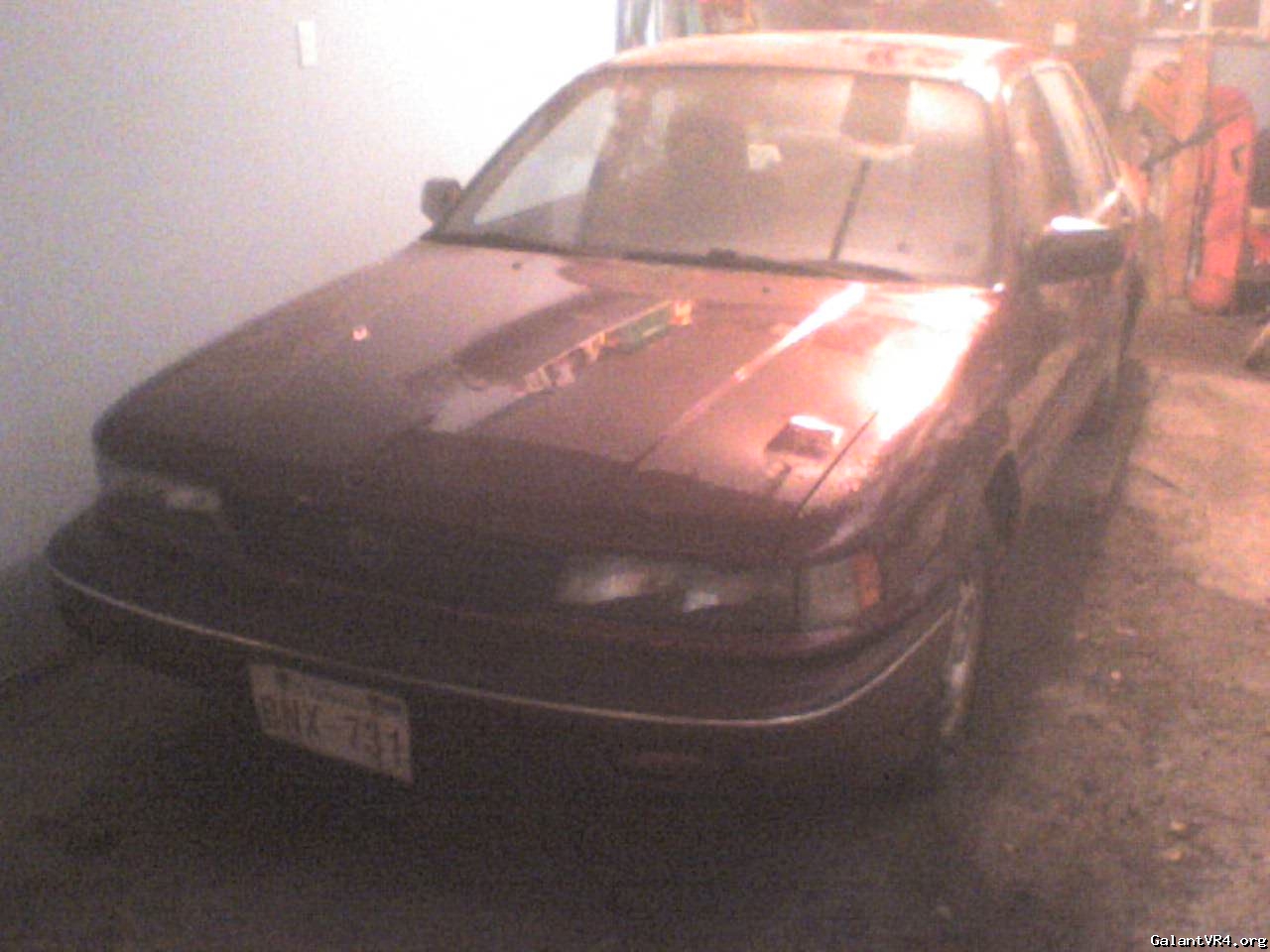

pushed the car out into the driveway. gonna be picked up by a flatbed. it looks good. /ubbthreads/images/graemlins/cool.gif
and the back end. finaly the tail lights match again!

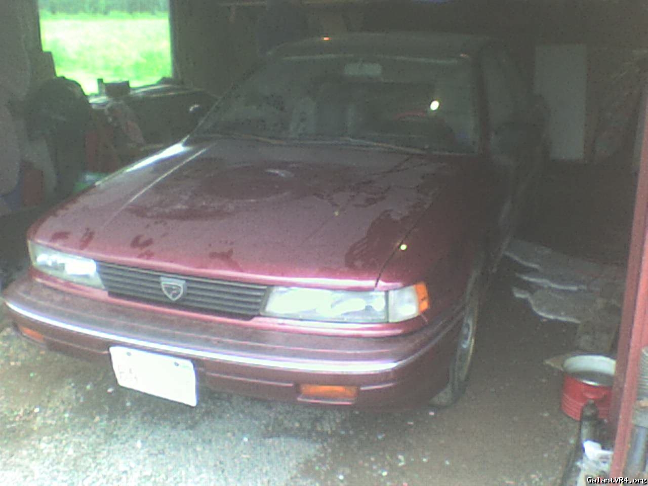

finaly back home, and sitting in my garage. /ubbthreads/images/graemlins/grin.gif Ahhhh... finaly.
now i can work on my car a little more relaxed, and i dont have to drive anywhere!
.... my car is realy dusty. lol
when im done, ill give it a good carwash.
