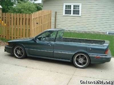

(Trucklants weigh as much as a luck dragon /ubbthreads/images/graemlins/wink.gif )

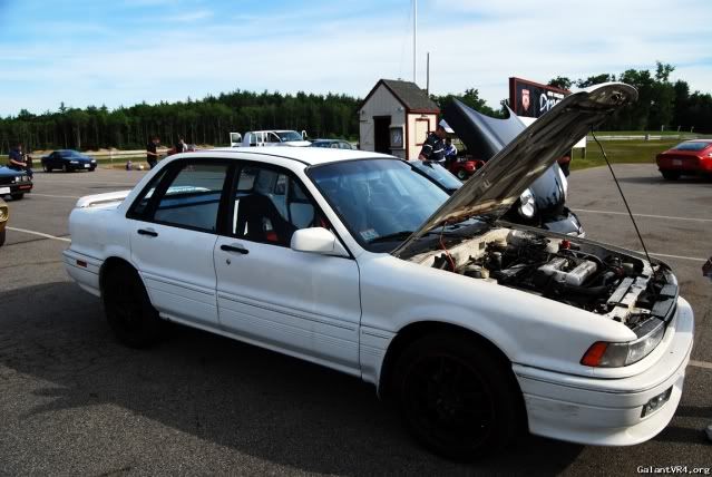

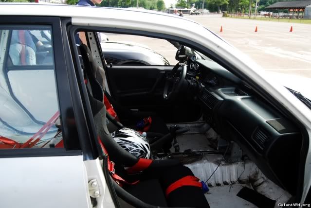

Mine isn't a true VR4 but ggsx, so its already light, but the last time it was on a scale before I parted was 2890lb with me (120lb).. No interior, two racing seats weighing 10.2lb each, seam welded interior, no a/c,no abs,welded sunroof,alum door panels, gutted trunk, 13.5lb each wheels etc..
Pictures courstey of Besso /ubbthreads/images/graemlins/grin.gif

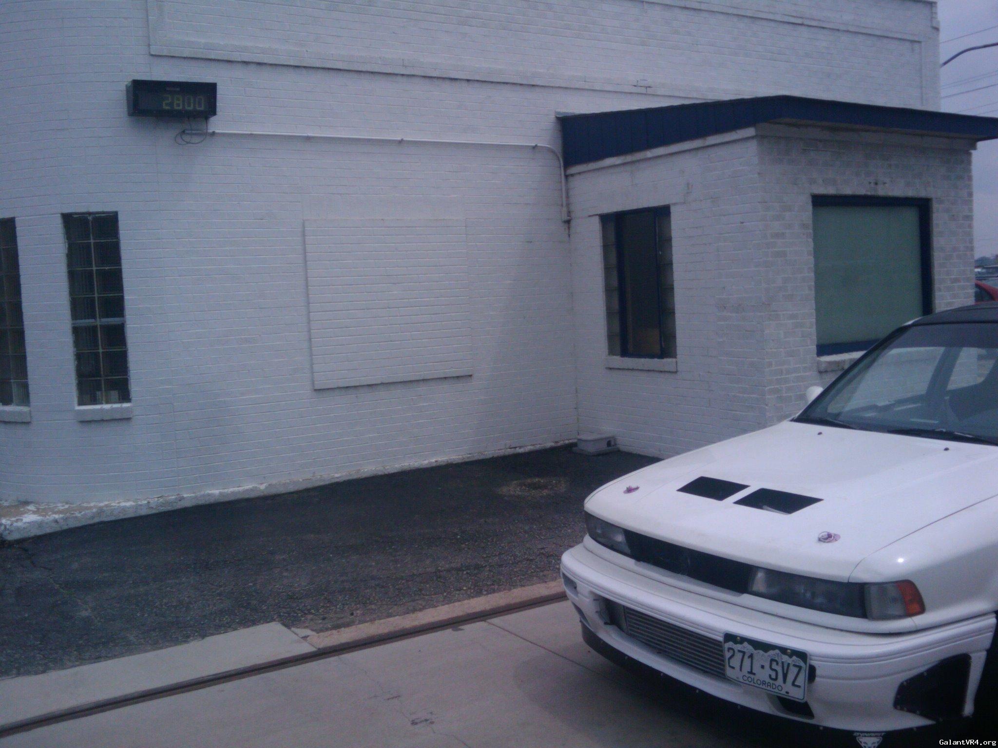

Last season i had mine down to 2800lb with a full tank of e85 and a lot left to take out.
