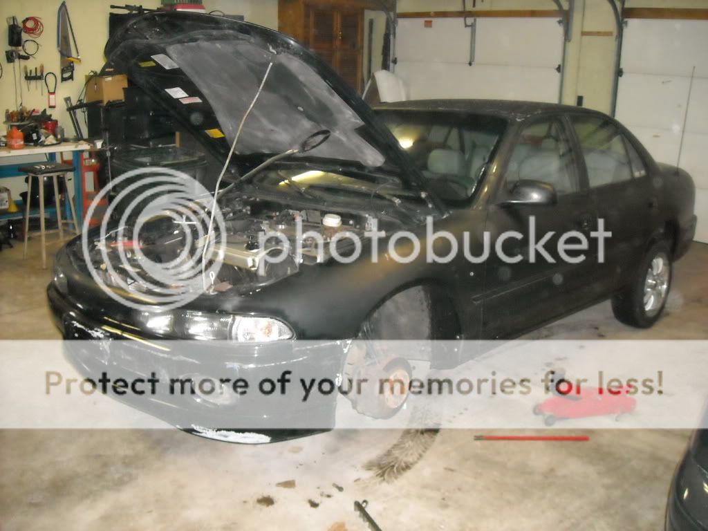

well I've got some experience with cars, but not a ton but.........
A friend of mine has turned his 7g Galant from this
to this
and a friend of mine has a shop that I can use whenever I want that has every tool/machine anyone could ever need
and for the record, I
that's what I was thinking in my wanting to use the GGSX as the platform for my project car
Alright, now I just need to buy this shell and get started on the build
