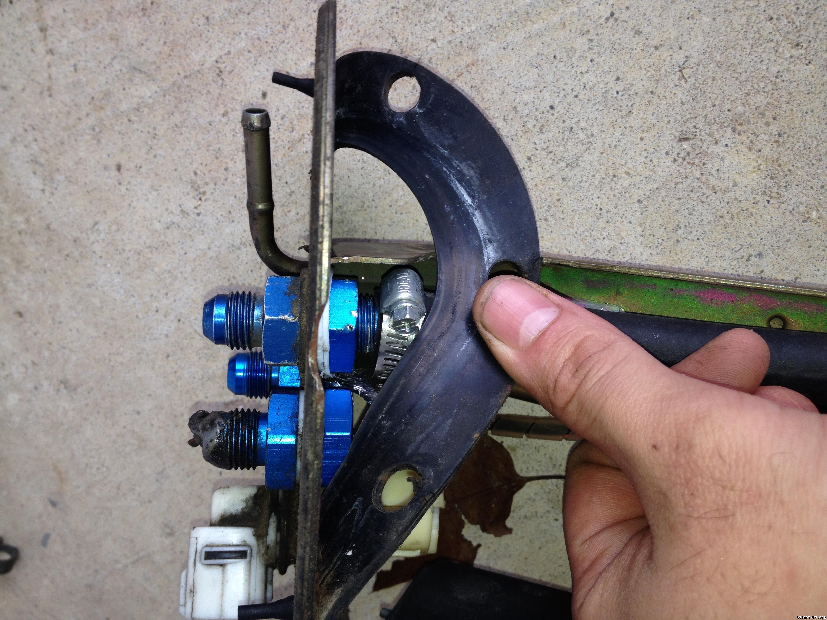

Here is pic from my STi. It's not welded and you can see how easy the crush washers get deformed

My trunk always smelled like gas from it not ever sealing properly. Maybe I just over torqued it.

Highly evident you did over-torque them. Aluminum washers don't take much to seal. If they deform then either you reused them over and over, or they are over-torqued.

The ones on my car weren't aluminum, nylon sounds right. I would have said plastic /ubbthreads/images/graemlins/blush.gif

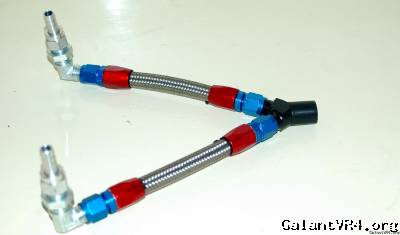

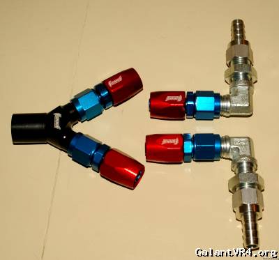

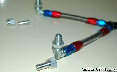

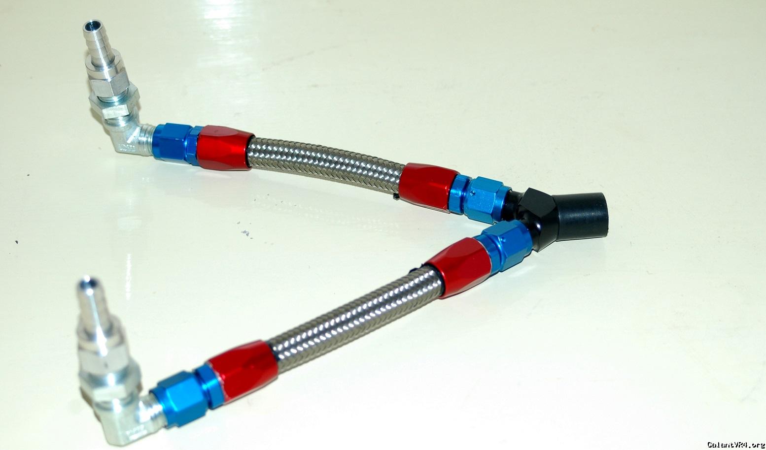

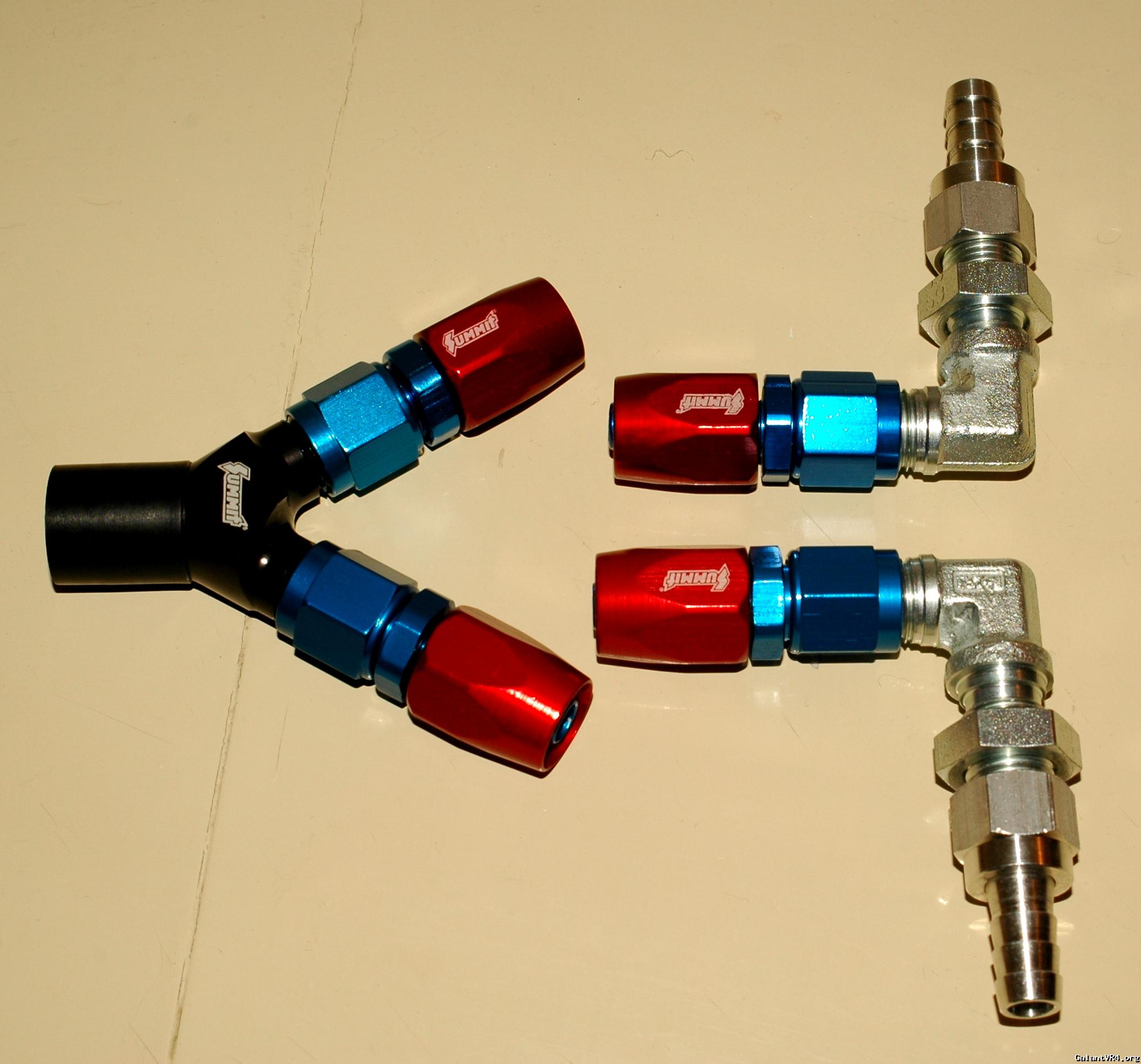

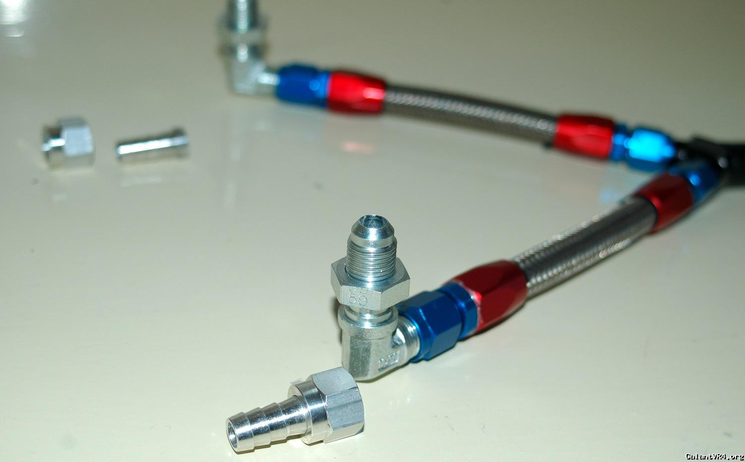

I'm getting ready to do a double in tank in mine and this is how I am going to set it up. I already have -8AN line going to the back of the car.

If I was just doing a single intank....I would do the 90deg -8AN bulkhead fitting as seen here then get a -8AN to 3/8" adapter fitting like this one and you are good to go.
