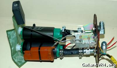

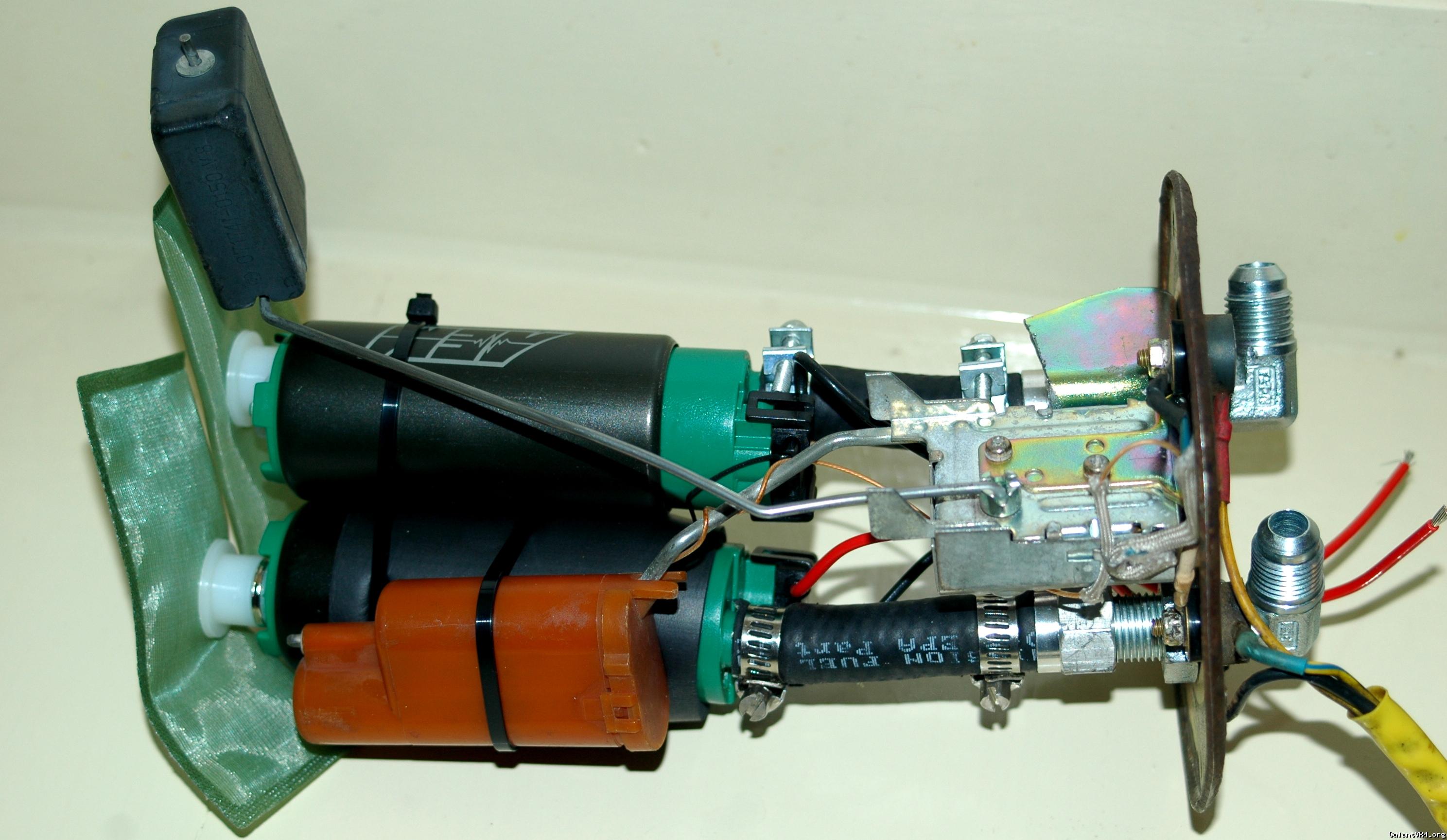

I don't have a Walbro 255 pump here with me but that's what I normally use. Coincidentally...I do have the Walbro 400lph pump sitting here and I mic'd the outside diameter of the outlet. It came out to be 0.3638" and the "barb" part was 0.3916". A 3/8" inside diameter hose = 0.375".
