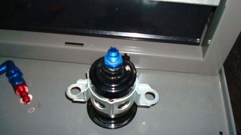

I joined the AN line with the hard line from the pump with a Earls fitting from Summit, (Female M14 1.5 thread, to male -6an) And it threads on like a glove.
I've seen -6an line coming from the top of the stock filter, where the bango bolt is used. I heard the banjo is the most restricted part of the system.
But the threads underneath could be the same as on top, so you could get the fitting to make it convert to -6an.
If you like that idea find the thread size and I can almost promise you that Summit has got it.

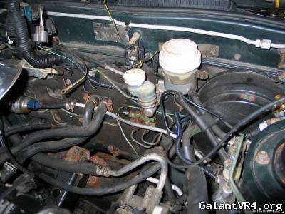

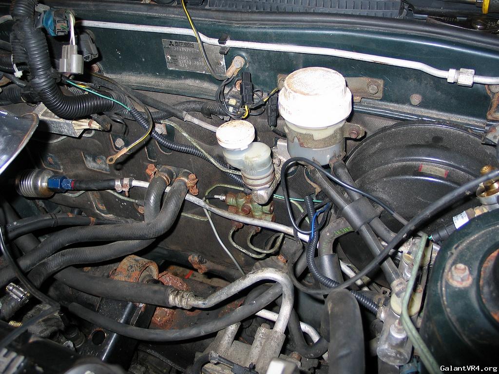

Pushloc connector with rubber hose over the hard line tightened down with clamps. /ubbthreads/images/graemlins/grin.gif
Previous owner did it when he replaced the hard line from the tank to the engine bay. Don't mind where it's currently sitting - I have everything pulled apart to replace my intake manifold and replace my rear brake hard lines. Needless to say, it works just fine this way. I'll probably clean it up since I have everything apart again, but leave it functionally the same.

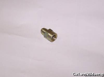

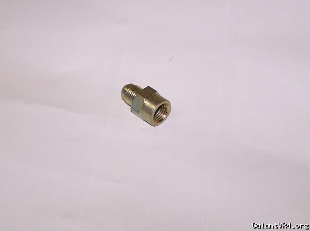

I've got this metric to -6AN fitting that will convert our factory line pre-filter to a -6 AN. You can then attach a -6 AN filter to it. This is for those that don't want to upgrade the entire line from the tank to the rail. The problem is they're $20. Still a lot cheaper than upgrading the entire line to -6 AN.

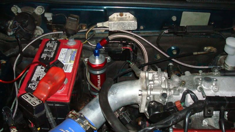

I wanted to be a cool kid and converted my sending unit over to a 6AN bulkhead to a 6AN teflon SS line to a fuel lap fuel filter then 6AN lines to the Fpr retaining the stock return line
The fitting Kenny posted will also work by converting the pinhole factory fitting to a -6AN fitting. Then all you'd need is the a -6AN pushloc fitting, ~1' -6AN pushloc hose, -6AN pushloc fitting & a -6AN rail adaptor.
Garfield,
Does the fitting you have shown have an inverted flare inside the end with the female threads?

Really?... Thats interesting. I just had to buy a Russel fitting from summit racing. Only on the inside of the end with the female threads, it didn't have an inverted flare. It was just flat on the inside. So I just used an O-ring, not the most ideal thing but it doesn't leak.
So since you are selling one of these fittings that in fact does have the inverted flare on the female thread side everyone should get their fitting from you. Because summit doesn't sell one that does, or anywhere else for that matter.
On a side note for anyone wondering this fitting will also connect to your factory sending unit and allow you to connect braided line with a female hose end on it. Granted that its -6 AN.
