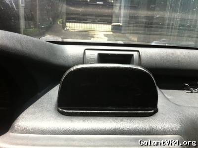

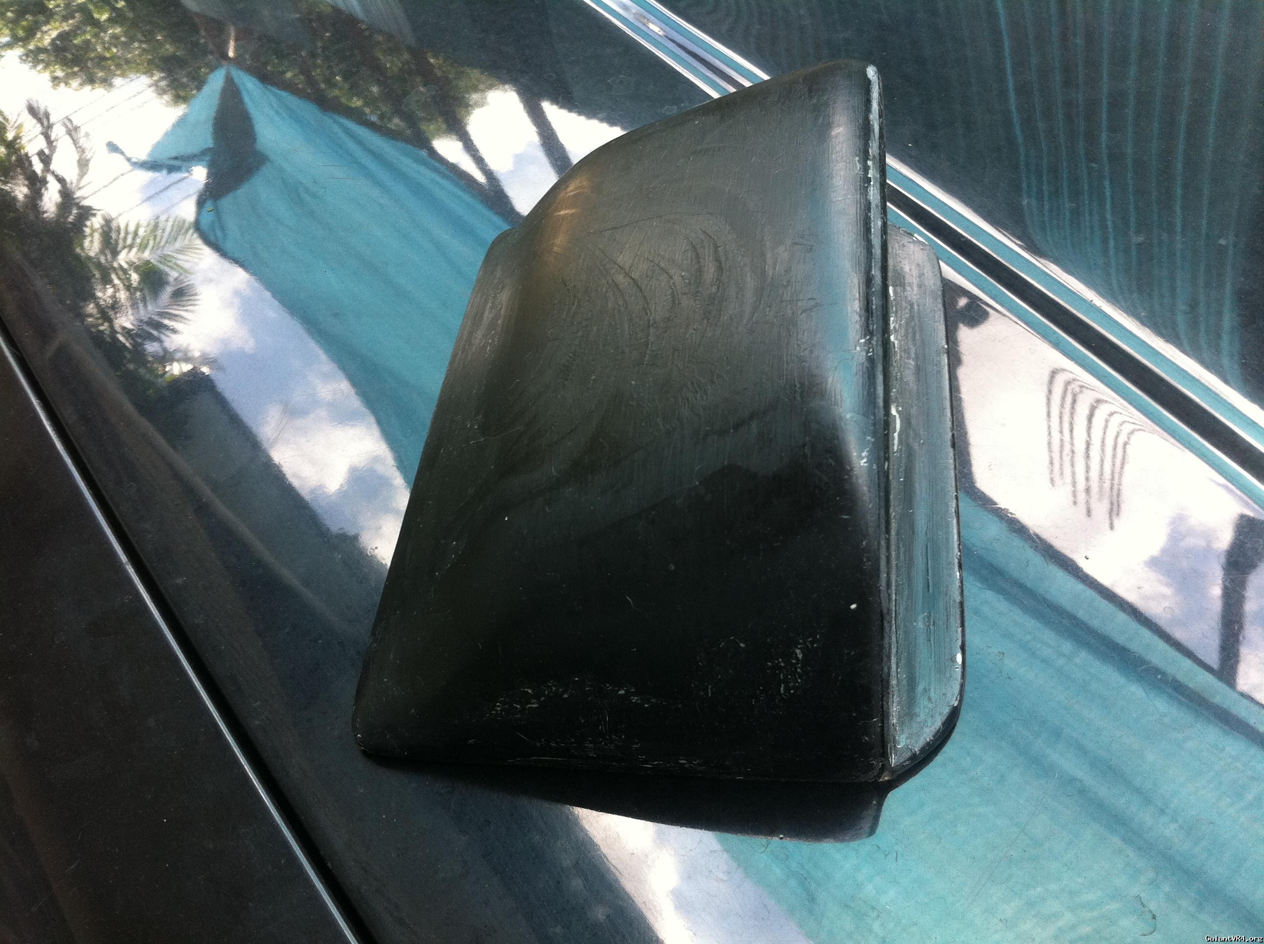

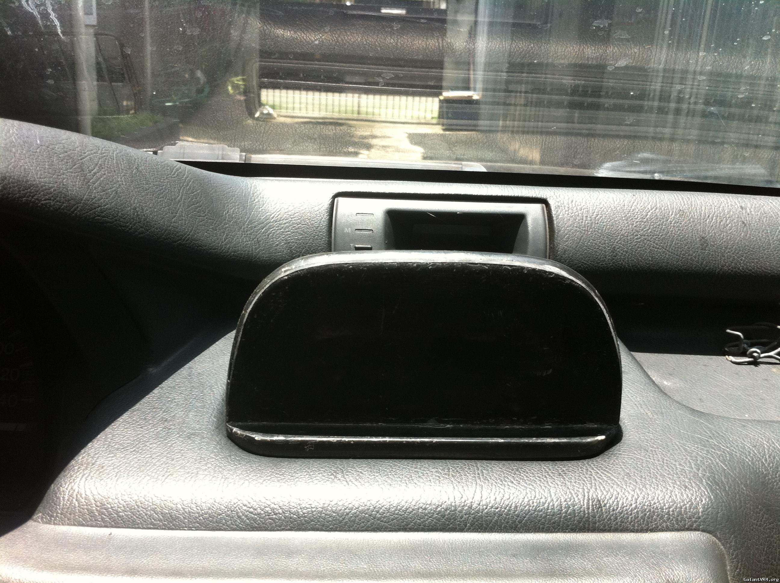

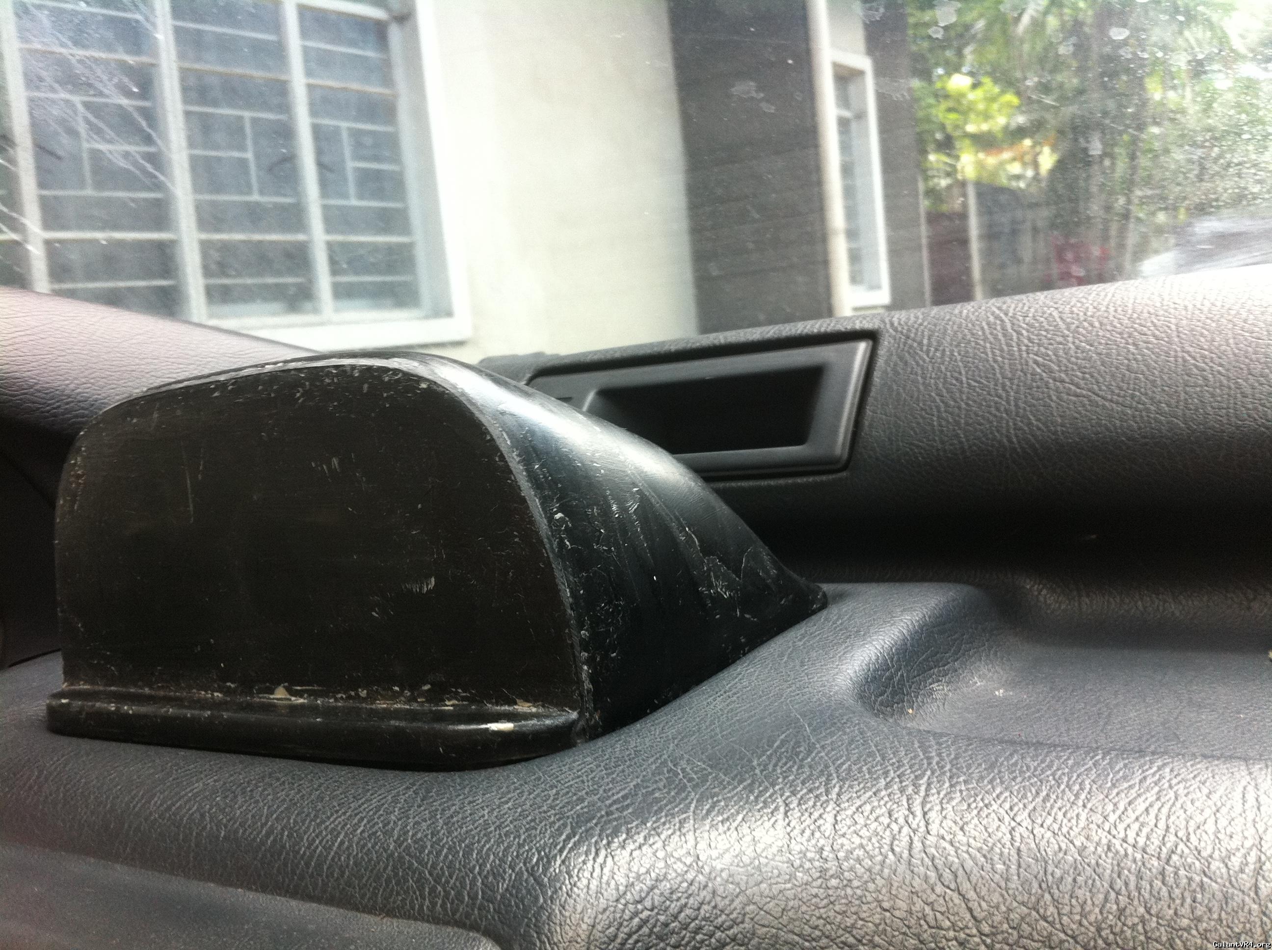

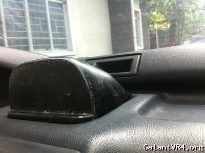

If you do this properly, use the correct type of gauge and make a plate to recess the gauge properly, it can come out fairly slick. You have to be committed to using it though because as stated it is a non reversible process. if you want to make it fit this well you are going to need to cut up the dash. There are a number of reasons why this is necessary.
First of all look at the third picture. If you recess the gauges properly, because of the angle that they sit at the area under the gauges (that little dash pocket in your USDM dash) is not deep enough. You have to cut out the bottom of that area or two pieces of it to recess the gauges into it so that the pod sits flush.
Secondly, if you cut away the vinyl at the edges of that recess you will uncover small holes that the bottom frame of the ECS pod can clip into. In the pictures above I did not use the frame because the pod I bought didn't have it (only the top cover). I will do another pod for my daily VR4 and I will endeavour to use the bottom frame to clip that one in. Either way works but both require cutting of the dash. The method I used for attaching my pod above was easy BUT my dash was out at the time. It would be difficult to use that method with the dash in the car. if you don't want to remove your dash, the clip in frame is the way to go.
Thirdly you will need to cut holes to route the wiring to the sensors.
I had no issues doing this because both my JDM cars had flip up pockets at that location in the dash and both were FUBAR. Removing the broken lids left a pocket/recess similar to yours but with exposed foam and holes etc (generally unattractive). The pod in comparison looked much better so hacking up that area under the pod was not an issue for me. You might be less willing to start doing the same to a virgin dash. That said if you do it properly once the pod is installed you won't see any of that and it will look factory. You just won't be able to remove it.
If you want it to be reversible you would have to attach the pod with velcro. In this case it won't sit flush, you would need to run the wires over the dash and it would in my opinion look crap.
Bottom line, think hard about if you want to do this and if you do, cut the dash, do it properly and don't look back.
