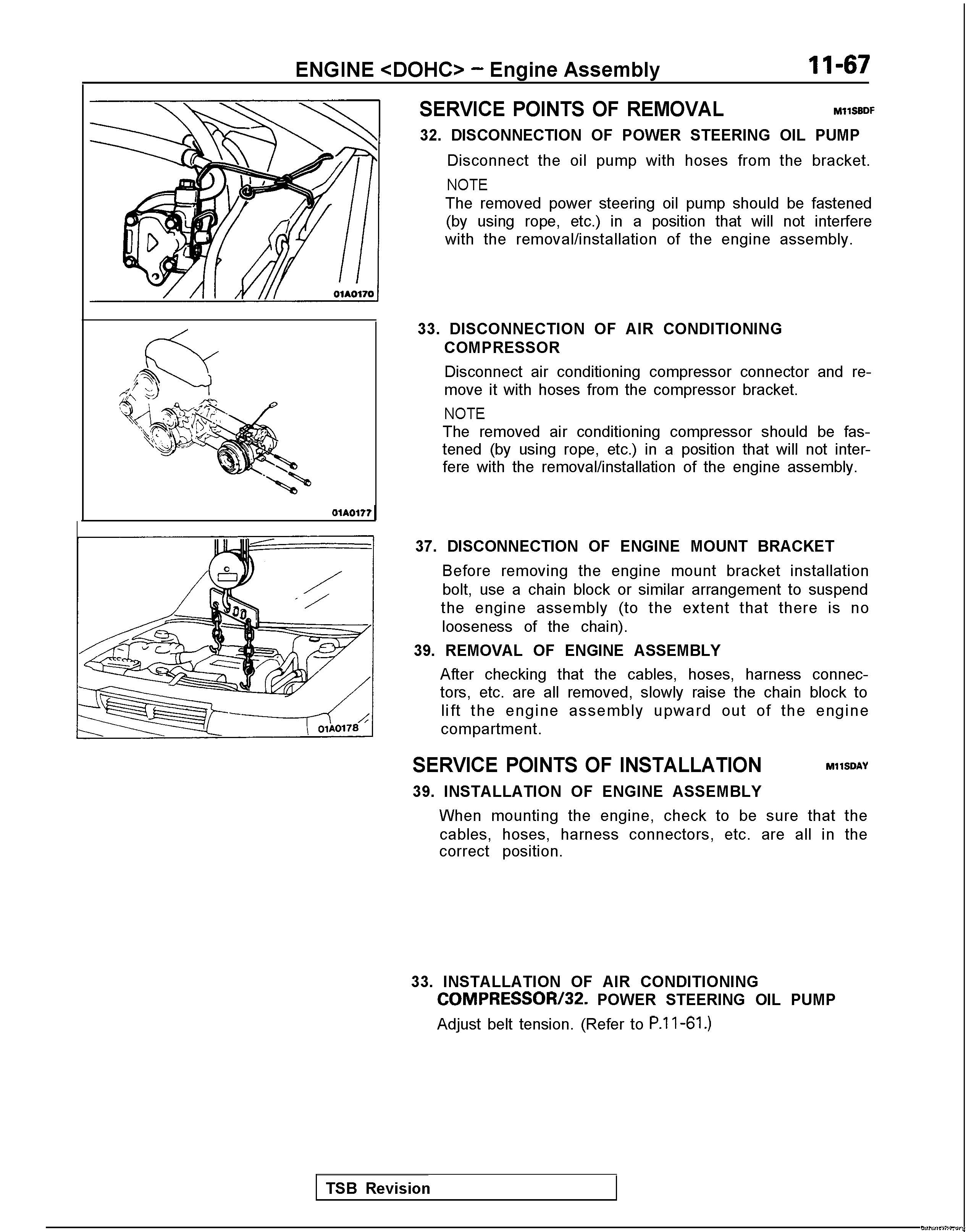

When I removed my engine, I tied the A/C compressor up with rope (spare piece of electrical wire actually) so the refrigerant lines weren't supporting the weight of the compressor. My A/C is original, has never been touched, and is ice cold /ubbthreads/images/graemlins/worthy.gif. I wasn't going to take a chance on loosing it.
Just make sure all the electrical connections (knock sensor, etc.) are undone before you start hoisting it out. The factory manual pages for the removal process are a good thing to have, just so you can remember everything. You might consider labeling the connectors (I did, using masking tape and a sharpie).
