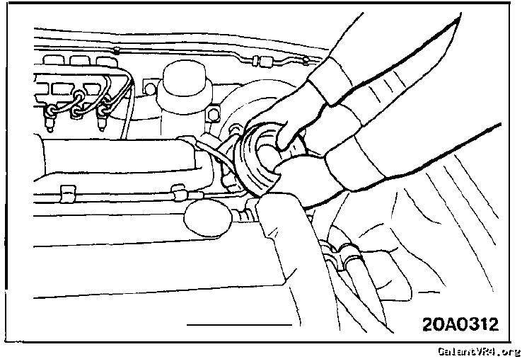

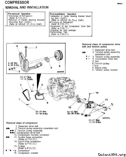

Here's the manual page about it:
Here's a picture of it being removed (not sure if this helps at all /ubbthreads/images/graemlins/dunno.gif)

Guess I forgot to add that in my first post. The compressor is free of everything, lines , bolts, connectors. I tried to bring it the way the FSM told me (like your pics, i have the same manual), but it catches on the master cylinder.

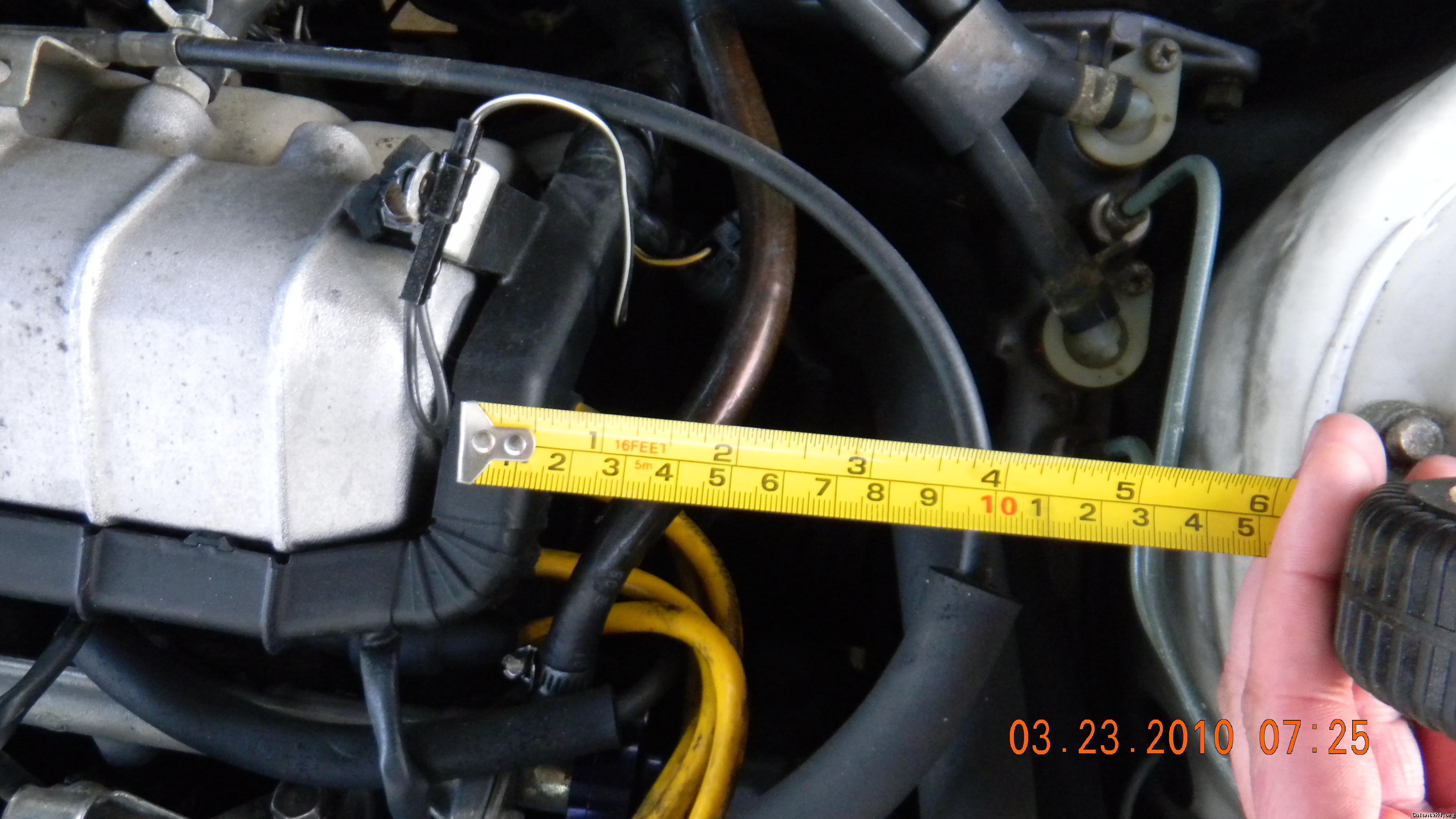

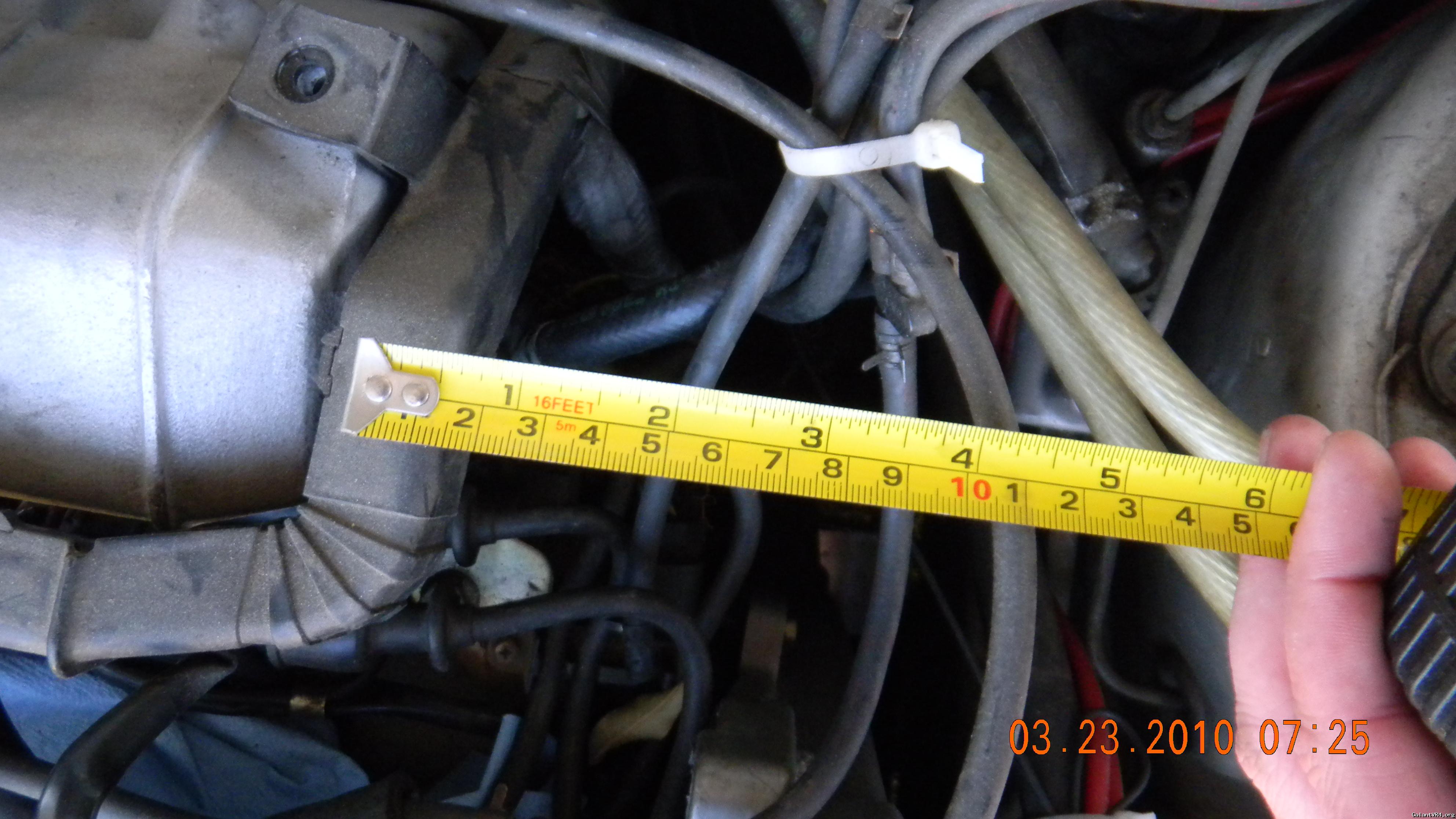

i have to do this job soon... have you tried removing the motor mount and tilting the engine back?
remove trans and driver side mount, gently jack the motor up from the pulley side? here is a pic of my 91 galant vr4 and 91 talon nonABS turbo. still alot of crap in the way. pull back the injector harness and pull the spark plug wires /ubbthreads/images/graemlins/confused.gif
talon
galant
well hell i was hoping the talon would have more of a gap, yep mitsu is still full of /ubbthreads/images/graemlins/banghead.gif
