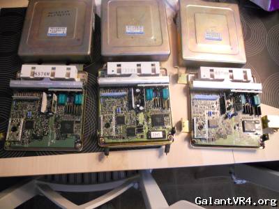

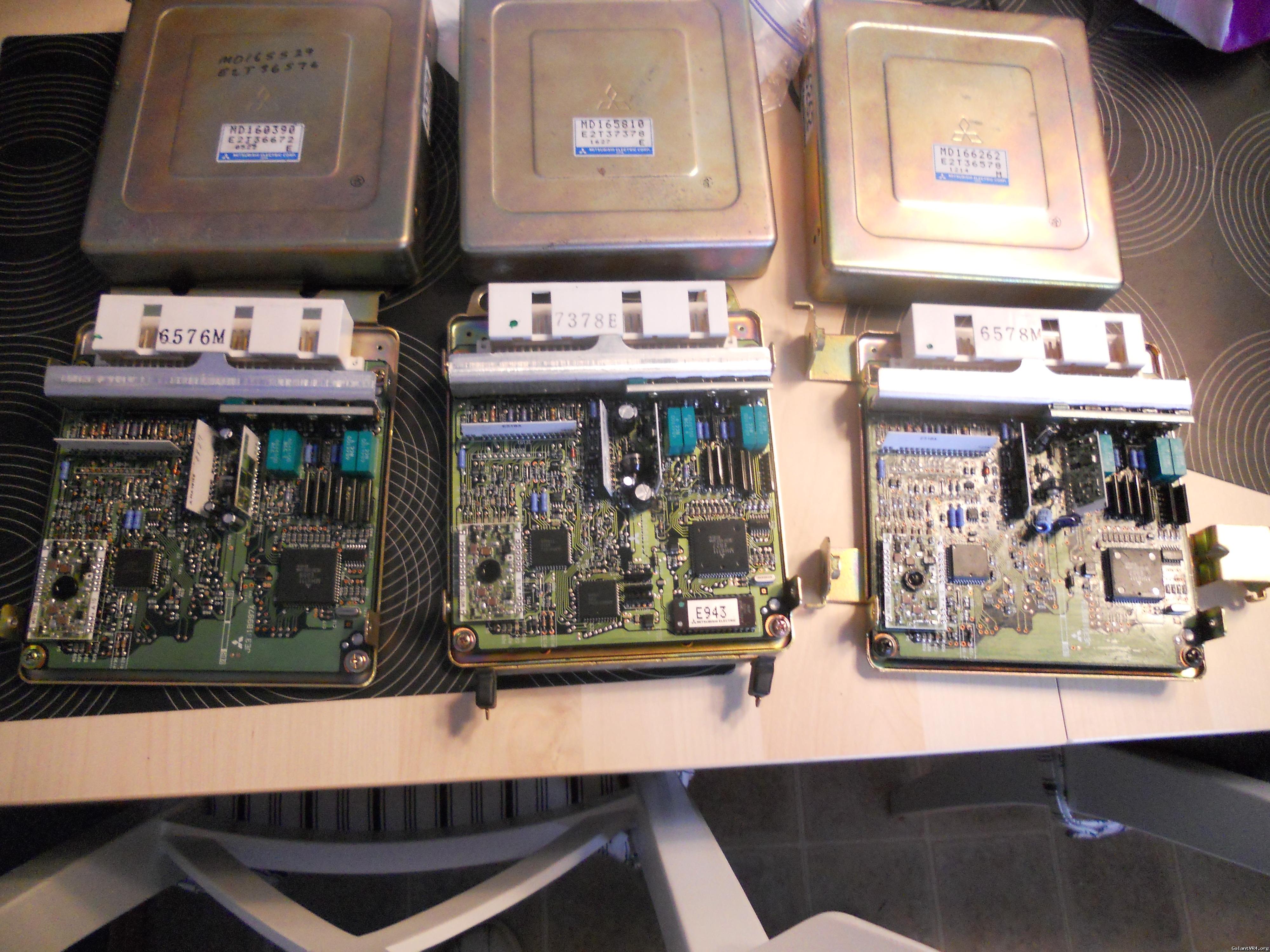

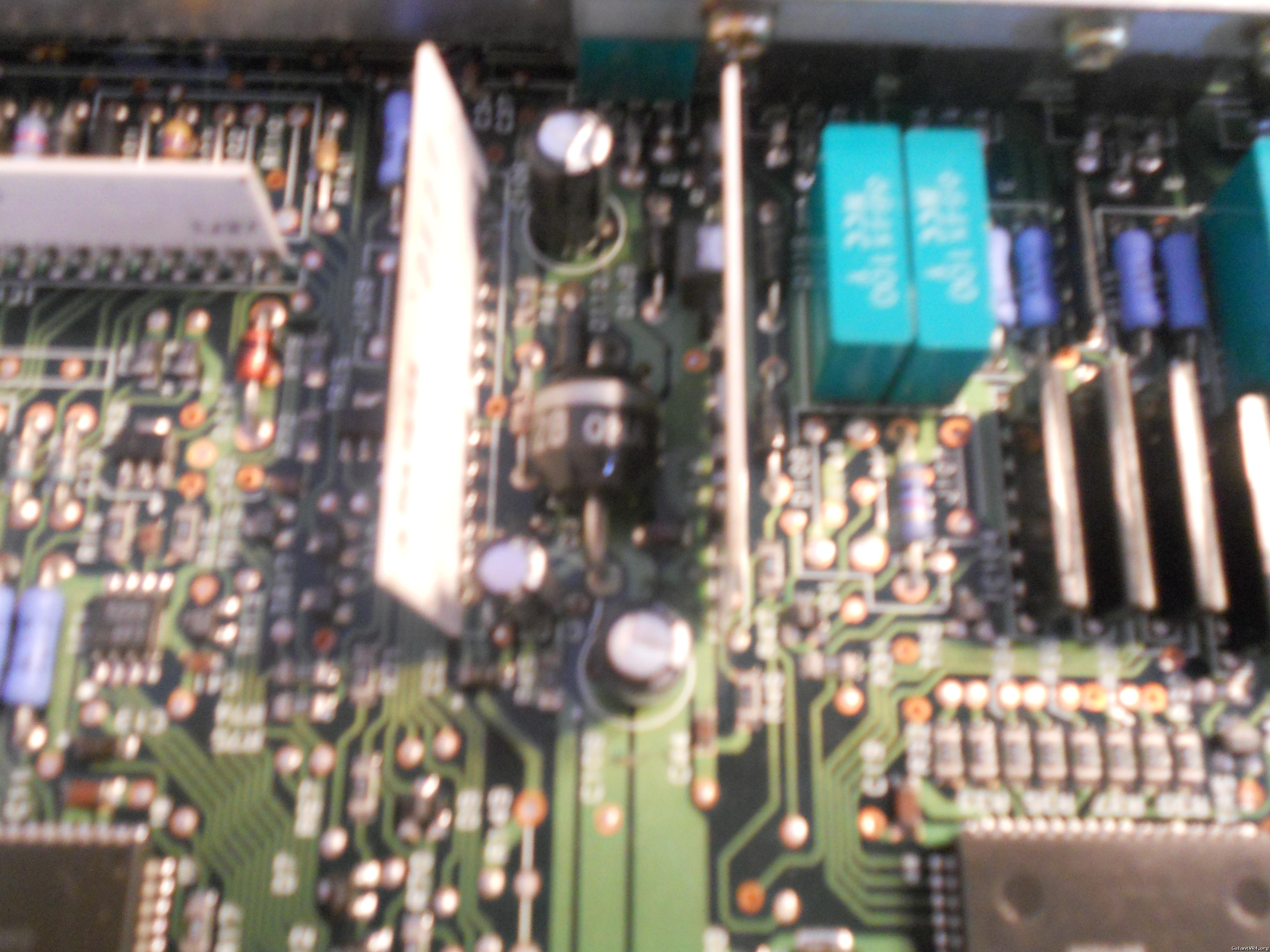

I don't have the best camera but here you go.
Heres all three together, the Original is on the right, my VR-4's in the middle, and the 94 auto that I bought on the left

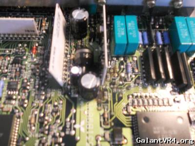

Closer view of the original that my father in law replaced the caps (non eprom)

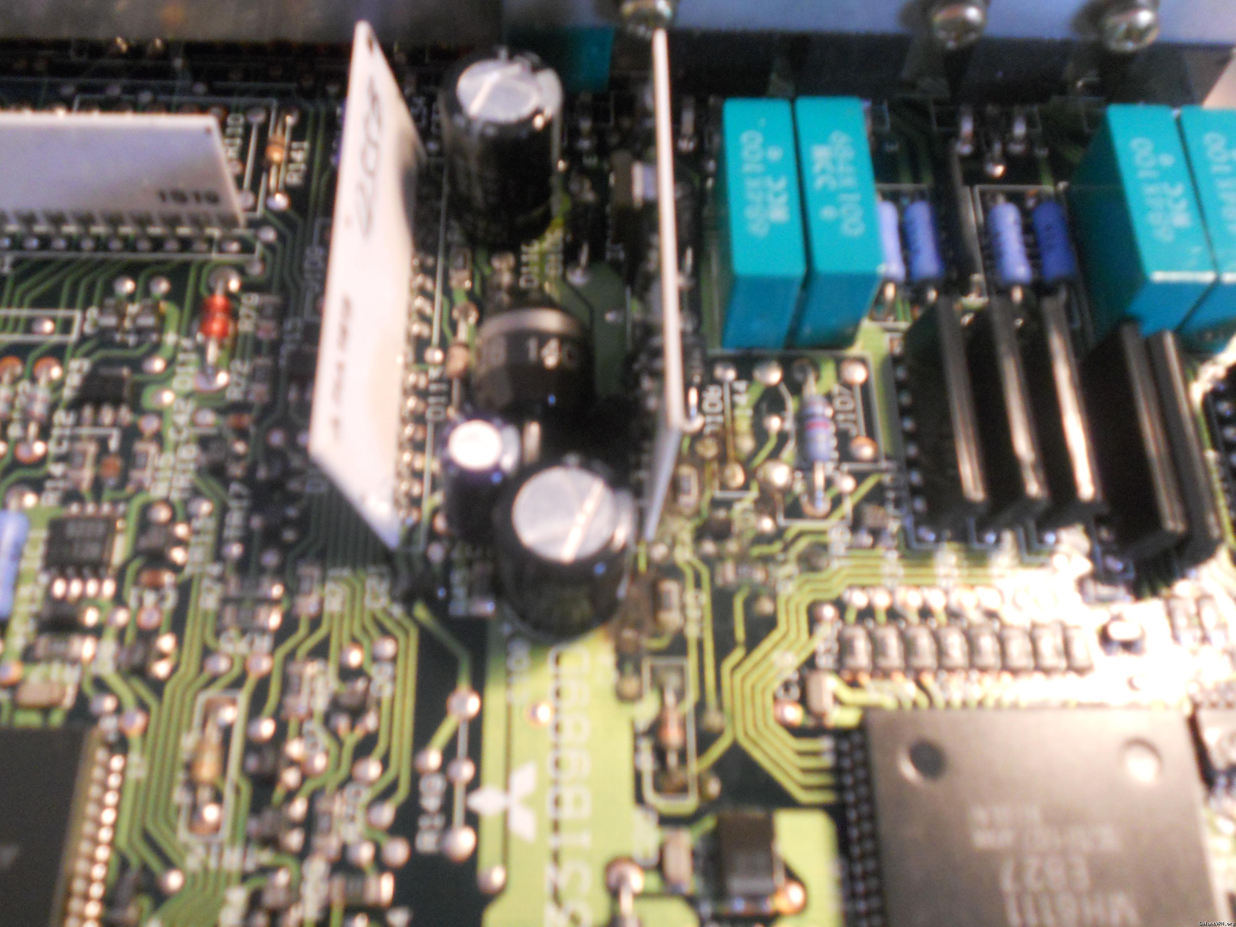

Closer view of my VR-4 notice that it has more damage than the original if you can see.(eprom)

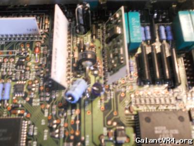

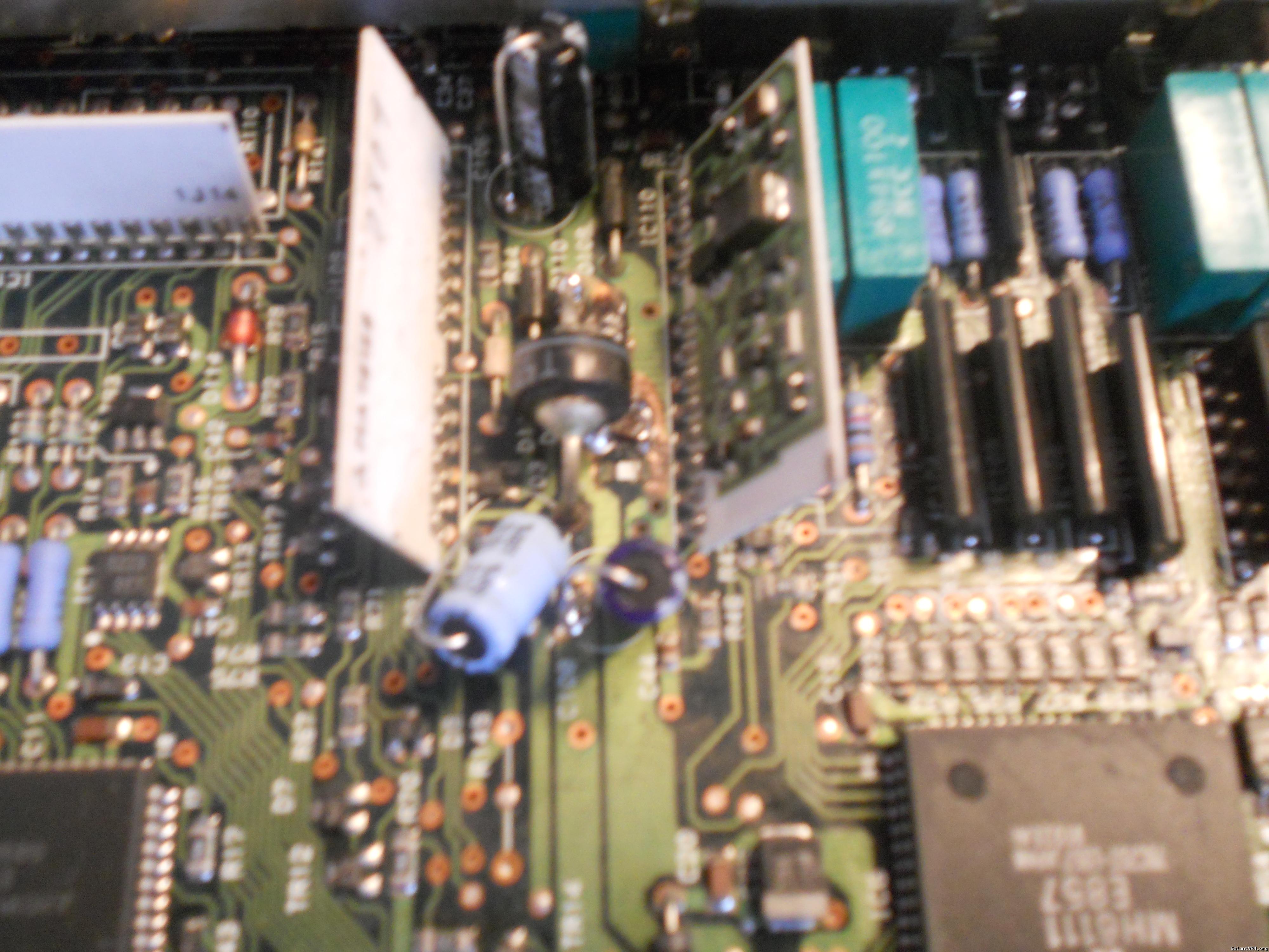

Closer view of the 94 auto ecu, cleanest of them all (non eprom)

Here's what you have:
MD165529 - 6576M (The ecu that comes from your car)
This is 6/90-6/92 Federal AT ecu
MD165810 - 7378E
This is GVR4 federal MT ecu
MD166262 - 6578M
This is 6/90-6/92 federal MT ecu
None of your ecu is a 1990 style. They're all the proper 91-94 style as far as pin arrangement is concerned.
Both your original ecu and the ecu that you purcahsed had the caps replaced, while the GVR4 ecu still has original caps. Perhaps there are electrical trace on ecu board that was damaged and overlooked during caps replacements.
