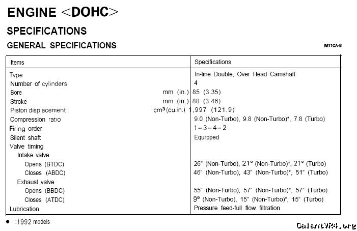

This page has some interesting bits about a non-turbo ECU with a knock board: Clicky . Also, I made this post a while back:
Quoting me:
The compression ratio is 9.8:1, according to the service manual. The 1992 N/A DOHC models had a 10hp increase (145hp) over the prior models, which had a 9:1 ratio. I guess this is why it needs a knock sensor. In order to achieve this extra compression, the 1992 N/A models have different camshafts in the cylinder head to change the valve timing, and higher compression pistons. I didn't realize this until tonight; I thought all N/A cams and pistons were alike.
The code on the pistons in this series is 63H (9.8, high compression), instead of 63D (9.0, non-turbo) or 63T (7.8, turbo).
I have all of this stuff sitting in my garage right now /ubbthreads/images/graemlins/smile.gif
Good luck on your search.
