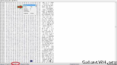

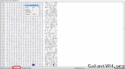

and on my ECU connector Pin 13 for "Control Relay (Fuel pump drive signal) is connected ?!
here is a pic from hex editor, is this the adress you mean?
AllanL
Aug 4, 2008
298
NV

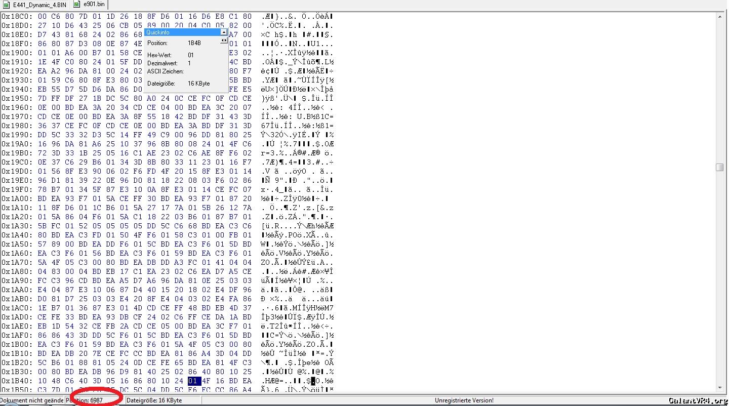

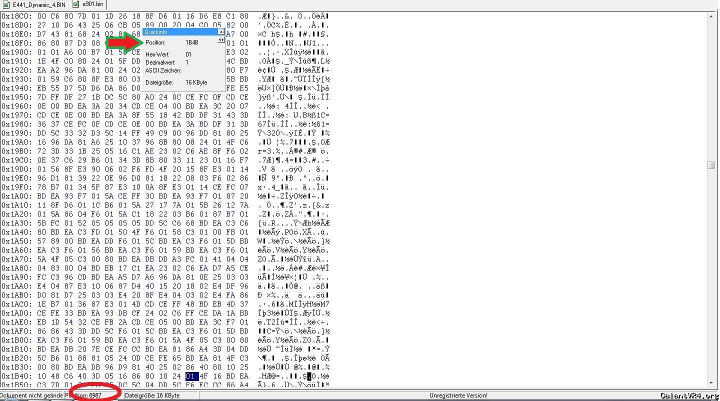

I believe Kim was referring to the E931 bin when he mentioned changing the value in 6987.
In the 32k bin for E901, it is 5B4B. in the 16k bin with the pic you posted, that address you encircled is incorrect. 1B4B is the position indicated by the green-red arrow in the pic below.
Use the search function in your bin editor, and search for the area where the string 'D5 40 01 5A' is present. I believe this string is at 2951 in your 16k bin.
Change 5A to 01.
Hope this helps.
Let us know if the CEL goes away after changing 5A --> 01.
Galant_martin
Oct 21, 2013
51
Austria
So.
I checked the 441.bin
The string started at "294E" with D5 and endet with 5A at "2951"
i changed it to 01 and it worked /ubbthreads/images/graemlins/wink.gif No CEL /ubbthreads/images/graemlins/cool.gif
