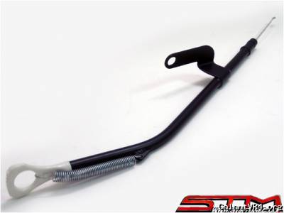

the plastic tops break off, but it's nice that they don't burn you like the metal ones.
if you're popping it out, just crimp it a LITTLE bit with pliers and it won't pop out anymore. Alternatively, you can put a little bit of hose & hose clamp around the tube, and then just zip tie the dipstick to the hose clamp. I've seen a lot of the fast race cars doing that since even with good compression & ventilation stuff going on 40+ psi tend to do wicked things.
belize1334
Nov 18, 2003
3,317
Bozeman, MT

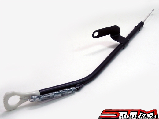

I just used a small hose clamp and added a spring to mine similar to what's pictured. Works flawlessly.

One of the local guys had a fire at the track from popping a brand new dipstick last summer. New motor w/ good sealing, dual -10 vents off the valve cover...
Like I said, it doesn't really matter, at huge boost/big power, tying it down makes sense. /ubbthreads/images/graemlins/wink.gif
A new dipstick definitely wouldn't hurt, but aren't they all plastic handled now?

no its not.. a new dipstick isn't going to fix it everytime. if your car is making good power, you can still blow out a brand new dipsick. its better than clamping the tube.
