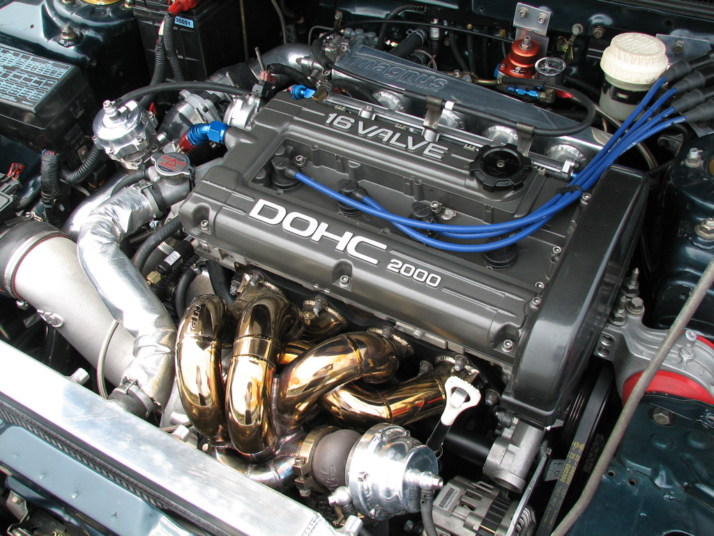

I'm not reading all of this mess, but do have a few suggestions!
1. Do this and simply hold the dipstick in place.
or
2. Do this and keep it from popping out.
It's important that you not only vent the crankcase pressure, but create a vacuum (why the line from the valve cover runs to the intake pipe/box) so that it seals and creates suction. Better ring seals etc. Anyways good luck.

^^wow, thats a clean engine bay, nice! /ubbthreads/images/graemlins/worthy.gif
